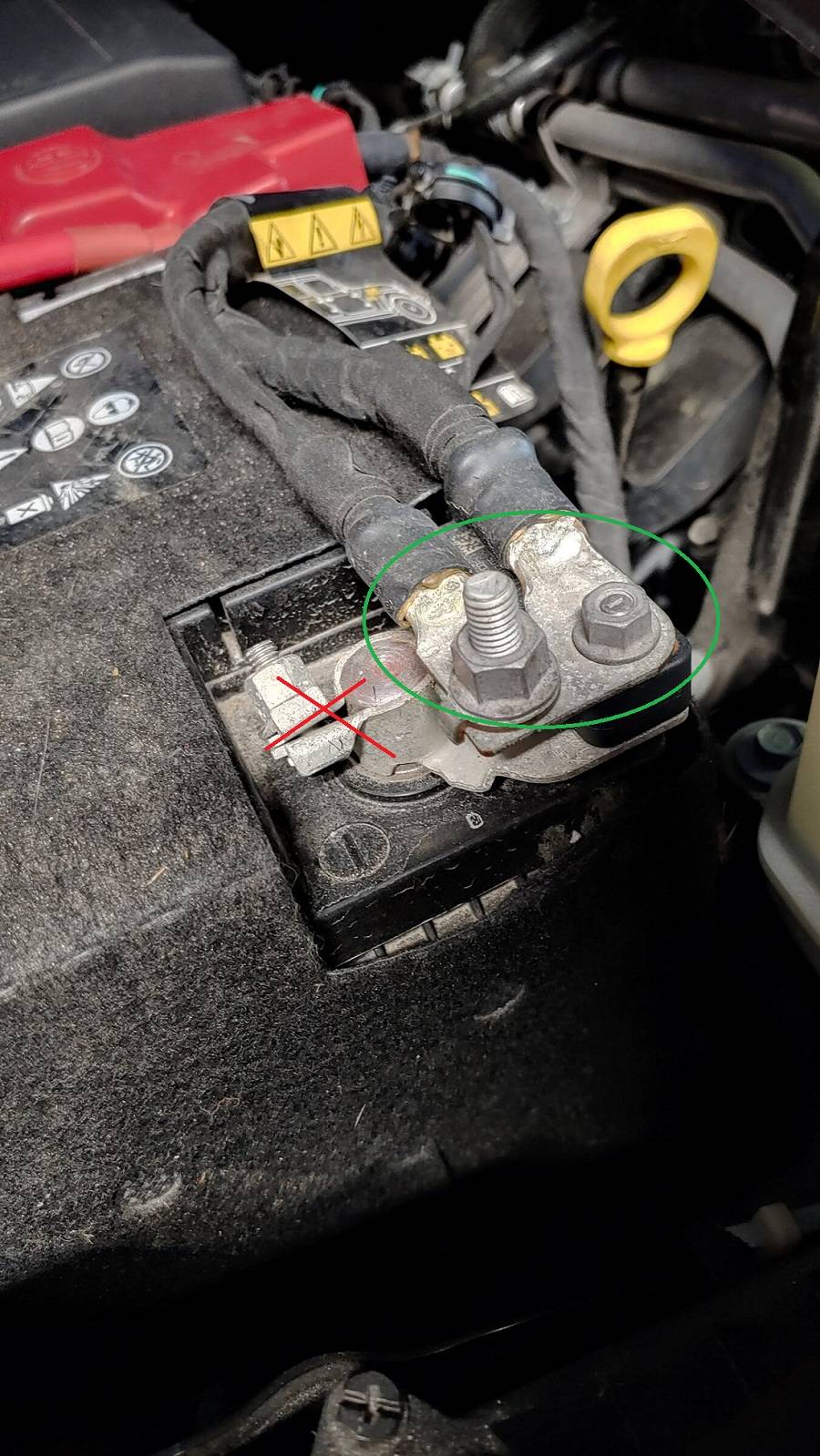

As long as you connect the ground to the plate above the main battery post you are good. If you connected it directly to the battery post, you may need to do an Ibs reset. Those two large cables at the negative post go to your fender ground and the Aux battery ground. If you take the ground off that connection, you can charge the batteries independently. Keep those cable ends from touching anything.

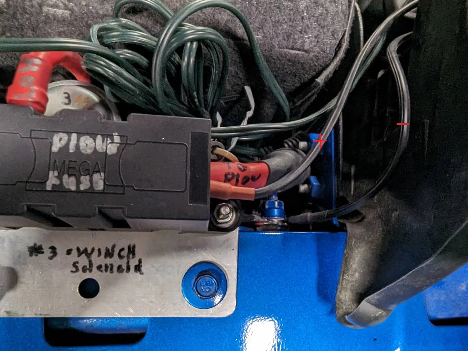

i connected my BatteryMinder to my snow plow fuse and to the fender ground lug.
It maintains at a voltage about 13.4 or something like that I checked voltage at the main battery and the aux battery via N1 and the voltage was the same at all points.

As far as connecting to the negative - either use a ground lug or somewhere in the green circle. Don't connect to the red X area -

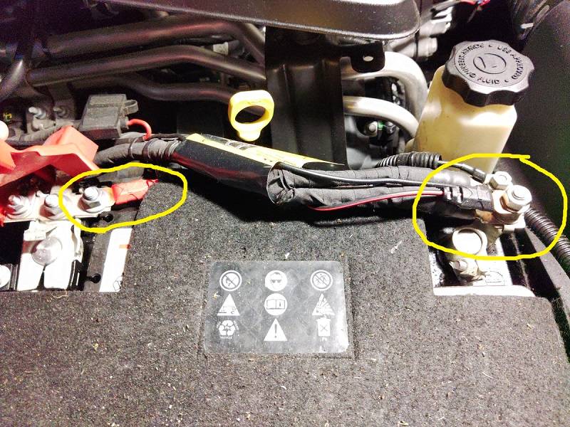

Here are the connections for the NOCO tender that is on my '21 Mojave which should work the same for your '20.
I added a nut to the top of the stud of the IBS for the negative terminal connection.

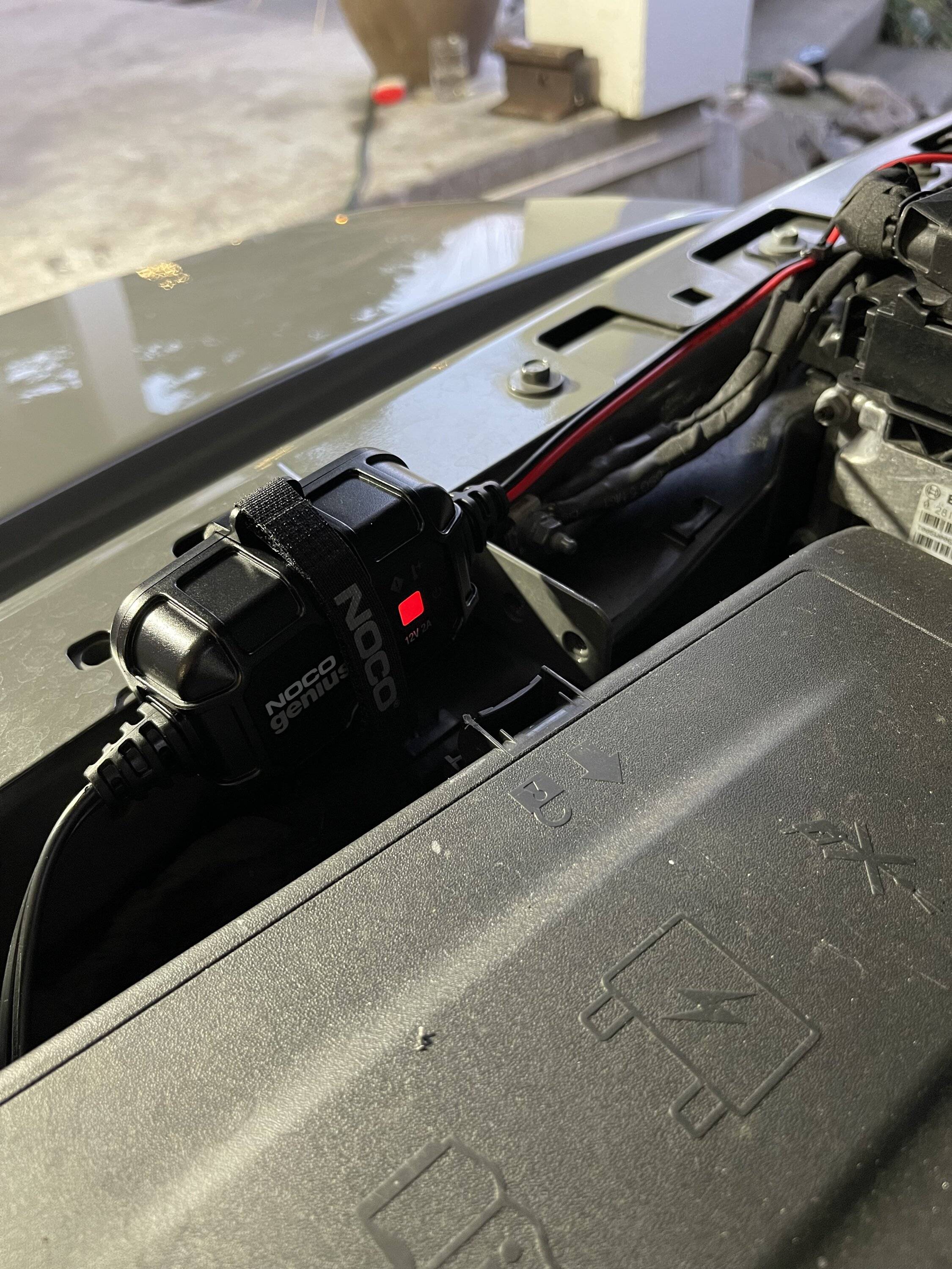

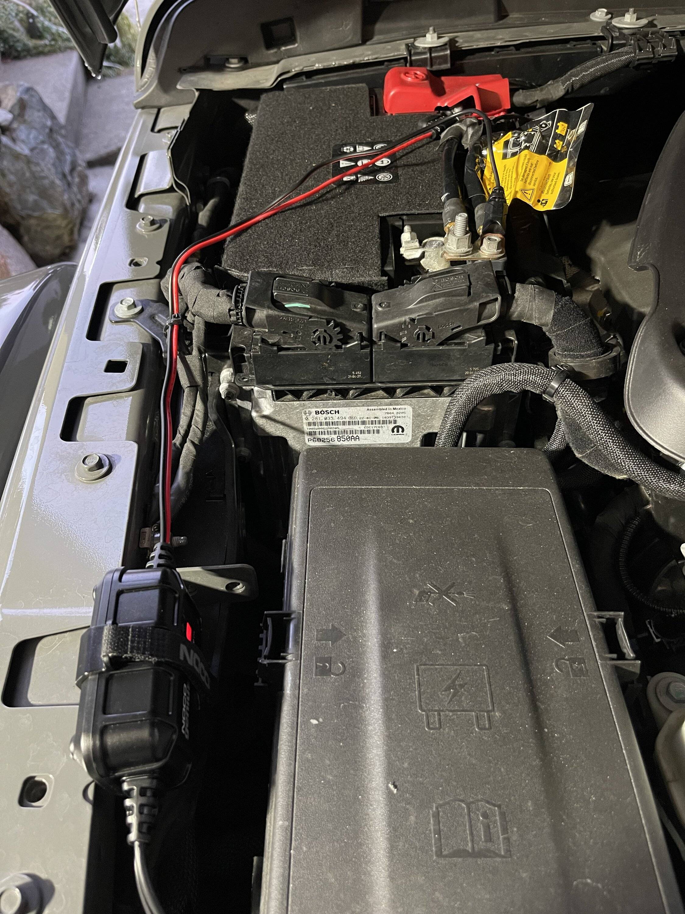

NOCO Genius 2D, very clean little mounting bracket is included. Do wish the 120v cord end was a bit longer but overall, great buy.
