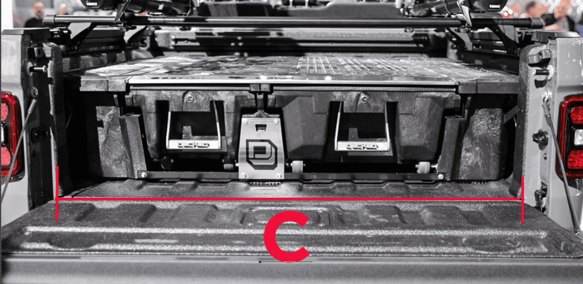

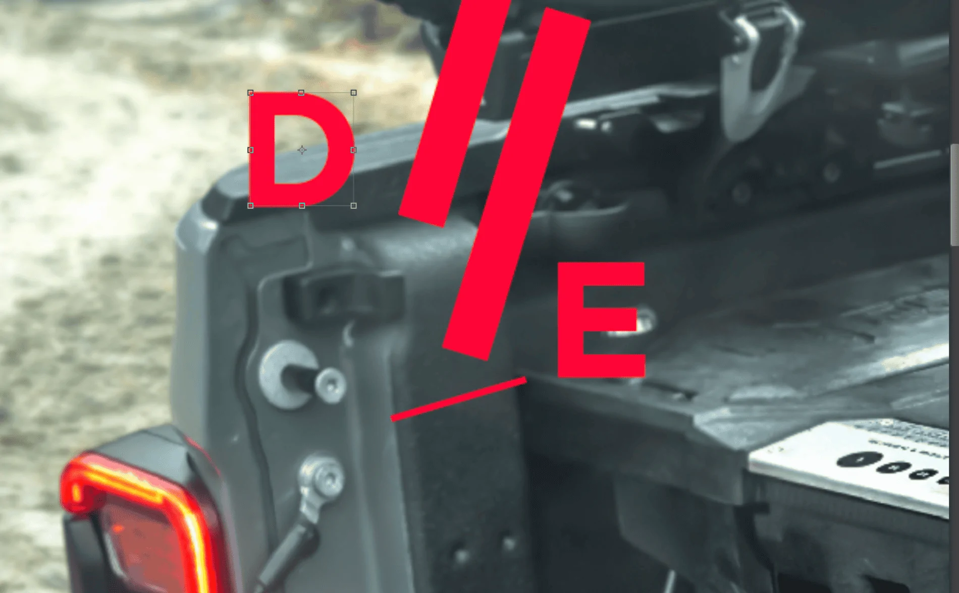

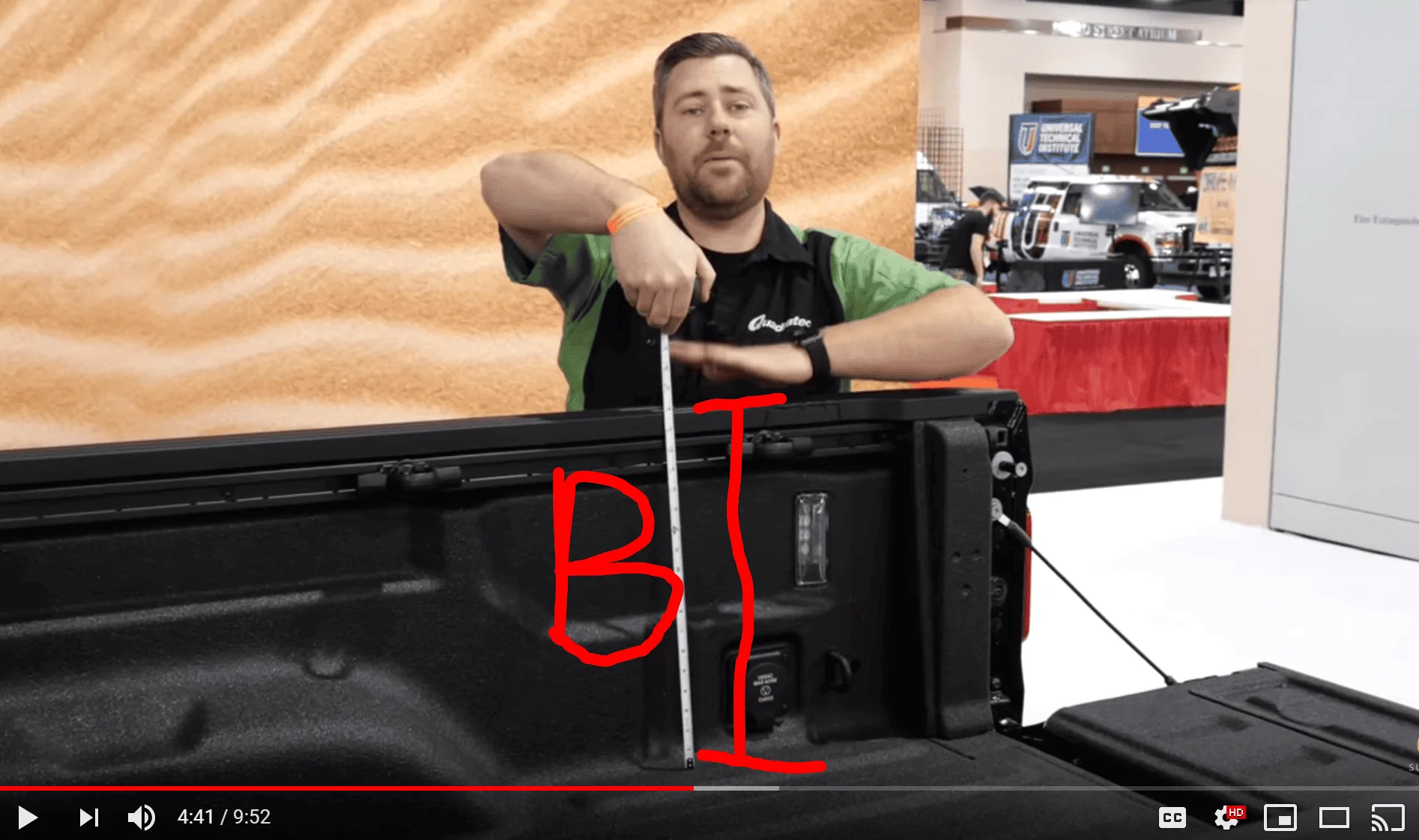

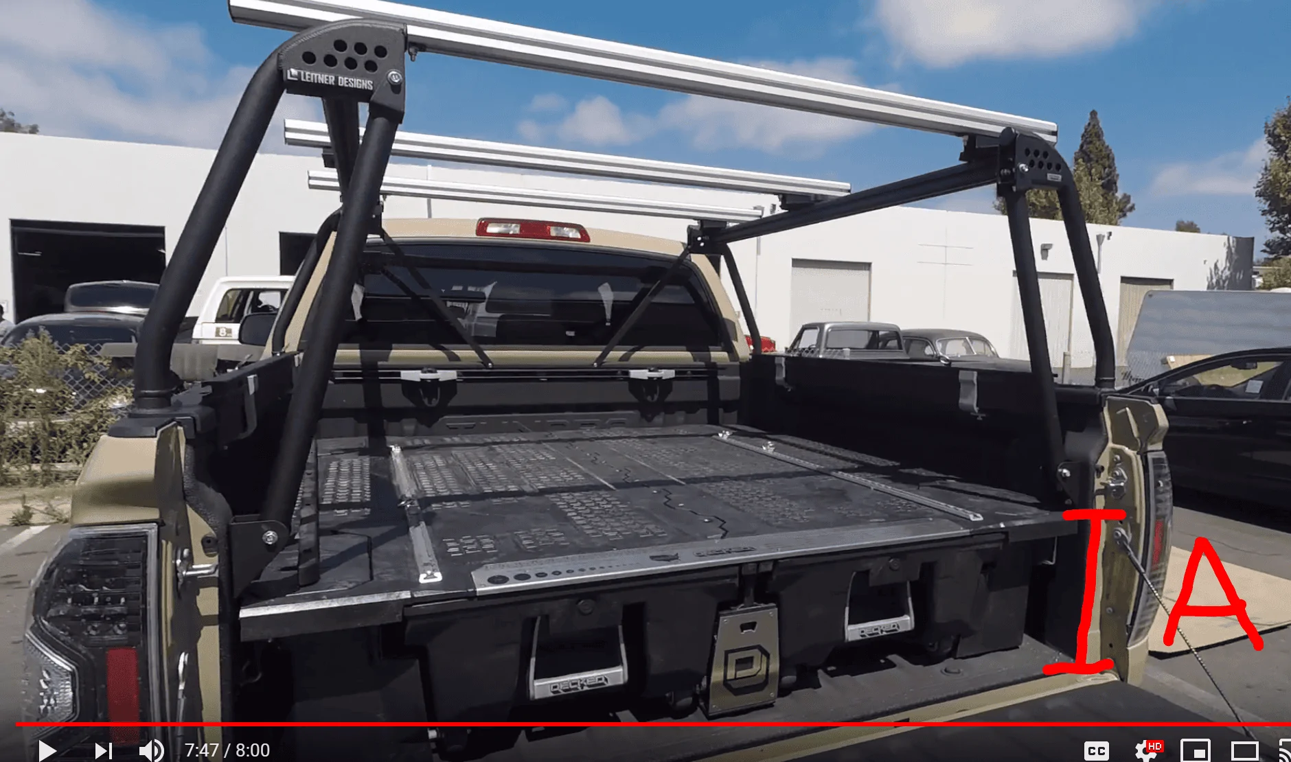

I posted this in the Leitner thread, but i think more guys frequent this one and i'm looking for opinions on if this mod i'm planning is structurally safe to the truck, and to the rack.
Looking from A and B measurements below, from the top of the deck to the top of the box would be 5.5" With only 49" between the D pillars "C", if the brackets for the diagonal supports are right above the decked box at E, PLYWOOD won't fit. So if Leitner does put them there, i'll have to modify it to mount at spot D below. I wonder if that area is structural enough to support it. I'm assuming so, with a static max load of 1000lbs, if weight is dispersed evenly, then only 250 lbs of weight at that spot......should be fine, don't you think?
Height A is 12" on all decked boxes.
Jeep Gladiator Tops! Canopy / covers / toppers / racks possibilities for Gladiator - Show me! 11525
Height B is 17.5"
Jeep Gladiator Tops! Canopy / covers / toppers / racks possibilities for Gladiator - Show me! 11526
C is 49" between the D pillars.
Jeep Gladiator Tops! Canopy / covers / toppers / racks possibilities for Gladiator - Show me! 11533
Need to fab up a new mount and shorten the diagonal support possibly.
Jeep Gladiator Tops! Canopy / covers / toppers / racks possibilities for Gladiator - Show me! 11532

If those angled supports are rigged to mount near the top of the bed rail, you still would only end up with room for 1-2 sheets of plywood between them and the top of the Deck. You might be better off hauling the plywood on top of the Leitner rack.
Regarding the angled supports:
If the Decked system ends a few inches before hitting the tailgate like the last pic shows (E), the supports will be able to mount however low they're designed to mount.
If the Decked system extends all the way to the tailgate, maybe you could just mount those inner supports to the top of the Decked structure itself. Granted, you'd lose some of that 49" width.
