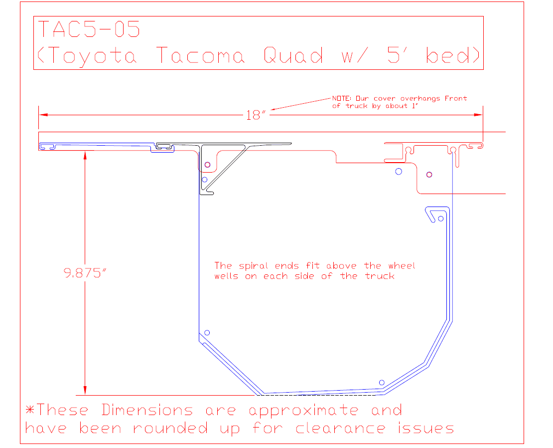

I contacted retrax and their tonneau coil cover canister is 9.875" tall. They don't have one for JT yet, but this will give us some idea of the canister depth

the Max Modular doesn't look like the first roll-n-rack in this video below, but it does do the same detent thing, where you have to pull it slightly past a spot, let it go back and it clicks into place.
At 1:04 he says maybe the most important thing, 7" canister, whereas the retrax might be 9.875" That's almost 3" more vertical space,.......THAT'S A LOT OF PLYWOOD!
I'll find out more info on the roll-n-lock, probably have an aluminum top version as well.

wait wait, hold on. Now the cust service guy from retrax is saying the mid-size trucks might not use the same canister and he'll find out. So .....i'll let you know when I know then go back and fix my previous posts.
EDIT: Fixed previous 2 posts with Taco info. Ours is probably similar once they finish making them. IF EVER....ugh

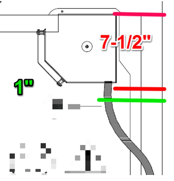

Just got this from Roll-n-lock Their housing is 7.5" down, plus 1" for the drain tube nipple. I plan to kick this out at about a 90 to go straight out the back of the box if I go this route. Also the photo doesn't show it, but in a follow up email from customer service is that its 9.75" from back of the bed to the front of the "canister".
8.5"x9.75" = 82.875 square inches times bed width for volume.
The retrax uses up WAY more volume back there. 13" x 10.875 (includes drain nipple) = 141.375 square inches times bed width for volume.
