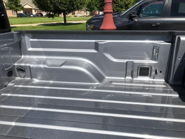

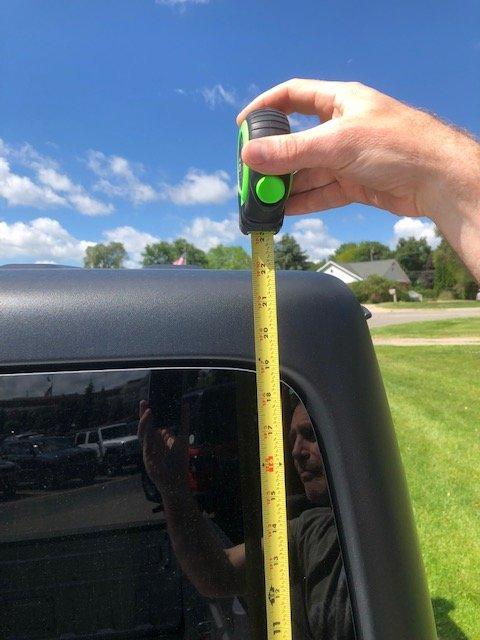

Since there has been talk of a homemade and/or 80/20 rack/topper, I took some pics of a Sport S with no 'trail rails' and no bedliner. I wanted to see what attachment points are possible.
First, the height from the top of the bed rail to the top of a hard top is 22" at the outer edge, but 23" at the center raised points.

The walls of the bed expose threads of welded nuts for mounting 'trail rails' as well as their tonneau covers. These could very well be used as attachment points for custom jobs. The grommets at the right & left would make it easy to run wire into the bed area to power anything you want powered in your custom topper.

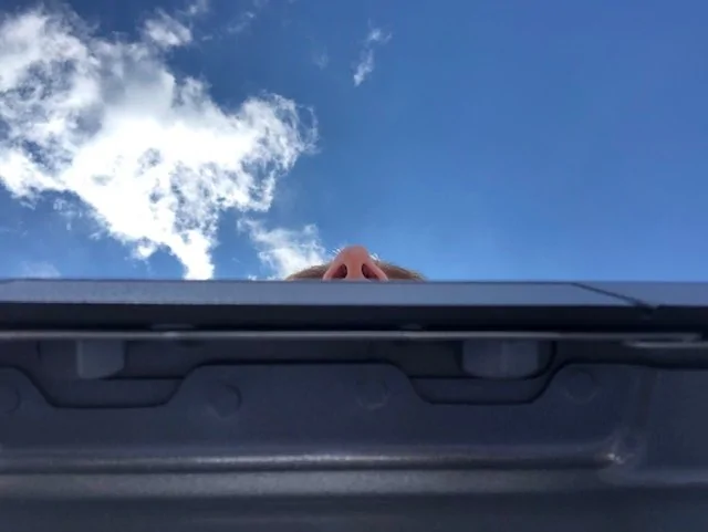

Two welded nuts are visible under the lip of the rail near the tailgate on both sides. Looks like part of the plastic bed rail protector can be removed to access the nuts pictured. (sorry about the nose pic)

The bed rail liner could be removed entirely via these plastic clips. Doing so would expose holes in the top of the bed rail that could also be used for mounting various racks or covers. I think there were 4 clips on each rail.
Jeep Gladiator Tops! Canopy / covers / toppers / racks possibilities for Gladiator - Show me! Bed rail cli
As previously noted, the fuel tank enclosure may prevent certain covers from being installed.
Jeep Gladiator Tops! Canopy / covers / toppers / racks possibilities for Gladiator - Show me! Bed left rail
Installing a power outlet after the fact may not require any cutting. Seems like the bed wall has a plastic cover over the hole that would have been used for the factory outlet.
Jeep Gladiator Tops! Canopy / covers / toppers / racks possibilities for Gladiator - Show me! Bed right rail
great work! im excited to see what creative stuff follows!
