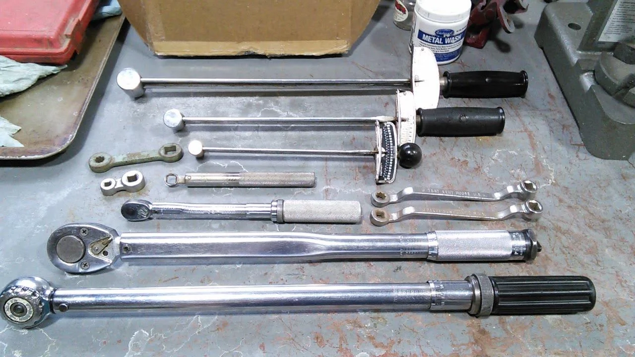

As my largest is less than 200 pound/feet looks like I need to get another one to add to the collection.
Proto, NAPA, Snap-On, Kent-Moore, Craftsman and others, including a specialized wrench made for adjusting the bands on early Borg-Warner automatic transmissions as well as some adapters to make it easier to get to the band adjustment screw while the transmission is in the car.....

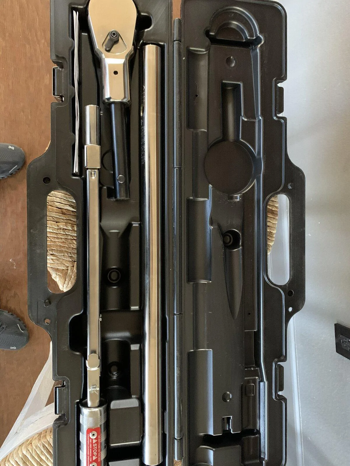

Amazon just delivered the incorrect torque wench... ? They sent PI’s C4D600F, good for 200 - 600 ft lbs! Build quality is outstanding - what a beast! Back it goes

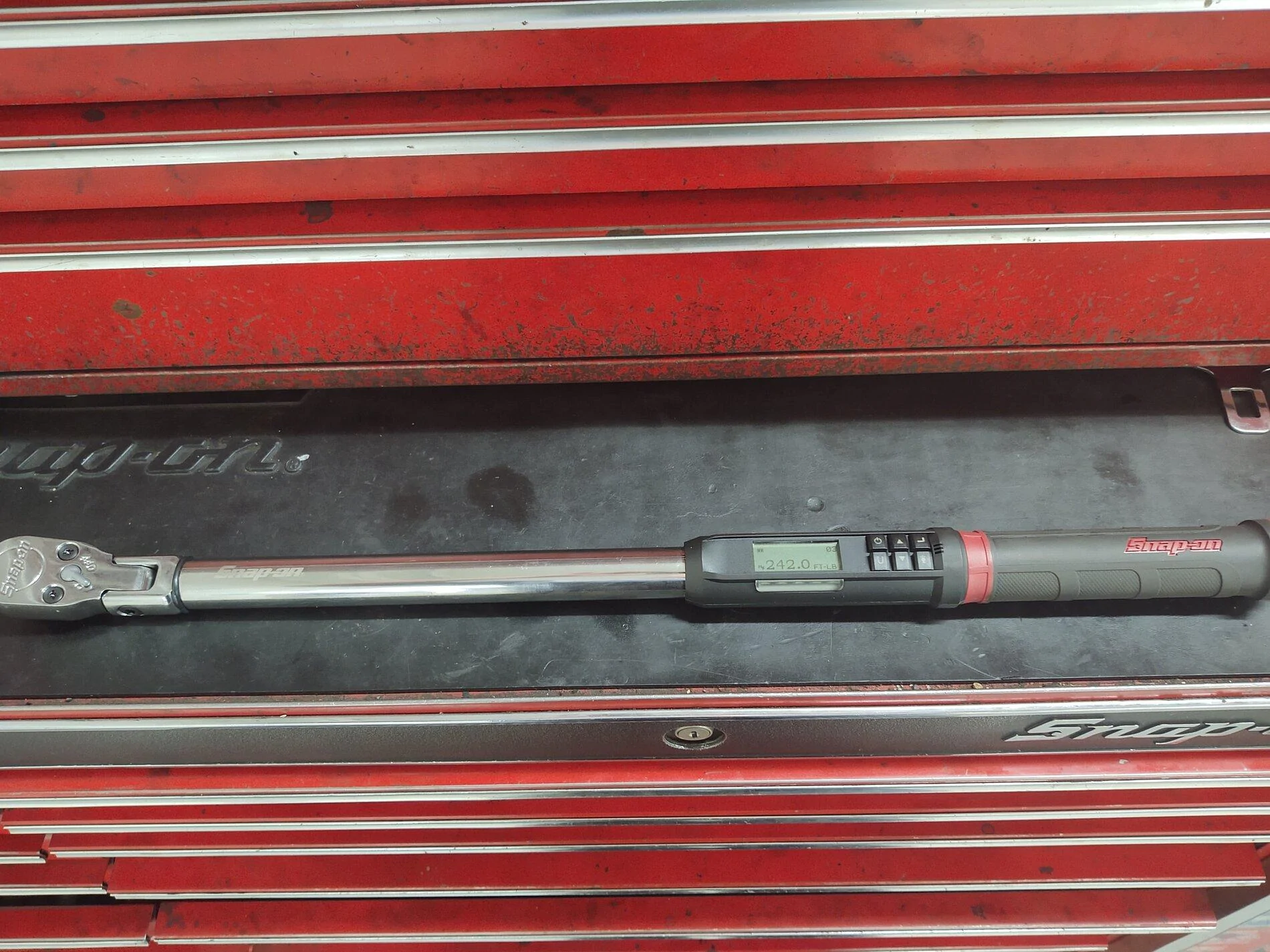

that hit me right in the feels, a few years back I bought the snap-on 1/2” and 3/8” torque wrenches (digital) that have the angle measure, saved Presets, multiple measurement jazz on them for a gut wrenching $1200+.... granted I’m a wrench for a living and I don’t put any faith Into something that has a higher probability of failure... but that precision instrument torque wrench looks identical the old style snap on... should be a good buy I figure
you had me in the first half though lol if it was the same wrench as mine I was going to be a little sore... granted I didn’t do any research into who built the snap-on from the gate and I have the utmost faith in my torque wrenches for accuracy and durability... if you don’t do this for a living I wouldn’t advise anyone to spend that kind of dough on tools. Don’t source the cheapest wrench and expect it to be top tier, but don’t drain a bank account paying out the nose for high end tools if they aren’t in service 24/7... pick a reputable brand with a good warranty and the price will probably be middle of the road and give you several years of service
Crap - if that started say about 150 then up, I'd say send it my way instead....... but my need is to cover 150-300 range.

? Amazon was willing to sell it to me for just over $100, they sell it new for ~350! I definitely don’t need that range of torquing power either...
Yeah for 100 bucks, if that thing started at 150, I'd be making a deal with you LOL
That range is a tad over what I need, though - at this point in life I'm only needing to go 250
Wow.
It sure is nice looking, too
This is 3/4” drive isn’t it?
40,440
53,854
3/4" drive, perfect for setting up AMC rear axles. I could use my 3/4 drive sockets and get 250 pound/feet easily. If I could get that for $100, I'd be all in.
