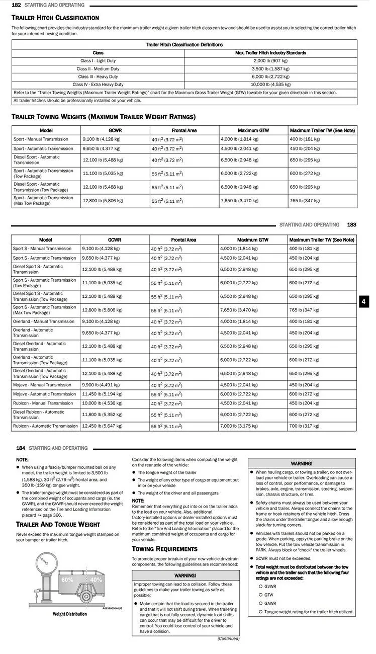

Another thing that was not mentioned (I think) is that in some instances you lose 1,000 lbs. towing capacity by going with a diesel. At least when compared to a JTR. From a Mojave auto to a diesel it's a wash.
The difference in tow rating is due to the diesel running hot. If you're towing a trailer that isn't near max capacity, then the diesel will tow it easier and with better fuel economy. There's no debate whether or not the diesel is the best application for towing, the argument is whether or not it's worth it.
In only two instances do you lose tow capacity when going to the diesel: from a 3.6 automatic Rubicon (7000lb capacity) and from a Max Tow package Sport (7650lb capacity). In all other instances the diesel version will have a tow rating equal to or higher than the gasoline version: the diesel Rubicon tow capacity is 6000lbs while all other diesel versions are 6500lbs.

Tow capacities are laid out in plain black and white in the owner's manual, one can't really go wrong going by that information. Good point about not trusting everything you read though as what you posted was itself not entirely correct.
All Gladiators are rated for 3500lbs when towing with the rear bumper, regardless of how they're otherwise equipped. Add on the appropriate receiver hitch and this bumps up to 4000lbs manual trans and 4500lbs auto trans, exception being the Mojave which goes to 4500lbs/6000lbs and the gas Rubicon which goes up to 4500lbs/7000lbs for manual/auto respectively. Add the factory tow package and the various trims/variants of the gas Sport/Sport S with auto trans also jump up to 6000lbs. Add the Max Tow package (only available on the Sport/Sport S with auto trans) and you get the highest rating, which is 7650lbs. As I mentioned in my earlier post, all diesels are rated 6500lbs except the Rubicon which is 6000lbs. Of note is there are also variations in allowable trailer frontal area depending on how each is equipped, see the excerpt from the owner's manual below for further information on that.

In 2021 the Sport S with max tow was rated for 7650 lbs with gas engine. The same truck with diesel was rated at 6000 lbs. The difference was attributed to the added weight of the diesel engine. That being said, diesels seem to tow better due to developing torque early in the power band.
The issue isn't the weight of the engine. The issue is the narrow grille opening which makes it difficult to adequately cool the engine/charge air cooler. The same engine with more HP/TQ in the Ram 1500 doesn't have that issue.

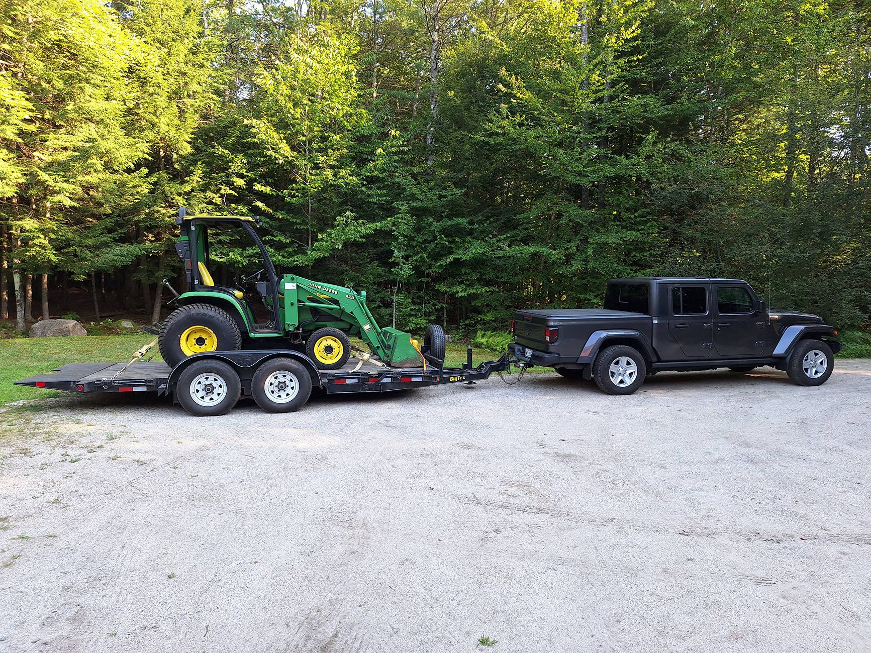

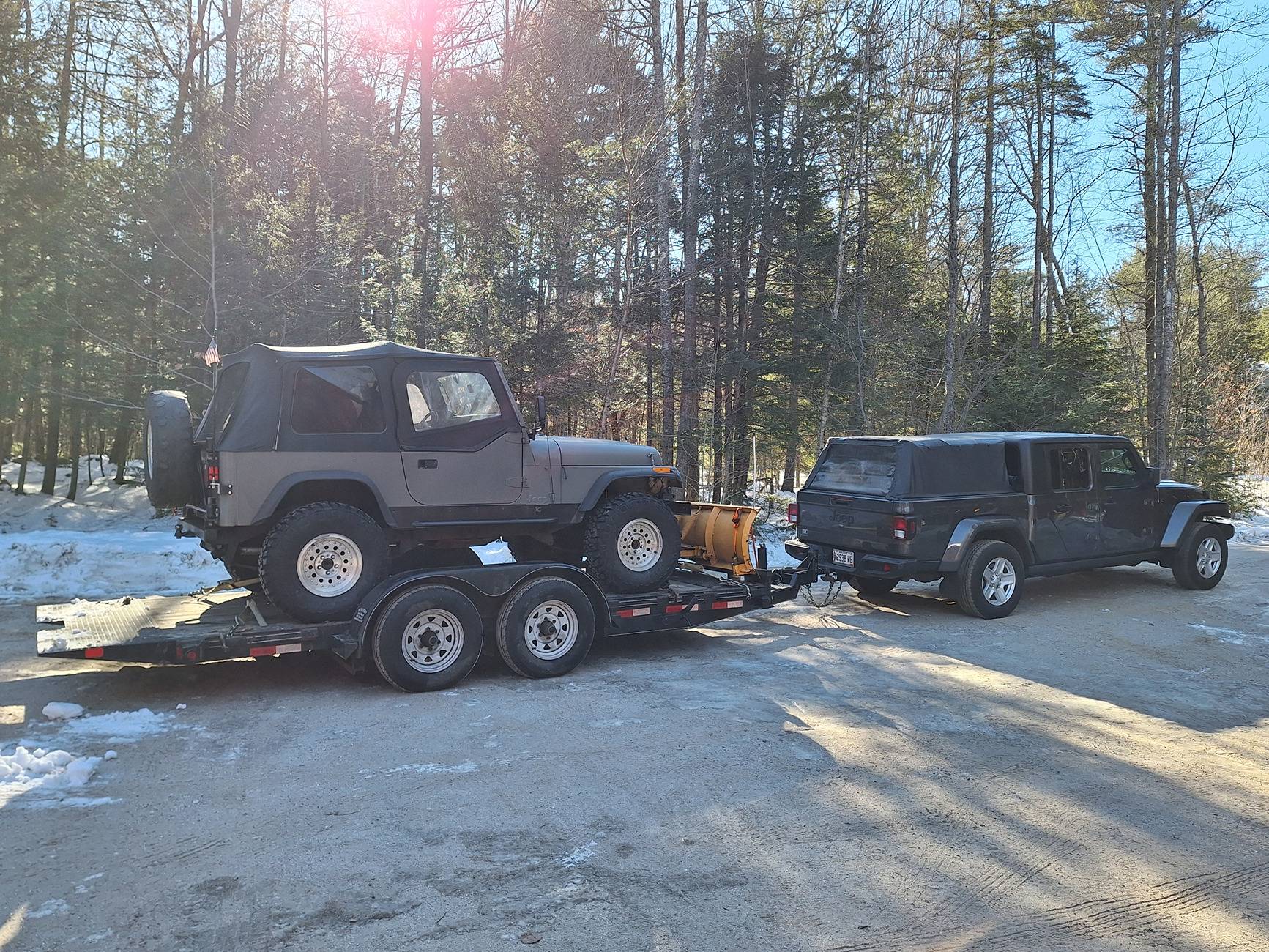

I got the diesel because of the much better driving experience in general, and not necessarily for towing.
I also tested the max tow, and have rented a Rubicon gas on 37s (gear ratio unknown, assuming 4:10) for a week in the California Sierra Nevada mountains. Both times, I did not enjoy the constant high revving to get power going up inclines with nothing in the vehicle. I wasn't afraid of hurting it, more that it was just annoying.
I can only compare my gas vs diesel towing experiences between my old Tacoma with similar power and torque as the Gladiator gas (though not an 8-speed), vs my current ecodiesel. The diesel certainly gives me way more confidence in terms of power. But it's still not that enjoyable to tow with a little truck. I've only towed something substantial with it, twice in nearly two years of ownership. I wanted a fun, nimble truck that could haul my YJ or a tractor, project Jeep, etc. when called upon, and that's about it. Both times, the trailer was maybe between 5,500 or 6,000 lbs. Trailer alone is a little heavy, being a tilt bed. A load-distributing hitch would be a valuable purchase if I towed more, to reduce the teeter-totter effect of the long rear overhang.
As others have said, if you like your truck the way it is and don't tow a lot, then just enjoy it.
The improved power of the diesel will not improve the small footprint of the truck.
