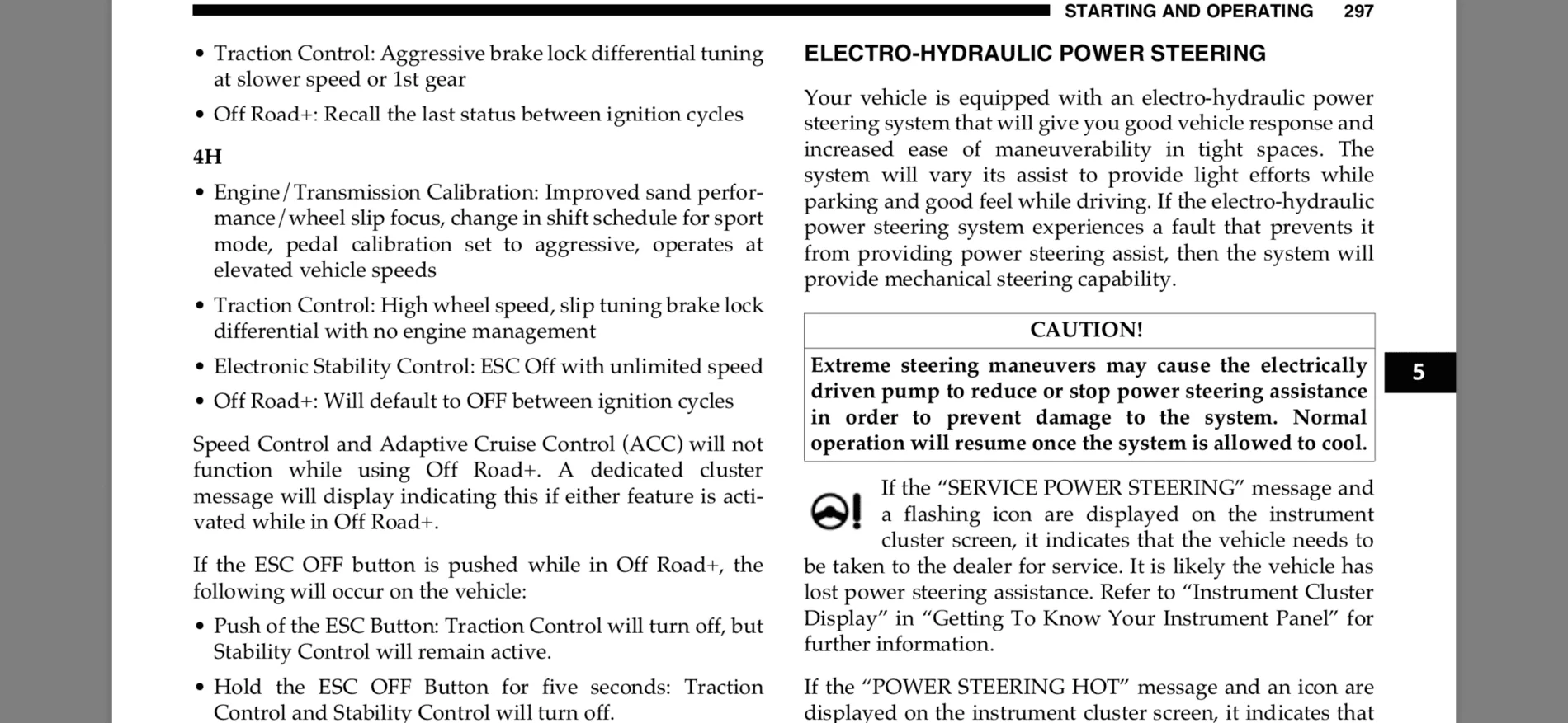

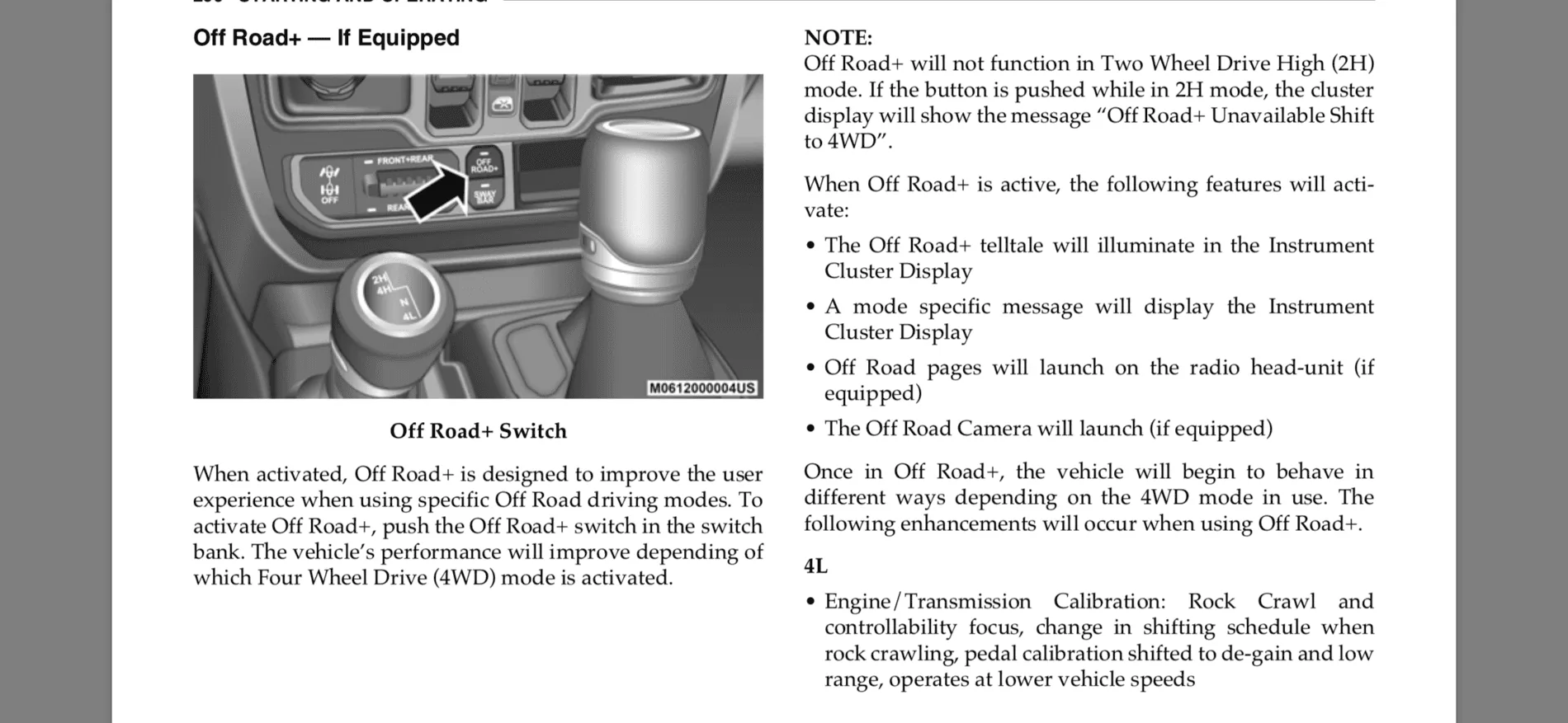

I thought they kept bragging that on the JT you could lock it in 4hi for sand mode. #fakenews
I don’t think they were referring to locking. They were referring to off-road+. Here are the pages from the manual that touches on this. Off-road+ when in 4 high is supposed to help with sand.

Perhaps Jeep marketing folks are confused between a physically locked differential and a brake locked differential? No one ever said the suits actually knew anything right?

I did try the Off Road + feature while driving in the sand at the beach. It made a noticeable difference. But i had no idea what it was doing. Definately higher RPM before shifting, and it felt like better traction. But i wasn't sure if that was just the RPMs or what. In any case, it drives like a champ in the sand.
