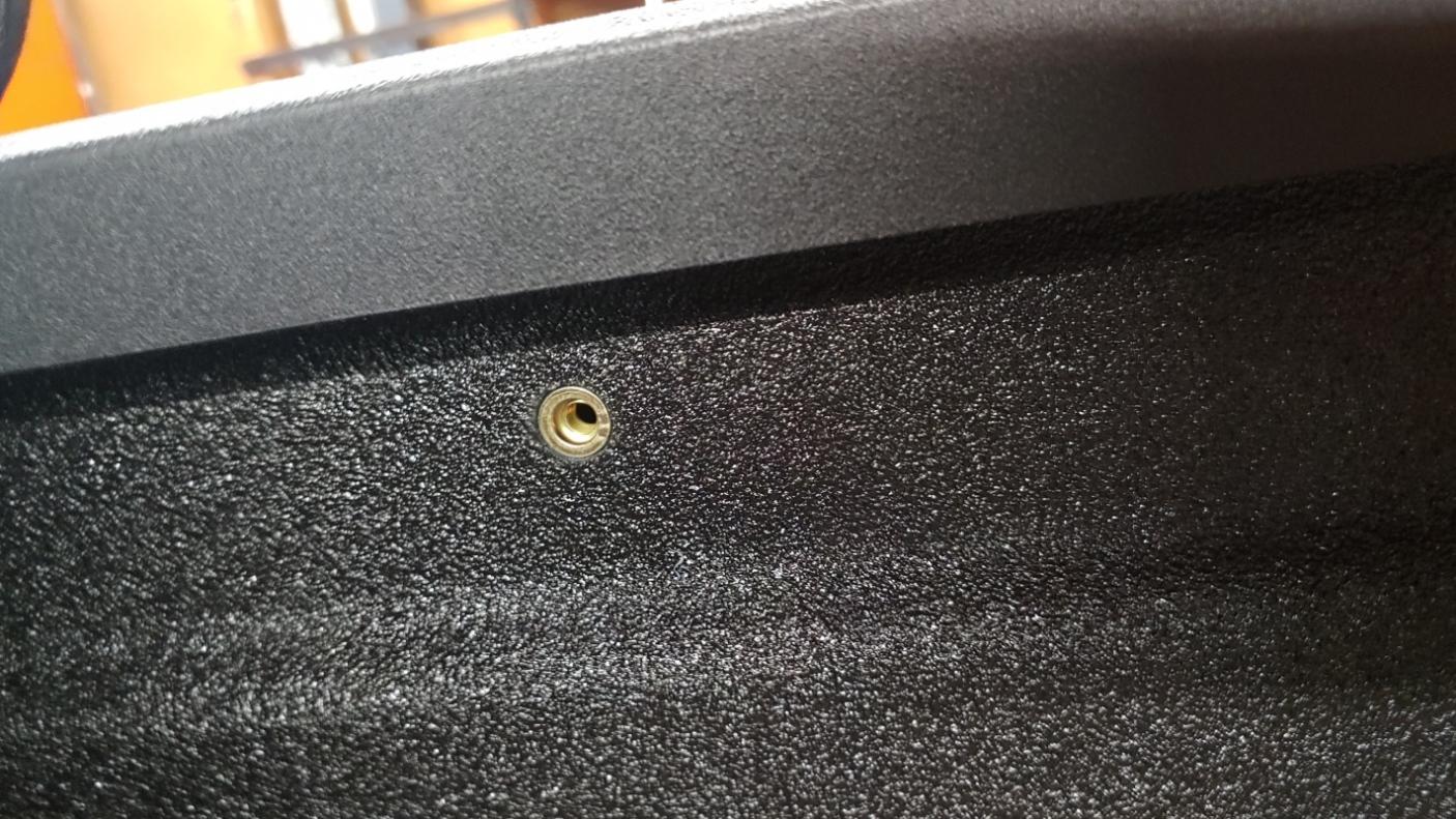

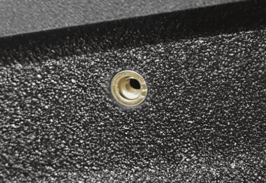

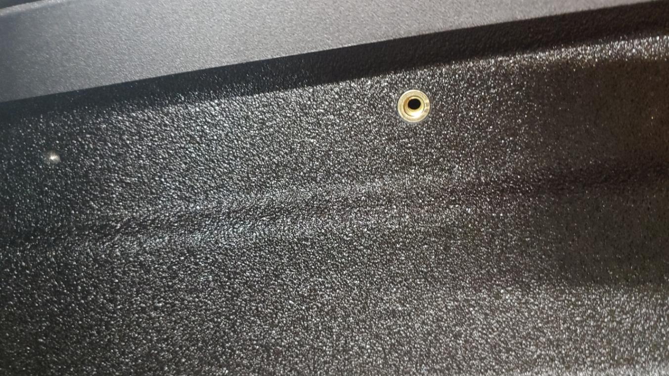

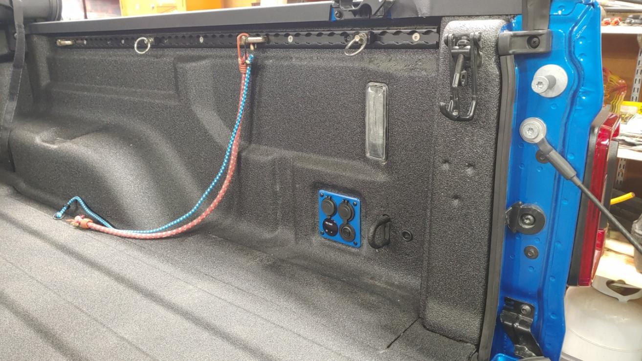

Made my own using the L track. I drilled the track to fit the existing mount points in the bed and added my own rivnuts to give a bit more strength.
Jeep Gladiator Trail Rail Question 20220819_151526
Recessed into the bedliner so they don't sit proud and hold the rail out -
Jeep Gladiator Trail Rail Question 1668901886610
Jeep Gladiator Trail Rail Question 20220722_132249
Original/stock hole on the left ->
Jeep Gladiator Trail Rail Question 20220722_132252

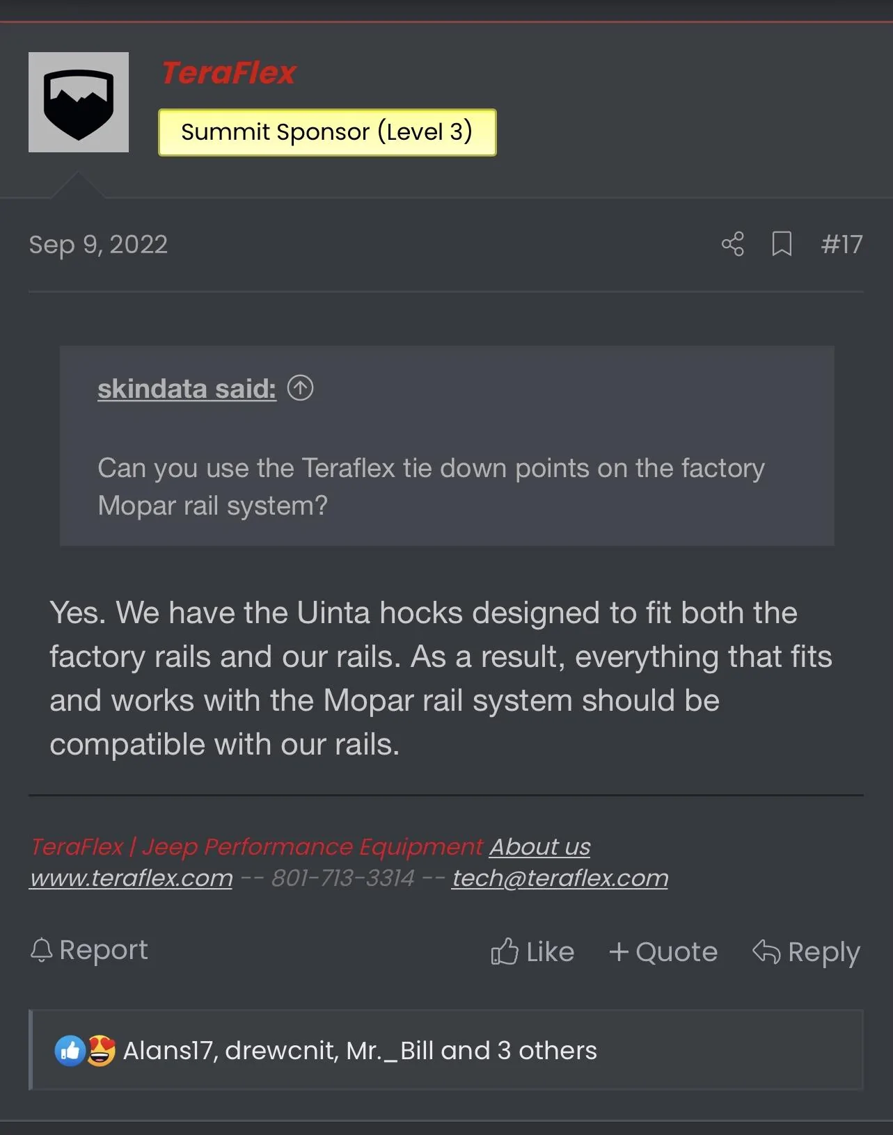

FWIW, Teraflex claims theirs are compatible:
Jeep Gladiator Trail Rail Question 21F2074B-1428-4583-86F5-C224E4DD46EC

Do theirs require slight modification? Rebel Offroad Mentions theirs requires a very slight mod, removing and flipping c clip.
https://rebeloffroad.com/Jeep_Gladiator-bed-rails-ROE-JT-BR3
That Rebel link says “Uinta Tie downs require minor modification for proper fitment.”
The Uinta tie downs are made by Teraflex, so no they would not require modification to use with the Teraflex rails.
Based on that Rebel disclaimer, I would say the Rebel Offroad rails may not be compatible with some Mopar compatible accessories.

I second this. I purchased and installed the Teraflex version. Shortly thereafter, I purchased a bed rack from JCR Off-road and they had no idea if it would fit. They could only confirm the Mopar fitment.
Everything fit like a glove. And still slightly cheaper than the Mopar version. And nicer too!

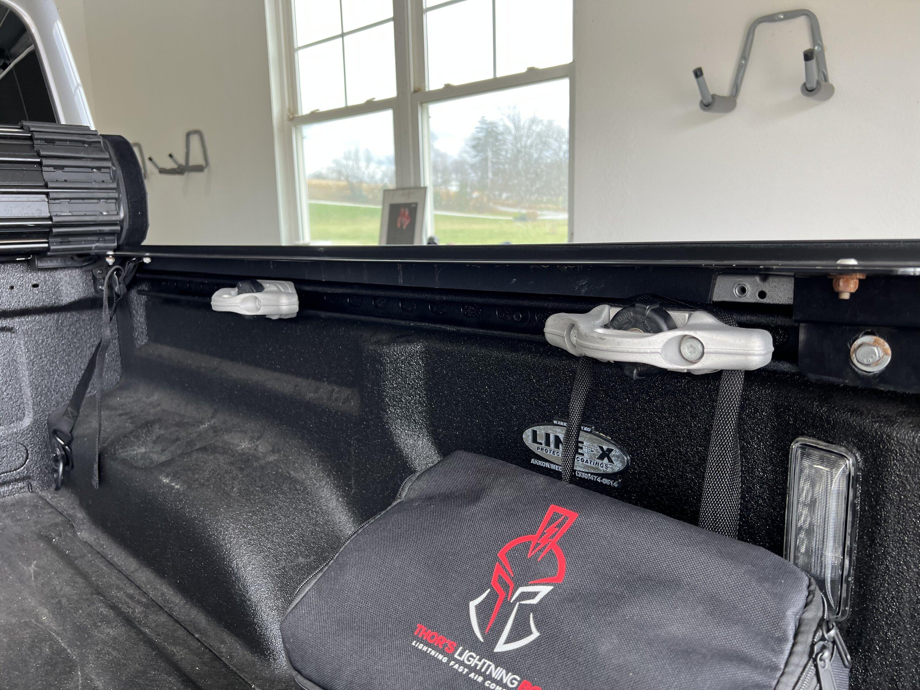

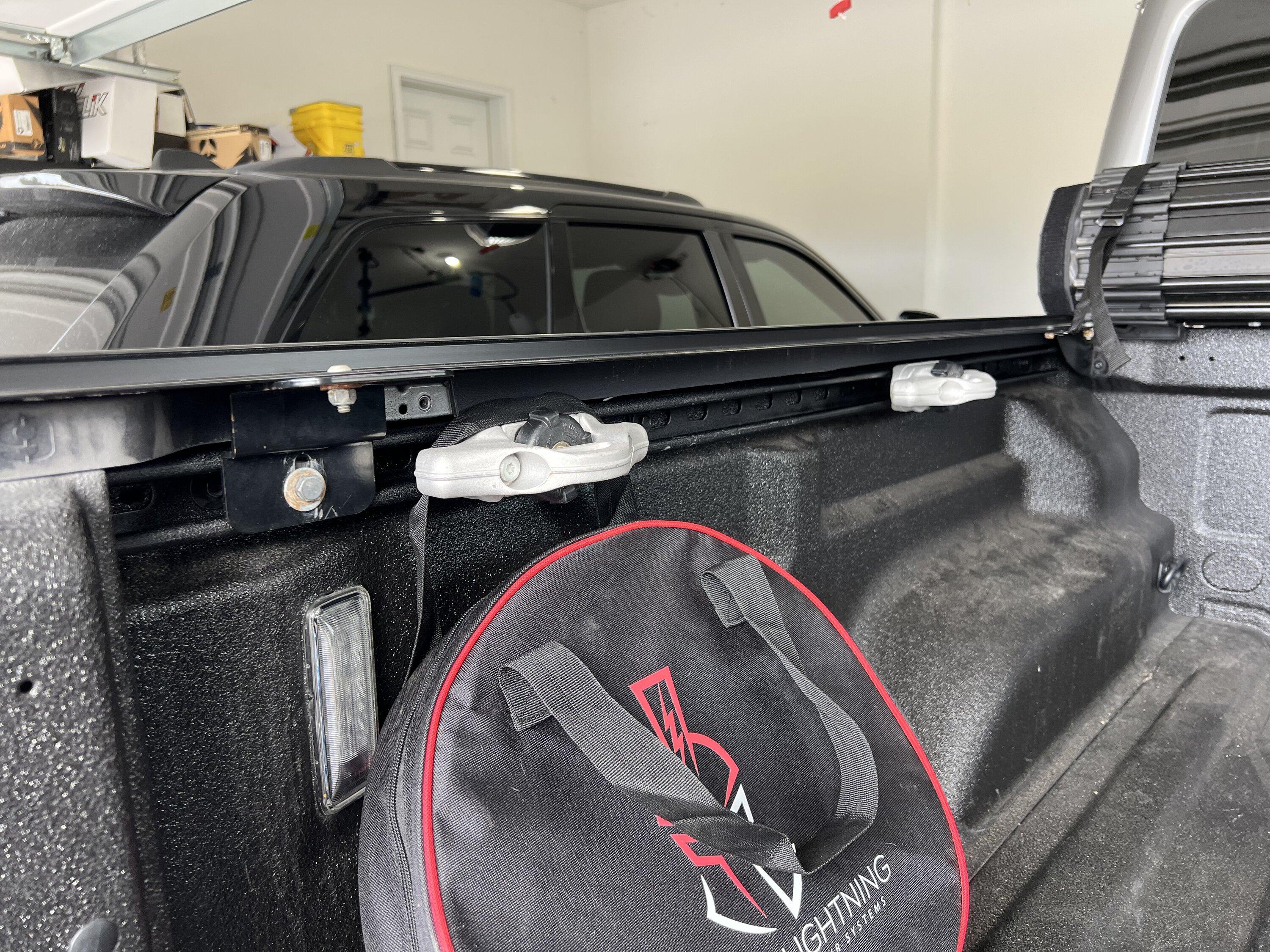

I made my own using strut channel from Home Depot. $32 for the 10ft piece that is cut with an angle grinder and then had powder coated ($40). I did have to clean the bedliner out with an M6 tap but it was quick and easy. I was able to pick up 4x Nissan Frontier tie downs (4 for $85 which is cheap because they are freaking expensive at $50 each retail). So for roughly $150-160 I have my own trail rails. It really only took me about an hour to make them and my tonneau mounts that are designed to work on the Jeep trail rail worked just fine for this.
