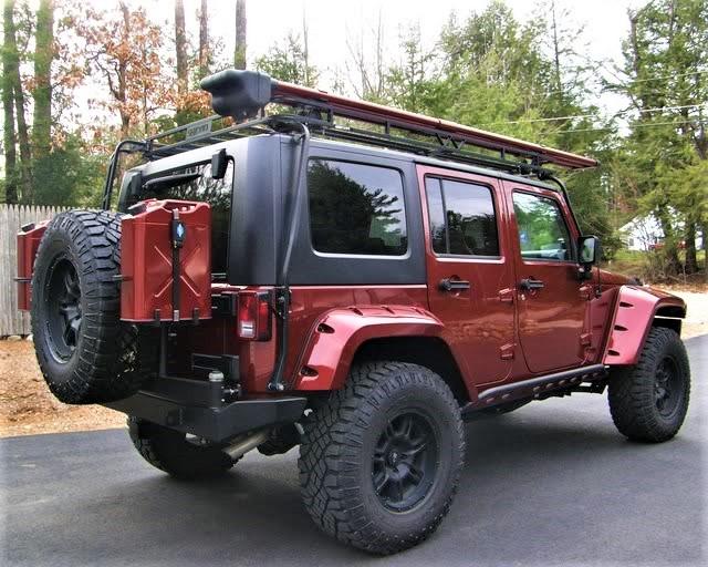

I know I’ve looked at a few in the past, but ideas on the rod holders/tubes?
MikeyK, that rod vault that Padre has on his truck is the same we have been using on our rigs for some time now. They are great. I have the same one going on my gladiator. Thule bought the company so you can find them just about anywhere now. Here is my JK with the same rack.

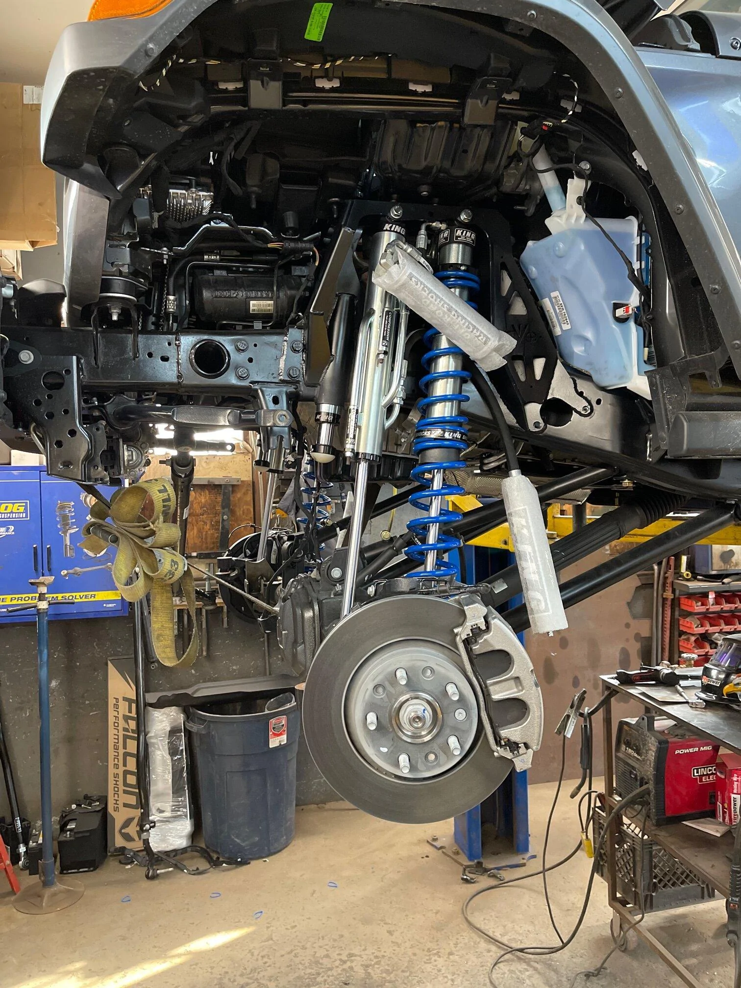

2020 JT Hydro Blue Max Tow

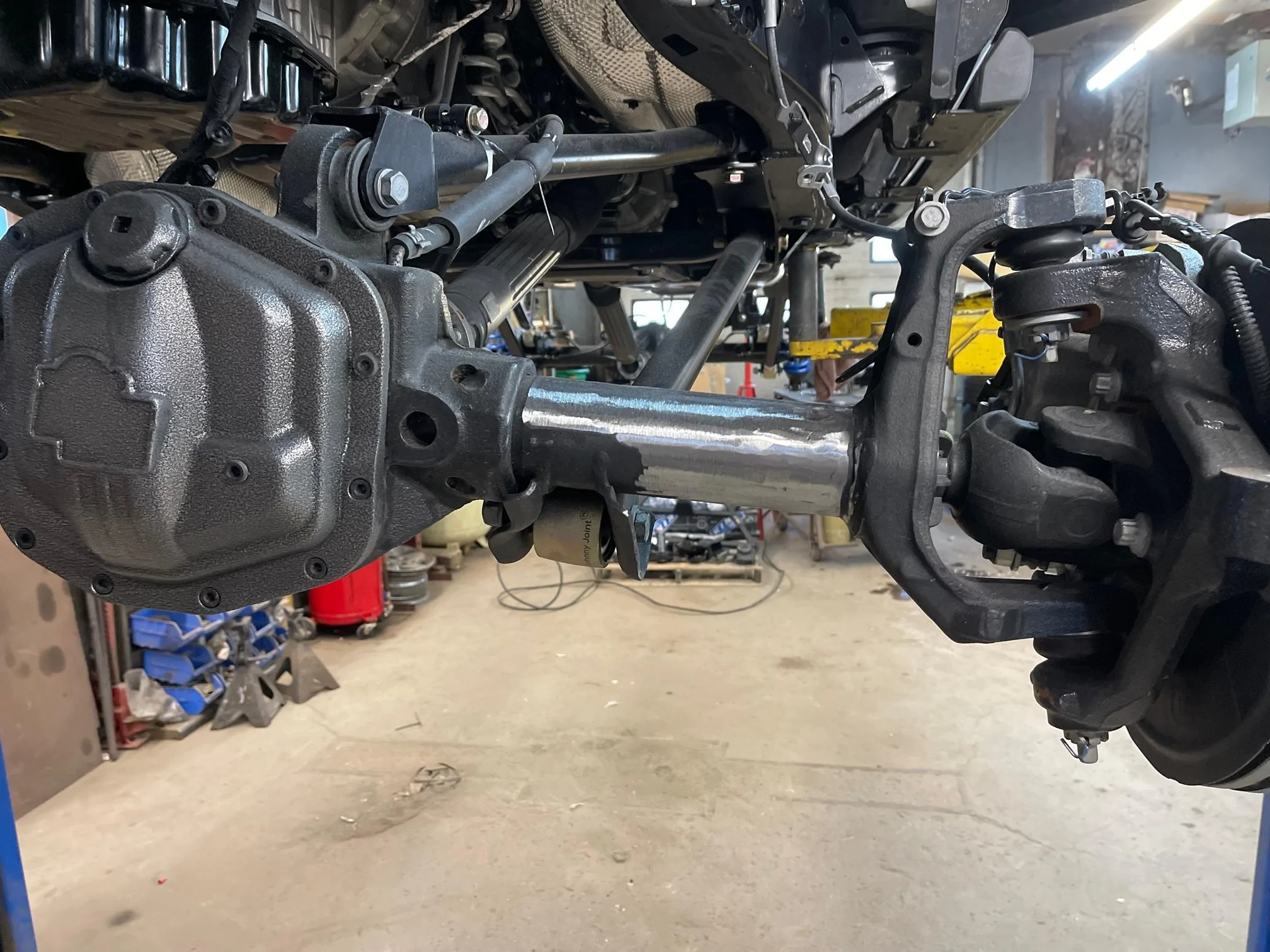

That’s some serious suspension, is the rear spring removed and replaced by the coil over. How are the attachment points reenforced, are those diff covers AEV with the logos removed, look great.

Yes the diff covers are AEV, I am not a big sticker guy. The coil springs are removed with the coil over. Bump stops will be going in where they were. There are new brackets for the mounting, I will try to get some pictures. The lift is adjustable from 2.5-5+ but I think it will be a strong 2.5 The entire existing system is also being cut out of the front. I have been impressed with the whole thing. I hope the ride is as good as it all looks.
Don’t want to get to far off the original topic (overlanding), and I know I can look them up, but are those long enough for us 11 foot 3 weight euro nymphing guys? 😉
Fishing and Jeeps is always on topic with me:) It fits my 10' rods. I think max length is 10.5.

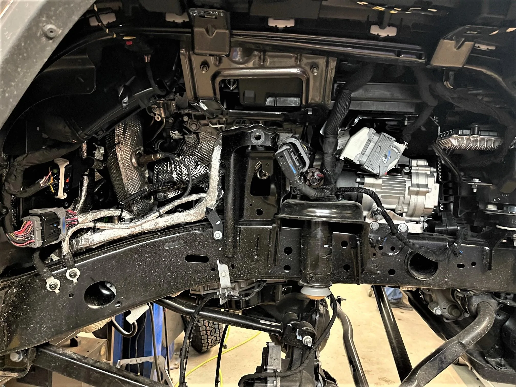

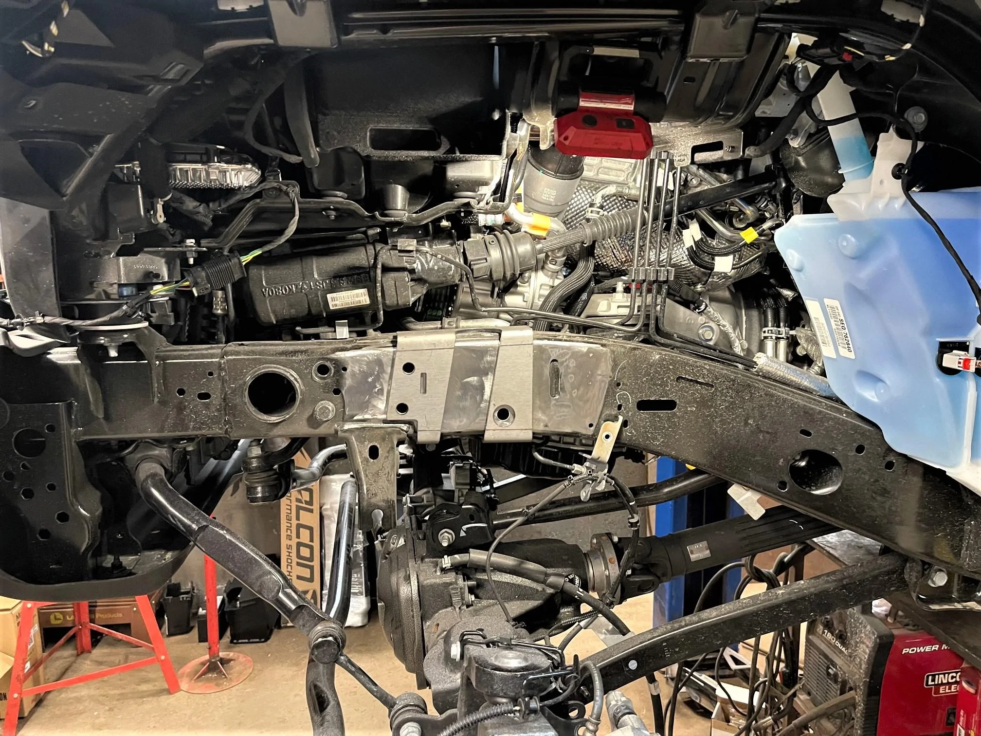

Removed the front suspension for coil over prep.
Jeep Gladiator Trout Safari Overland Expedition Build IMG_0334

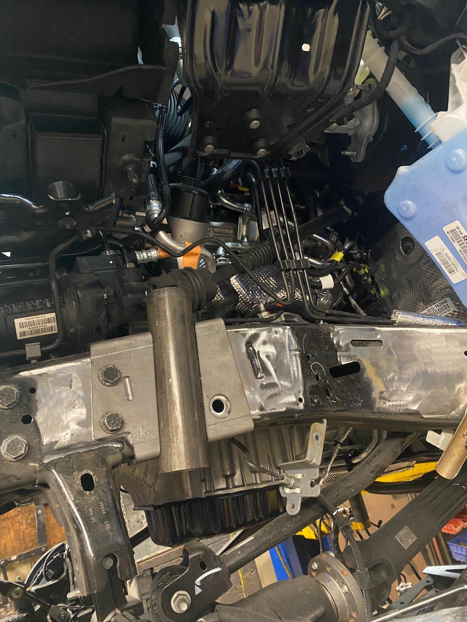

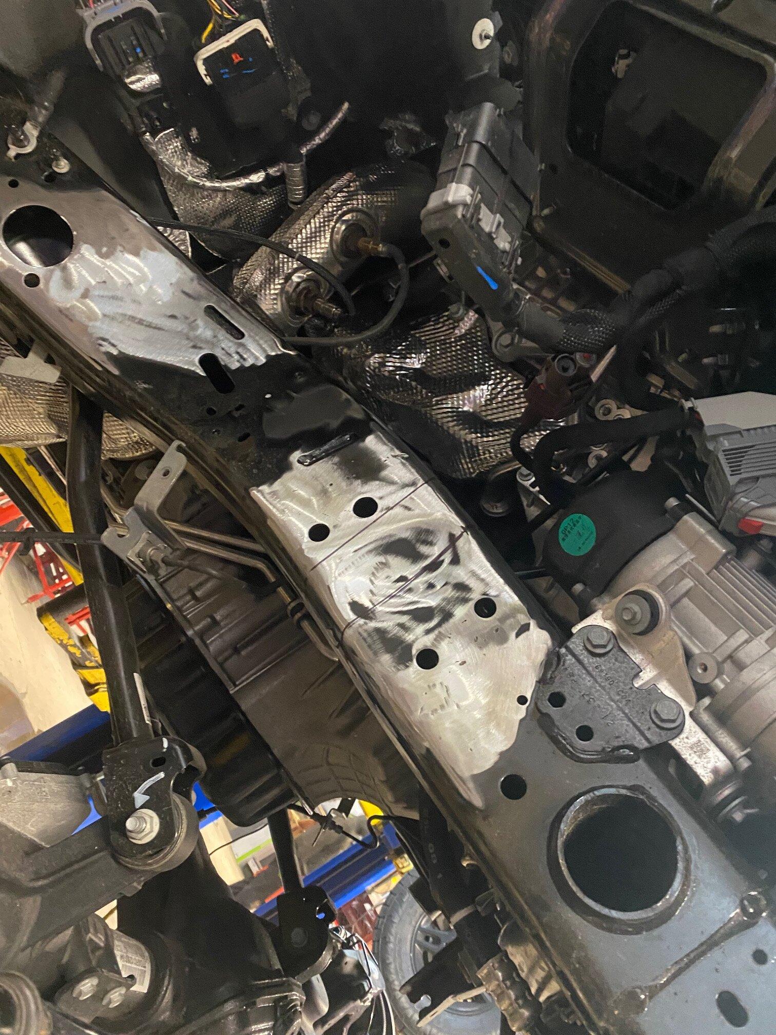

A few fun challenges along the way. A new battery box was installed as the stock one is in the way, and we are going to have to make a change to the air box as that will also need to be eliminated for space for the Brackets. We are adapting bump stops as those also do not have available kits yet. Lots of cutting and grinding, but it will be worth it.

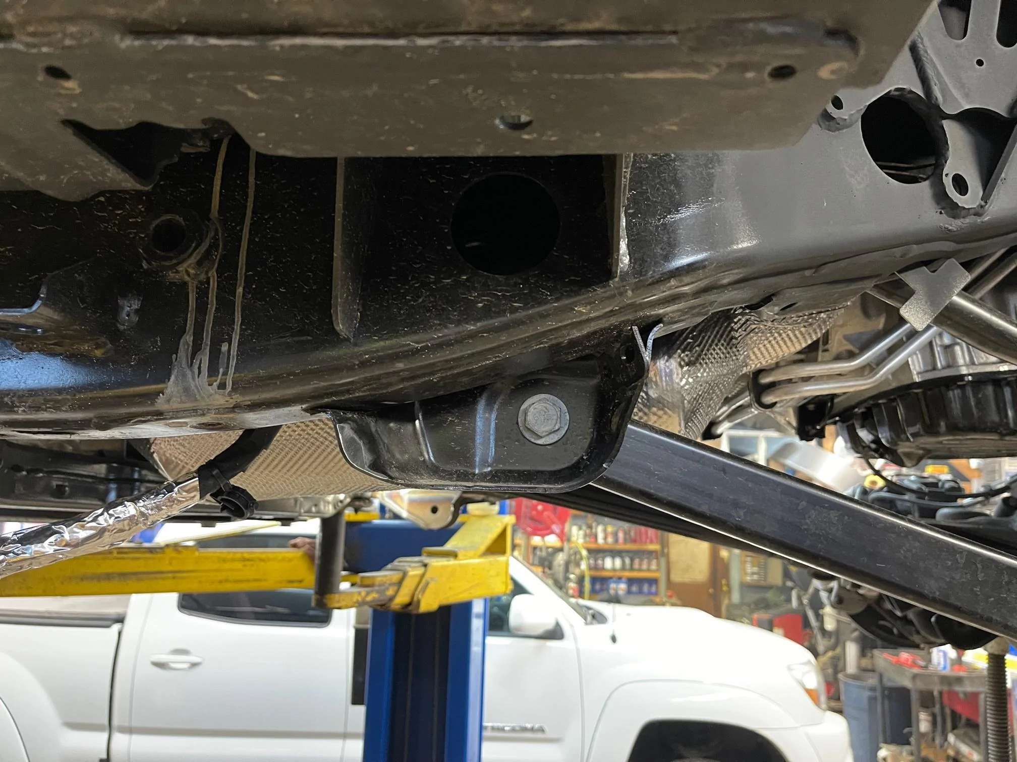

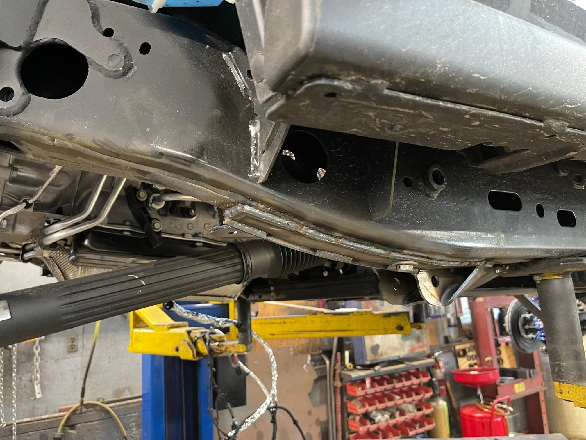

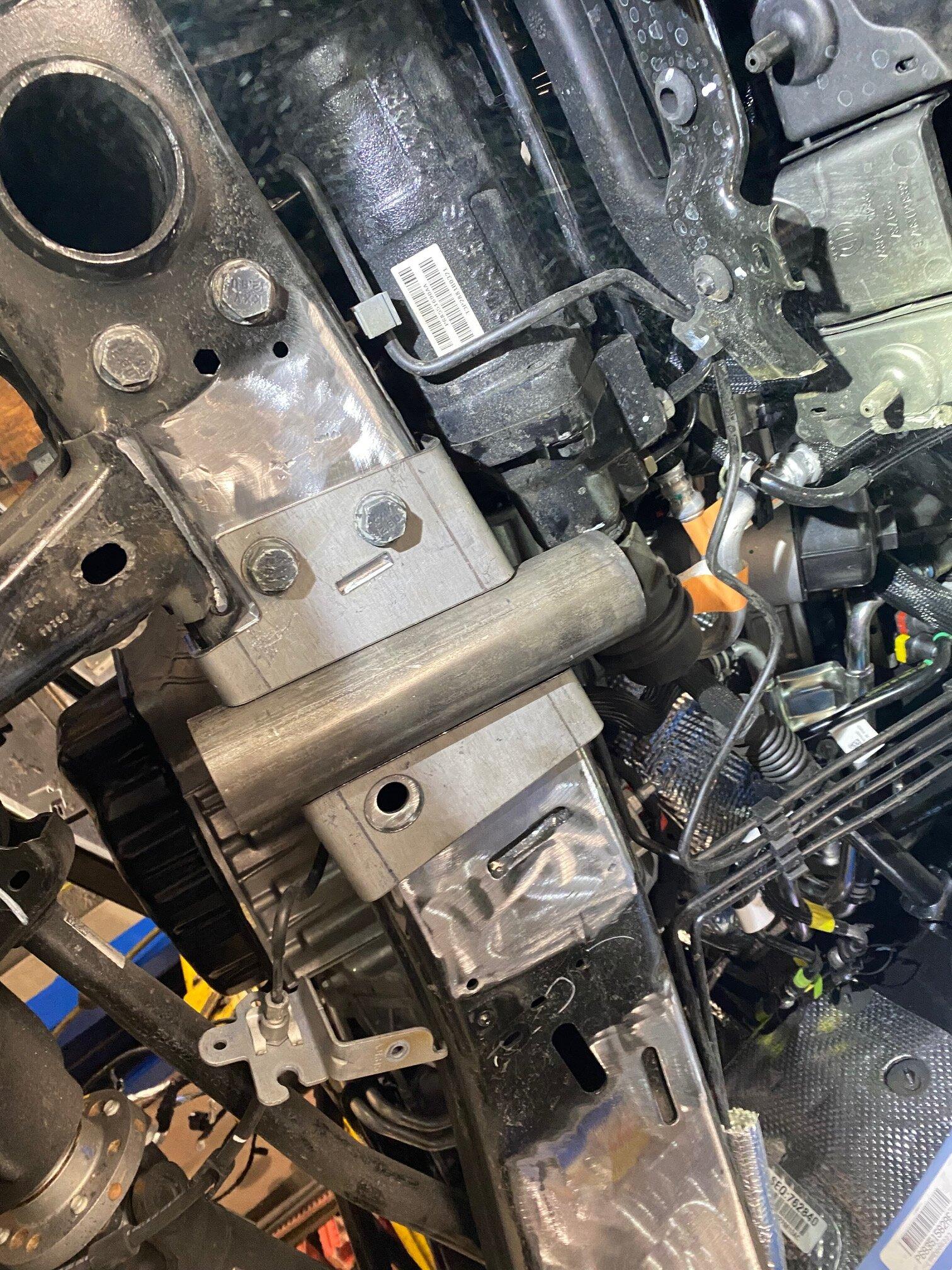

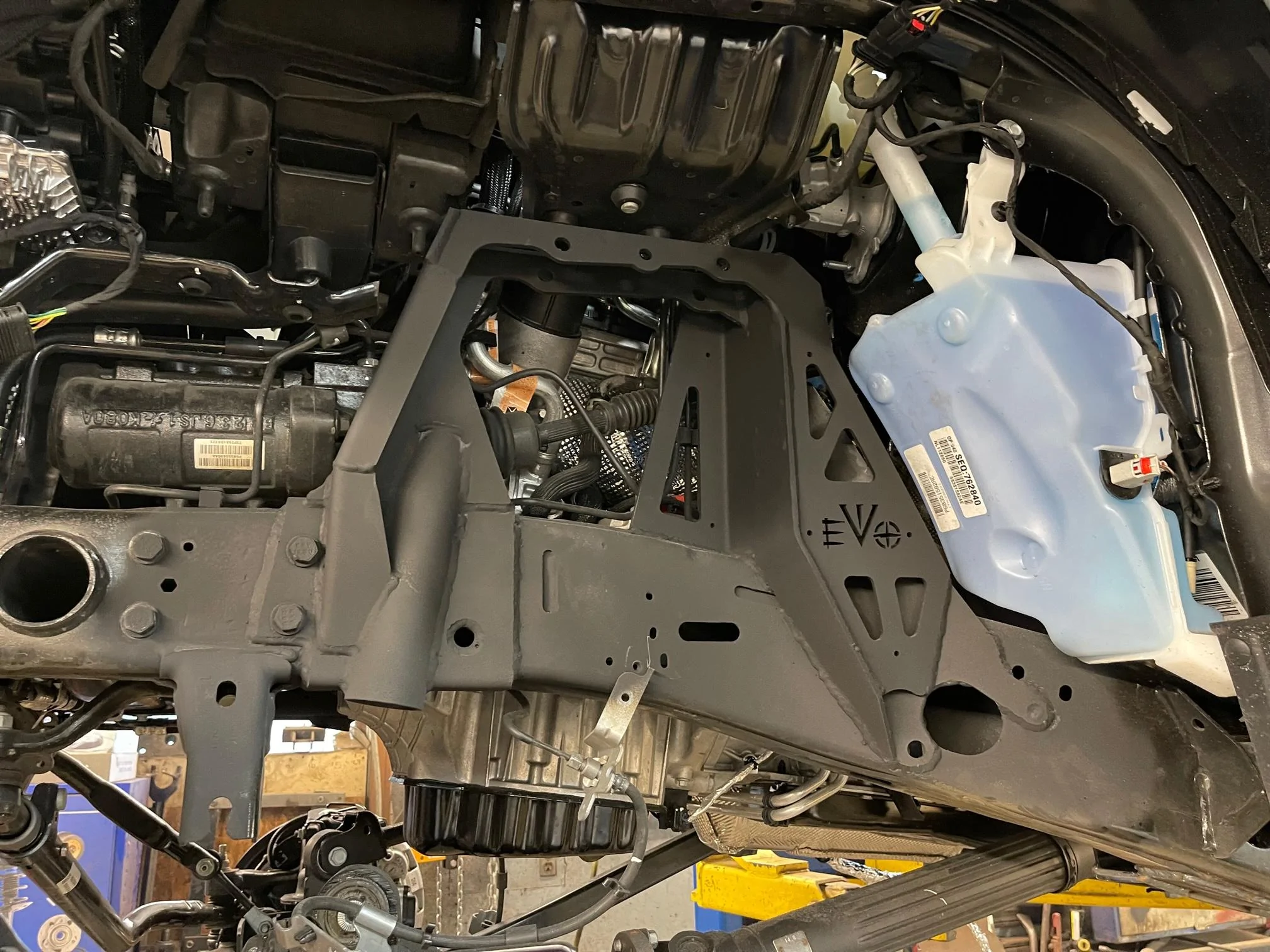

Got the first side coil over suspension brackets welded in, the short arm brackets removed and long arm brackets welded in.
