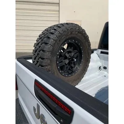

So this has me concerned for the Wilco spare mount I purchased, but yet to install. The angle iron used is similar to the trail tail concept. Only difference is I would have it flush to the bed towards the back, so less leverage. Still concerning. Anyone have a Wilco installed and using it with a 37?
I would think a mount that attaches to the bed rail is multiple times stronger than two screws in sheet metal the OP had.
Spreads the forces out across more mounting points and surface area.
I would agree, but it appears he had a piece of angle iron all the way down the bed if I’m seeing it correctly in the pic.

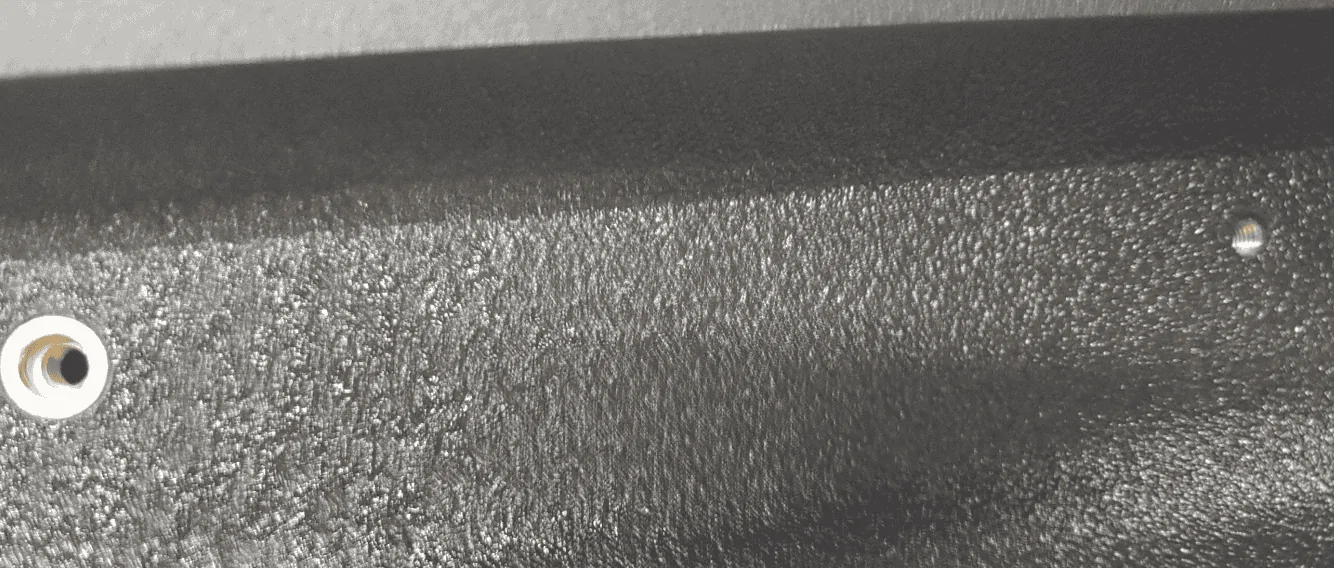

There's a reason I added rivnuts to the walls of my truck when I mounted rails on mine. I wasn't impressed with the few anchor points they provide, not to mention HOW the anchor points are made.
So I drilled and made more attachment points.

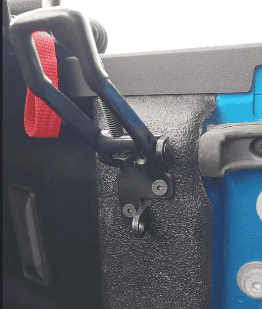

Given that those mounting points are designed to hold bedrails and secure heavy items, I can’t believe they ripped out from a tire sitting there. Doesn’t seem like there would be as much force from that, but what do I know.
But the frame wasn't mounted on the bed rail and only in 2 places.

6mm threaded holes in the sides - and not that many threads, either. Look at the back side - not a lot of support back there. It's not much better than home-installed rivnuts. The only advantage the "trail rails" have is spreading the load over the few tiny holes on the sides - the trail rails are stiff, won't flex a lot so any pull should be spread out at least a little bit. There's still going to be more "pull" or loading at the two fasteners nearest the load because of a certain amount of "ridgidness" to the trail rail.
Take the weight of that big spare and bounce it around a bit - any tiny bit of wiggle and it becomes a slide-hammer, not just a steady 100 pound load.

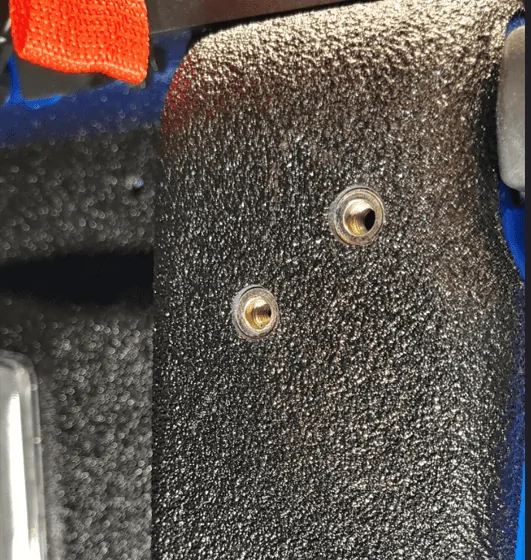

Yeah, something up at the top where there's some meat, the top edge. Even when I had my 70 Chevy that's where I had the spare tire carrier mounted - at the top of the bed rail, then to the floor. Not to the wall of the bed.
Rivnuts or nutserts..........what separates the rookies from the pros.

Nutsert is a trade name, go looking for either and you'll find the same products sold with either name.
I keep an assortment on hand all the time and have used them for my bed cover latches, my own "trail rail" setup, the acrylic brackets for my electric accessories under the hood and more.
You already know how many variations you can get - aluminum, stainless, steel - in different finishes, etc.

Rail mounting -
Mine - left, theirs - right
I just decided I wasn't sure about trusting their few attachment points when adding more, even if only marginal added strength, was worth it if nothing else in making the more narrow rails I used a bit more rigid.
