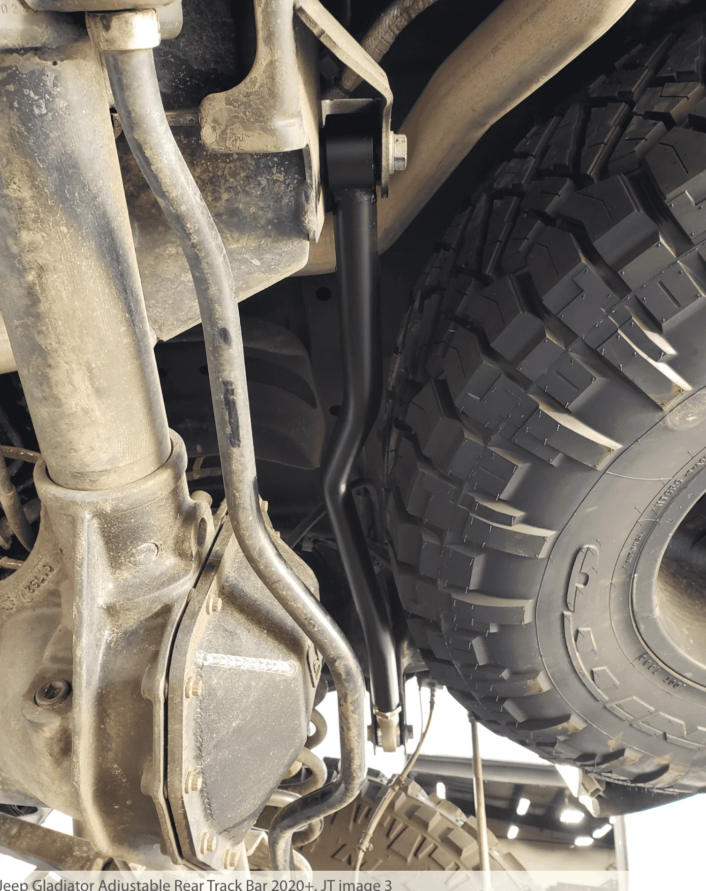

The other solution here (and once bigger than ~37-38", nothing will fit between the frame rails regardless of track bar design) is trail rail of some sort with appropriately sized tiedowns. Factory, Mopar kit, several aftermarket and DIY options. Bare sheet metal on a weight-optimized midsize truck unfortunately isn't the answer. Trail rails spread the load out over a much, much larger area
