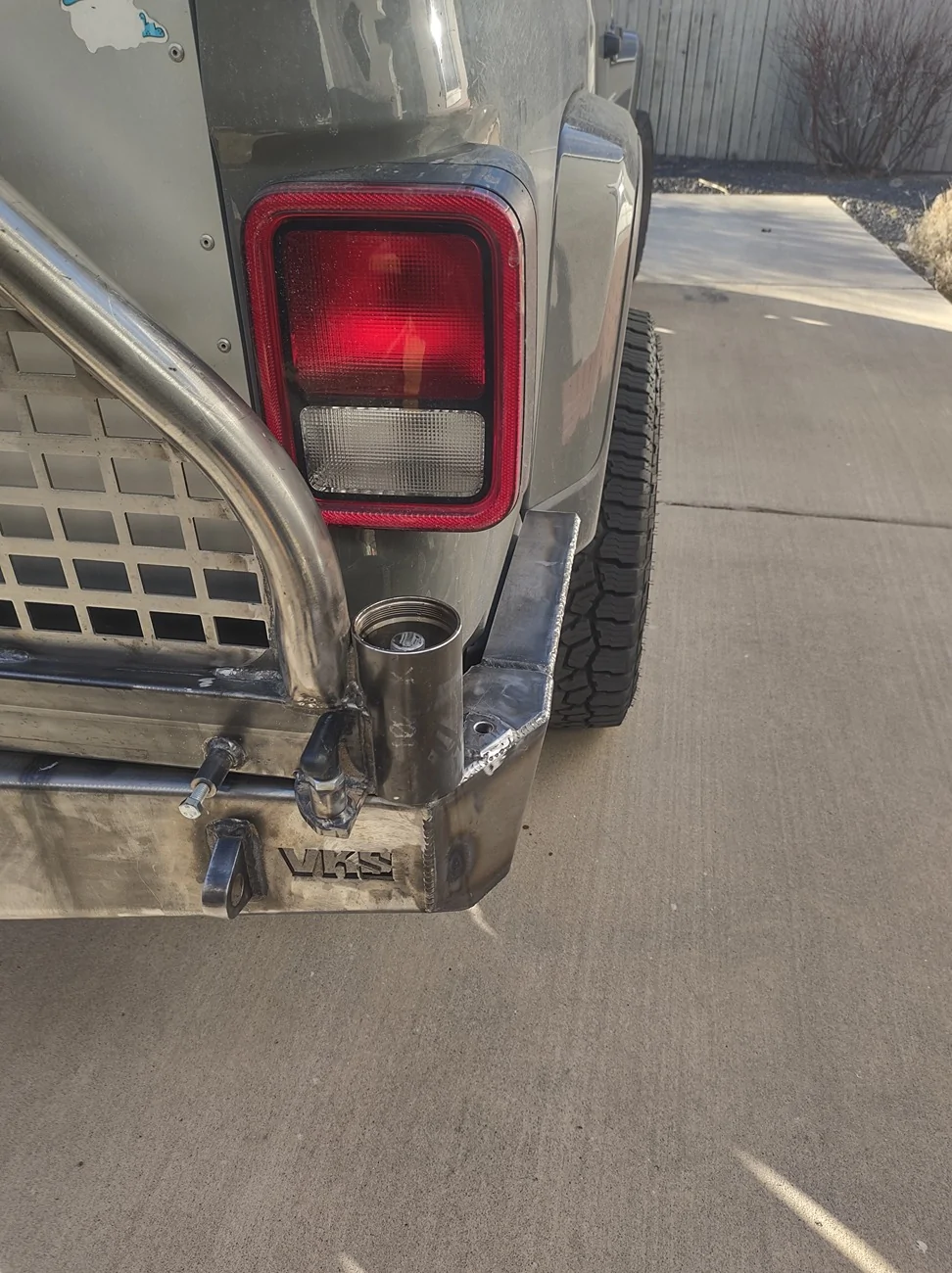

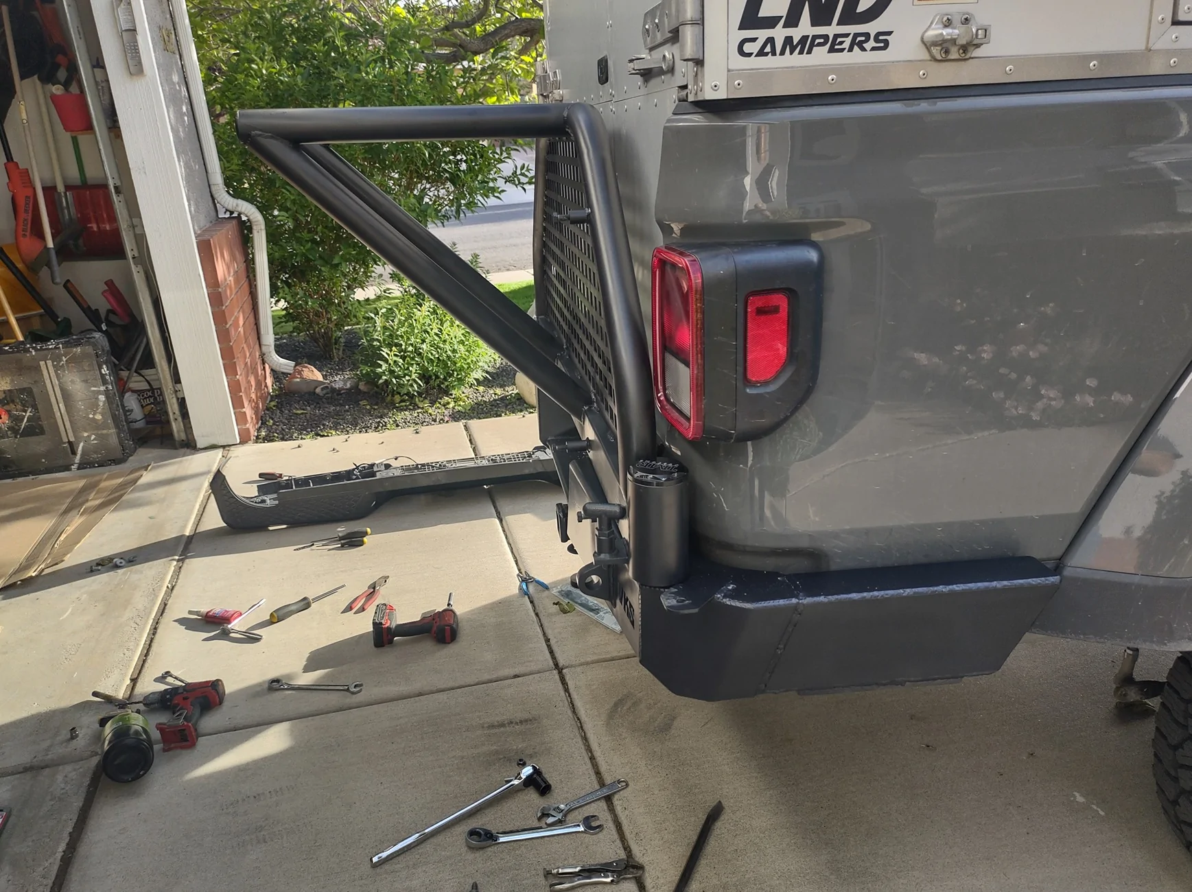

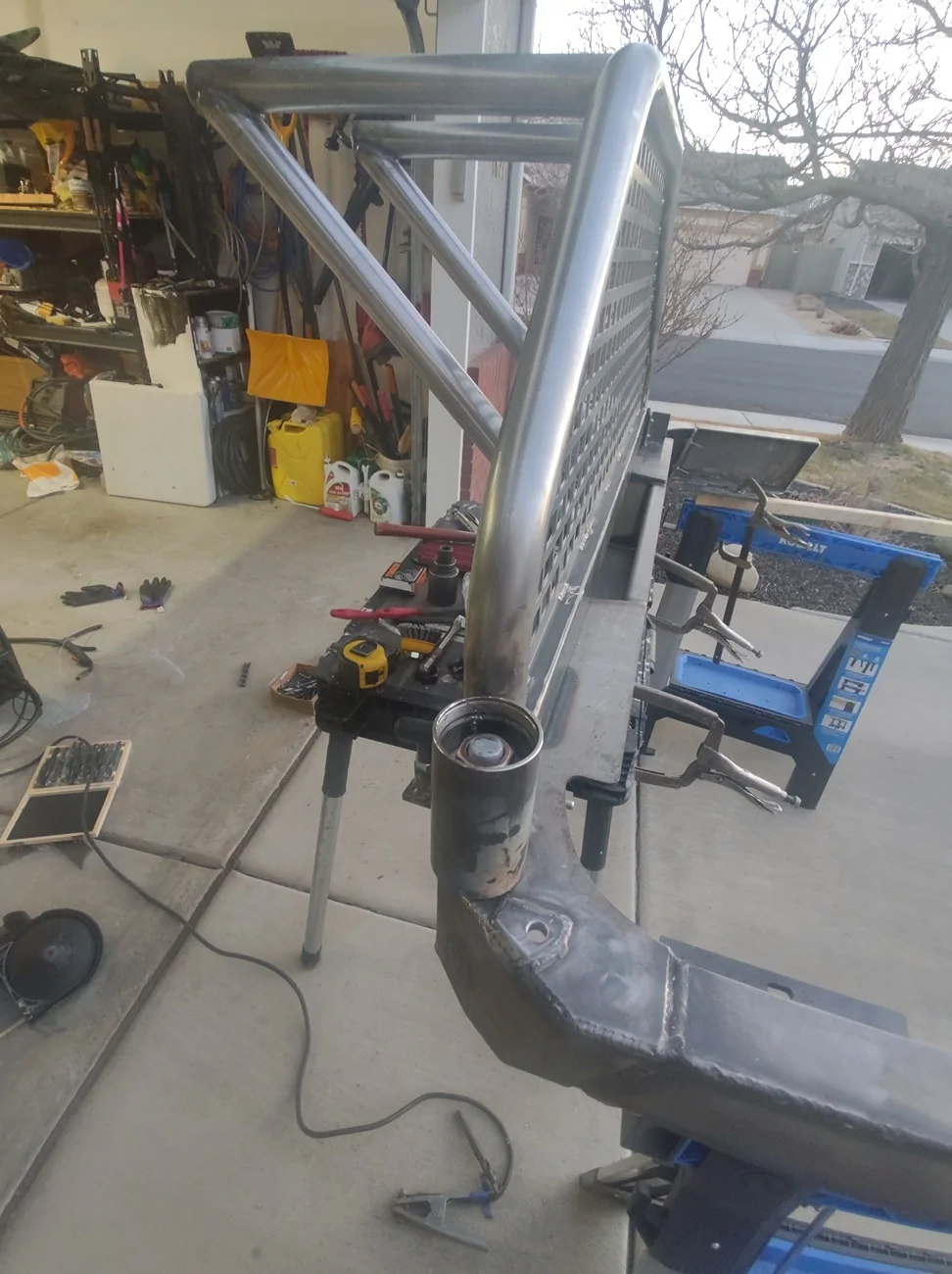

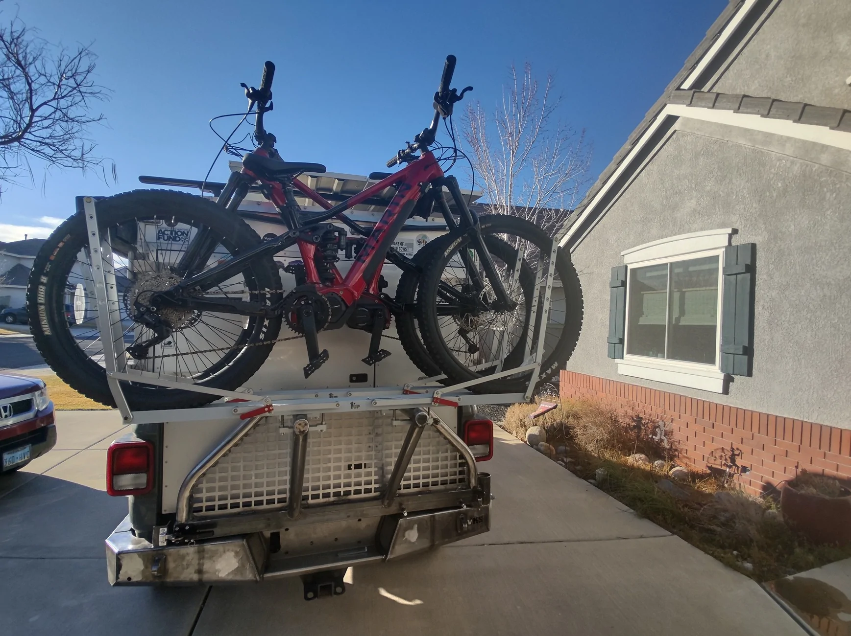

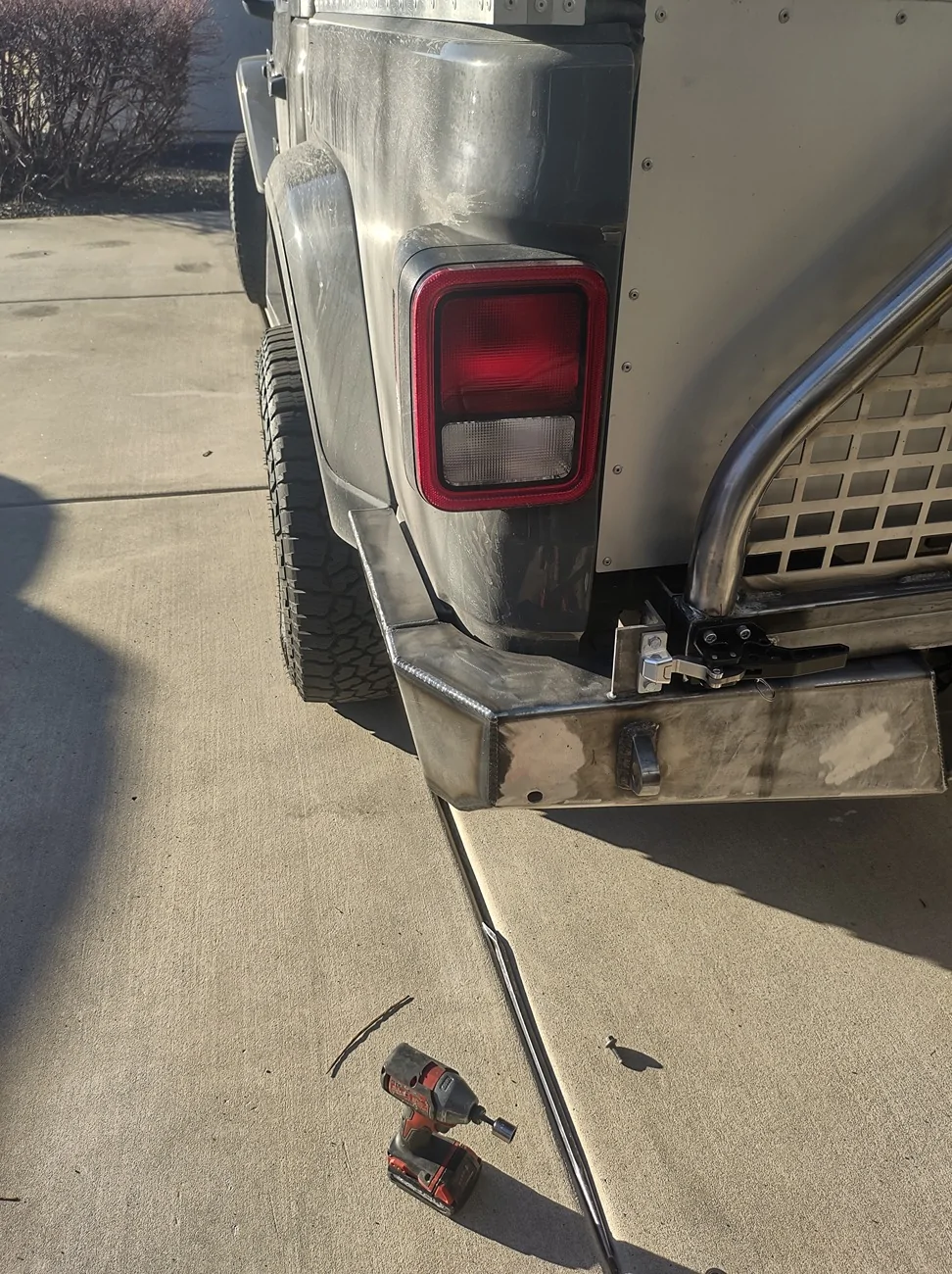

I bought a bumper from VKS fab, the absolute last one ever built. But then modified it for what I needed it to do. I built the wings for quarter panel protection. I believe I used 3/8 plate to tie into the factory brackets that originally held the Rubicon rock sliders. It has a TMR customs mega swing away. I designed and built the swing away with bike rack for the wife and I. Originally I had some flex on the corner, but tied it back into the frame. Pretty rock solid now.
That’s impressive.
