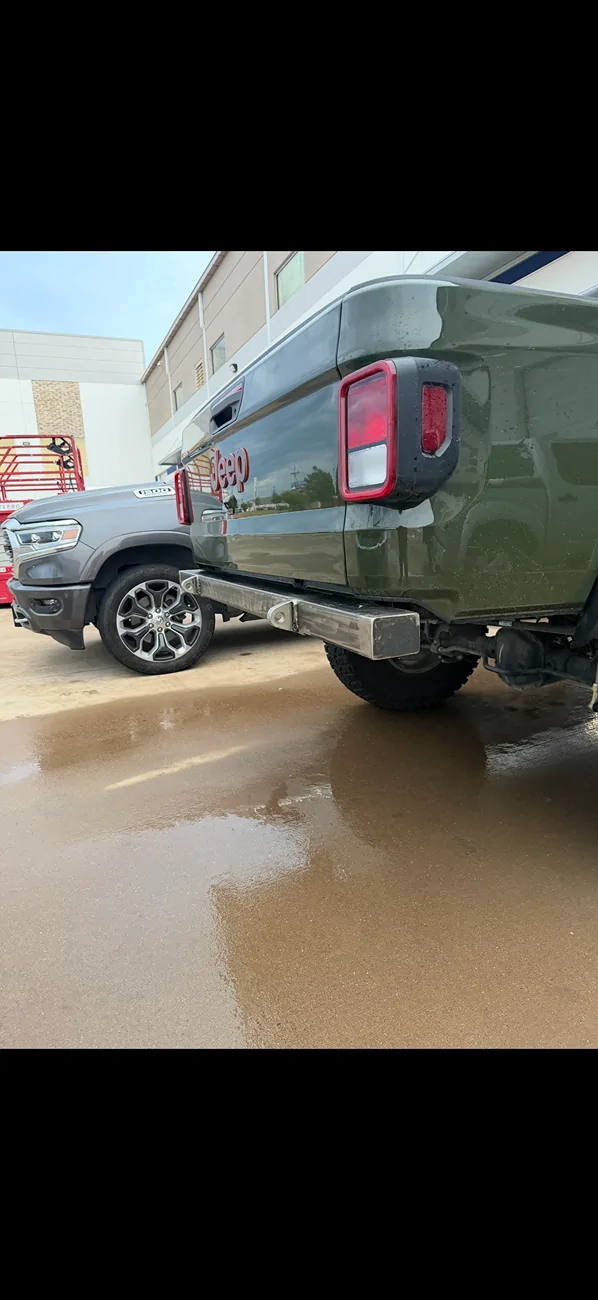

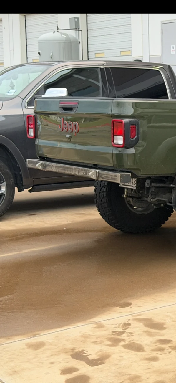

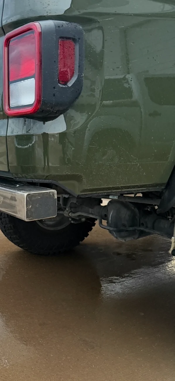

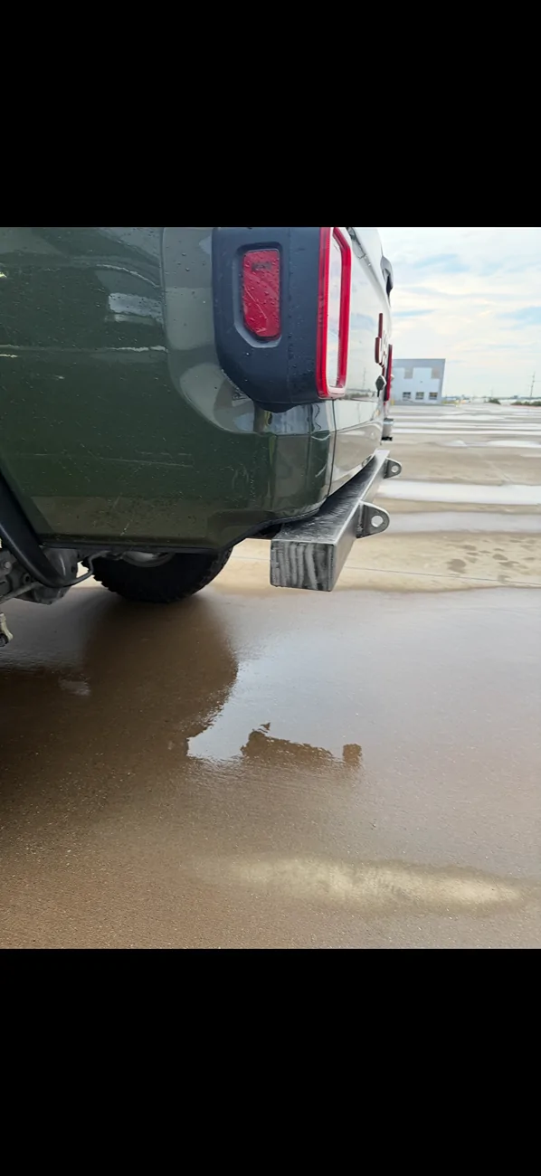

I built my own rear bumper for under$200 in material. Stronger than any mass produced bumper on the market. I can add a hitch receiver easily and have more clearance than any other bumper on the market. I shaved 8" From stock tow bumper
You’re speaking my language. I want simple and strength. But I’m going to use the rubicon sliders as a mounting point. That way I don’t need to figure out a slider wrap around design with my small brain. I love what you did.

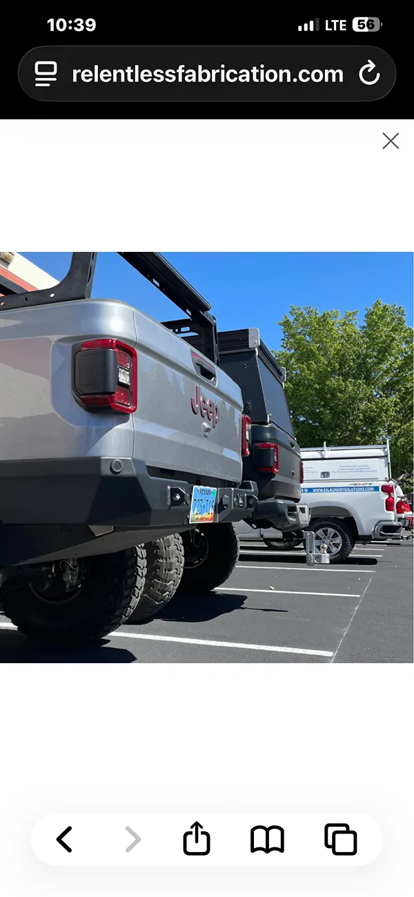

I think you are looking for the perfect bumper with high clearance, no cutting body and a certified hitch , what you need to build is a bumper coming off above the factory hitch then going up on the the sides and it should wrap as one piece around sides, perhaps with pipe loops coming up on sides to protect sheet metal. You will need a good hitch skid no wider then the tow eyes, unless you modify them, you still will struggle with the hitch dragging. I know Relentless does not meet your needs for spare tire, hitch height , and certified receiver, but this pictures shows what you have to over come. I have no doubt Dan will come up with some thing….Jack
That is exactly what I was imagining. Plate can go on the tailgate and it looks like the corner sliders would fit right in there as well. Well done, Sir.
If you look closely you'll see my plate is mounted underneath the bed.
I trimmed that extra 3" off the bottom of the bed. The Rubi side slider's won't work on mine.
I trimmed it high and tight and added some amozom fender trim. Shaving the bottom 3" helps prevent it From getting damaged From coming off rocks
Exactly right, Jack. I love the lines of the relentless. If I could put the spare in the bed, it would be near perfect, if I make one, it’ll never look as good as a professional design, but it might be fun, so why not. Thanks!
