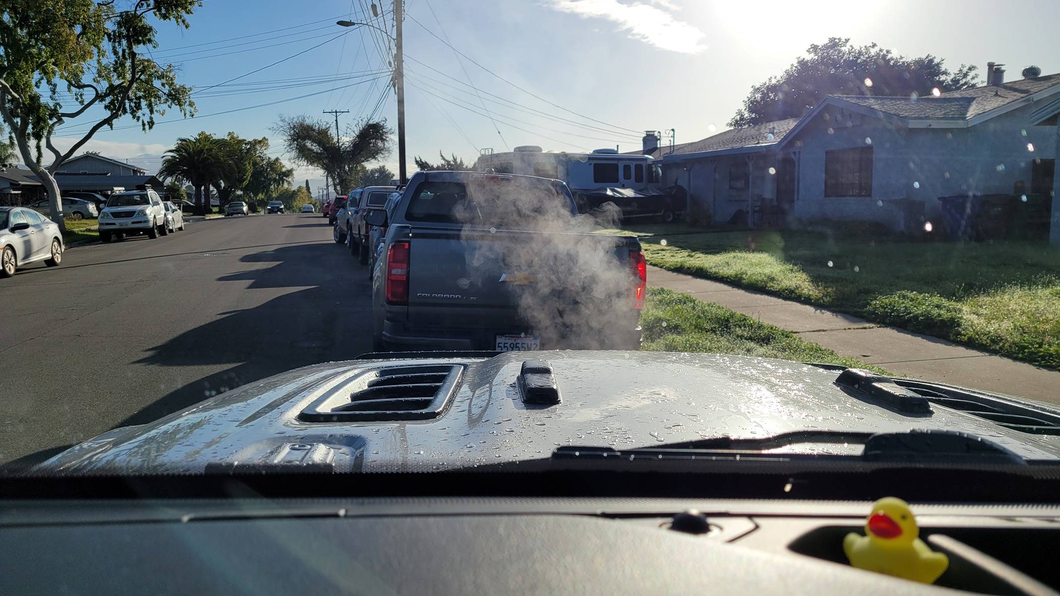

I took my JT into the dealer today for the following issues: P0300 (random misfire), P0303 (cylinder 3 misfire), coolant in oil, "disappearing" coolant, and radiator leak (coolant steam came out of front grille area).
What finally prompted me to set up an appointment was what appeared to be a radiator leak. Here is a picture of what it looked like while I was parked on the side of the street.
Jeep Gladiator Trying to gather info to find commonality on "misfires" 20240304_073957
I drove home immediately. There was a bit of wetness on the transmission cooler (in front of the radiator), but just a faint bit of steam coming out near the middle (not by any hose clamps). waited till things cooled down for a couple hours and started back up. No leak. Drove it for a week until my appointment today. No visible decline in coolant level in the reservoir.
A few days after the radiator leak, the engine light cleared on its own, but I figured the code would be stored. It had previously had the two misfire codes stored. I knew the aux battery was going bad. ESS disabled and charging voltage was always pegged (14.4 volts). I replaced it. The main crank battery was replaced about six months ago. Charging voltage was back down to about 12.7 volts while driving around. ESS worked as normal.
Described everything to the service advisor, who plugged in their scanner. Guess what, no stored codes! She said misfires can occur due to either battery going bad. If bad batteries were the cause of misfires, she said it is likely the stored codes were cleared on its own (after a few run cycles) once I replaced the aux battery. Looking back, that makes sense. The check engine light used to come on shortly after start up on cold mornings, when batteries had drained down overnight.
