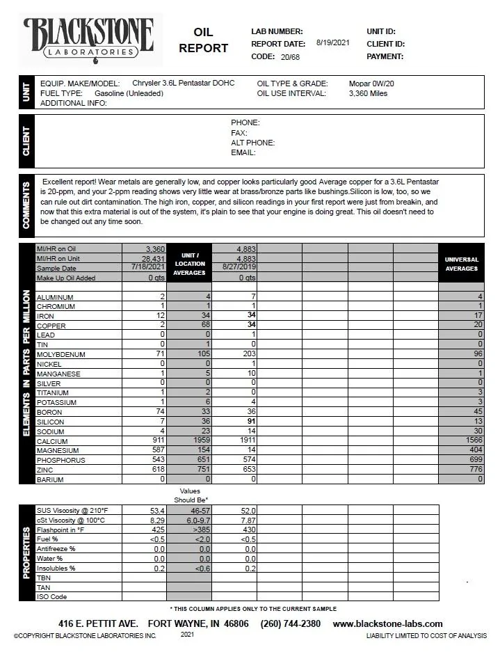

Finally received my Blackstone Labs report. It actually looks pretty good with very low to almost nothing showing for Potassium and Sodium to indicate any coolant leakage.
Since the spark plug change and swapping the fuel injector and coil around, I have had no ESS disable message or any pending P0304 showing on scan data. #4 cylinder cold start misfire count has been lowered but is still higher than what the other cylinders show. So I am still not discounting a possible valve train or head contributing factor but until this migrates beyond only intermittent pending codes and starts posting permanent codes tripping the CIL, I am not going to be picking this scab. Only regret is I wish I had thought of doing a cylinder compression test when I had it tore apart for the spark plug change out.
Only other troubleshooting action I am going to take is pressure test the coolant system. Waiting on an adapter for the coolant fill tank to come in from Amazon to do that. Given the oil analysis, not expecting it to fail.
