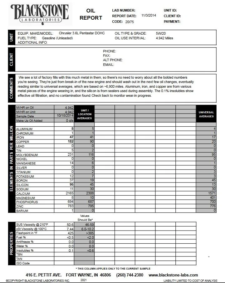

For a reference, here is the first sample I took on my then 2014 Wrangler with the Pentastar 3.6l at 5K miles with 5W/20 factory fill instead of 0W/20. Sodium and Potassium is roughly in the same ballpark and I would assume both were Pennzoil Products used in the factory fill.

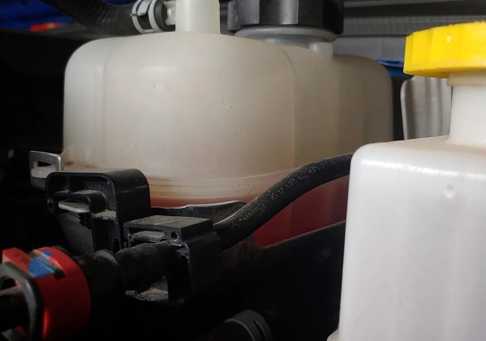

For reference - I keep track of the fluids with photos now - so I can tell exactly what's going on and don't have to "remember" - now, was it just above or just below or in the middle of the line - and when was that?" because it's in the time/date stamp of the photo and the photo shows pretty clearly the exact level.
This is where mine has been since - well, pretty much shortly after I got it. Obviously the dealership has never added any as I look it over before it goes in so I can try to tell what they've touched and if they are checking fluids and such like they claim. The levels of the PS, brake fluid and coolant have been rock solid for months.
I know even ambient temperature changes can make fluid levels look differently - so I try to keep track in my mind that sort of thing, too.
This was checked before I started the truck - it's been sitting since mid-morning yesterday.

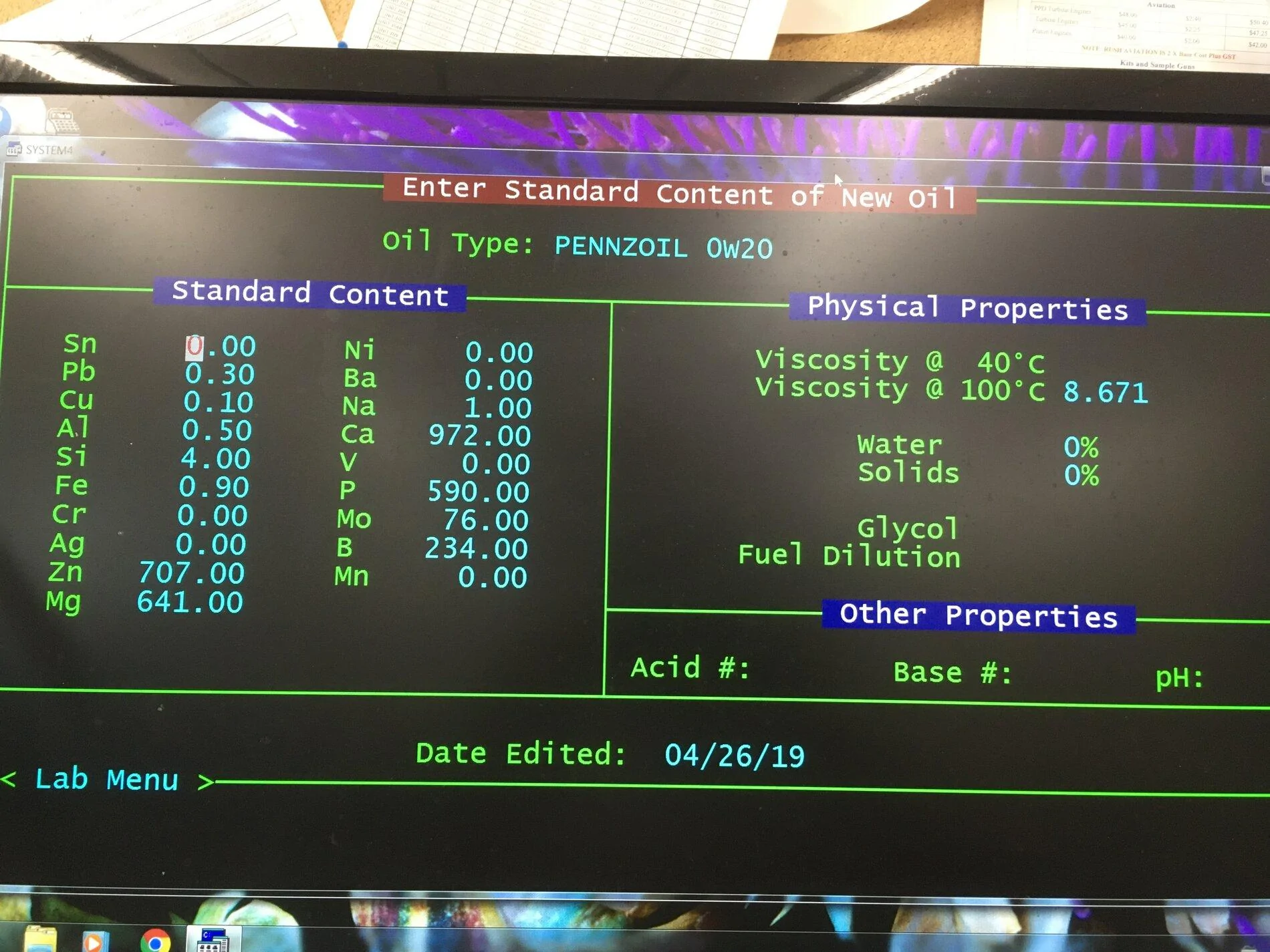

Here we go! Just got out of the meeting with the oil lab tech (Metro Tech Systems Ltd, Petroleum Products Consultants)-Calgary, AB.
The tech’s comments are this: A generic mean average of base numbers is not an accurate reference point to draw any clear cross data. To know exactly what is happening in your own engine is to start a clear reference point from a fresh un contaminated bottle of oil being used in the engine. If the SODIUM starts at “1” from the bottle and a sample is taken 10k later that shows higher numbers in sodium, contamination is getting in either by coolant or salt dust from winter driving. A GLYTEC test is what’s done next to determine, on a colour chart, the concentration of coolant in the oil. This test is done if SODIUM numbers are higher than the fresh reference point free of charge as part of the fee to sample the oil. If after that, more test is needed to determine coolant concentration, a further test is done which costs about $200.
The tech pulled up the fresh Pennzoil 0/20 results done in 2019 and the SODIUM (Na) level is “1”, just like Amsoil. The data is attached. I’m having him run the fresh bottle anyway and I’ll have those numbers tomorrow.
My SODIUM (Na) numbers of 11, 9 and 16 are serious concern backed up by the GLYTEC test.
He said to have a generic acceptable number of 30 is absolutely unacceptable without reason to be so much higher than what comes in the oil.

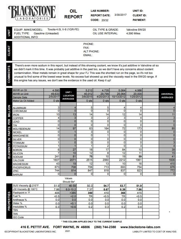

I dug through all my other oil samples and found one where I ued Valvoline conventional 5W/20 on my wifes 2010 FJ cruiser. It had a sodium level of 241 ppm which was not out of the ordinary because up until a couple of years ago, Valvoline used high levels of sodium as a detergent additive in their oil formulations back then. Even found older oil analysis of Valvoline conventional with 350+ ppm.
So, it is not unexpected to see a 30 ppm in a universal average report. Blackstone never claims those universal averages are what you should expect.
Also, when looking at any of my reports over time, I am not brand loyal to any oil brand. I buy whatever is on sale, clearance and deep rebated so each oil analysis of a given vehicle could totally be a different brand oil but is always a current API spec and "usually" with in the recommend grade for the vehicle I run it in. Main things I key in on with any oil analysis is actual wear metals over time and any dramatic spike of both Potassium and Sodium to indicate coolant issue and not so much sodium by itself without a corresponding elevate Potassium level.

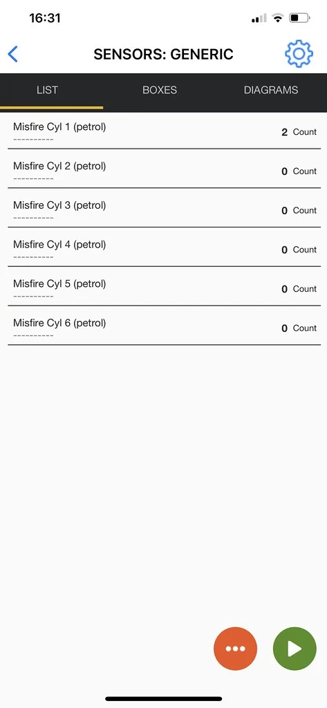

Did some drives with JSCAN and only tripped two misfires. No codes were stored. When I felt the 'surging' sensation, no codes were tripped. So I don't have a correlation to what or how the misfires were created. :(
I am starting to wonder if it's the transmission programming messing with the ECU and pulling timing for a brief second or two. I may try to record a video of the tach and see if it pulses while doing a steady pull and I feel the surging/misfire sensation.
The way I finally got the engine light to finally come on was to stomp on the throttle. I was travelling at highway speeds at the time I stood on the gas peddle.
I had noticed problems at those times and would back off and just take it easy. I finally just decided I was tired of that and just leaned into the problem,… all hell broke loose then, violent shaking, engine light flashing and dinging. I let off the throttle, engine light stopped flashing and stayed on. The truck smoothed out and I drove like grandpa to the dealership and it was the PO302 #2 cylinder misfire. That was the first engine code and injector fix. The second time it happened, I did the same thing on the highway. All the bells and whistles happened again but then the engine light self healed. I knew the tech wouldn’t be able to find a problem so I waited till I was about 10 min away from the dealership, still on the highway coming into town and I stood on the throttle till all hell broke loose again. All the drama started again and the light stayed on for them.

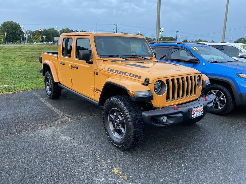

I had enough frustration with the misfire and inability for the dealer to try and resolve. "You have plenty of warranty remaining." - so, I found a Nacho Rubicon discounted $9k with a few more options, so I sold my Mojave to CarMax and I couldn't be happier.
The Rubicon has a March 2021 build date, steel steering box and no misfire sensations. If anything changes, I will report back in this thread.
