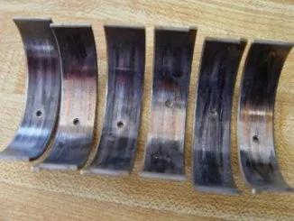

They need to see some of what I can easily look up - instead of me pulling from what I know and trying to get it all down, I'll not re-invent the wheel, I'll copy and paste what others have put together -
As a result, coolant leaks into the crankcase oil. (Antifreeze in Oil )
Acids and precipitants form as the glycol coolant additives and lubricant additives react.
Hence, these insolubles begin to plug the oil filter.
Concurrently, the acids and water disrupt soot dispersancy causing a dumping condition.
More sludge and insolubles form.
By now the filter is plugged with the glycol transformation by-products.
The oil and filter are changed.
Typically around 15 percent of the old oil remains, either in the oil pan or on engine surfaces.
The new oil (with detergents and dispersants) mobilizes the soot and the sludge, carrying it to the filter.
Once again, the filter becomes clogged (even with the coolant leak fixed).
Organic acids will form and can jeopardize bearings and other frictional surfaces.
These bearings should be a nice silvery color -
Jeep Gladiator Trying to gather info to find commonality on "misfires" Engine-Bearing-Damage-326x245
Because glycol breaks down at temperatures over 200 degrees and because engine oil is routinely subjected to those temperatures for extended periods, the actual glycol in the oil may be difficult if not impossible to detect. This suggests that any glycol that is normally in oil when fresh would be broken down and not detected hours later. This further suggests that any glycol found is not what's in the oil when fresh, but is being continuously introduced into the oil during driving. What needs to be tested for is the components that result from the glycol being present and broken down - sodium, silicon, potassium and so on. Those indicate that even if the glycol has broken down and isn't detectible at that point, the side effects of it having been there are proof that it was there.
Any tech that argues otherwise has only searched google and looked at the highlights of the results which suggest glycol is used in pipelines to transport oil - by the time that oil is processed and used in an engine, it should be present in amounts all but impossible to trace and there should be little to no sodium, potassium or silicon found.

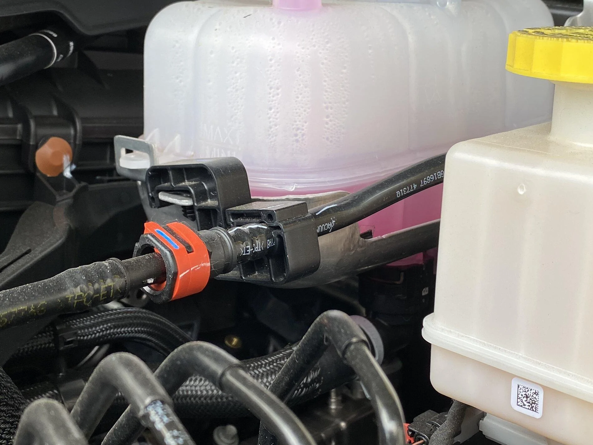

Top the coolant up to the MAX line when engine is cold. It looks like it’s sitting at or below the MIN line
40,504
54,031
I leave it at minimum or a bit over when cold, not over maximum when hot.
If it's sitting in the middle or the minimum line, I leave it.
I want room for expansion.

Wipe the sealing areas with a clean cloth, leave no lint or threads behind. Sometimes I just wipe the sealing areas with a clean finger - that way I can feel if there's any grit that might get embedded in anything. Not anything really scary or life critical -as long as the seal and sealing surface are clean and there's not dirt or grit.
That link looks like the right stuff - 10 year/150,000 mile OAT coolant.

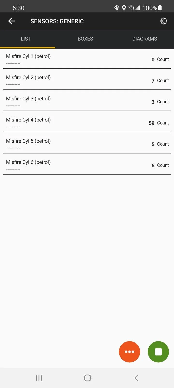

.......................I have had an intermittent once in a blue moon “Start/Stop System Disabled” indication and icon show up on the instrument cluster. Discounted it as a low ESS battery issue and never deep dived it for the longest time because it would go away on next restart. Never had a CIL indication either and never really noticed any performance issues or misfire when driving.
About 2-3 months ago, this “Start/Stop System Disabled” indication would become a now once a week affair. Using JScan as a rudimentary scan tool, I would do an initial scan and there was a pending but never posting P0304 #4 cylinder misfire code. I would then do a PID scan of all 6 cylinders and the #4 cylinder would have a misfire count of 25-65 misfires with the other cylinders either zero or single digits.
The #4 cylinder misfires would only happen on a cold like sitting for 8 hours or more start and would almost never count any higher for my 45 minute commute. For a few week, I would hook up JScan and monitor my misfire count on a cold start and found the #4 cylinder always has a double digit misfire count compared to the other cylinders regardless. “Start/Stop System Disabled” indication only seems to come on when the misfire count gets about 40 count with anything less not setting it.
I know not getting a proper check engine light (CIL) with the P0304 code posting and only a intermittent pending that clears after a couple of restarts, dealing with the dealership service was going to be a donkey show like you are going through. That leads me down the path of usual suspects and getting coolant concerns figured out and hopefully out of the way. If my oil analysis shows nothing to be concerned in regards to coolant, I am coming up on the 30K mile mark here soon and have already bought new spark plugs, intake gaskets and fuel injector o-rings and plan to replace the spark plugs and move both #4 cylinder fuel injector and ignition coil to two different cylinder and see what if anything travels. If nothing travels and seems fixed, call it with the spark plugs. If the moved ignition coil or fuel injector had a misfire on the traveled two cylinder, then call either item to be replaced. If after all that, my issue remains on #4 cylinder, then I am looking at head or valvetrain issues and that will be a dealer visit for warranty and playing that donkey show with them.
As of this writing, still waiting on my oil analysis return from Blackstone which I expect sometime next week.
Only change is this week, I did get another ESS disable message and instead of the P0304 pending I had previously, i had the generic P0300 multiple cylinder misfire but JScan data still showed the majority misfire count on #4 cylinder.

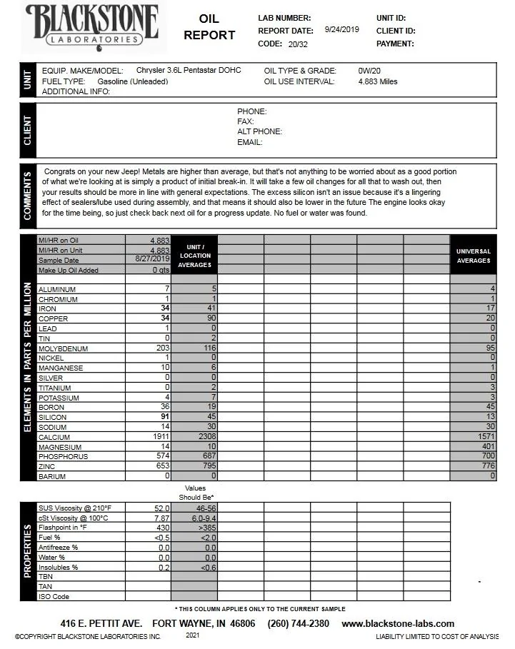

I have attached my original baseline oil analysis for reference I did when the vehicle was at the first oil change around 5K miles and nothing was flagged for the potassium and sodium levels being above expected values. Current analysis I am waiting on from Blackstone was pulled at 28K miles.
Jeep Gladiator Trying to gather info to find commonality on "misfires" Blackston

Had not seen this thread until now but will post here as it seems a more appropriate thread to list and update to on my misfire issue. Original link to discussion is below.
https://www.jeepgladiatorforum.com/forum/threads/3-6l-pentastar-problems.17567/page-2#post-763187
I should also note that my coolant level when I added the mentioned 8oz of coolant was the same as @stew7710 showed in his post.
Interesting seeing a Blackstone sample. On the far right, the column is titled “National Averages” and gives base numbers. These to me are general numbers that for the most part are acceptable?? So they don’t want a sample of the fresh oil you are using and start with those base numbers?
For example, my lab wanted and was supplied a fresh uncontaminated sample of Amsoil to start with those hard base numbers to go off of. The starting point of SODIUM in fresh Amsoil is “1” ppm. So when they saw my first oil change sample @1000kms, the SODIUM level was 11 ppm. The second oil change sample @10k SODIUM was 9 ppm and the 3rd early taken sample SODIUM spiked to 16 ppm. I would guess if I do a regular oil change sample at another 4000kms, the 16ppm would look more like 20-23ppm SODIUM from a clean base number of 1 ppm, shows a big problem is coming. But if I was looking at my numbers doing there thing, and cross checking it with the acceptable NATIONAL AVERAGE, I wouldn’t be alarmed.
You need the base numbers from the oil you’re using to cross check, no??
EDIT- additional info:
My lab highlighted the SODIUM columns in all 3 samples but ALERTED to coolant leak in the last 2 results. To back up their suspicion that I had an internal leak they also ran a separate GLYTEC test to be absolutely certain coolant was in the oil.
The far right column "Universal Averages is amalgamation of "ALL" oil samples that have been submitted against that engine type regardless of brand and oil grade. It is a average and not necessarily a standard of what the oil should be for your particular sample.
Blackstone does not test your submitted sample against a virgin baseline of the oil brand sample one submits but just an indication of what wear metals, chemical by products and oil additive remaining in that sample in addition to checking the weight grade shearing and remaining flashpoint.
https://www.blackstone-labs.com/services/report-explanation/
