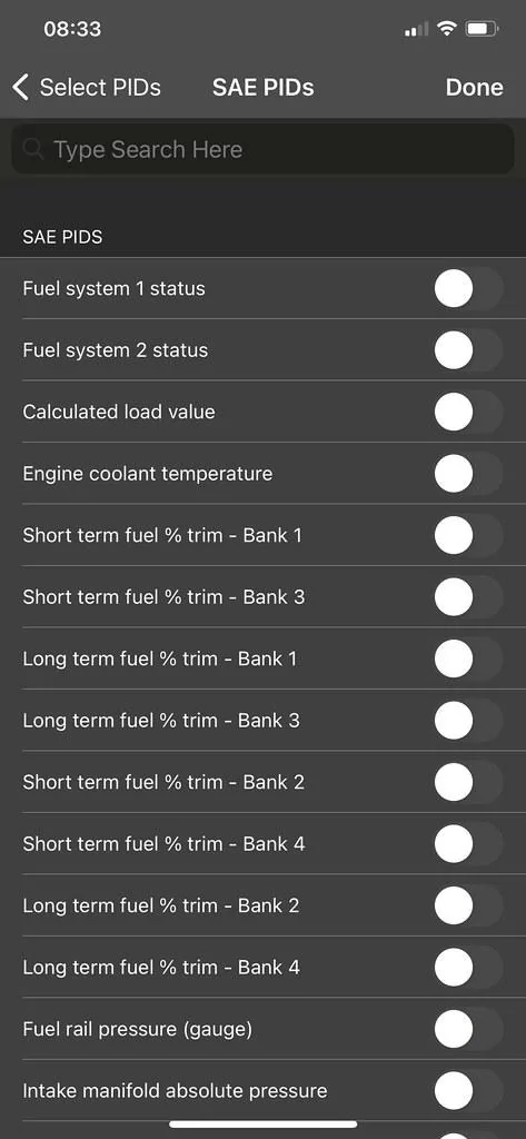

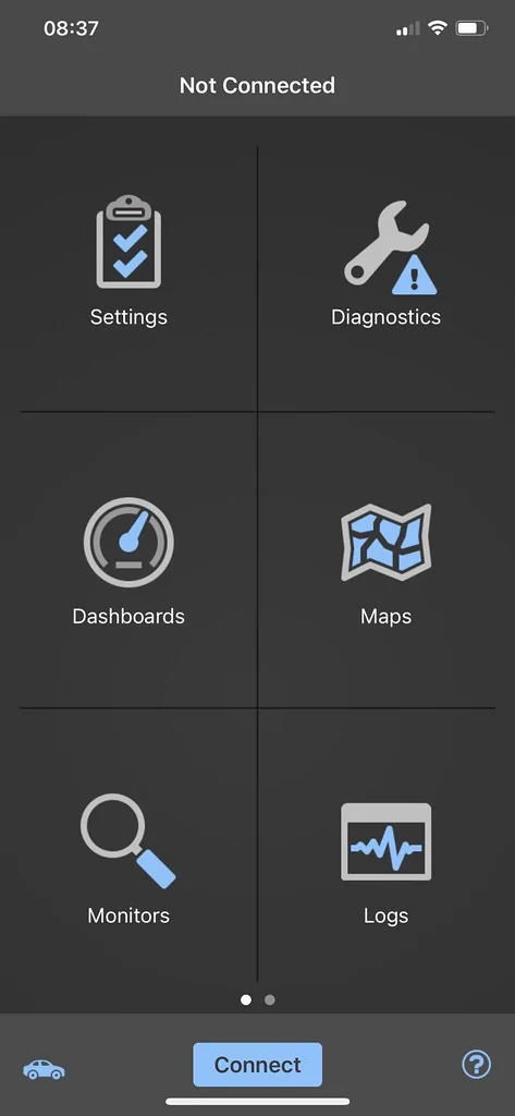

Which items did you select for the Graph items within the OBDLink software? I have it on my phone and did a test drive with the out of the box settings. Now I am trying to find the log to review and see what was captured.
Been a few months - I forgot exactly how I got it but there was a save log checkbox and I seem to have found reference to it elsewhere -
From another forum -
Chose Status/Faults tab.
Click on Read System Status button.
Be sure Save log checkbox is checked.
-----EDIT--------------
Just opened it on my phone again, once you connect you choose an icon near the top right that's TOOLS, looks like a couple of wrenches crossed into an X
Then choose View faults and status log
You need to choose an app to open and view it in.

This is the app I am using: https://apps.apple.com/us/app/obdlink/id879636351
Is this the correct app?
That's OBDLink - it's the free app to use with their bluetooth OBDII device. I have it but have not used it because it wasn't capable of doing what I've been doing. It MAY log errors, I don't know.
I use AlfaOBD - it's what the Ram truck people rave about.
