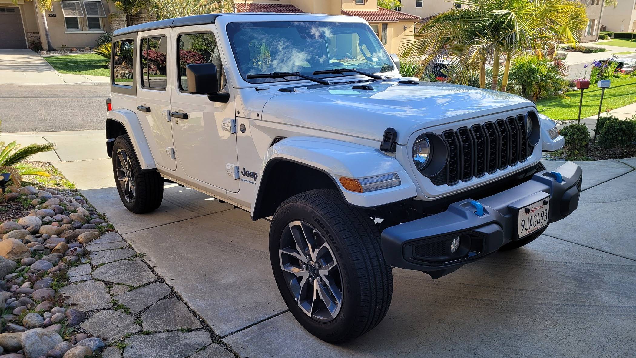

At least they gave me a decent loaner/rental while my JT is in the shop. I suppose they are trying to lure me into trading in or buying another Jeep. Nope, not gonna happen. Nice Wrangler 4XE though.
Jeep Gladiator Trying to gather info to find commonality on "misfires" 20240315_091201
