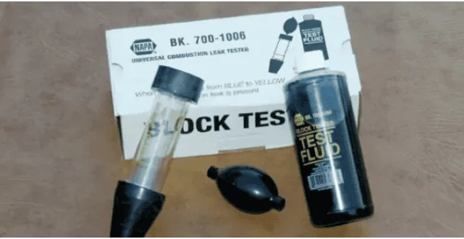

If you can't see a visible leak or signs of an external leak, and there's no tell in the exhaust, about the only way to know if it's an internal issue is with oil samples - and perhaps even the sniff test of the cooling system (I believe someone here did that - a large "dropper" type device with a special fluid pulls air out of the cooling system and if there's traces of combustion gas in the cooling system, the solution changes color - we used to do that a lot, pretty common tool for our shop back then)
Frankly, if I was suspect of actual coolant consumption, I'd do both - oil sample and test for combustion gas in the cooling system.
You can often "borrow" such a tool at a parts store if you pay for the fluid used.
Or you can buy it and own it at many auto parts stores, NAPA is one that has them around here.

My reasoning for using both test methods (sample and gas) is that you can have a leak that produces combustion gases in the cooling system but doesn't necessarily contaminate the oil to the point of sending off an alarm. Some "cracks" or head gasket defects can result in a "leak" where it requires hundreds of pounds of pressure to breach the defect, but the 16 psi of a cooling system doesn't force enough coolant into a chamber to be "tracked" into the oil. A crack around an exhaust valve seat can result in coolant making its way out of the engine, but not in any large quantity into the oil.
AND - you get instant results........ no waiting for a sample.
I still agree an oil sample is wise. There are many ways for coolant to leave a system through the engine.
Both are so easy it's silly to not get things tested.

My start up misfire has went away since I started using a battery tender. I pulled the battery (I am only running one) and tested it and it returned fine, but when I start without keeping it on the battery tender for a couple of days I get a red alert on the dash that I am guessing is low voltage. The dash screen momentarily shows 13.3-13.5 volts then moves up to 14.5-6 as the alternator kicks in, I am guessing.
I have also been trying to figure out where my coolant is going as it appears unrelated to the misfire. I used a combustion gas checker and there was no detection of combustion gas in the coolant system. I have sent an oil sample out to Blackstone and am awaiting a response.
Any thoughts on what else I can look at?
