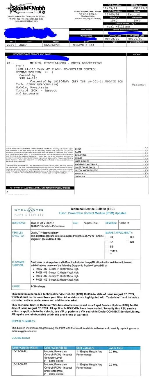

He emailed me the invoice and the TSB, which states:
"This bulletin involves reprogramming the PCM with the latest available software and possibly replacing one or more oxygen sensors."
I wonder why they didn't bother replacing the O2 sensor(s).
Because they were lazy.
