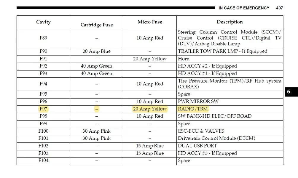

Okay, so I pulled the cable off the neg post and charged the battery. The jeep started and i drove it a few miles and put it back on charge. The display is still rebooting every 15 seconds, guessing that is what discharged the battery. Anybody know if there is a fuse i can pull to disable the display but the AC will still work until the head unit is replaced?

Pull fuse F97 for the radio. Should be a location map under the fuse box cover.
HVAC controls are on another fuse circuit so pulling the F97 fuse should not affect it.

Thank you sir!
I found this earlier. The dealer tech said to pull the radio fuse but provided no location info. First chance, that was the one I found too.
I wonder if the backup Camara will still work, did not test that yet. Hope the radio head unit fixes it, besides this trouble I really like the JT.

I doubt the backup camera will display with the Radio fuse pulled.
