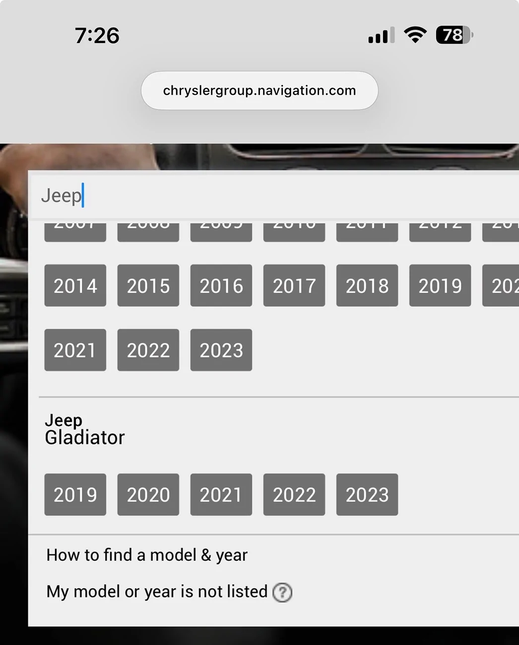

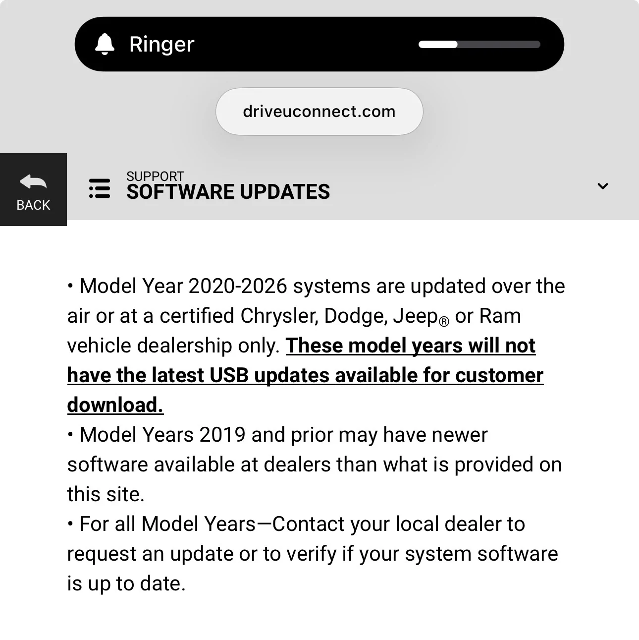

What website were you on? On the Uconnect map update site it only goes to 2023 Gladiators as they went to over-the-air updates after that:
Jeep Gladiator Uconnect Glitching IMG_1641
Where did you find downloadable software for a 2025?
Then for Uconnect system updates they went to OTA after 2020:
Jeep Gladiator Uconnect Glitching IMG_1642
