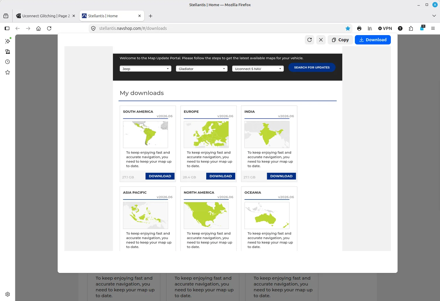

This one:
https://stellantis.navshop.com/#/downloads
I selected Jeep>Gladiator> UConnect 5, and got the following results.
I've not tried to see if the updates would work on this new system. Information came from a cross posting where a guy with a '24 Trailhawk used this to update his system. Maybe Trailhawk is behind the JL & JT?
Looks like this is working. I’m downloading the North America maps on to my thumb drive right now. I’ll be saving the website too. Thanks for your help on this!

So . . . . it did NOT work. At all. Downloaded the files from that site, unzipped them and stuck them on my thumb drive. Went and plugged it in to my JT and nothing . . . . nada, zip. So that was a waste of an hour as it took a while to download 18 GB of maps. Ugh.
My UConnect is still trying to connect to wifi to do the stupid OTA updates. So back to the drawing board.

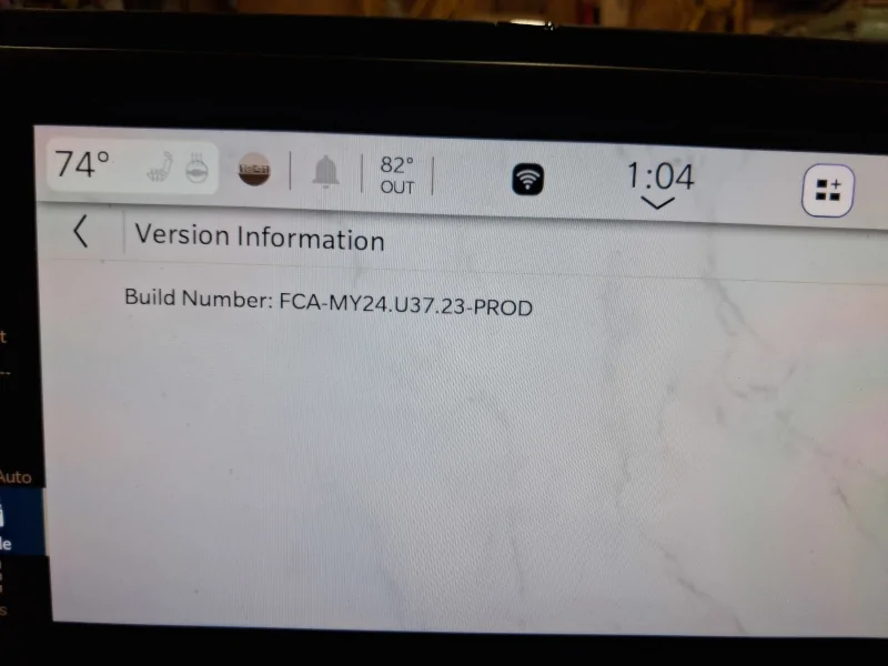

Looks like mine is a slightly older version. So much for their over the air updates that supposed to keep everything peachy. 🤣
Yeah, mine has been connected to home WiFi and connected by cellular and it still hasn’t updated the firmware. I may ask the dealer to update it the next time I am in for service.
Well that's a bummer. Was really hoping it worked for you. Seems like the ota process for map updates doesn't work either.

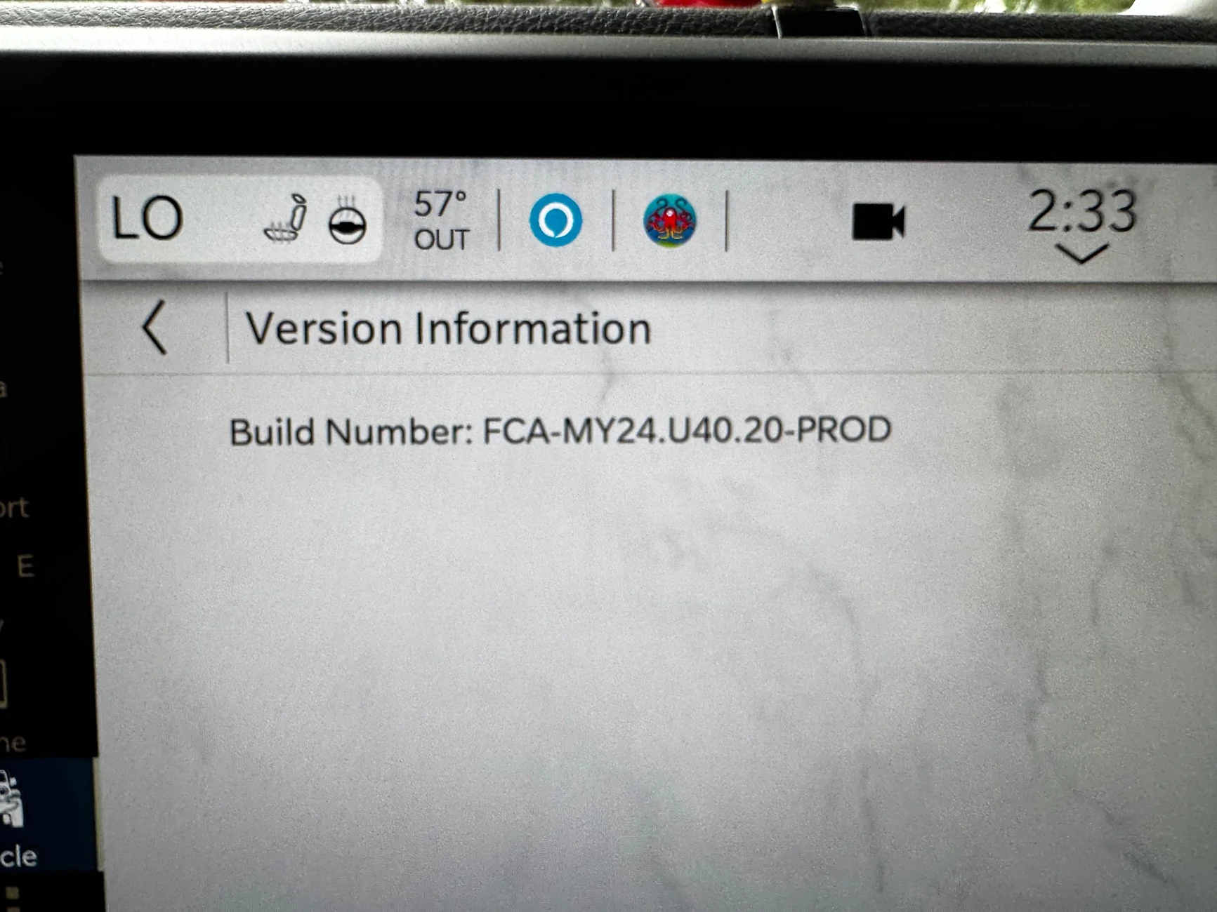

Wonder if this is a physical build # Here is what is in my '25 Rubicon-X.
Both the original radio and the exchange radio are the same build number.
Makes me think this may not be software/firmware related.
Total WAG on my part.
Agreed. It’s stupid them stopping you from using a USB when the OTA updates are so hot and miss.
I don’t need 5 GB of Europe maps, as much as I’d line to drive my JT there I’m not going to.

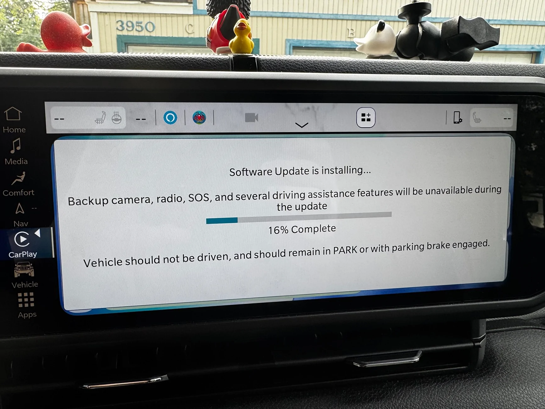

Pulled in to the driveway tonight after driving home and this popped up:
Jeep Gladiator Uconnect Glitching IMG_1781
So we shall see what happens after it’s done installing.

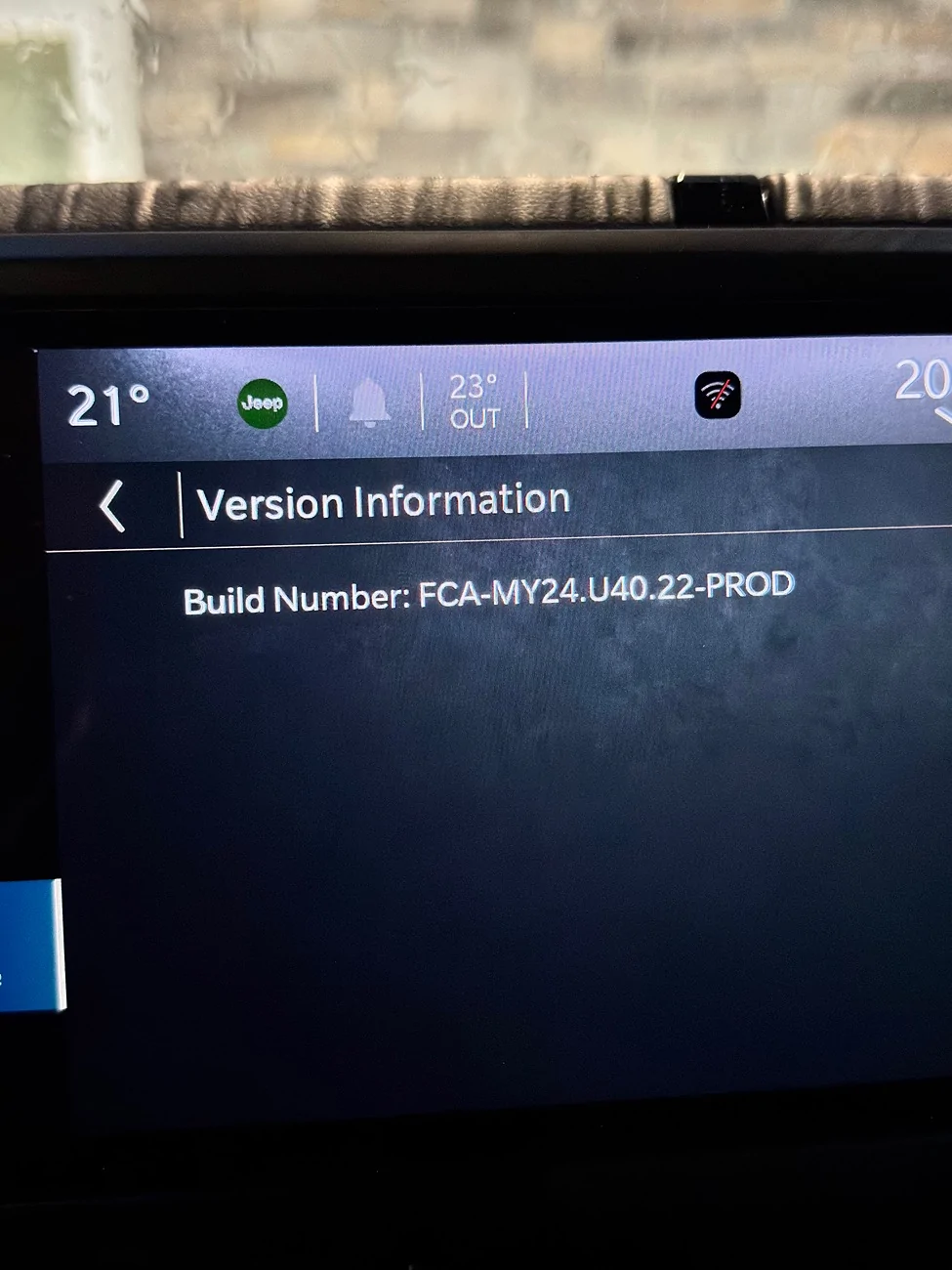

Poked my dealer today while the gladiator was in having its hitch installed. He had the tech check my version and lo and behold- there is an update available that is supposed to fix the resizing and volume glitch.
She goes in Tuesday of next week for the update as it "is dealer only, not going to be pushed out OTA Due to the size)
We shall see.
Currently running FCA-MY24.U40.22-PROD
