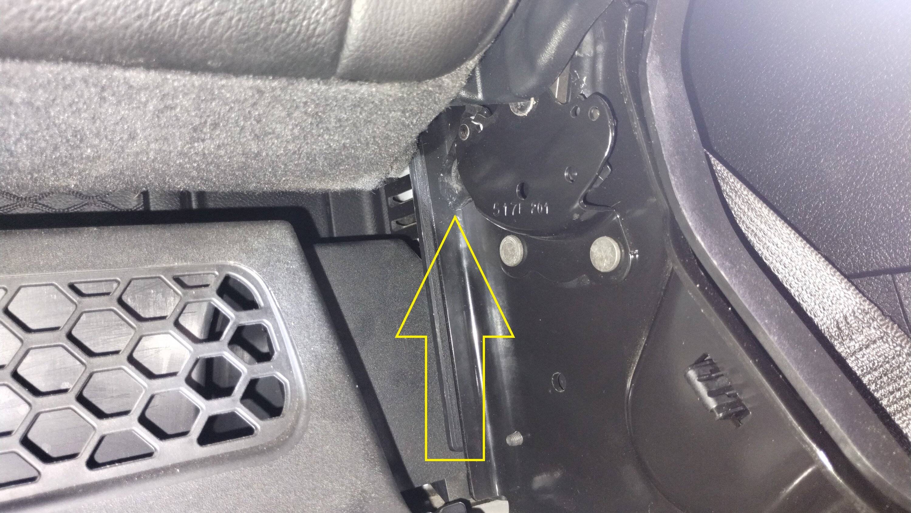

On the inside of the seat hinge (door side of seat), there's this little spring-loaded lever that activates the lock when it moves downward (probably some sort of counter weight):

So, it looks like somewhere around 10-15 degrees when it locks. I'll qualify my photography skills with the fact I am not a photographer. The lock is on the door side hinge of both seats. You have to pry the two plastic cover apart slightly to see the latch/lock:
Yellow arrow is pointing at the bottom of the latch/lock:
You need to insert a small screwdriver or similar and lift up on the latch, seat should lift:
This is GREAT!!

So, I just tested the roll angle for my driver side rear. These are rough estimates working on my bench without the two extra hands I needed. However, for my '21 Mojave, It took about 30 degrees of roll to the passenger side and about 50 degrees to the driver side to lock. As much as I could tell from the benchtop, the seat stays locked until the seat gets back below those angles. Bear in mind, that was a level roll (no pitch). It also appears that in a pitched position (I said 10-15 degrees before but it appears to be closer to 20-ish) the seat bottom will also lock in the up position.
