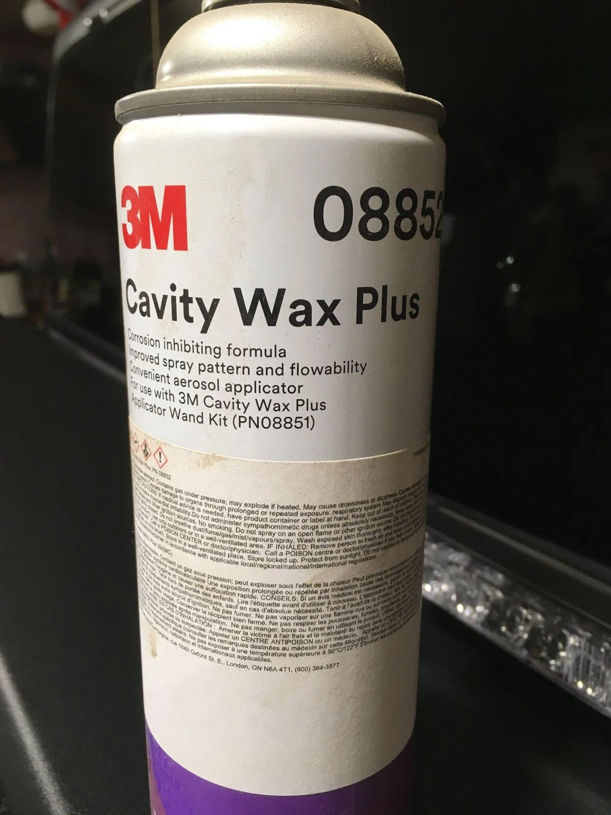

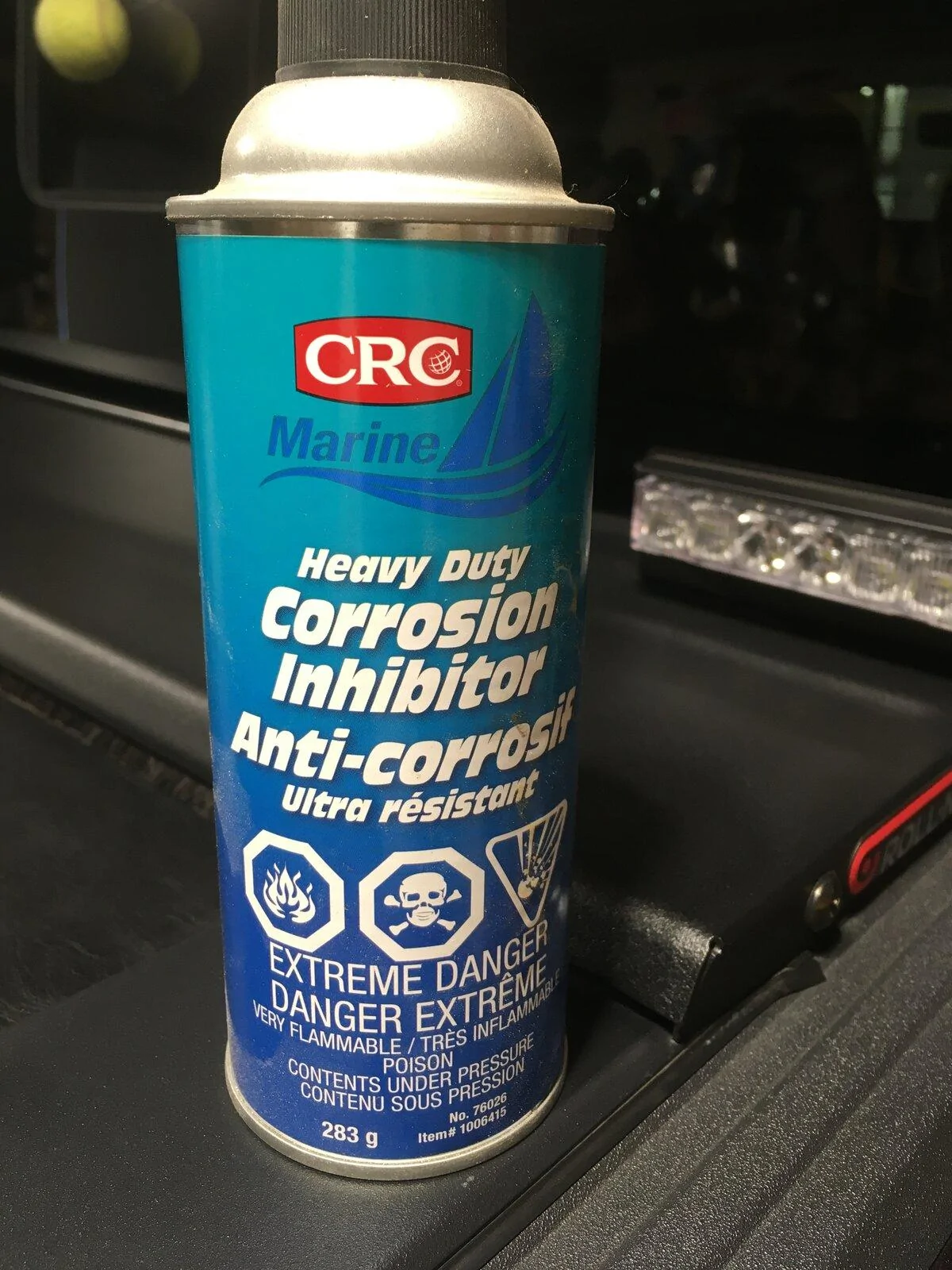

I had my JT undercoated by the dealership new back in February when I picked it up. I then ordered 5 cans on line of 3M Cavity Wax and application wands to do the internal parts of the doors, hood and frame. I also ordered on line CRC MARINE Heavy Duty Corrosion Inhibitor wax spray for all the other parts that couldn’t be undercoated. To date, there is no rust to see.
