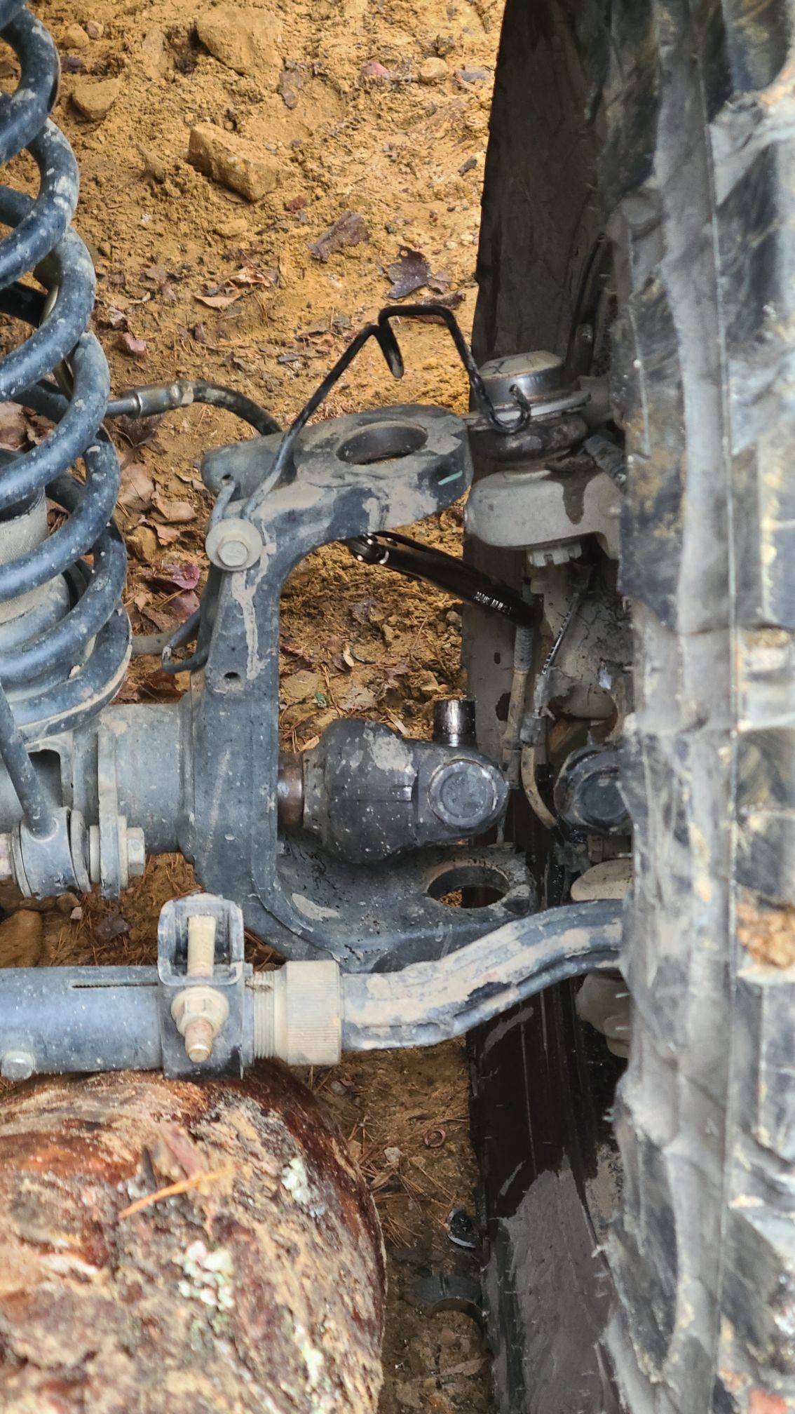

opps, i would bet 5 bucks the ball joint pulled out and then the aluminum knuckle snapped.
Broken u-joint, then ball joints popped out. The knuckle stayed in tact. You can tell that it’s still attached to the tie rod. I’ve done a similar thing to mine, although I was not giving it a bunch of gas. I was just bound up on an undercut rock. The ball joints really aren’t held into the axle very tightly. If doing hard crawling, c-clip ball joints are in order.

... I 2nd the above statement. U-joint popped and then proceeded to un-install his ball joints. Yes, a nuance of the current JL and JT, but IMO total driver error.

I’ll own mine. I continued to try to drive it after breaking the u-joint. That’s when it pressed the ball joints out. Won’t do that again. I gained the experience of ball joint replacement on the trail though, so that’s positive.

We’re only seeing the part Of the video with the equipment failure but it wouldn’t surprise me if that driver had made a few attempts and realized he had to get a certain amount of momentum to make it all the way up. Unfortunately the momentum put too much pressure on the ball joint and it gave way.
