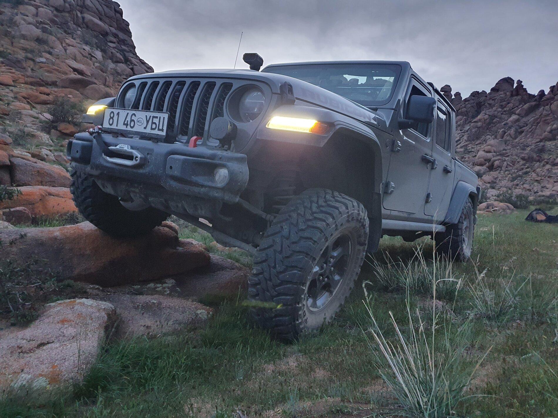

Btw here is my jeep. Currently sitting on front 2.5" spacer lift.
