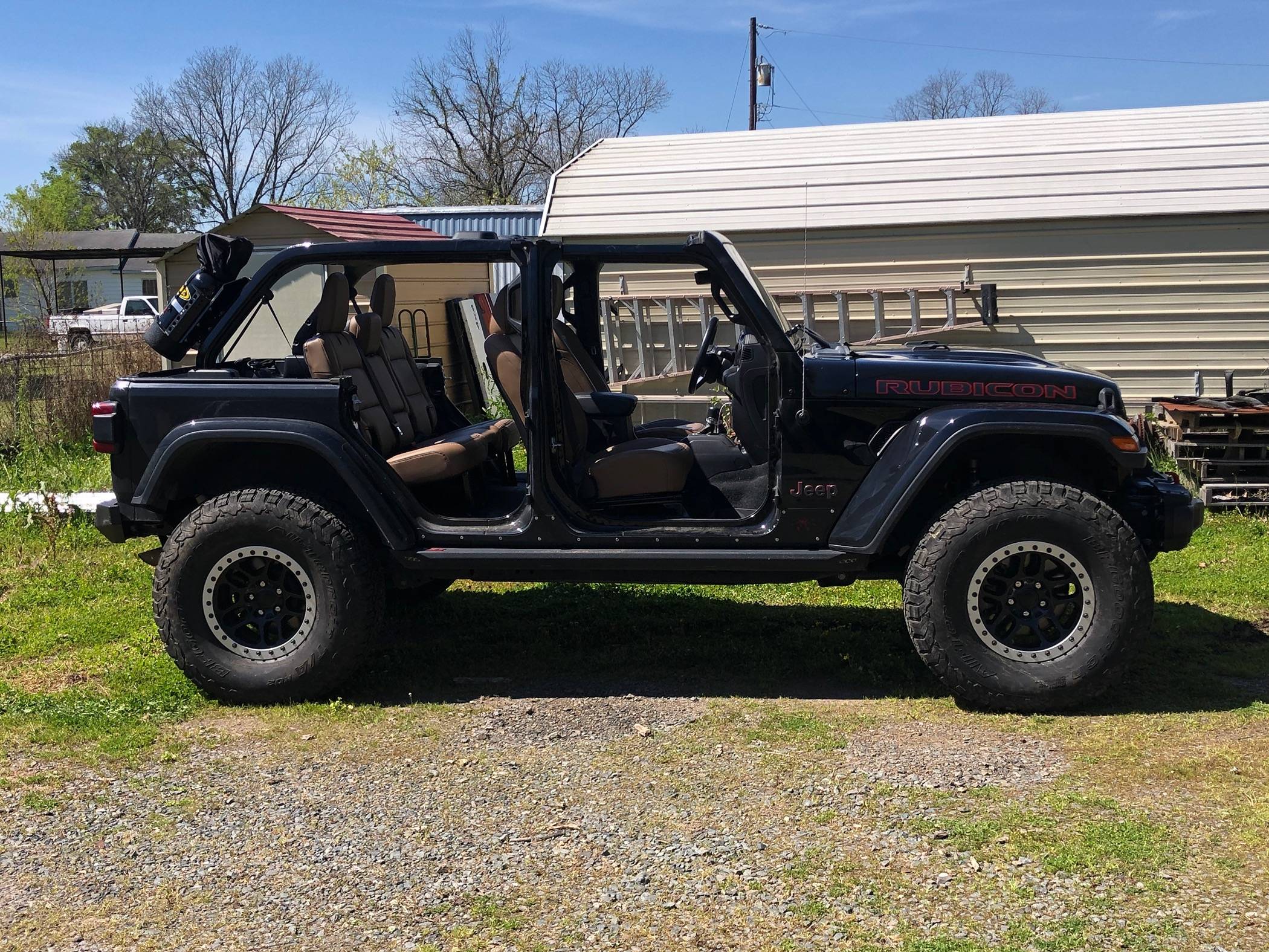

I have 77,000 trouble free miles on my 2020 JL Rubicon Diesel. I just pulled the 37's off my JT and put them on the JL so we can take it to Moab next week for nine days of wheeling, I wish I could find a low mileage Diesel Sport to drive to work to keep miles off the Rubi. I would not hesitate to buy one with 60 K well maintained.

Ready to roll

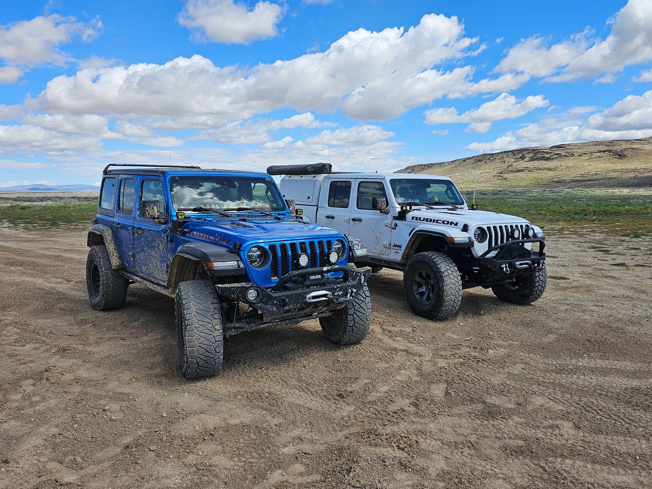

All depends on the how it was maintained and also some dumb luck....
I have a 23 JTRD with 22k on it no issues, wife has a 21 JLURD with 65k no issues.... bit I had a 22 that had an emissions harness issue from day 1 and then lost the pump at 3k and I sold it back to them... (it's in Alabama now btw)
We LOVE our diesels and wouldn't have the Jeep with the anemic 3.6
