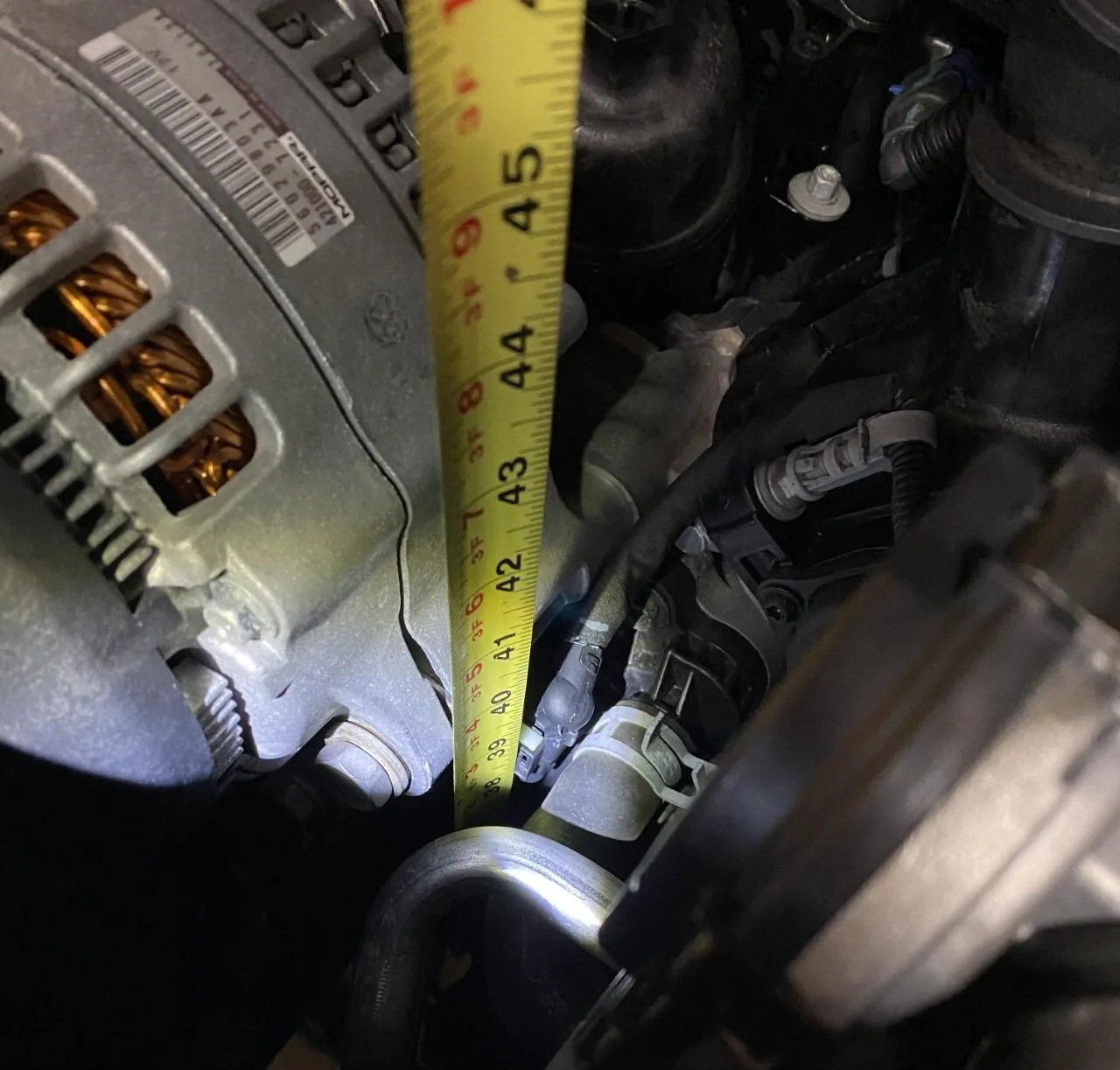

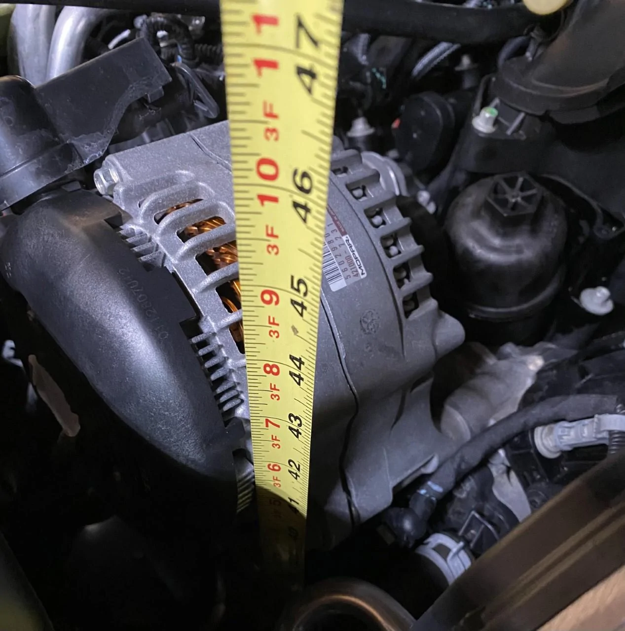

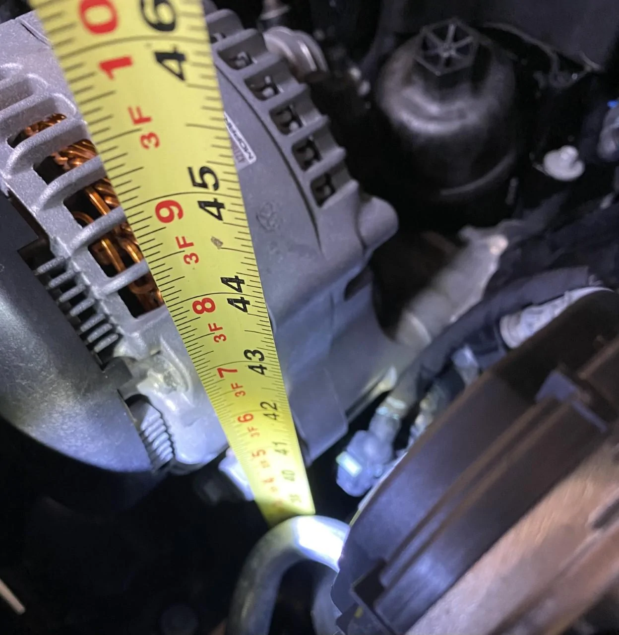

This whole thing has got me really confused. The OP has a JT Gladiator and I think it has a water fording limit of 30 inches max which would be the same I guess for liquid mud? I have a 2018 JL Sahara stock suspension and I think I'm right in saying that the JT Gladiator is probably higher than my Sahara. So, here is my confusion, the bottom of my alternator is 40 inches above the ground and behind the radiator. How in the world could I possibly get mud or water to my alternator if I only went into water or mud of 30 inches or less? Surely the radiator and suspension and other components would shield the alternator! Me shaking my head and trying to figure this out! Photos provided of my alternator measurements, maybe some engineer on here can help me out?

Water fording depth 30" means crawling through water. Not running, dashing, speeding, a slow walk through it, not splashing it up high over the hood and roof.
What we see in the pics and videos here is not water, nor is it what most call mud - it's muddy water with silt, sand, grit, dirt, possibly small rock in it and getting splashed up high. The speed in the video would seem to me to shove muddy water up high even under the hood.
When I wired my winch I could see direct routes from under the truck up to the battery area - I had a light under the truck and could easily see it up above when looking down past the alternator.
Worse - you have the belt and other spinning things churning things up under the hood.

That makes sense, thanks.
