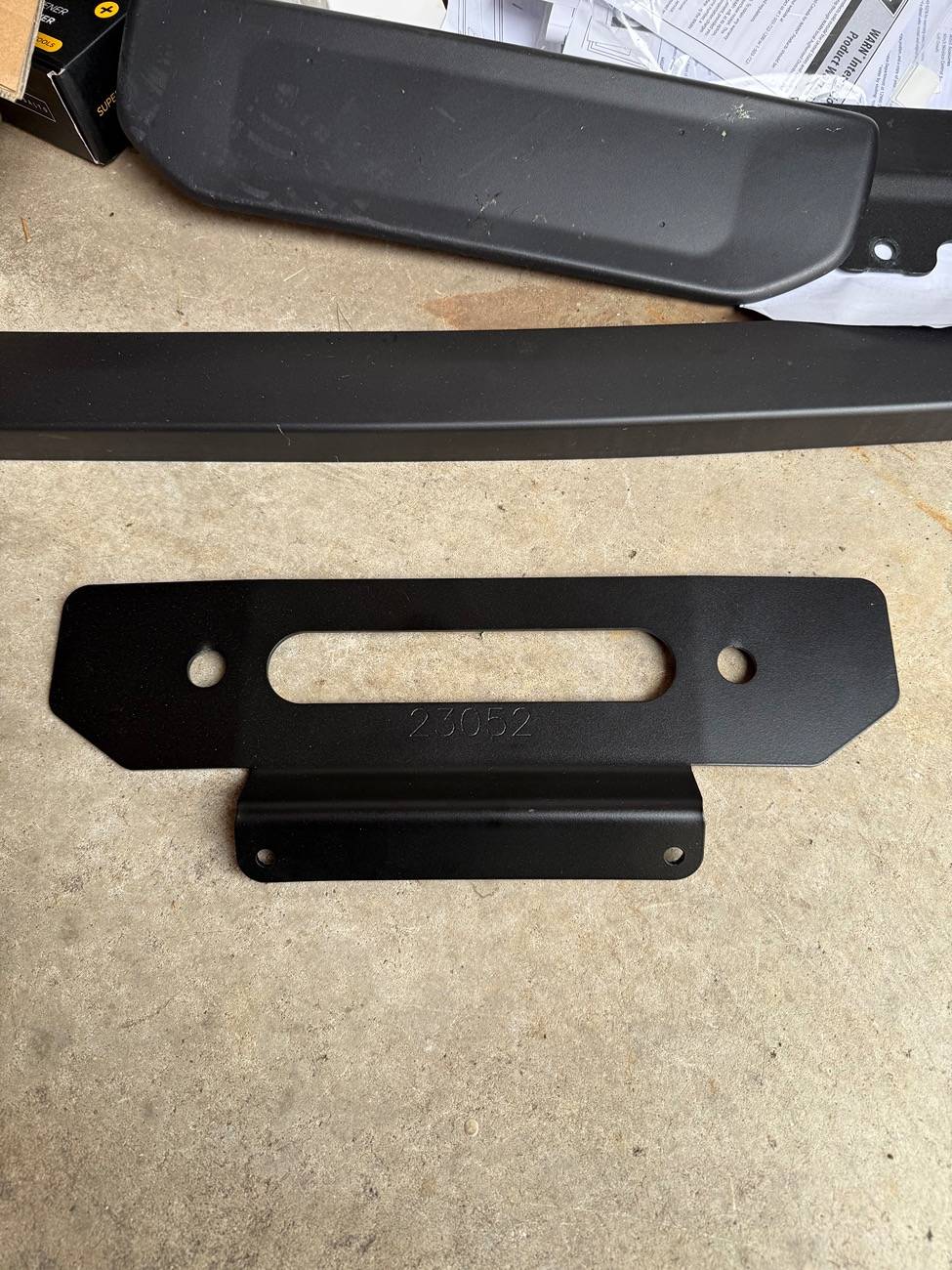

Oh I also have this whole big metal piece extra that the directions don’t reference at all, please see pic below. Anybody know where I was suppose to put this?

Thats your fairlead back plate. Goes between the fairlead and the bumper. the plastic cover is trash now.

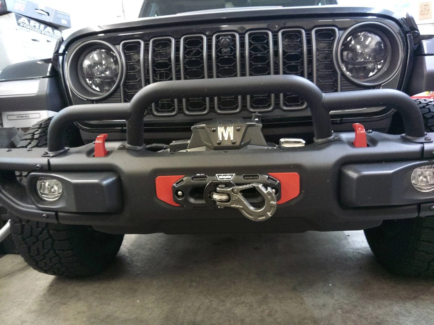

Not sure. I have a Warn Zeon 12K winch with Warn mount and it fit well but snug. The winch is extremely tight but it fits like it's supposed too. You have to be methodical about it and leave all bolts loose until everything is in place. The fit is tight but it fits nonetheless. I watched a few installs on YouTube first which really helped. The secret is to get things in place with the bolts loose first. I found with mine that the 12K winch was very snug and would have benefited from some more bumper clearance. Regardless of what the videos say, it took me about four or five hours to get it right. Good luck to you.

Does the brush guard black your trail cam? Are you going to get a relocation kit for the cam? I am thinking about doing this and adding lights.
