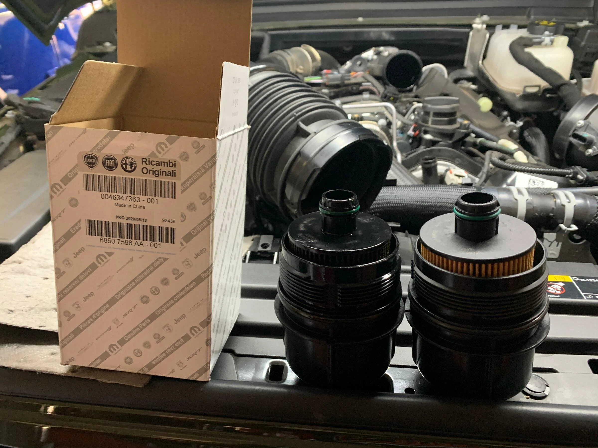

They don't look the same but that might be from the camera angle
Deleted member 22728
They both dimensionally match, bottomed smoothly with no obvious resistance. Even removed the new one to check for any crush or non-conformity. Now, that said, it resembles the previous gen cartridge, however there's been at least one post where the change was attempted with an undesirable outcome.
