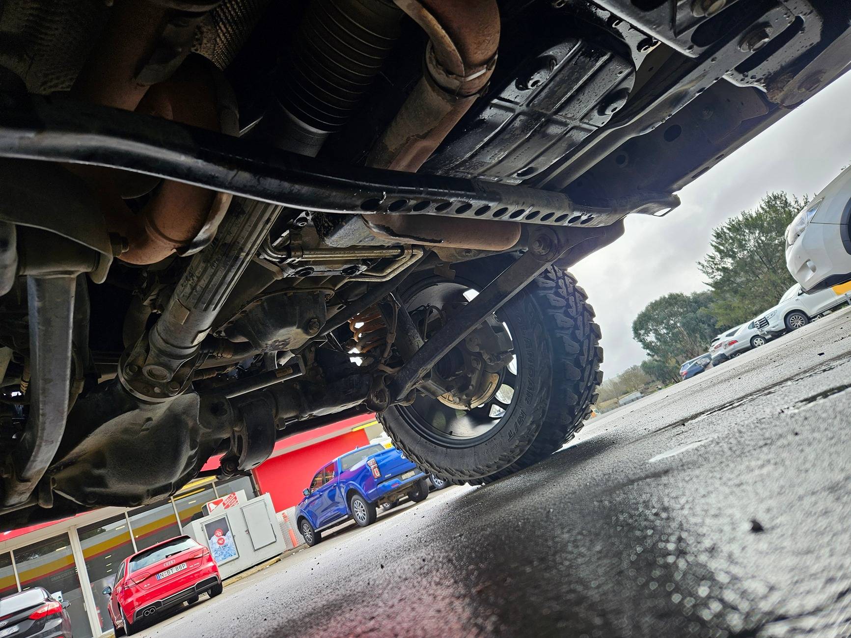

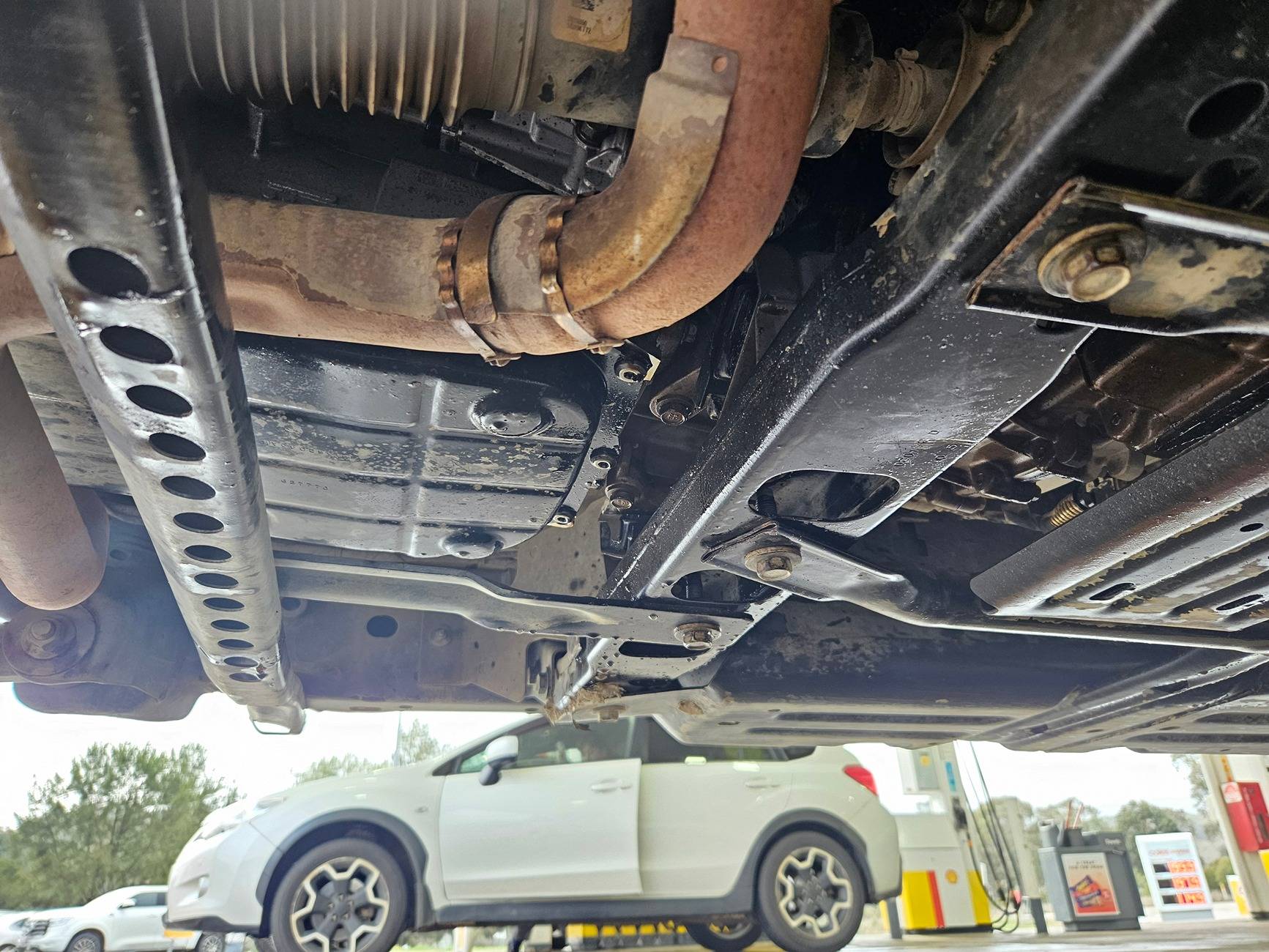

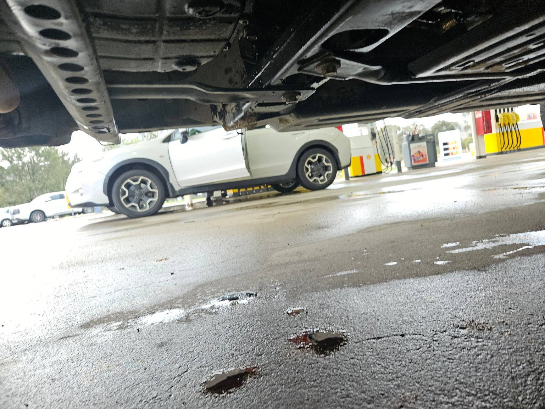

Hi guys an update...
My 2nd transmission (the one for this O.P which got water in it) was replaced under warranty.
The car was away getting replacement transmission for almost 2 months.
I picked the car up 3 weeks ago...and sadly, less than 3,000km later...
its pissing oil out of the bell housing and i think the transmission oil pan.
Somehow I need to drive 500km back to jeep dealership who installed this transmission.
note this is transmission no 3...the car has 50,000km on the clock. First one failed at 36,000km, second one at 47,000km (installer forgot to install breather hose)...this one will be lucky to make it to dealership I think...but I'm screwed I'm in the middle of no where.

Don’t drive it. If you try, you’ll still be in the middle of no where
walking. If you were able to drive to your place, so can a tow truck.
11,516
30,704
Rent a Uhaul trailer and truck. Tow it back. Cheaper than a tow truck or flat bed for that distance. I had to do it once.
Maximus Gladius
Jan 30, 2021
75
2,919
3,732
Calgary, AB, Canada
2021 JTR, 2023 JTR
OP, from the time you noticed the oil leak and took those photos, how many miles did you drive already? Did you drive it after those photos? How many miles back to the dealership? You mentioned being in the middle of nowhere
. Is “nowhere” at these photos at the gas station/store or you’re literally “nowhere” because you drove home?
Are you hearing any whine from the transmission (pump)? Have you pulled up the temp display on the screen to see where the transmission is at?
Your tranny holds about 9 litres. I don’t know how much you can lose before damage starts. You’d definitely hear and feel something by then but I’m not so sure if FCA will take to kindly to you driving it when you knew it had a bad leak.
