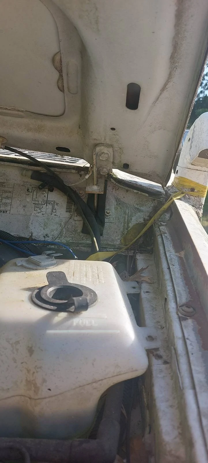

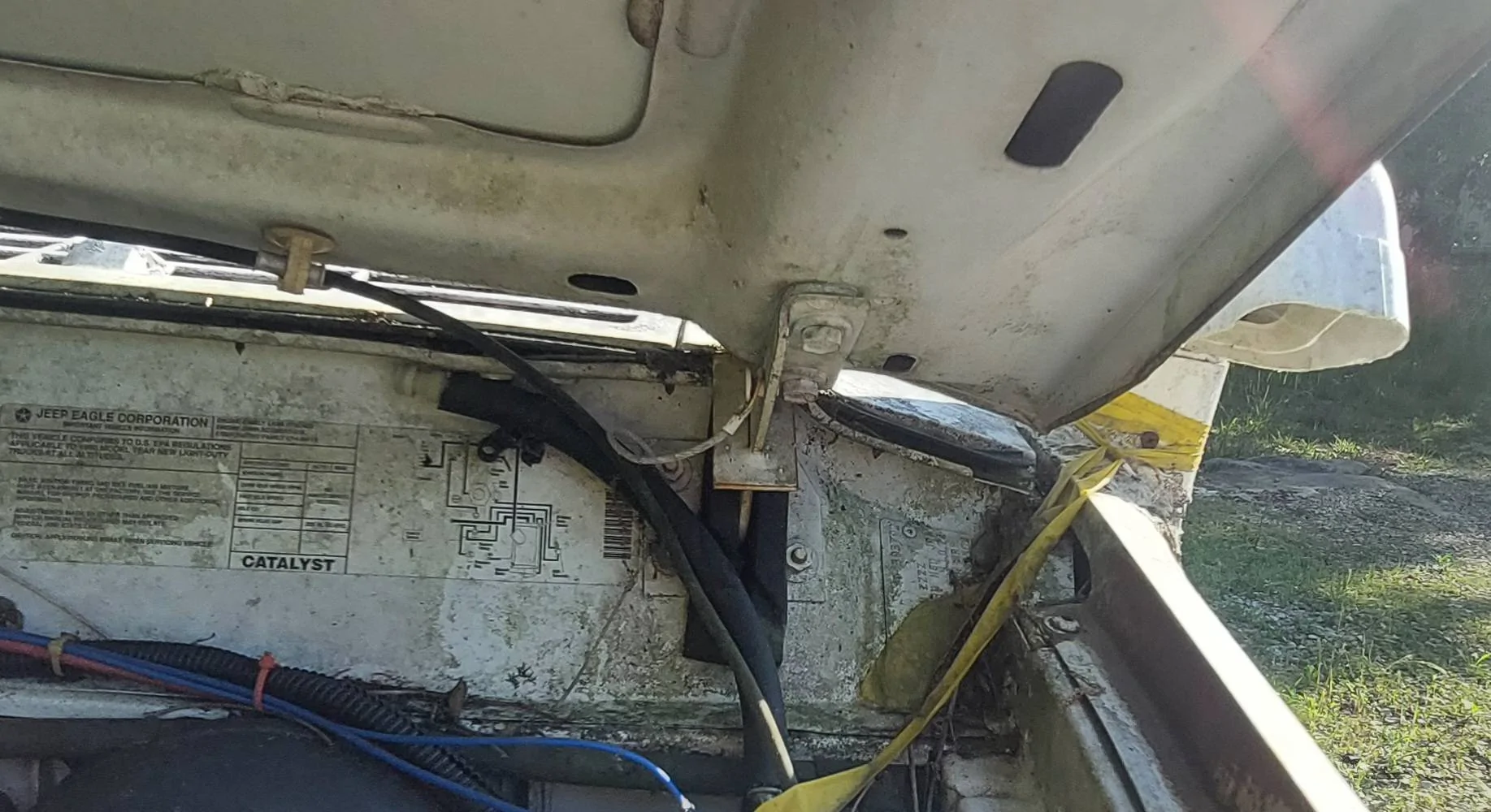

9. And this is the most important...can anyone explain how a breather hose which has a one way valve and is located up on top of the engine comes off the top of a transmission in the first place given its a new transmission?
Also, have any of the naysayers actually seen how this breather hose is connected to the transmission? Its a push on plug (like a small spark plug connector). You can pull it off with two fingers whilst under the car.
Im going to argue that the breather hose is not adquitely connected to the transmission...it should have a hose clamp not a push on cap!
At the end of this post is a picture of what the transmission breather connector cap looks like. Some of you will argue thats a spark plug cap...google jeep transmission breather connector and you will eventually find this image...its exactly what the cap on my jeep transmission looks like.
Ive watched a few videos on preparing jeeps for deep water, ive not yet seen one that says anything about changing the transmission breather hose (because the top of it is already up in the engine bay on above the engine)...so i wasnt expecting this to be an issue.
This is where I relocated the vent for front axle, transmission and transfer case to on my XJ it is around 1.4 meter high. The rear axle and fuel tank are vented to over fuel cap level that can extend to top of roof. As a general rule I don't ford above the tires that is over 30 cm lower than the vents.
Prior lessons learned with that vehicle. (90XJ) lesson two, I don't trust any one who works on my vehicles with what they say the did.oNow the businesses you have there, it might be different. I check that what is said to be done is done. I've had one dealership I went to in Germany, I would recommend from past experiences with them. Not any help for you though.
