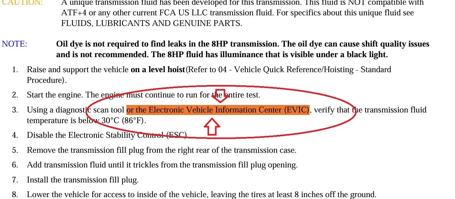

I want to see one of the bullies on here change their ZF fluid to the proper level without using a scan tool..LOL! You can use the display I understand but its not the correct or precise way.
I have no clue why you are stuck on this and any data provided to the contrary is dismissed by you?
The PDF I previously replied and provided to you is directly from the dealership MOPAR Tech Authority website portal the dealership techs use. It explicitly states you can use either a scan tool or the EVIC.
I guess facts are bullying nowadays?
I dont know why I get so much push back on this forum when I try and state the truth or actual facts. Its the same 5 guys that bully people and like each others posts constantly.
Uh, quite a few do it - even Jeep says it's ok.
Where in the world are you getting your info - youtube??

Thanks for the facts man, I always was told i needed a scan tool. My bad and apologies if I mislead anyone.
I have done it twice doing the EVIC method. In both cases sans may a couple ounces +/-, the same amount of fluid went back in that had drained out.
