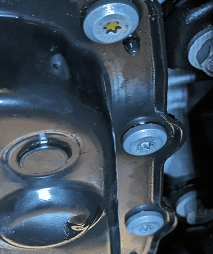

Right side, just above the rear corner section of the pan. Google it if you want pics and vidsOn the ZF transmission, where?

If there's water in it, it will be milky.You cannot check the fluid appearance unless its overflled at 86 degrees F and it spits out of the overfill.
May I also ask what good ZF fluid looks like in comparison to bad fluid?
Green in color . Light green . If you run some in a empty clear glass cup or sprite bottle it has a "clearish" green hinge to it.You cannot check the fluid appearance unless its overflled at 86 degrees F and it spits out of the overfill.
Sitting cold the fluid in the torque converter will drain back in the pan and there will be about 1.5 liters of fluid above the fill check plug.You cannot check the fluid appearance unless its overflled at 86 degrees F and it spits out of the overfill.
It is a specialized formula developed by ZF for their transmissions. Do not use any other type ,Chrysler 8&9 speed transmission fluid. Others have and it has not went well.Ok, understood.
The subject is about checking the fluid quality, in this case, water in the fluid. I am not talking about doing a service level check.Thats not true at all. To properly check the level of the Zf you need a scan tool.
Does someone have that picture handy of when I asked the color? It's wicked. Reminds me of 80's era 'hot' colors. Maybe I can find that thread.Green in color . Light green . If you run some in a empty clear glass cup or sprite bottle it has a "clearish" green hinge to it.
