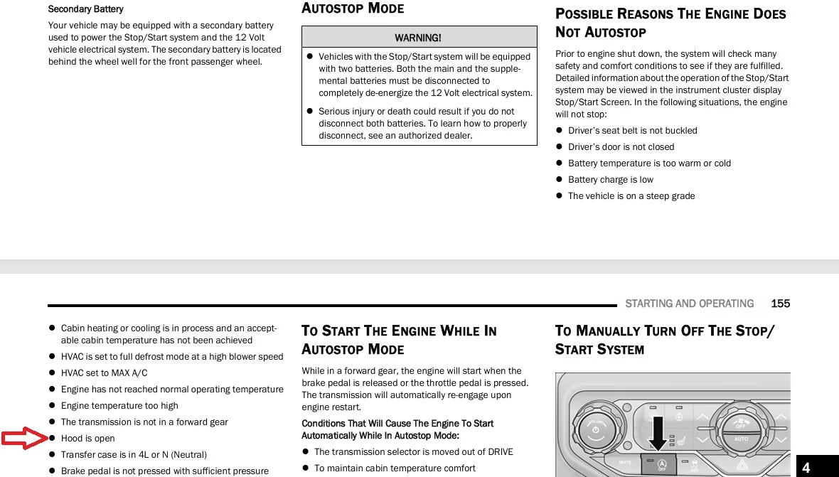

One of the switches is tied to the auto start stop disable function other is hood open alarm dash light.
Spot on. The ESS system checks the hood closed switch position as part of its readiness state.

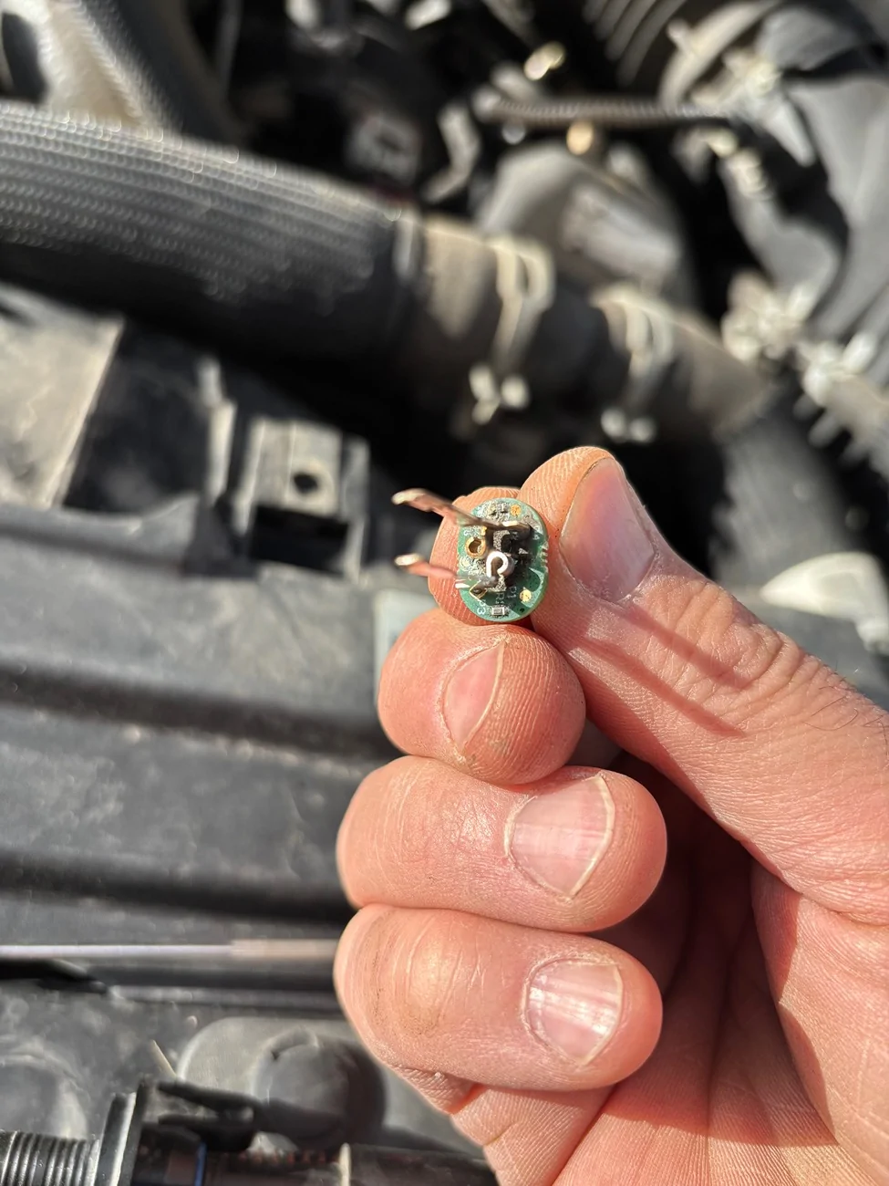

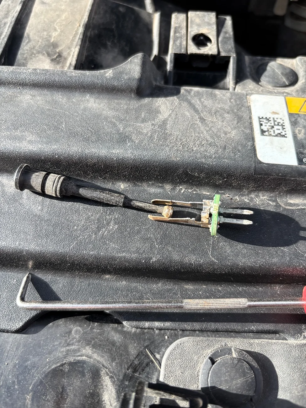

I just went through this. The switches are terrible and not waterproof at all. As the vehicle gets older these switches corrode badly. I took mine apart and cleaned them which cleared up the lights on the dash.
Jeep Gladiator Weird alerts this weekend. IMG_0270
Jeep Gladiator Weird alerts this weekend. IMG_0271
Mine started with the hood open alarm. I cleaned that one and then shortly after it was the ASS system alarm. Cleaned it up as it was just as bad and all was well again. Not sure how much they are to buy.
