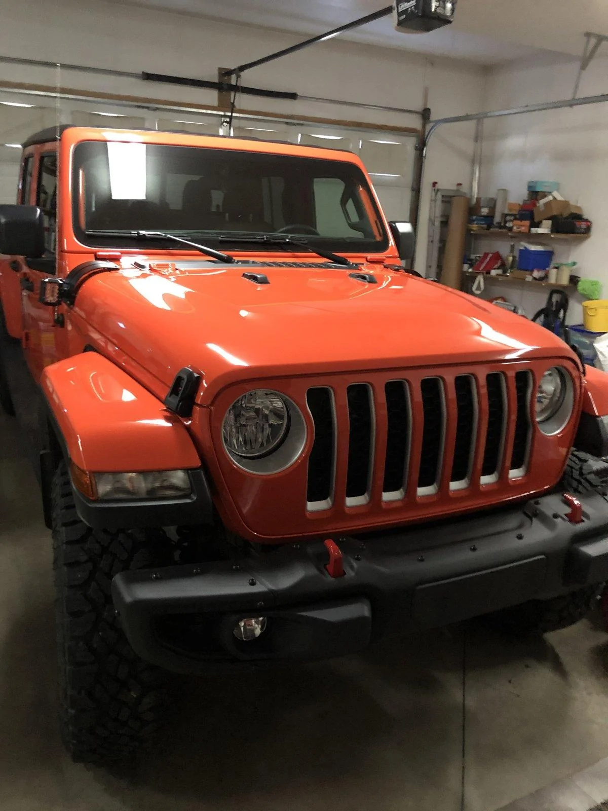

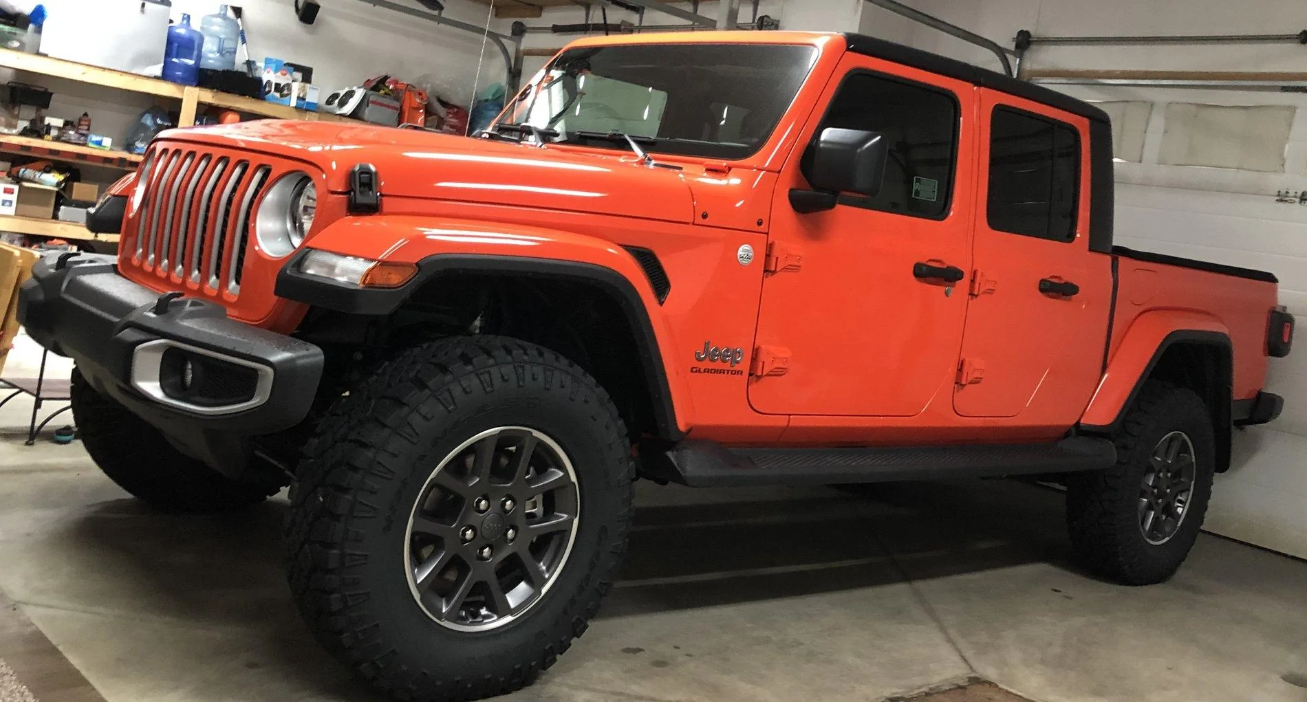

I have an overland that the dealership put a 2” lift and 285-75-18 duratracs (35”) on. Had very minimal rubbing on full lockup and a bit more in reverse. Anyway I just put on the rubicon steel front bumper and now I am getting considerably more rubbing on hard turns. I realize the weight would have dropped it a bit but come on. I also want to put a winch and winch plate in then what? Am I going to have to put a 1” front spacer in?

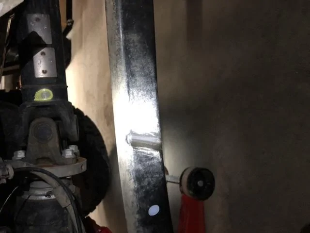

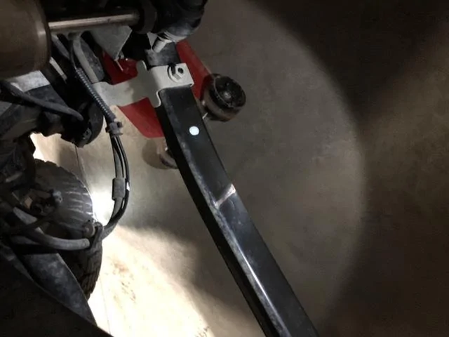

Well found out where it was rubbing. How does one fix it? I guess I can bring out the bumpstops a bit.
It I not unusual to have to adjust your bump stops, especially if you do not have an adjustable track bar

I’d say those tires are too wide for the factory wheel offset, backspacing, or whatever it’s called (I’m not a technical guru). Go with wheel spacers or new wheels.
A lot of ways to hide a problem or as one would say, skin a cat. You can fix it properly with an adjustable track bar, but I would never recommend wheel spacers for a cure, can cause to many other problems down the road. But everyone's budget is their own.
Ok, I get what you’re saying. I missed the 2inch lift portion. OP has a .5 inch inset on one side vs the other if they don’t have a track bar to correct it. Sorry I missed that! :like:
