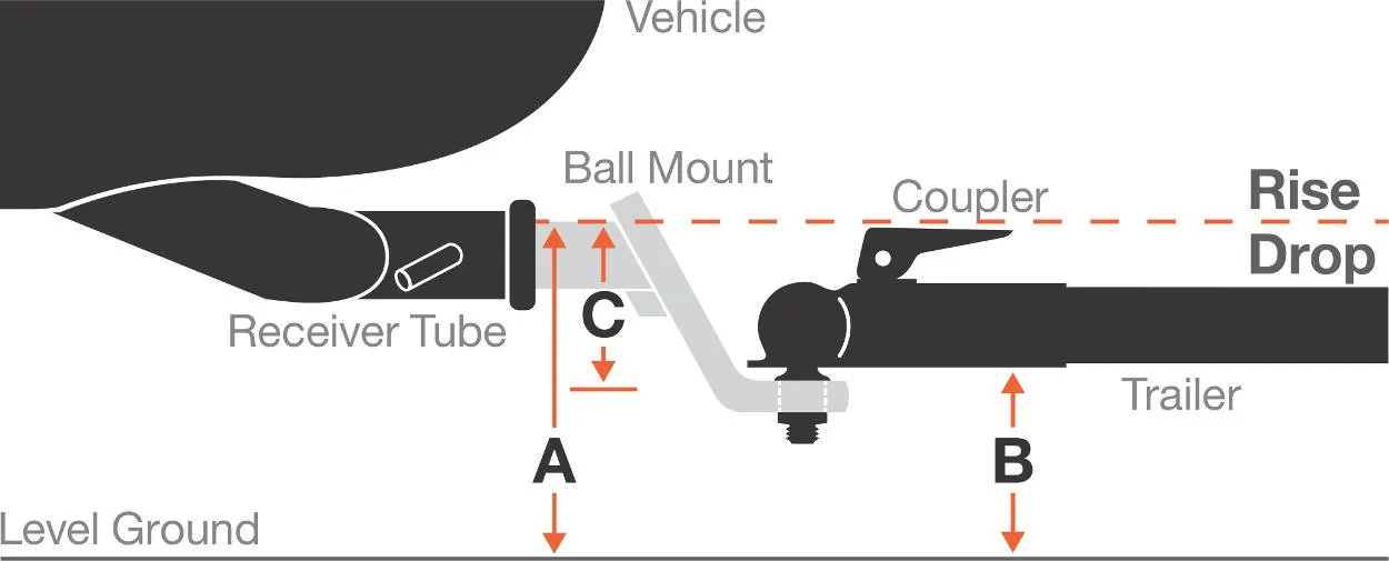

All depends on your trailer.
B minus A equals C, the drop.

Like all of the others have said - the mount should allow the trailer to sit totally level once it's hitched up. So you can't measure the truck as it sits - as it will drop some with the trailer finally hooked up.

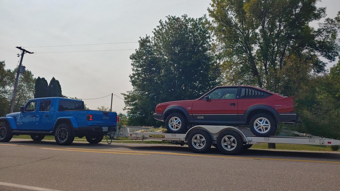

I hooked my trailer up, measured how much it dropped the truck. Then I unhooked and set my trailer jack until my trailer was totally level and measured the coupler on the trailer to the ground. I then did the math.... hopefully I did the math correctly as I load everything up and leave at 5:30 am friday.
You especially want twin axle trailers level when hooked up so the weight is distributed evenly on both axles, if the front is too high, the rear axle handles more of the load and the front axle less (and the tongue weight increases). If the front is too low - then you put too much weight on the trailer's front axle.
