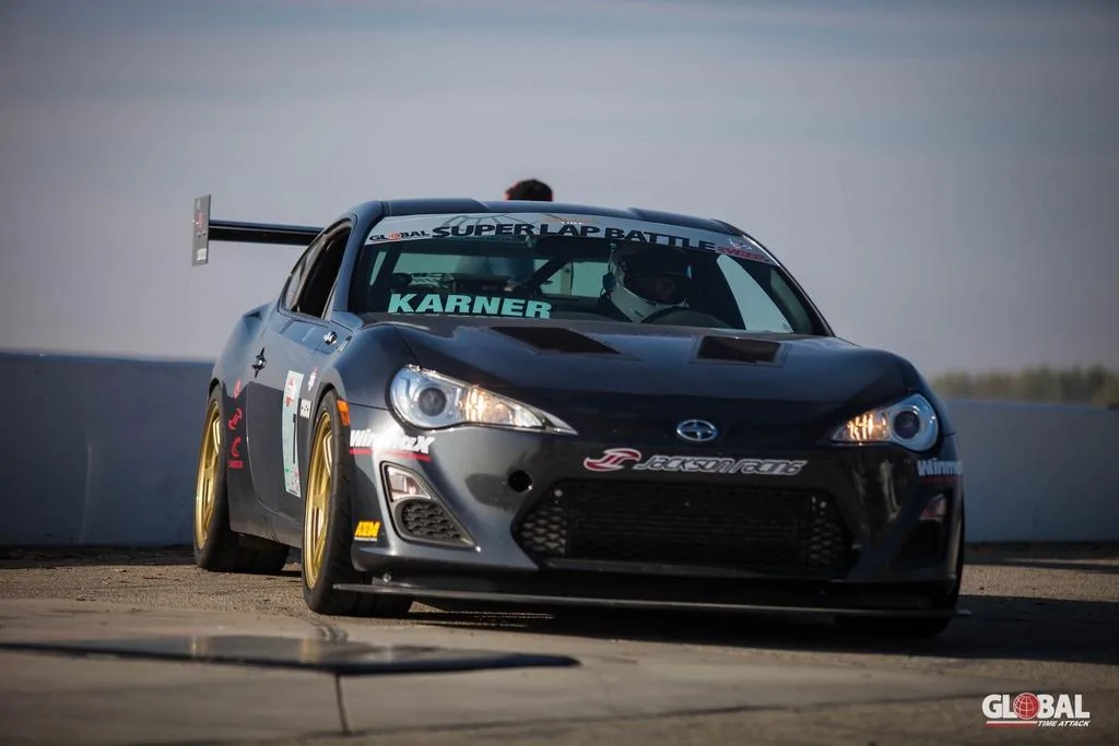

This was a car that I converted to flex fuel.
550hp from 2.0L
