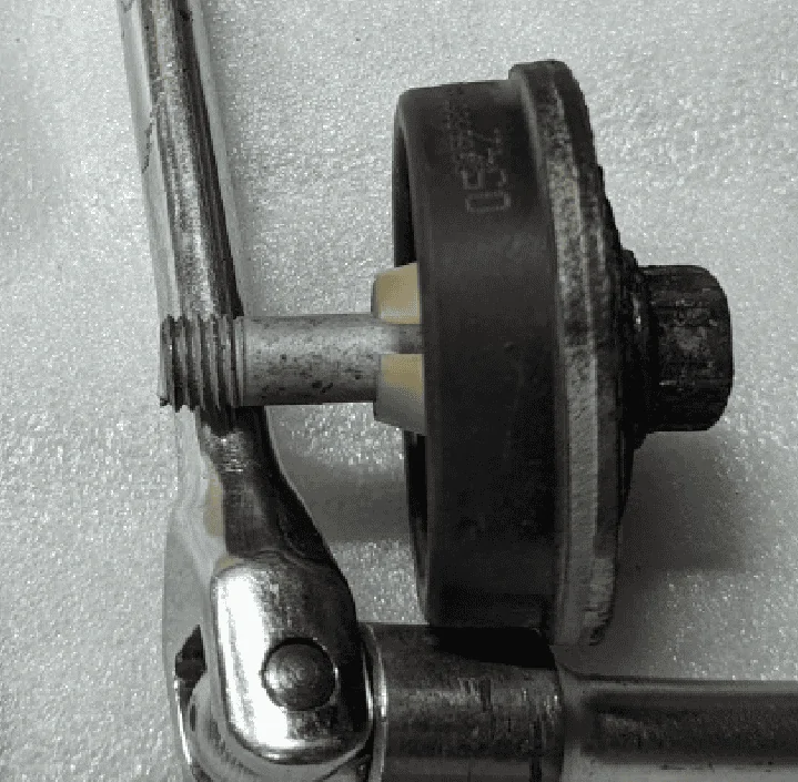

Benny - part number and price for front body bolt? The big long bolt with 3 tubes of Loc-tite spread all over all threads that holds the body to the frame......
This is part of it...........the rest is solidly glued up into the body ->
Man, that sucks.. I just did mine and I was blissfully unaware of this possibility...
I was thinking about replacing my bolts though after reading about these breaking but I'm debating on whether or not it's worth messing with them now ..

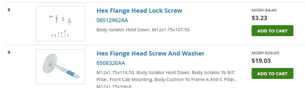

Benny can confirm but these are what I have in my cart currently...
Front bolts: 06512962AA
Middle bolts: 6508326AA
Rear bolts: 06512897AA

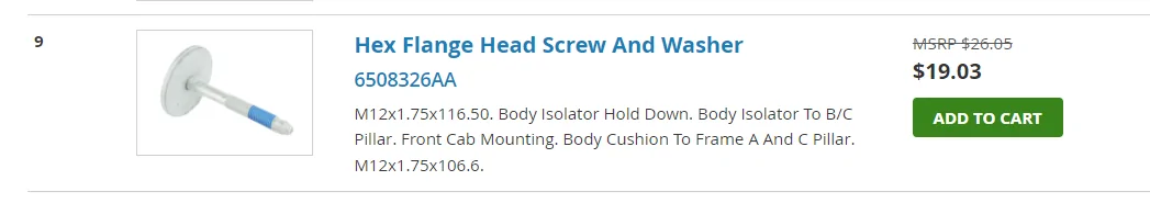

It says body cushion to frame A and C which means the front and rear...
Jeep Gladiator What can we do for you? 1679666217284
Now compare prices - and look at the sizes - almost the exact same size, off by roughly 1 mm - 6 times the cost! and shorter by 1mm

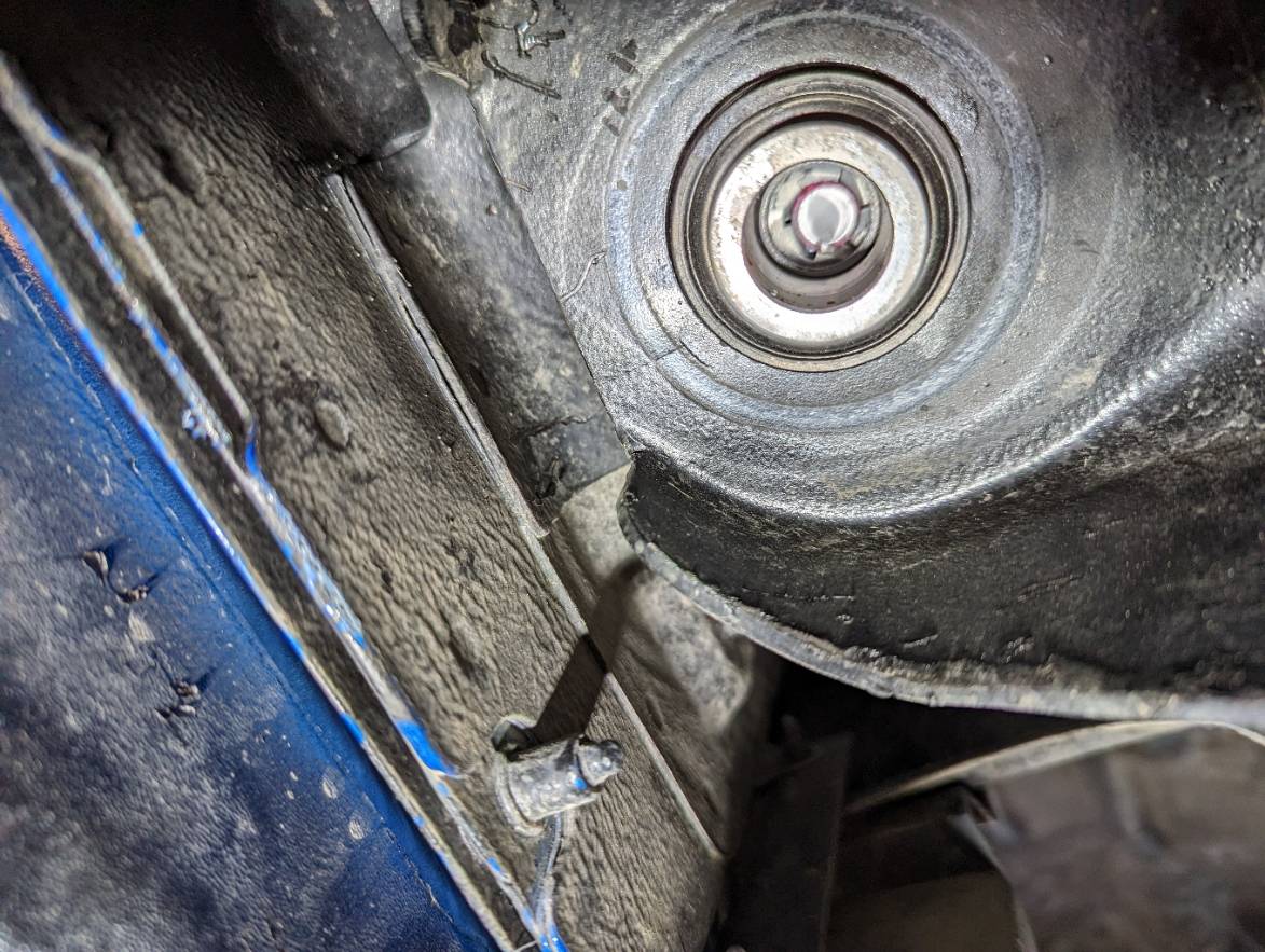

I was not thinking completely when I said "front". The fronts are near the engine bay, on the left, near the steering gear.
I should have been careful in terminology - "my front" is the front of the 3 needed to mount the steps. It's the front of the three between the axles. My front would be the second one back on each side, just behind the front wheels. They are right about where a mud flap would be, almost right under the windshield.
I didn't keep in mind there are REAL front mounts that are ahead of the axles.

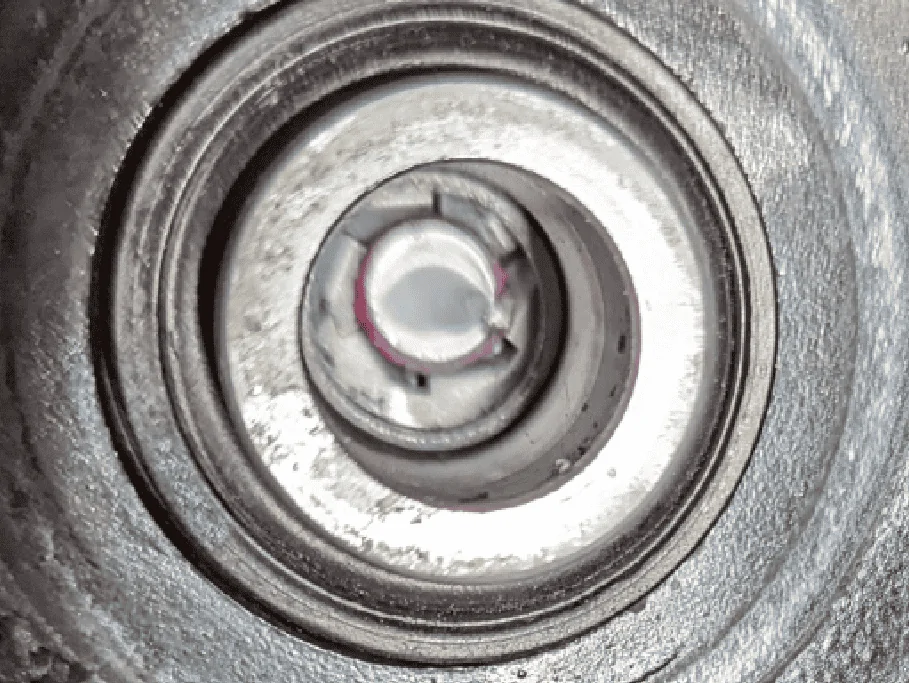

So when I say front, I should be clear - not the real front that a parts person would look up, but the second one back, the first one behind the front wheel. The "A pillar" body mount bolt, just about straight down from the cowl or rear edge of the hood, right behind the front wheel. It's the one they use 3 tubes of locking compound on so that the locking compound is so thick you can't even tell there's threads on the bolts.
I was going to remove each bolt fully and clear their locking compound off but they have retainers that hold the bolts up in place so that even when fully unscrewed from the body mount, you can't just pull the bolt down and out. You can unscrews them so they are out of the threads, but you can't drop the bolt out. (not without real force)
You can see it here - along with 8 ounces of the Loctite they use on these A pillar body bolts.

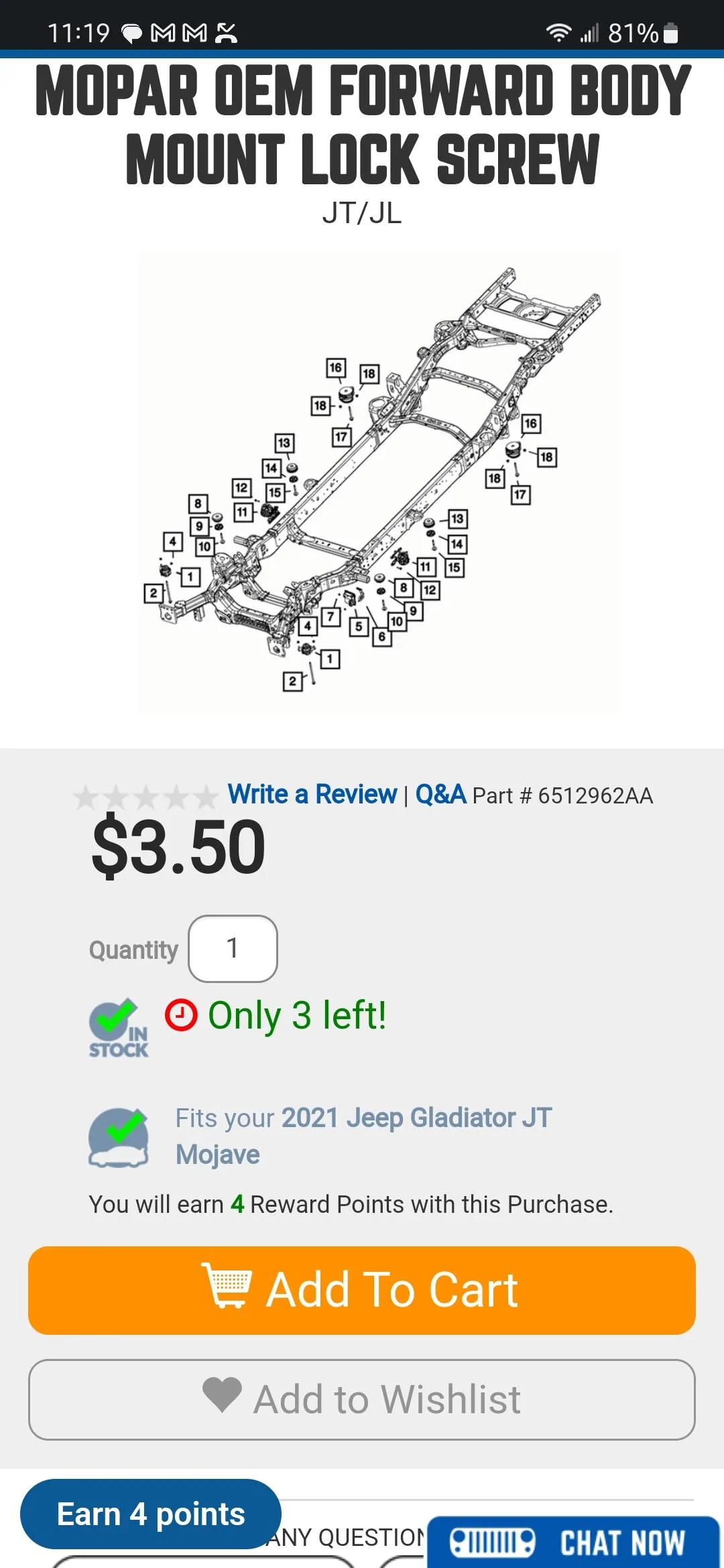

To be honest, I hadn't really thought about the "real" forward body mount by the grill..
I found the part numbers On northridge4x4.com, they have a diagram showing where the bolt is. It's not in the screen capture, but they call out number 10 as being the forward body mount bolt below the a pillar..
I suppose we'll have to wait for Benny to confirm, I am far from a Mopar parts expert lol...

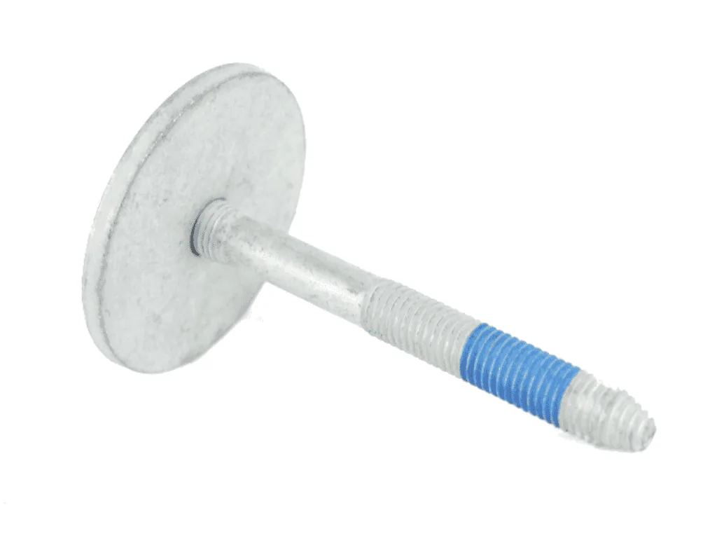

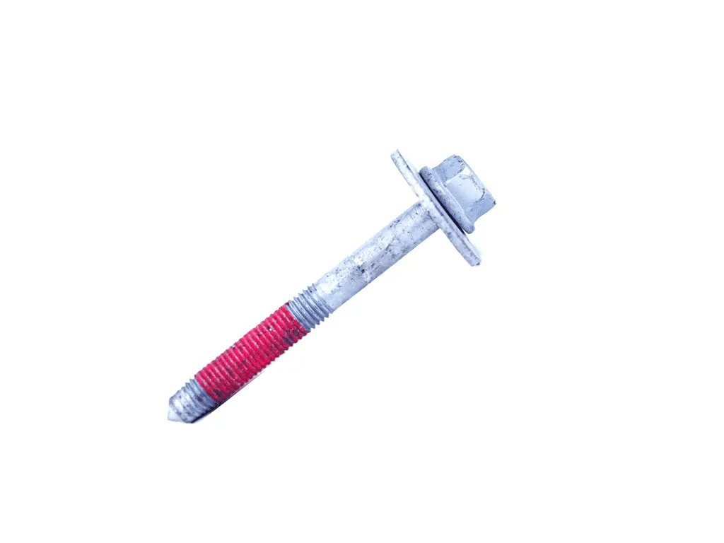

I cannot confirm placement because our data does not show locations.
6 Bolts are used (2 Each) with all bolts being M12x1.75 , Only the length differs.
Part # 6512962AA 107.50 mm long
Jeep Gladiator What can we do for you? 1679686948998
Part # 6508326AA 116.50 mm long
Jeep Gladiator What can we do for you? 1679687003581
Part # 6512897AA 215 mm long

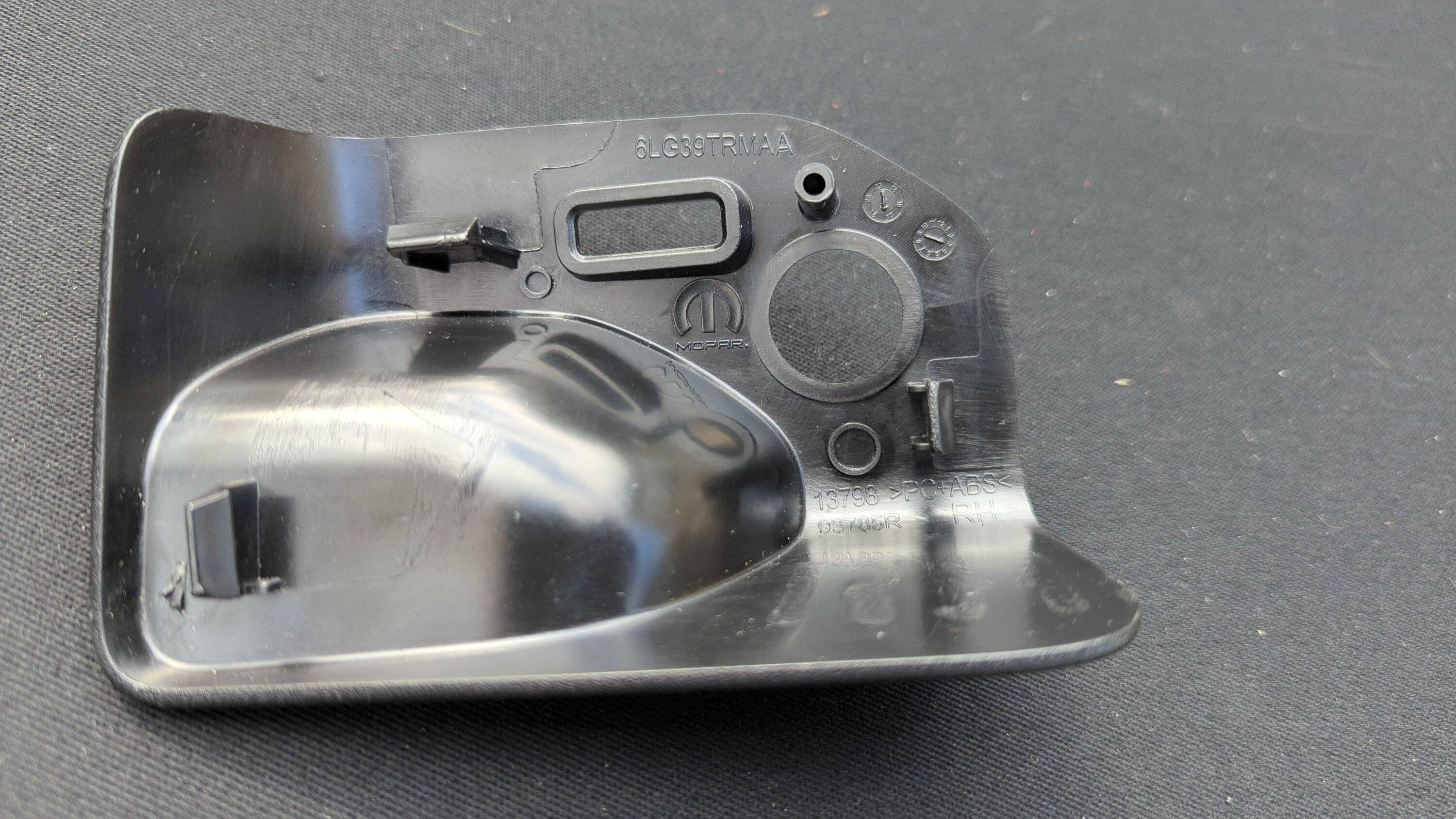

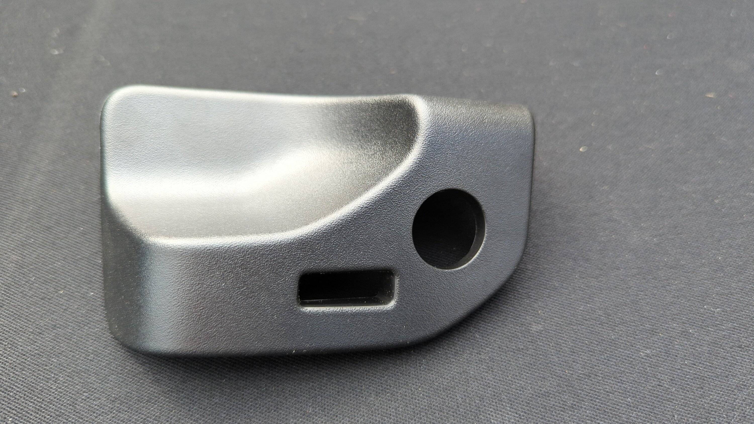

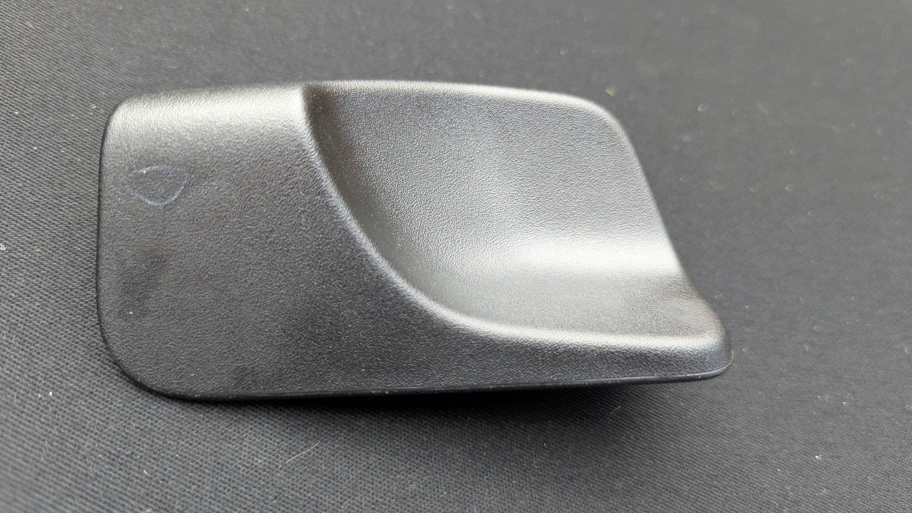

Does anyone know what this is for? Bought a new to me 2020 Mojave. This was in the glove box and I cannot for the life of me figure out what this is for?
It's got 3 different numbers on it.
Mopar - 6LG39TRMAA
13798<<< PC+ABS
939785R RH
I Googled it but couldn't find anything.
Jeep Gladiator What can we do for you? 1680030072684187757928964220618-
Jeep Gladiator What can we do for you? 1680030103781265077639064664026-
Jeep Gladiator What can we do for you? 16800301250542237765698447225501-
Mopar - 6LG39TRMAA
13798<<< PC+ABS
939785R RH
Rear seatback release bezel. I believe its located on the top right of the rear seatback.
