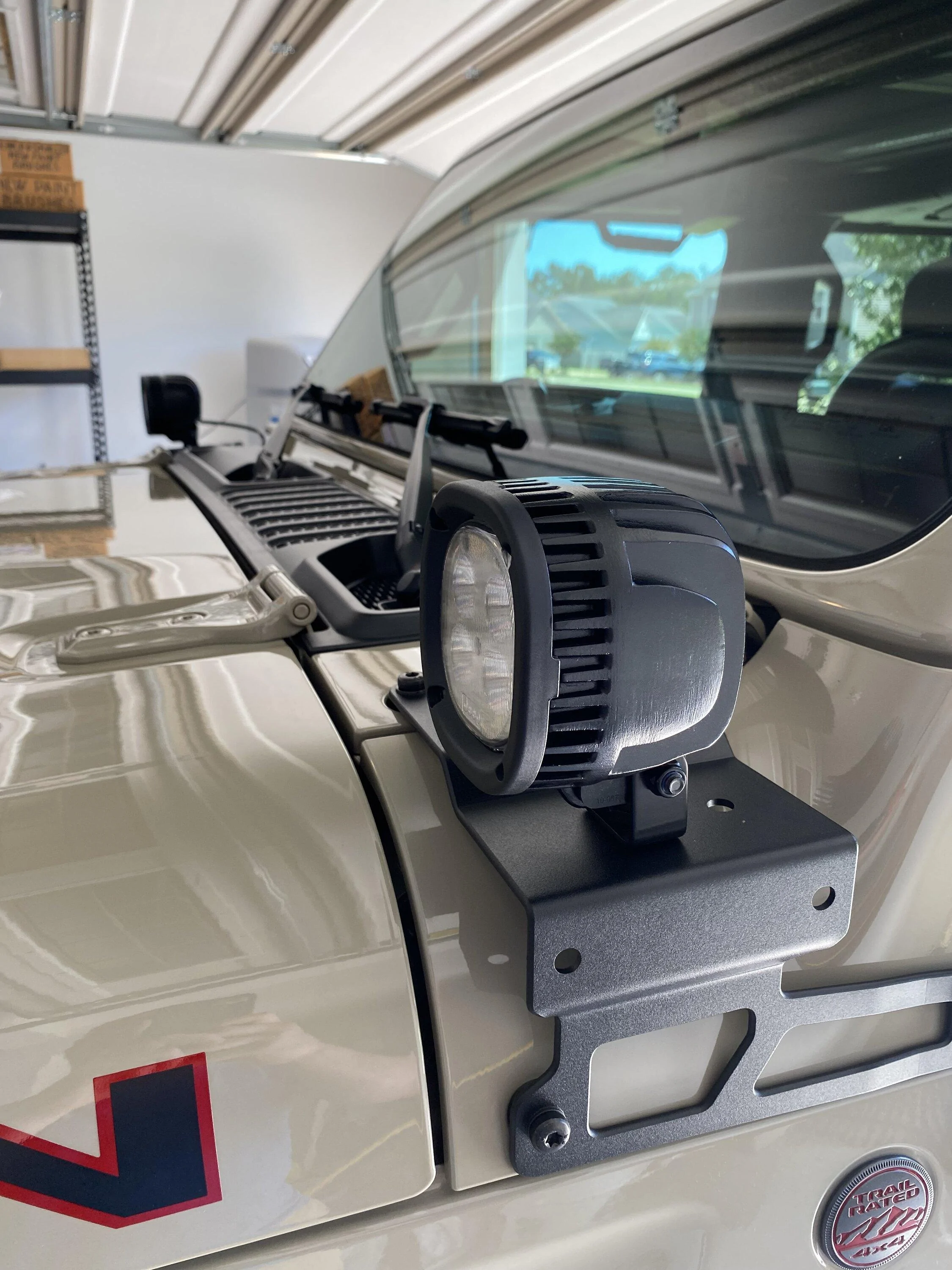

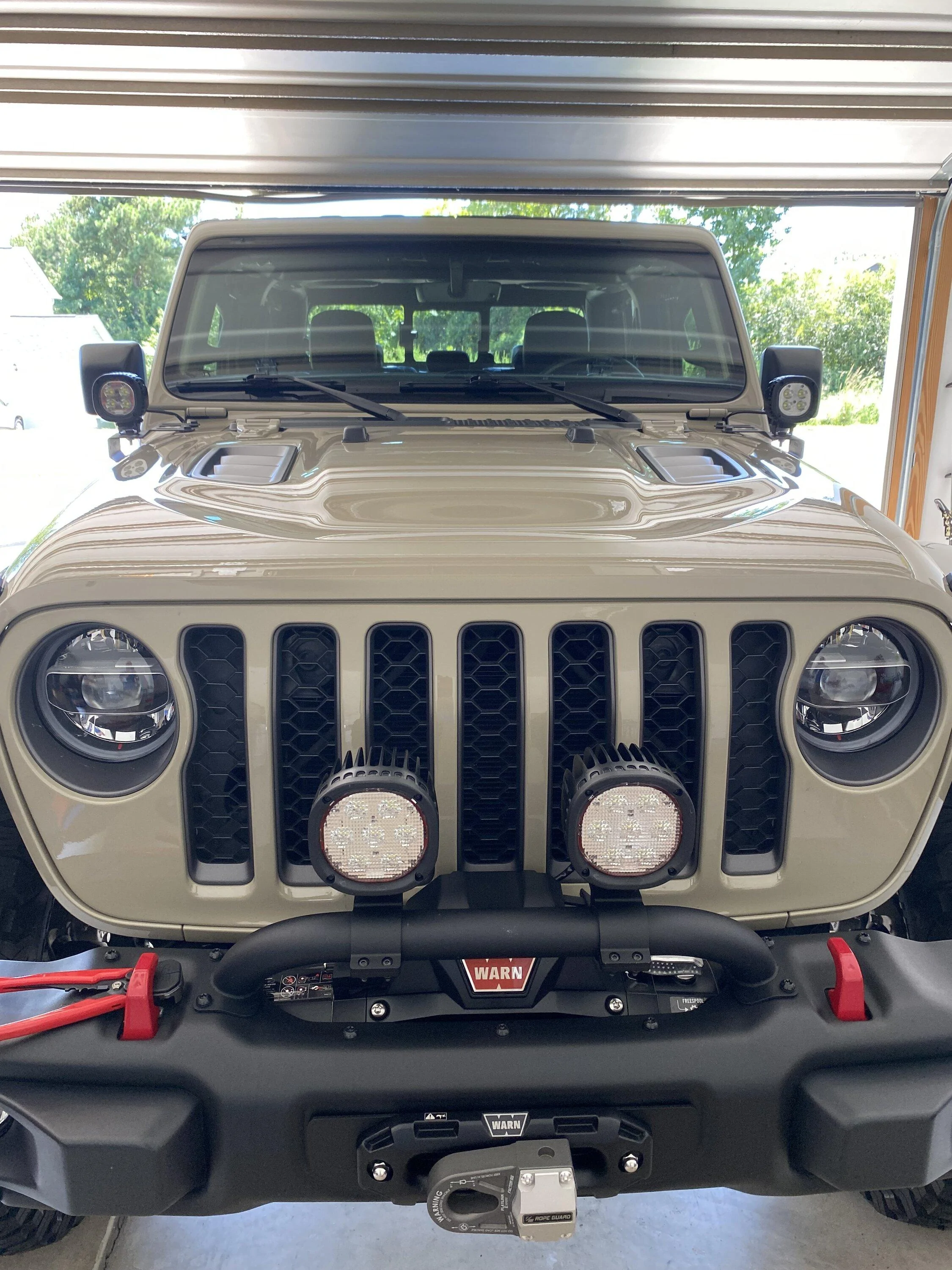

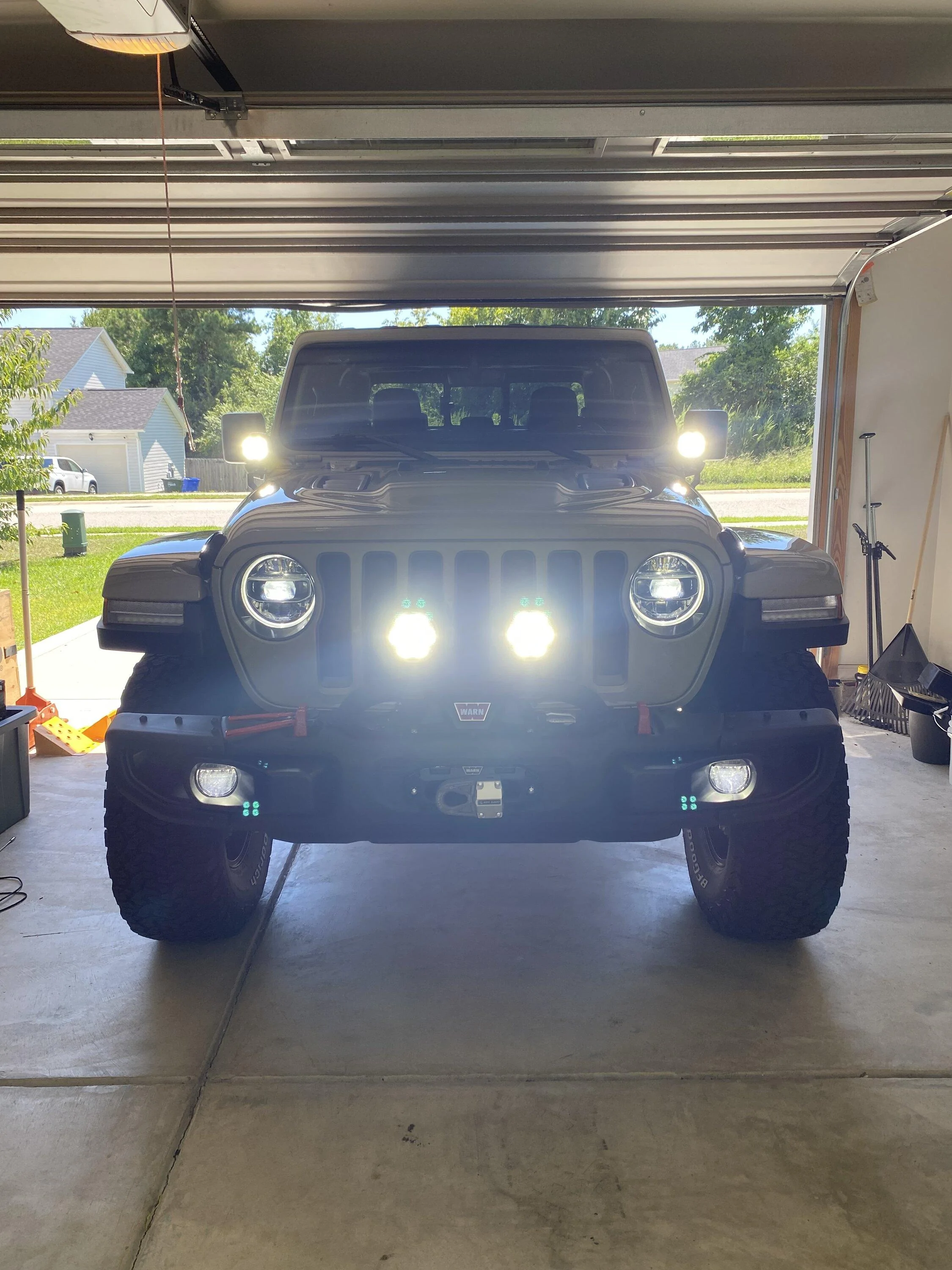

Finally got around to installing the MOPAR A-pillar light mounts and MOPAR 5 inch lights. Super easy install with the AUX switches and matches the 7 inch MOPAR lights mounted on winch guard.

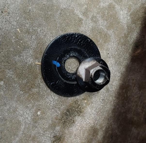

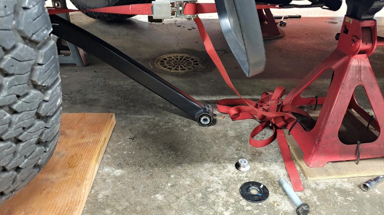

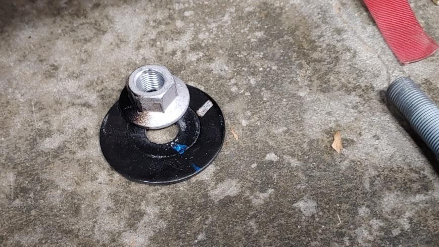

Put the l/4" longer MOPAR lower control arms in, prepping for the future and to see if it makes any difference with no other changes. 1/4" is so minimal, I expect nothing..........
I did notice a change between 2020 models and 2022 models - a large flat washer on the inboard side of the LCA frame bracket. That was not present on my 2020.
It was put on and received a blue inspection mark before the nut was put on.
How do I know? Because the blue mark extended UNDER the nut flange.

Then after the nut was installed, another inspection mark outside of the reach of the nut's flange-
Left LCA -
Jeep Gladiator What did you do TO your Gladiator today? [ADMIN WARNING: NO POLITICS, NO GUN TALK] 20220815_144253
Nut and washer for right LCA -
Jeep Gladiator What did you do TO your Gladiator today? [ADMIN WARNING: NO POLITICS, NO GUN TALK] 20220815_145555
Left LCA -
I added the longer Mopar LCAs with the 2" AEV spacer lift and the alignment showed it was high out-of spec. Caster was at 6.4. The specs were supposed to be between 3.4 and 5.9...somewhere around there. So I took them out and put the stock LCAs back in. Didn't notice any ride quality issues with either one.
Left LCA -
I noticed that change on my 2021 Willys.
Damn. Just ordered these for my TF 1.5” level.

I just ordered these to put on with my AEV spacer lift. Wonder if it’ll be worth it to return them
This is my first jeep and I'm not a suspension expert but it seems that the oem caster is on the high end to begin with.
You definitely don't need it for 1.5" I did it based on recommendations from others but after the alignment numbers came back and saw it was out-of spec even more, I took them off. I'll let an expert chime in about the numbers

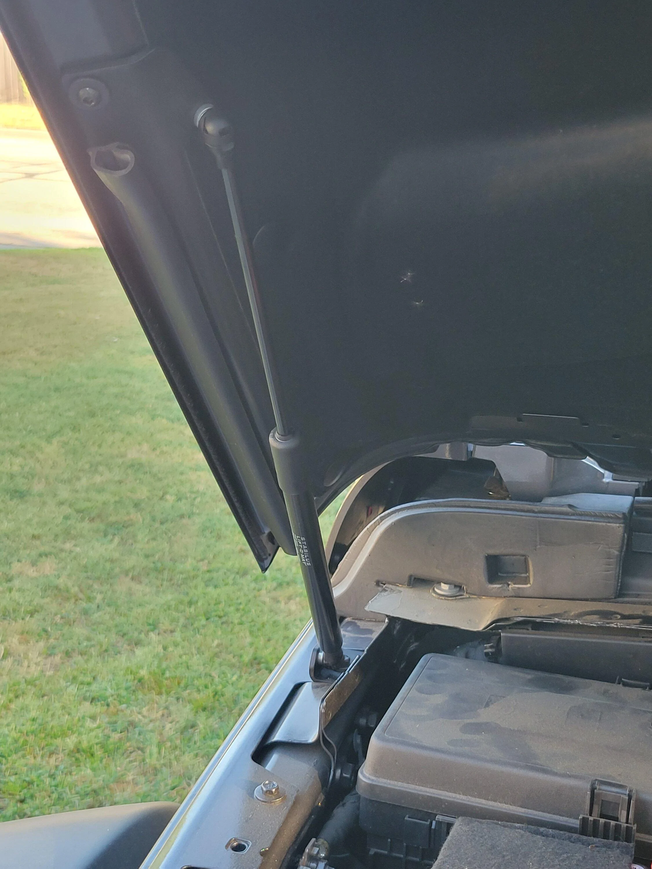

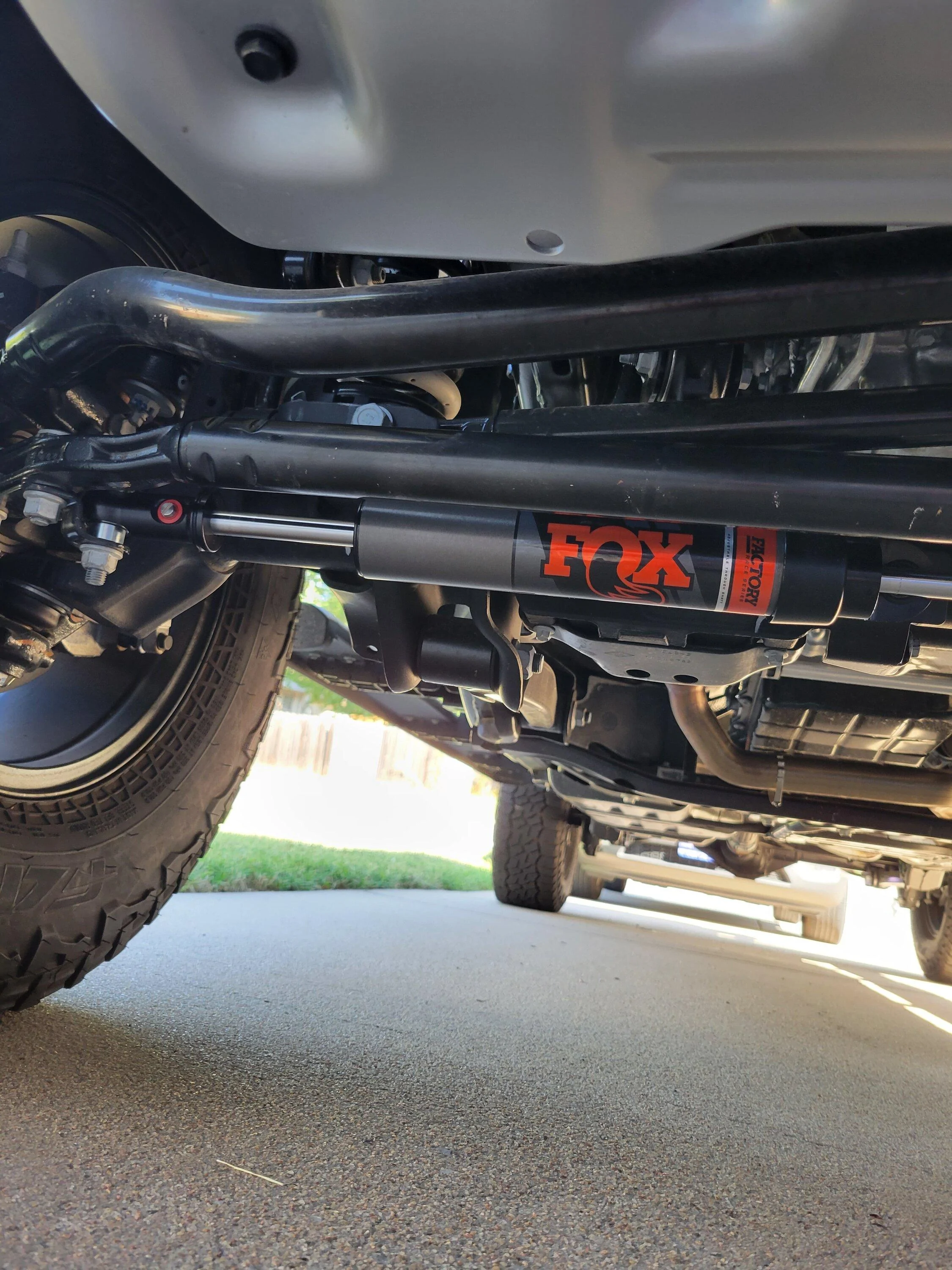

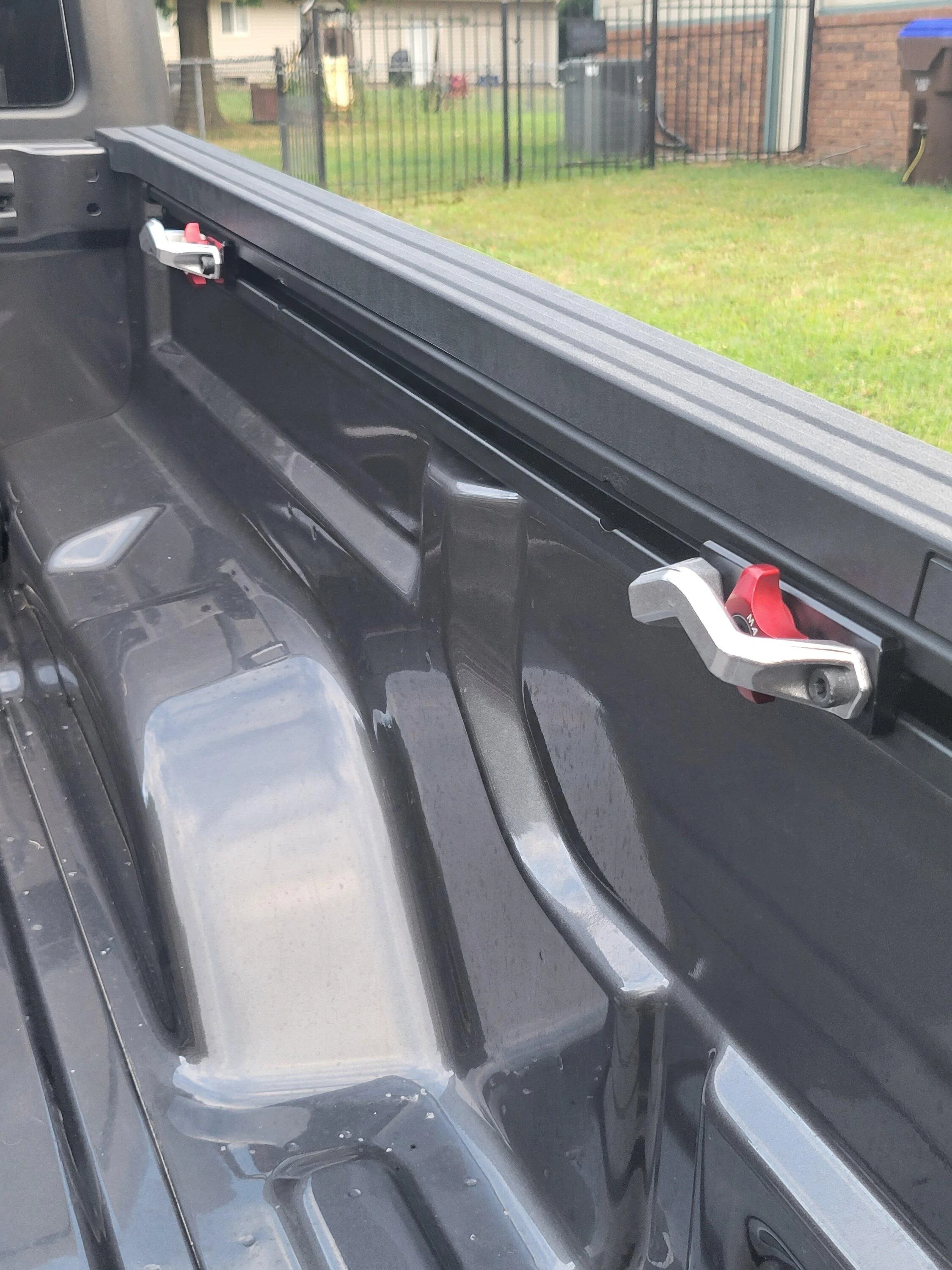

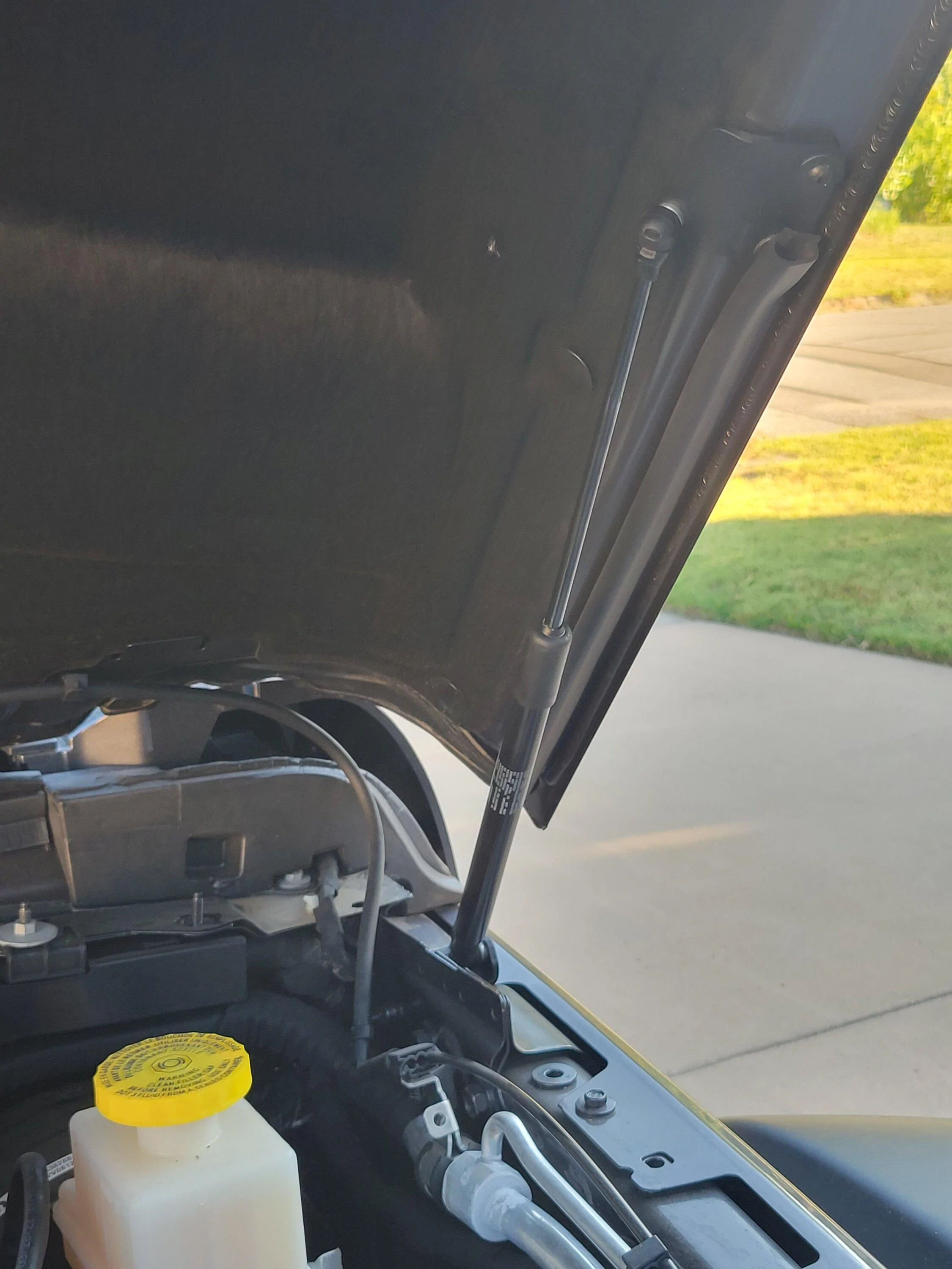

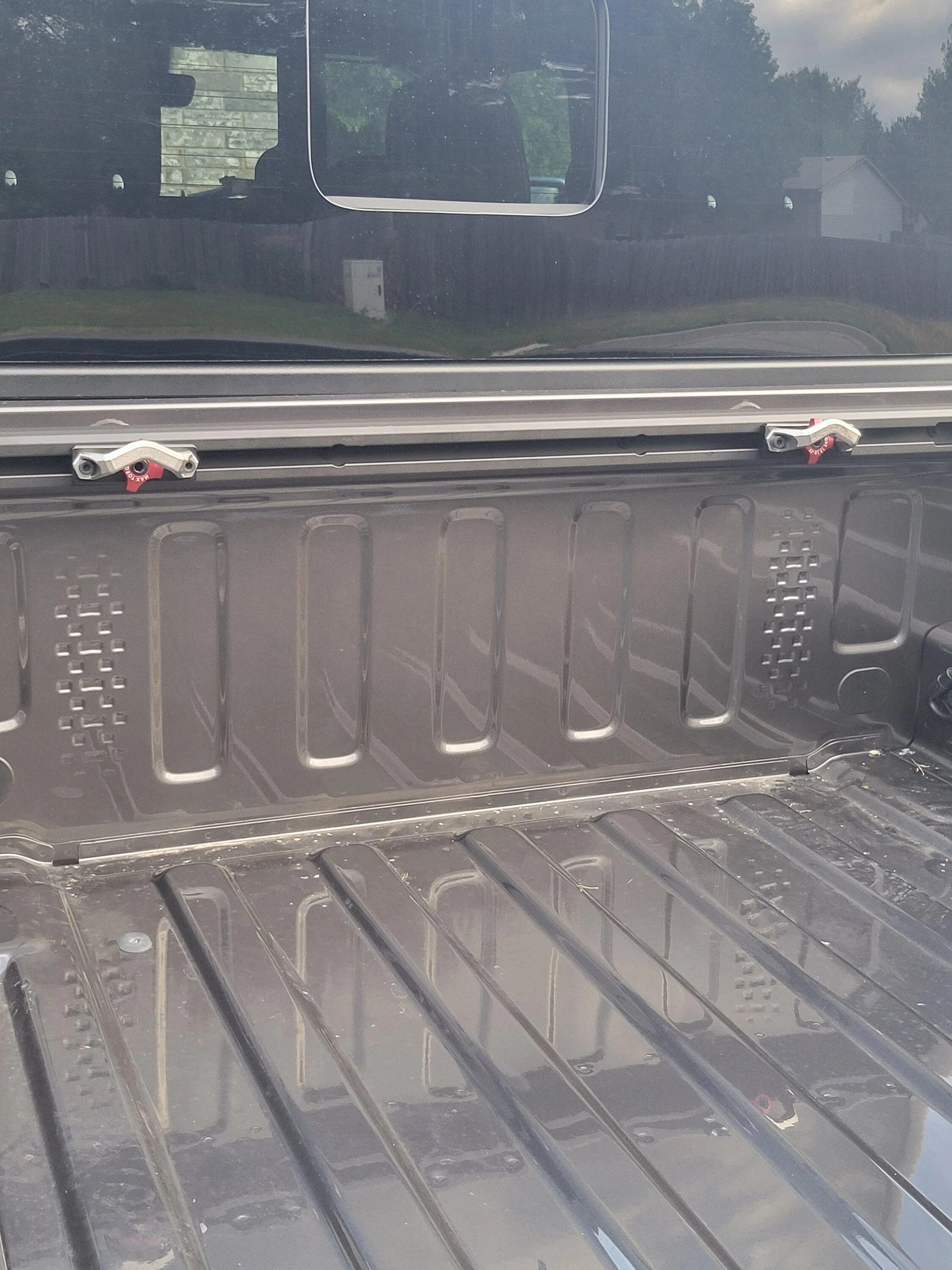

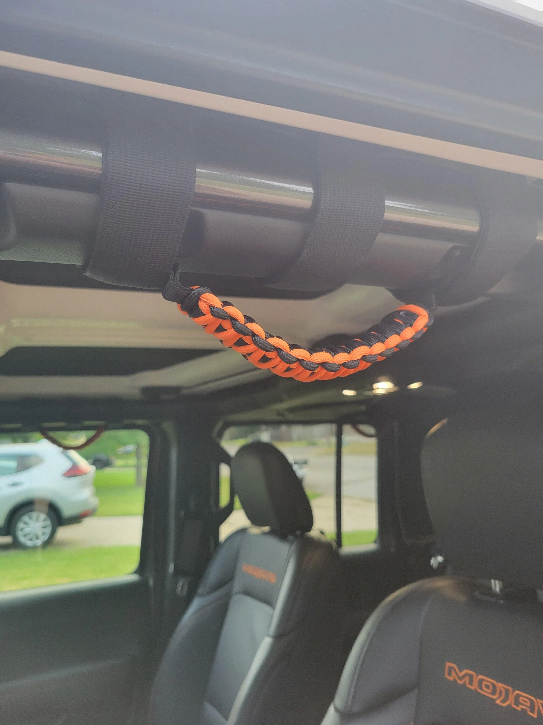

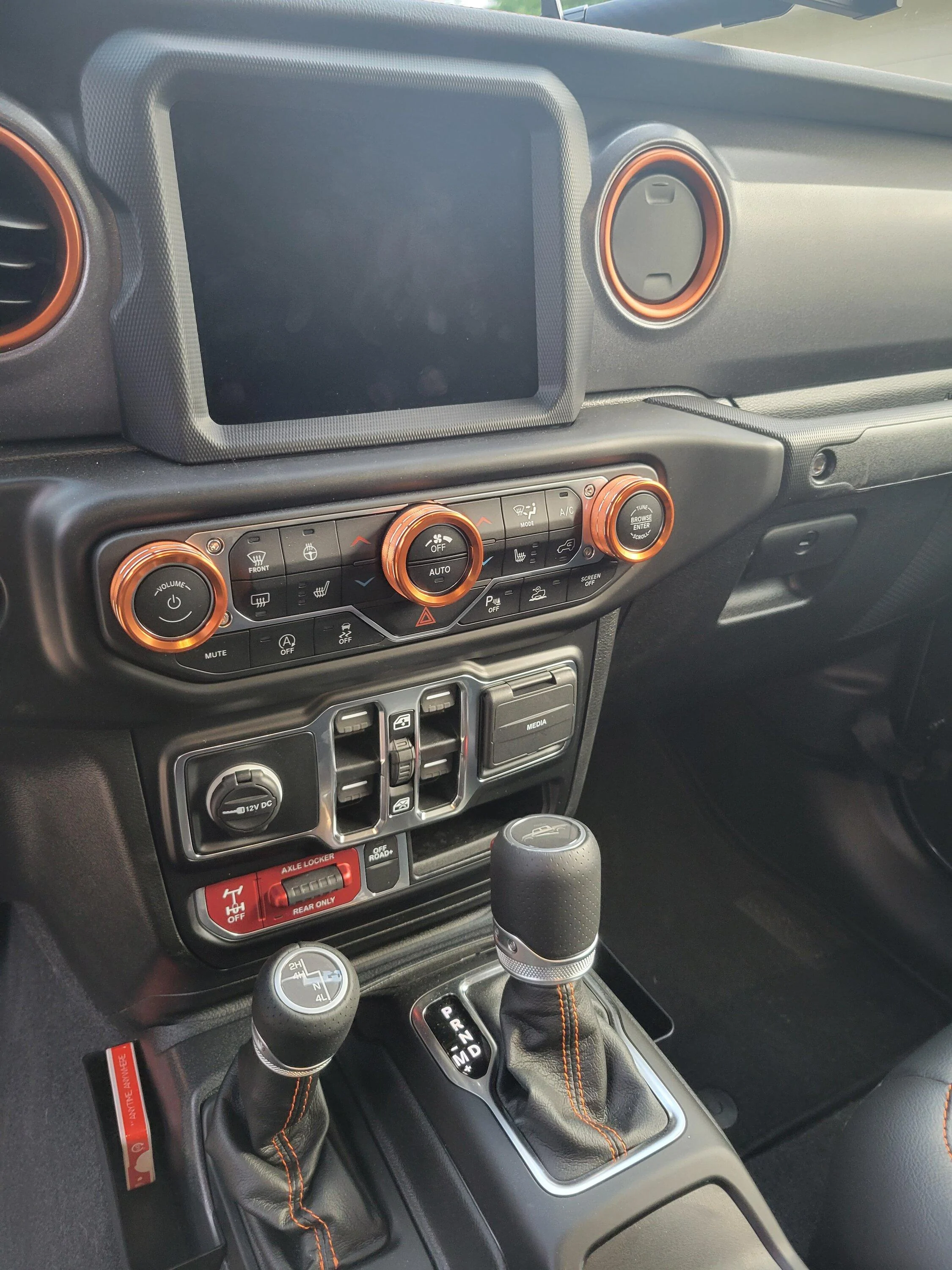

Didn't do it today but last Saturday added a few items.
Anodized orange knob covers
Fox 2.0 ATS steering stabilizer
Rival hood struts
Teraflex bed rails
Grab handles
Bulletpoint phone holders
And the only Jurassic decal that will be on it.
What are your thoughts on the Fox Stabilizer? Better drivability?
Just order adjustable and they’ll definitely work. 1/4” is a reasonable adjustment. I fixed close to a 10 degree pinion angle with 1/4” shorter on rear lowers and 1/4” longer on rear uppers. Now it’s zero.
