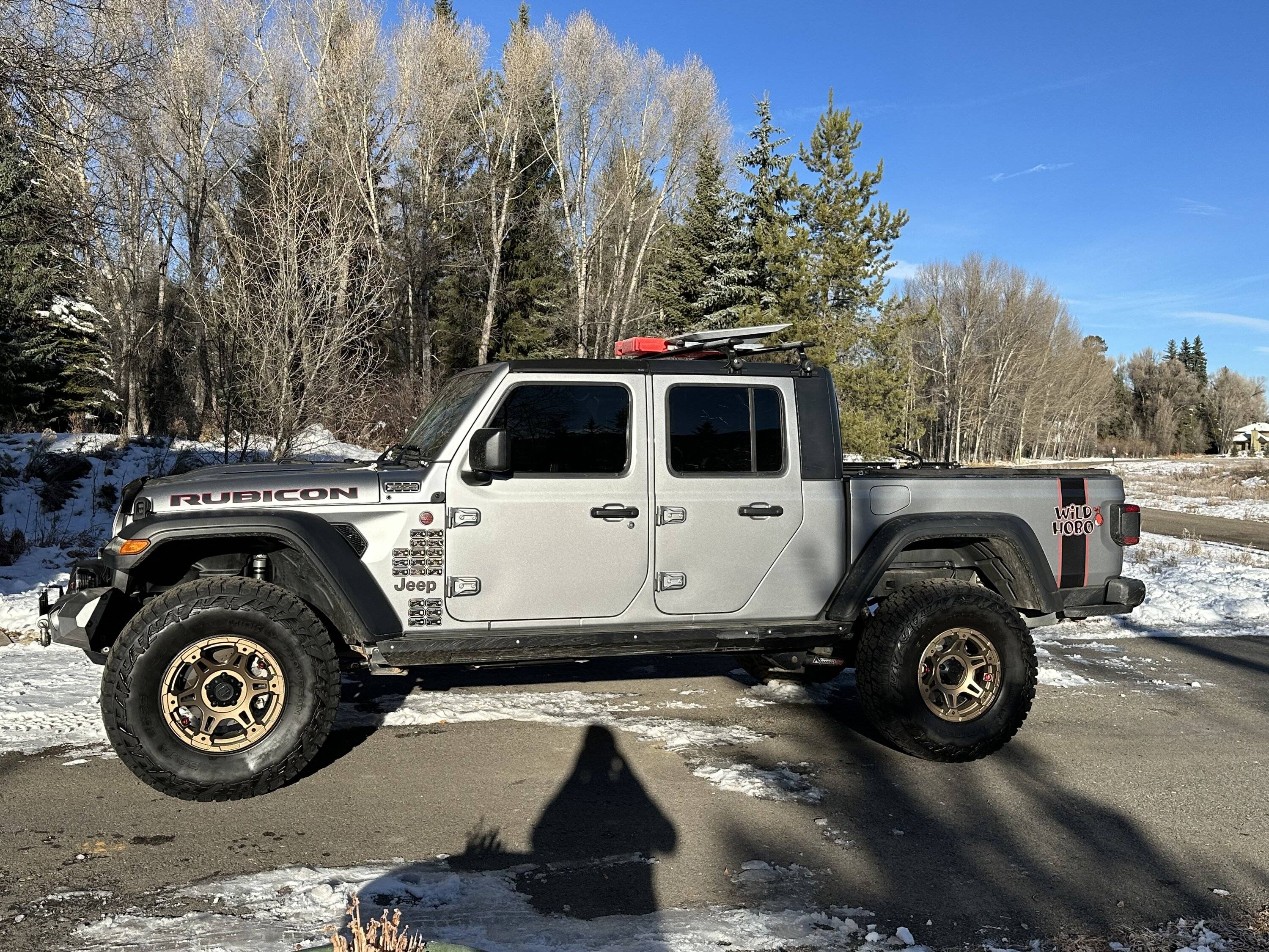

It might be the picture, but I think your rear tires are a bit forward in the wheel well. If you have adjustable control arms, you can fox that easily. Maybe it’s an illusion. Height looks great!
That was the first thing I saw as well.

It must have been an odd angle I was at, just ran out to the garage to look! Eye ball test says both are sitting dead-ish center

Thanks. It’s been driving me crazy with the level/sag. I absolutely hated rear squat when any weight was put into the bed and glad I got some time to finally getting it sit right.
I’m with you. I’m a big rake fan. I have bigger rear springs for the same reason.

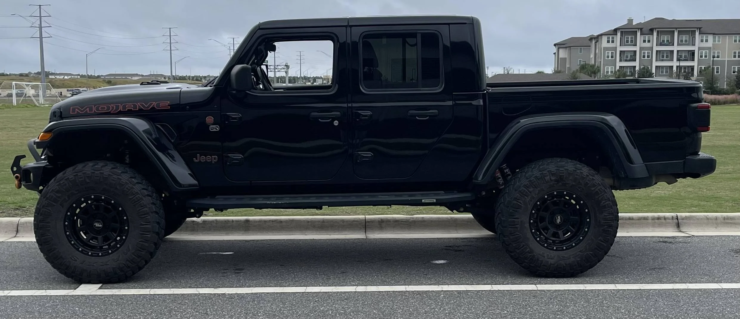

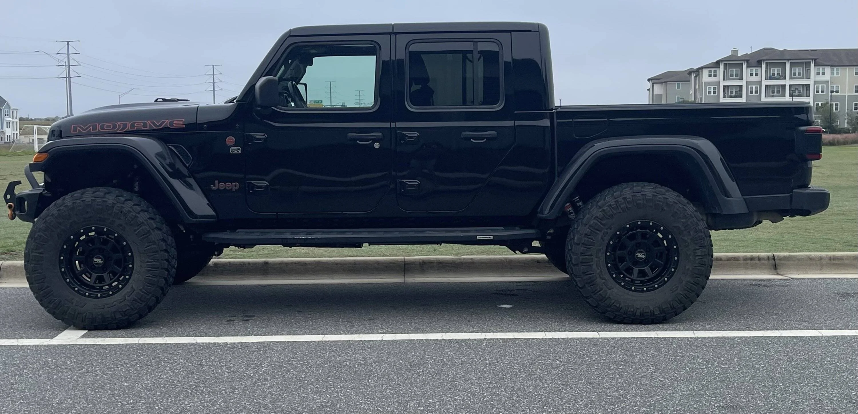

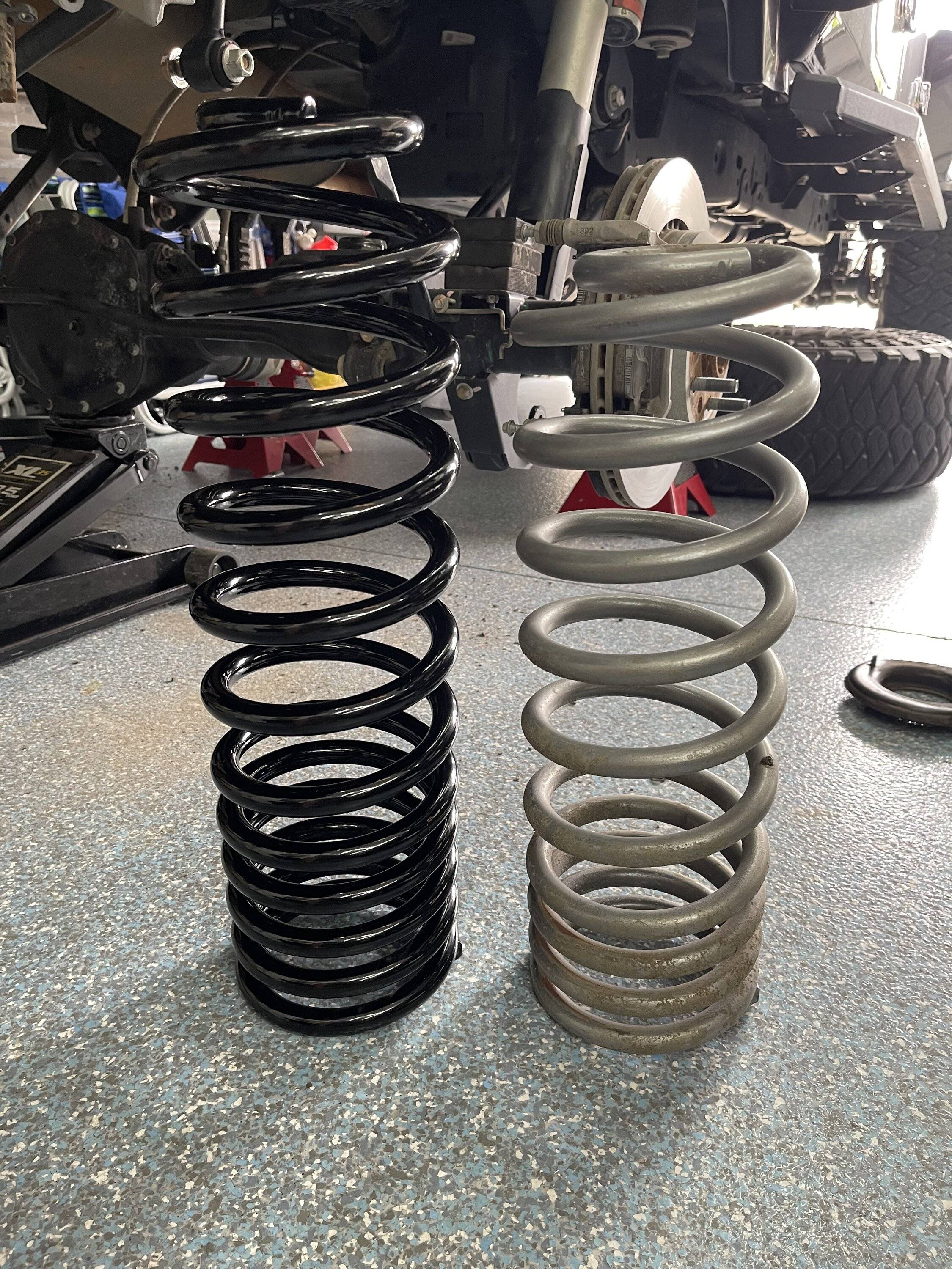

Swapped out RC rear springs for some Rancho HD 3.5” springs and Grimm extended rear brake lines. Wasn’t happy with the RC since install. Only gave me about 2” lift compared to the 4” I got in the front with their 3.5” kit. Happy with their ride so far on an empty bed.
RC springs
Rancho springs
RC 3.5 spring next to Rancho 3.5
What size tires are you running? I have a Clayton 3.5 lift kit coming this week and I am already on 35’s in my Rubicon. I like your setup and if those are 35’s then I may not need to go up to 37’s.

They’re 37s. I’ve seen quite a few running 35s on 3.5 lift and they look killer.

Thanks for the info, my plan is to ride out the 35’s till they need replaced and then re-gear and go up to 37’s. We’ll see how she looks with the lift and then decide.

Really and I mean REALLY nice build. That thing is sitting perfectly with that set up.

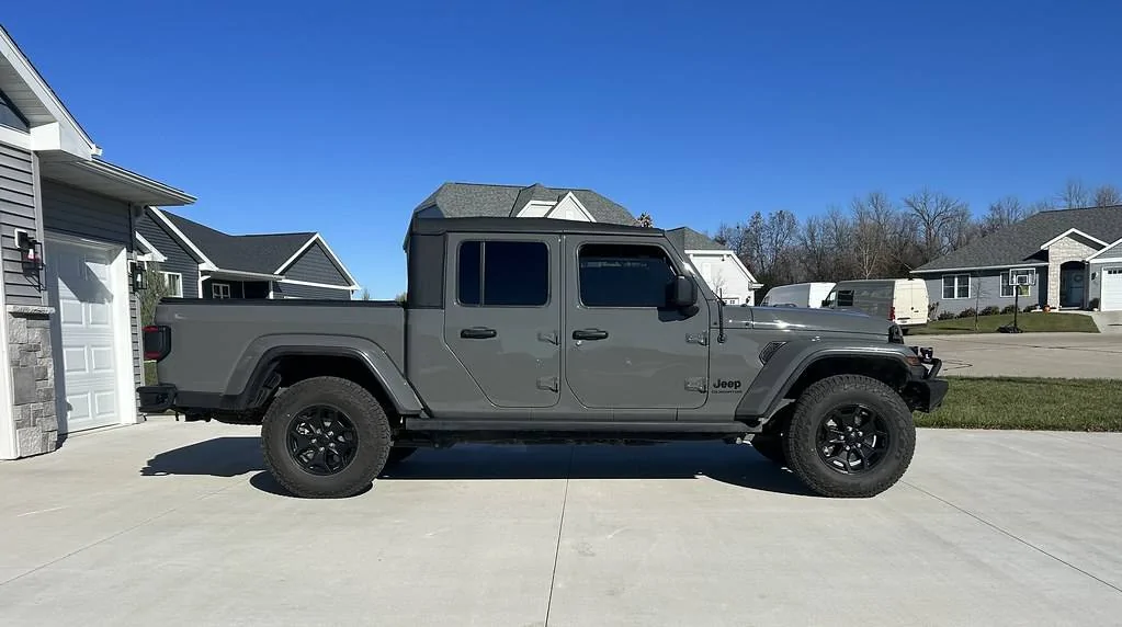

Removed the 3/4" Daystar level and installed a 1.5" level (Amazon Terraflex 1.5" knockoff). Looks much better in my opinion. With the bumper and winch it sits about exactly where I want it to. Doesn't look too bad with 33's either, which is what my main concern was.

I'm still on the fence about going to 35s... For sure they would look better, but I'm rocking a manual transmission and I'm not going to spend $2k+ regearing the truck. I also drive 90 miles a day for work, so the MPG hit would not be fun either, and I hear that 35s + manual + 3.73 gears = no bueno

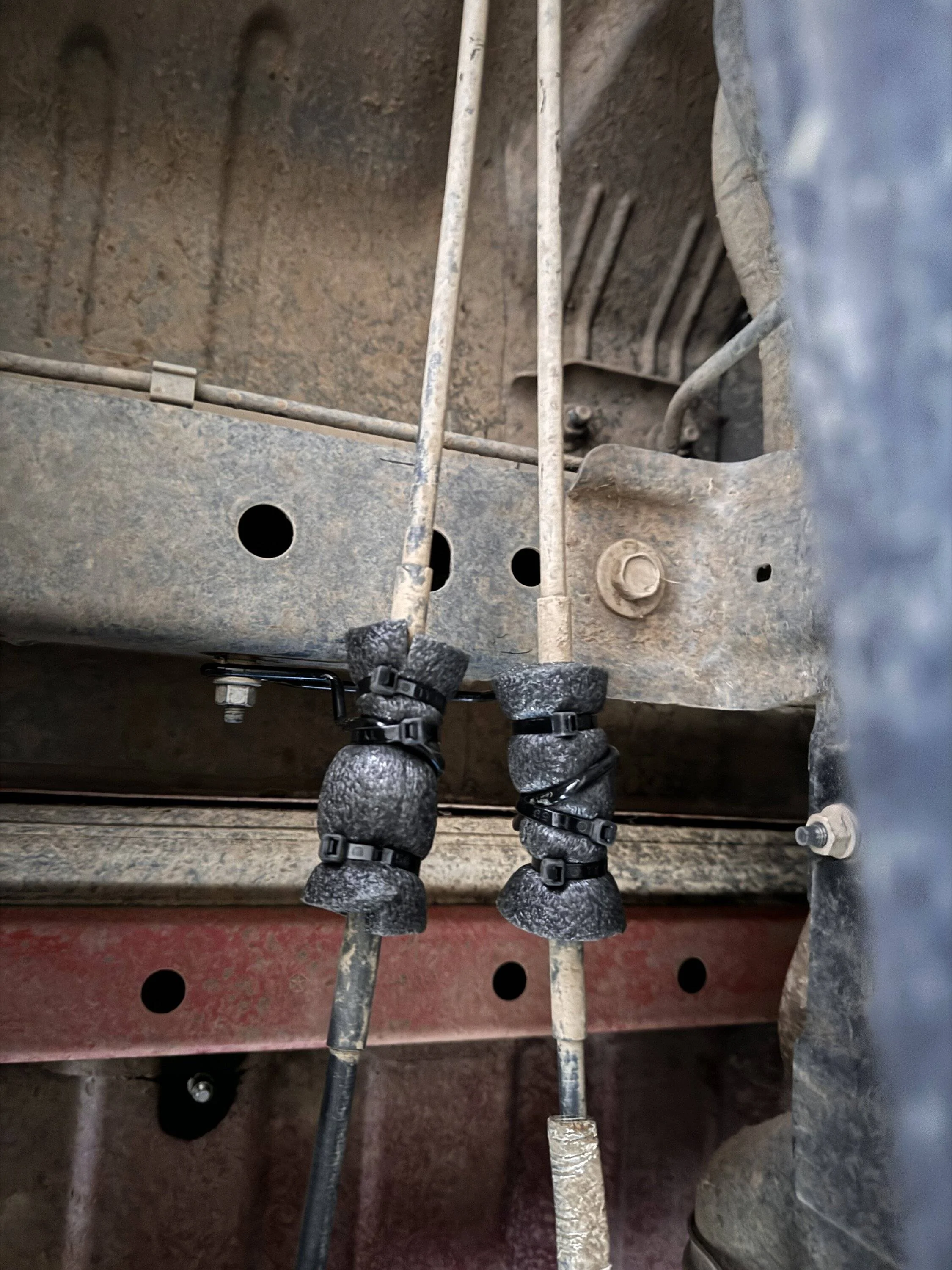

I’ve had a rattle noise that occurs usually when going over speed bumps. It’s a weird sound. It almost sounds like the suspension. It’s not. It’s Jeep’s stupid engineering. The e-brake lines go through a hanger under the center of the truck. The hard e-brake lines rattle against this hanger and the sound travels everywhere, through the bed, down to the axle, up to the body where they penetrate. I “cold forged” the hanger a bit to account for some pipe insulation which I zip tied in place. No more rattle. It’s incredible how much more solid this truck sounds now, going down the road.

I'll have to check that tomorrow, I bet that's what's been rattling over bumps on my truck as well!
