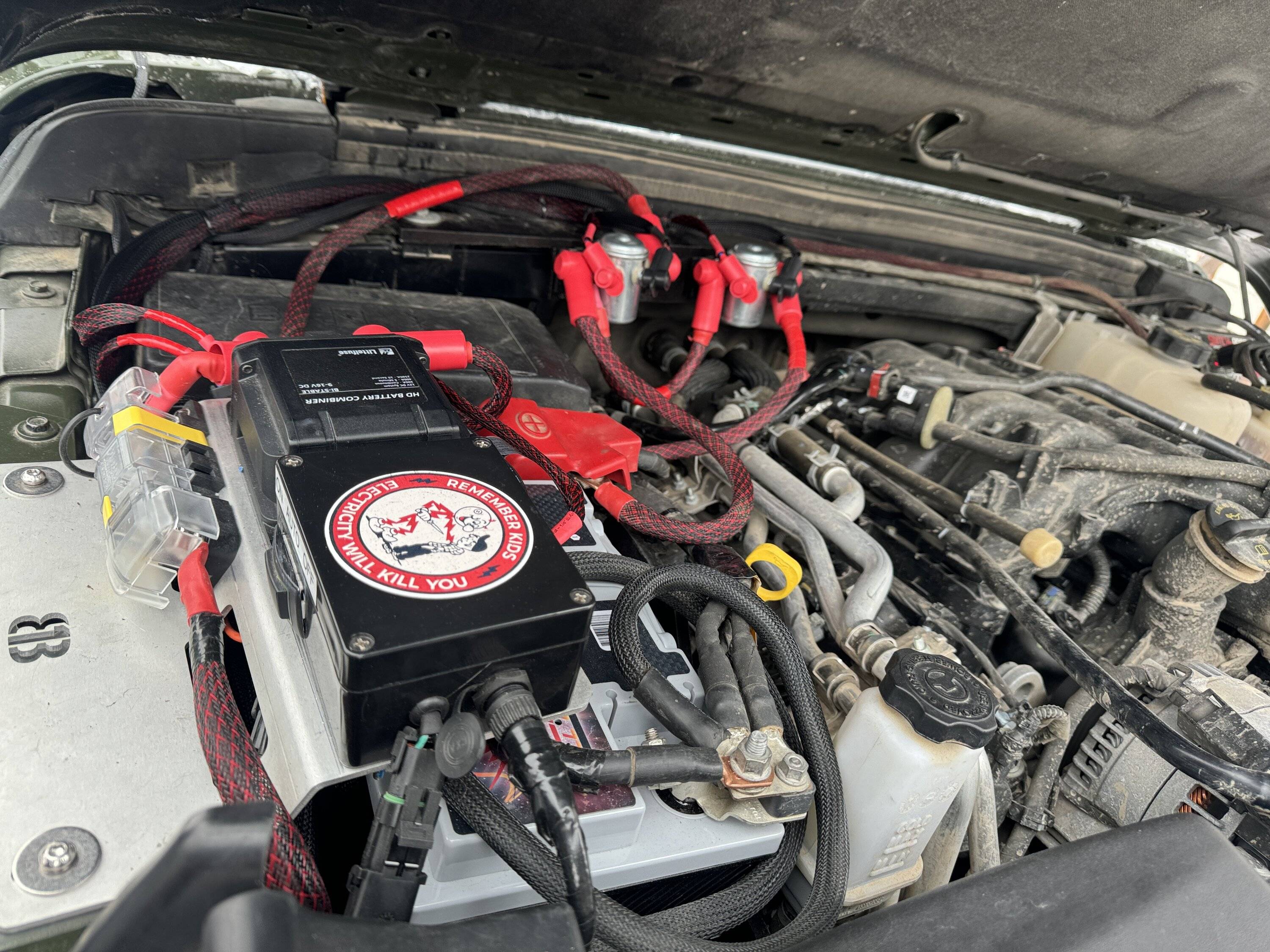

Decided to finally re-do some winch wiring.
Jeep Gladiator What did you do TO your Gladiator today? [ADMIN WARNING: NO POLITICS, NO GUN TALK] IMG_3646.JPG
A few friends wanted to observe.

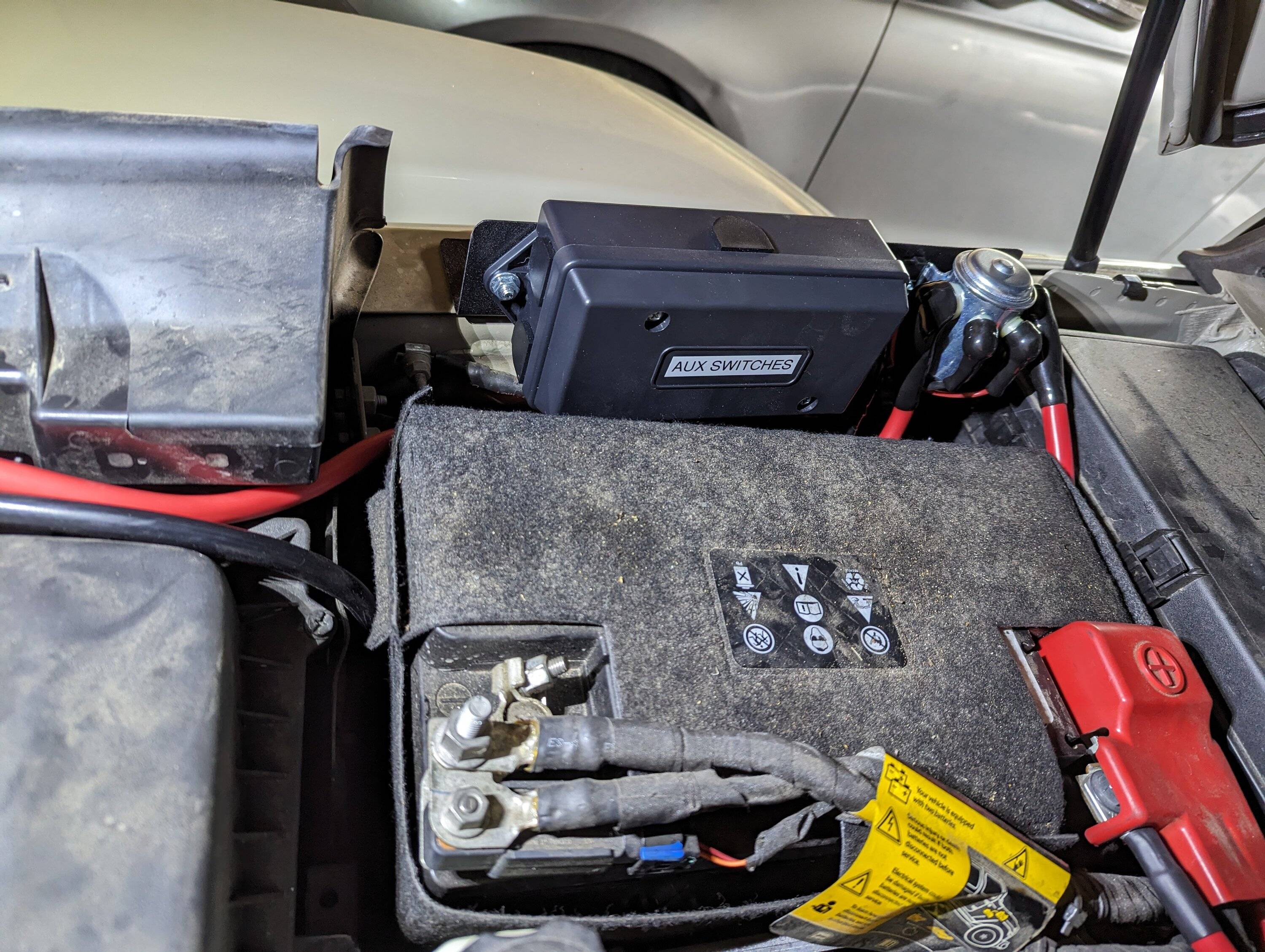

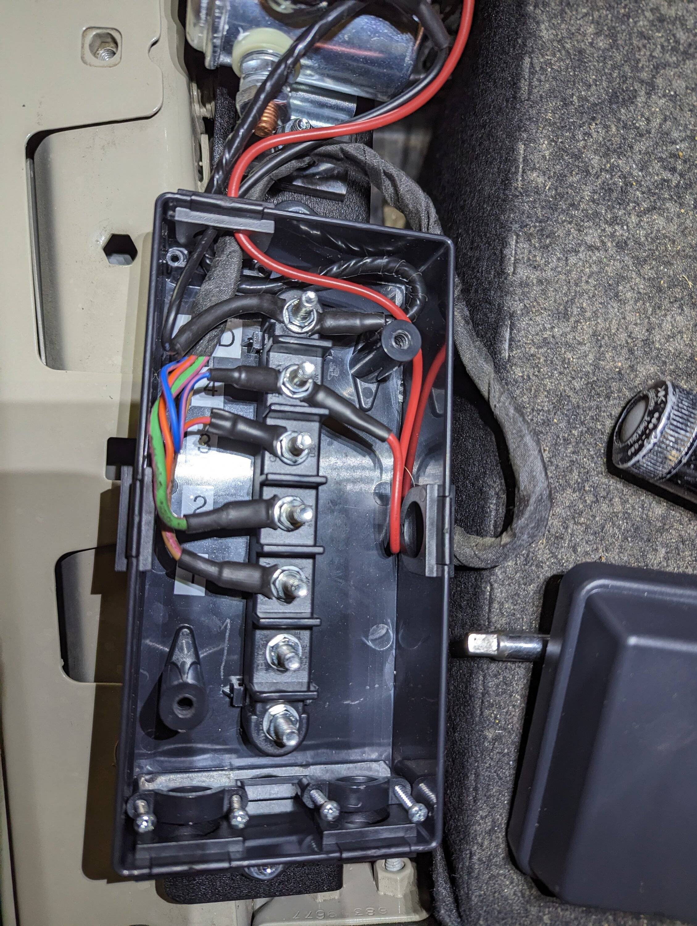

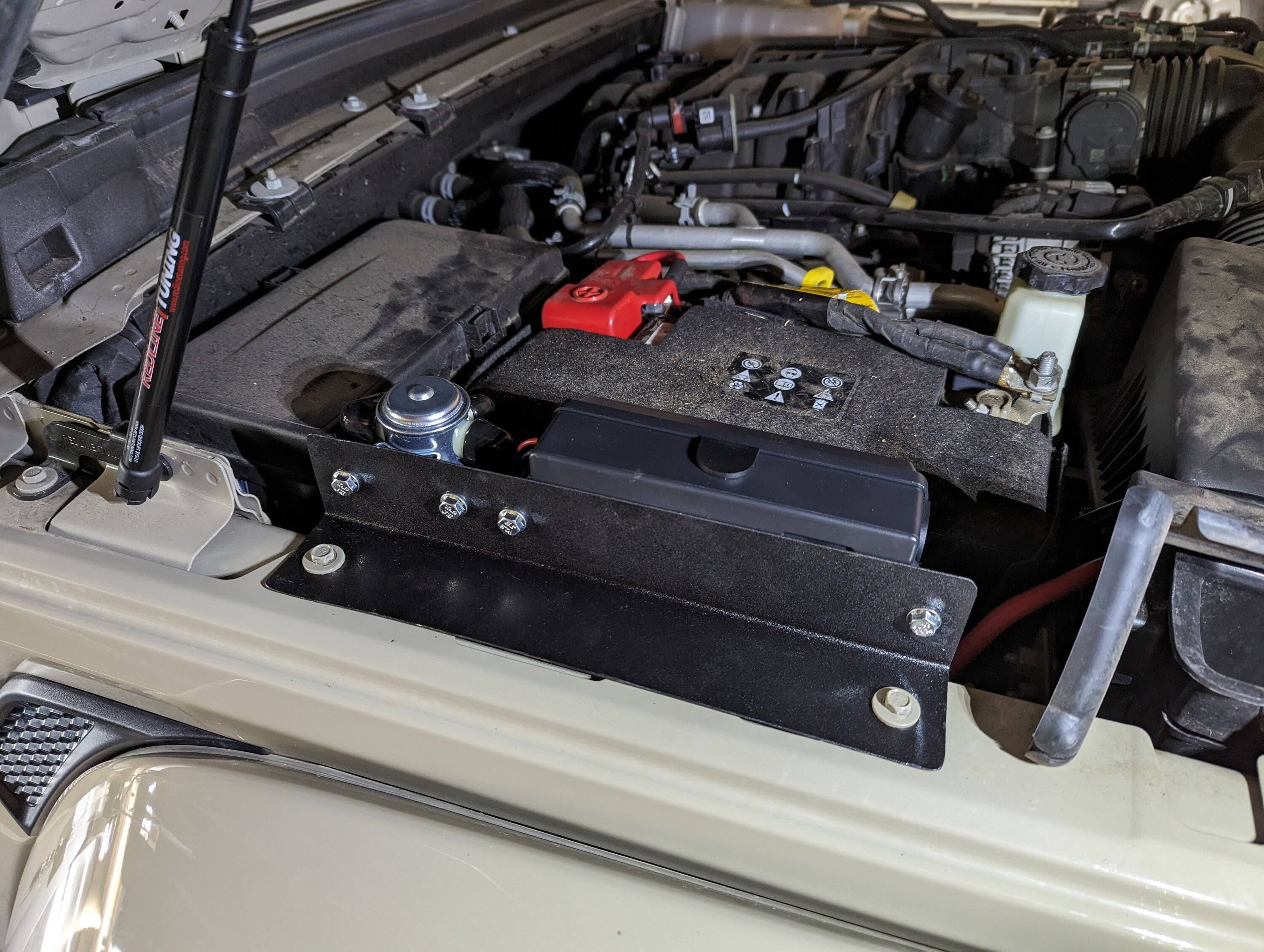

Today I installed a Warn Winch Power Interrupt Kit that I wired up to the Mopar Aux switches. I made the bracket out of some scrap .063 6061-T3 aluminum that was 4-1/4" x 12". For the terminal board I used a 7-way trailer wiring box for water resistance. I put a strip of camper foam tape under the bracket so it doesn't scratch the fender.
The Redline hood struts clear the bracket with plenty of clearance and so does the hood. Keep in mind this is on a Mojave with the higher hood. You could drill the holes down further for the Solenoid and Junction box if clearance is an issue on the other models.
Parts
WARN 62132 Power Interrupt Kit
7 Way Trailer Junction Box
Camper Foam Tape
Misc Nuts, bolts, terminal ends and shrink tubing.
If I was going to do it all again I wouldn't have used the Warn kit and only picked up a Solenoid since a lot of the kit went unused. The red power cable was also barely long enough to reach the battery so I may end up making a longer cable in the future to increase the bend radius where it hooks up the the battery.
Also If I was buying the metal to make the bracket, I would get a piece of 1/8" thick 2" Aluminum angle like this. The thinner piece I used has some flex but seems rigid enough for now. I'll keep an eye out on the bend for cracks as I suspect that's where they would develop.
I still plan on routing the cables to the winch under the air filter box and wrapping them in some tubing for protection when the air filter I ordered arrives.

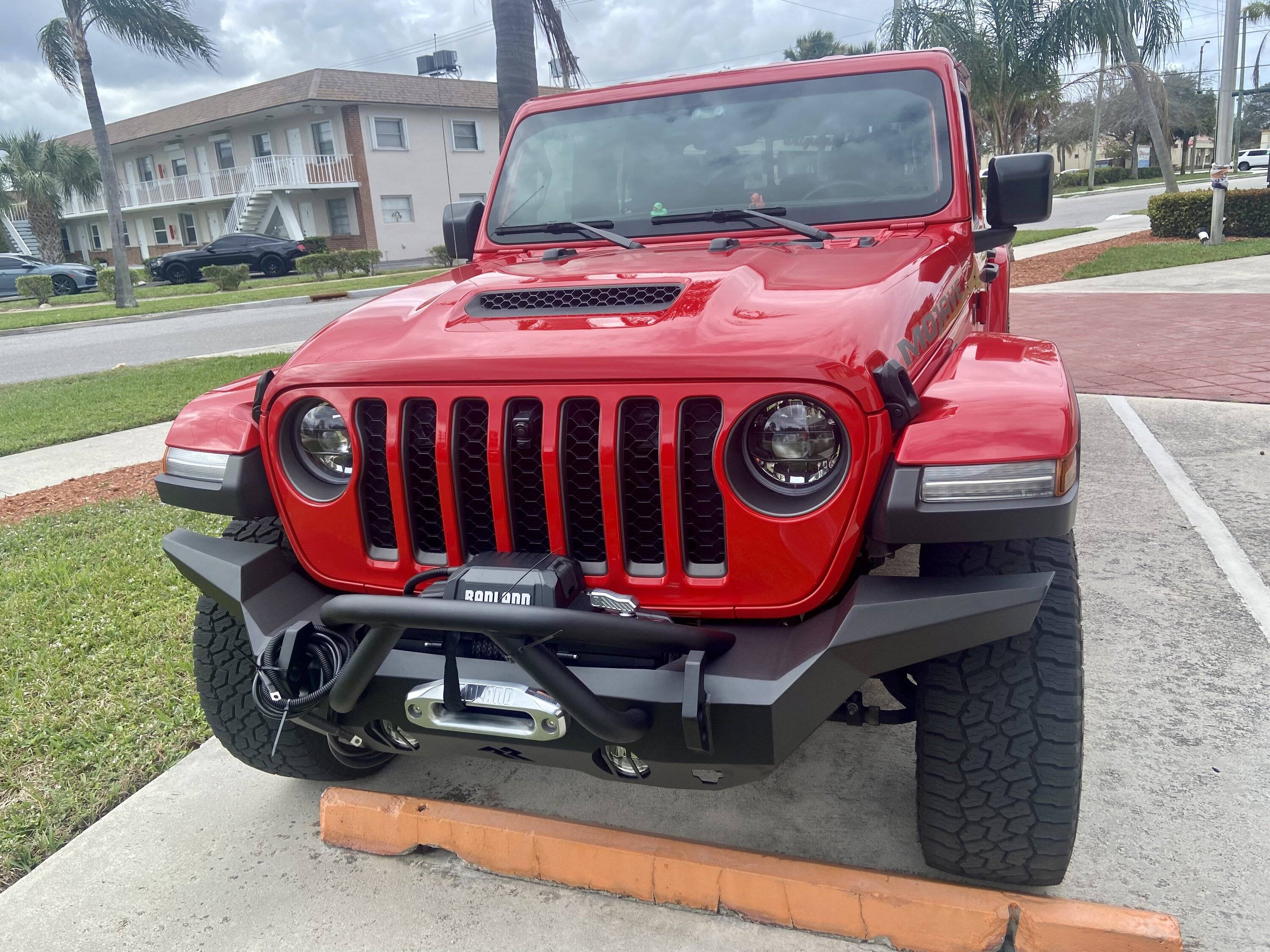

It was actually yesterday (Sunday). I installed a Rugged Ridge HD Full Width Front Bumper with the Rugged Ridge X-Striker Bar and a Badland Apex 12000 LB winch. I still need to wire up the winch (ran out of daylight) and reinstall my Mojave skid plate.

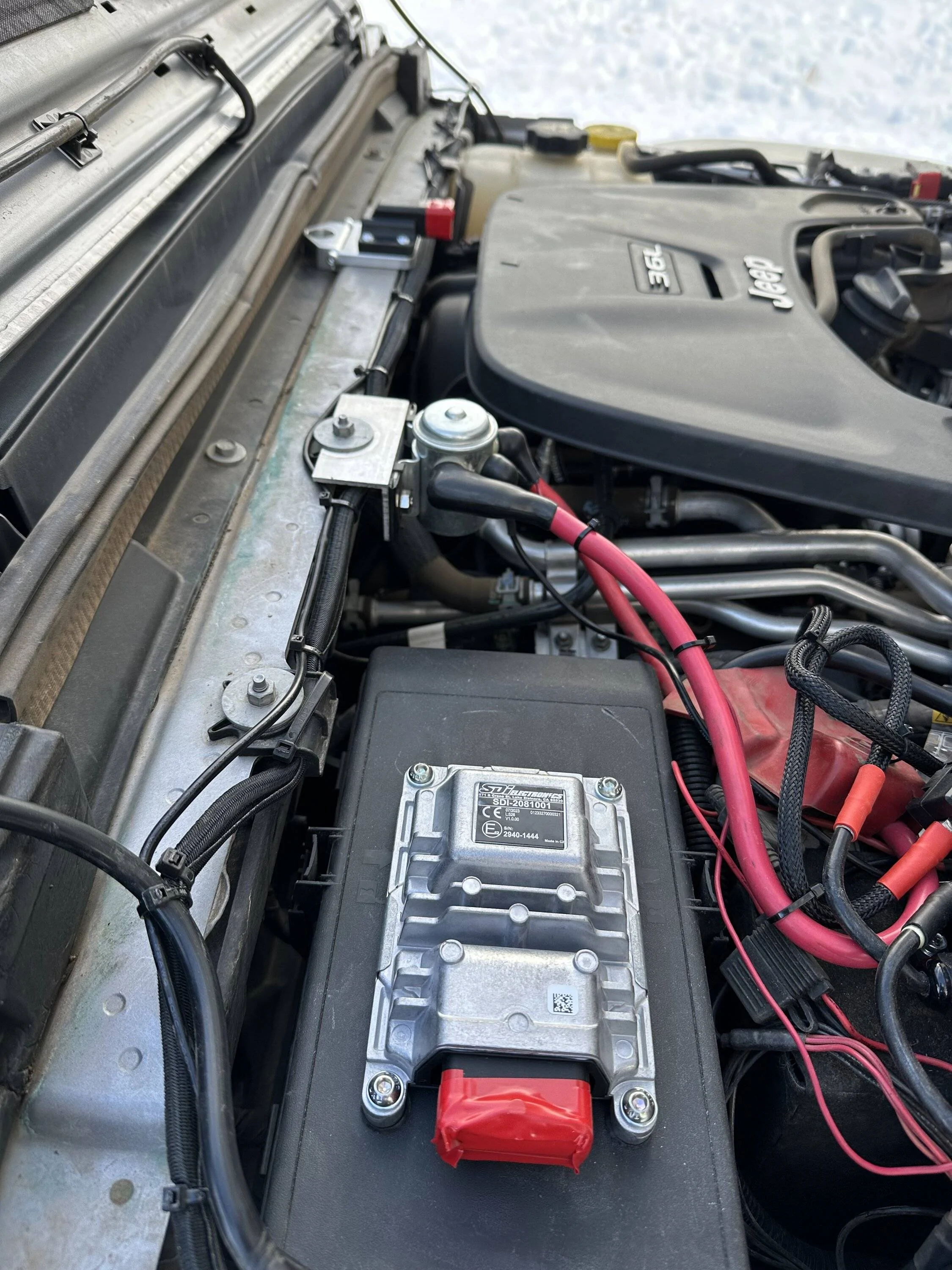

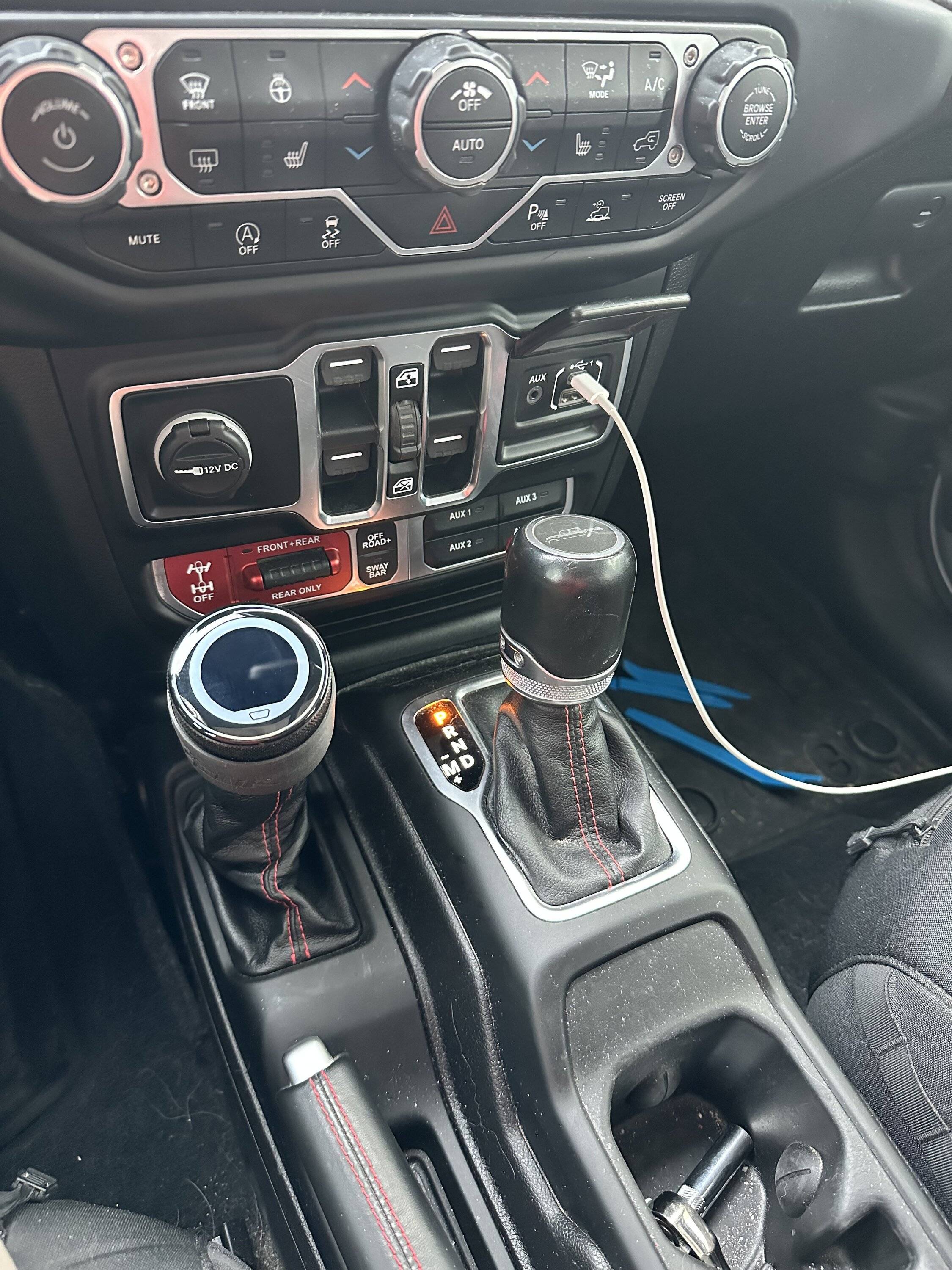

As a start to the EClik shock install, relocated the charge controller in the way, mounted the ecu and inertia/tilt/roll sensor, and installed the new t-case shift knob/clickwheel/touch screen. I’ll wire it all when I install the shocks later this week.
How much wider/taller is that new knob? I have a problem with wanting to rest the side of my knee against it.
Pretty significantly. It’s close to the size of the tranny knob.
