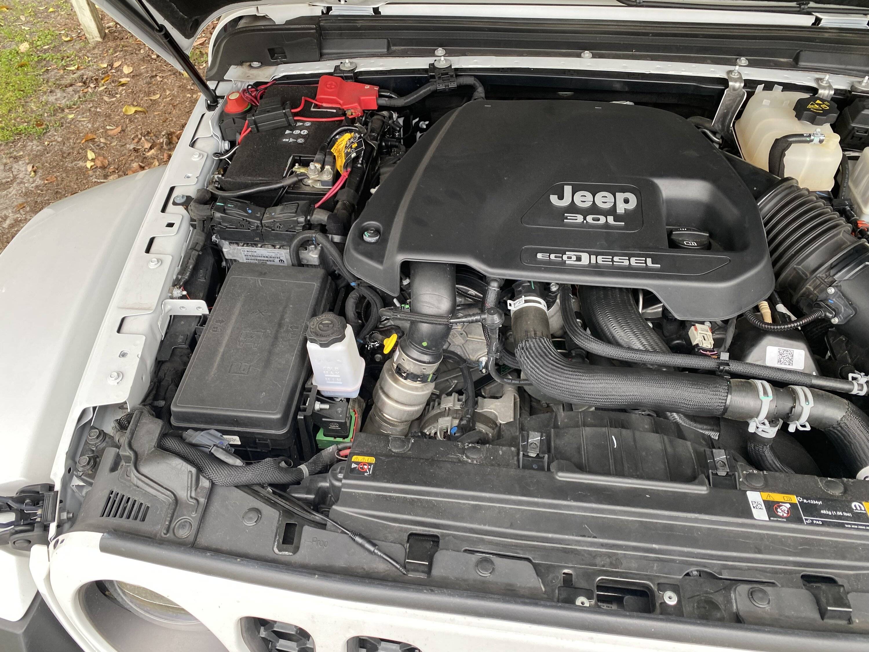

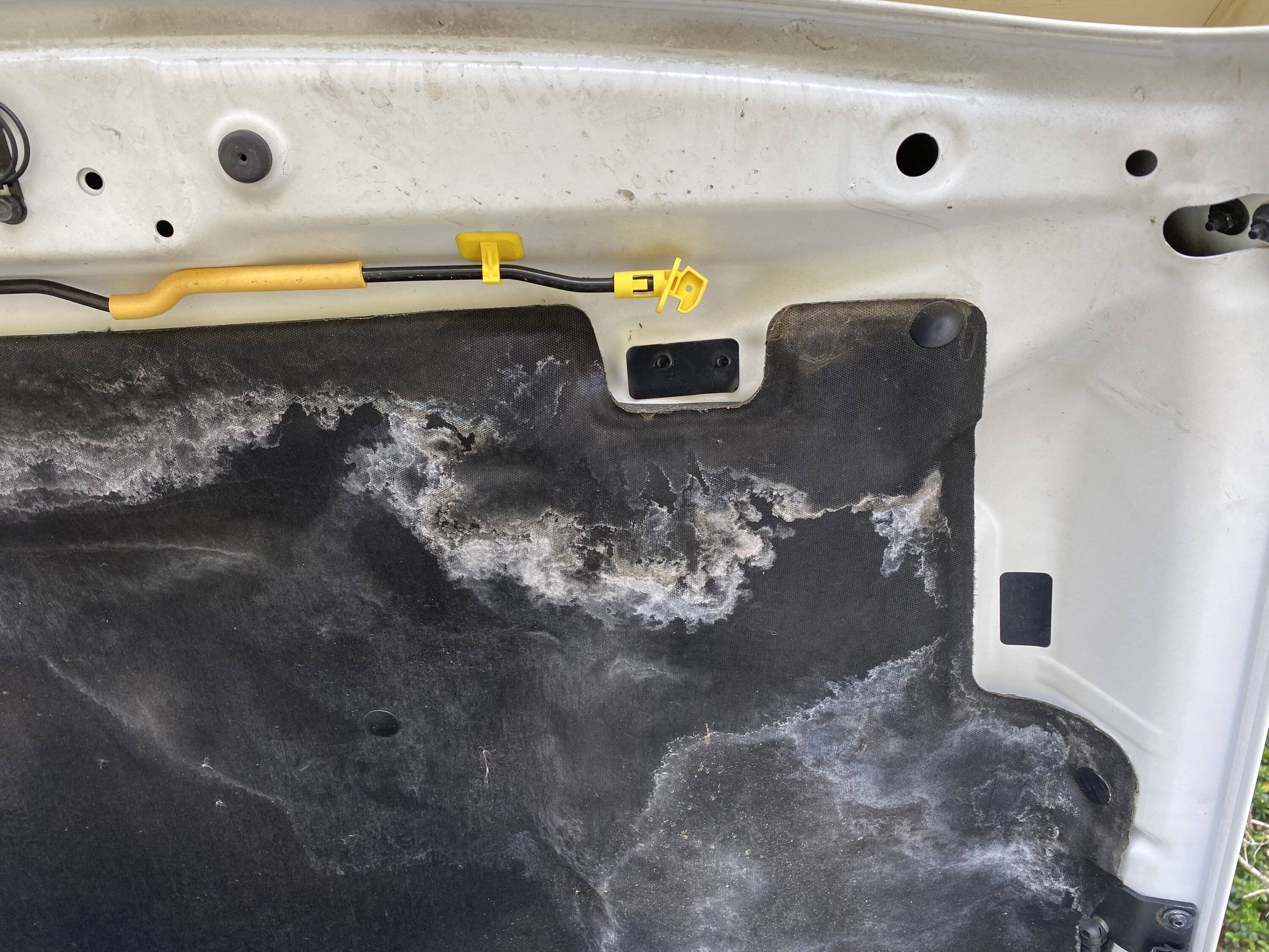

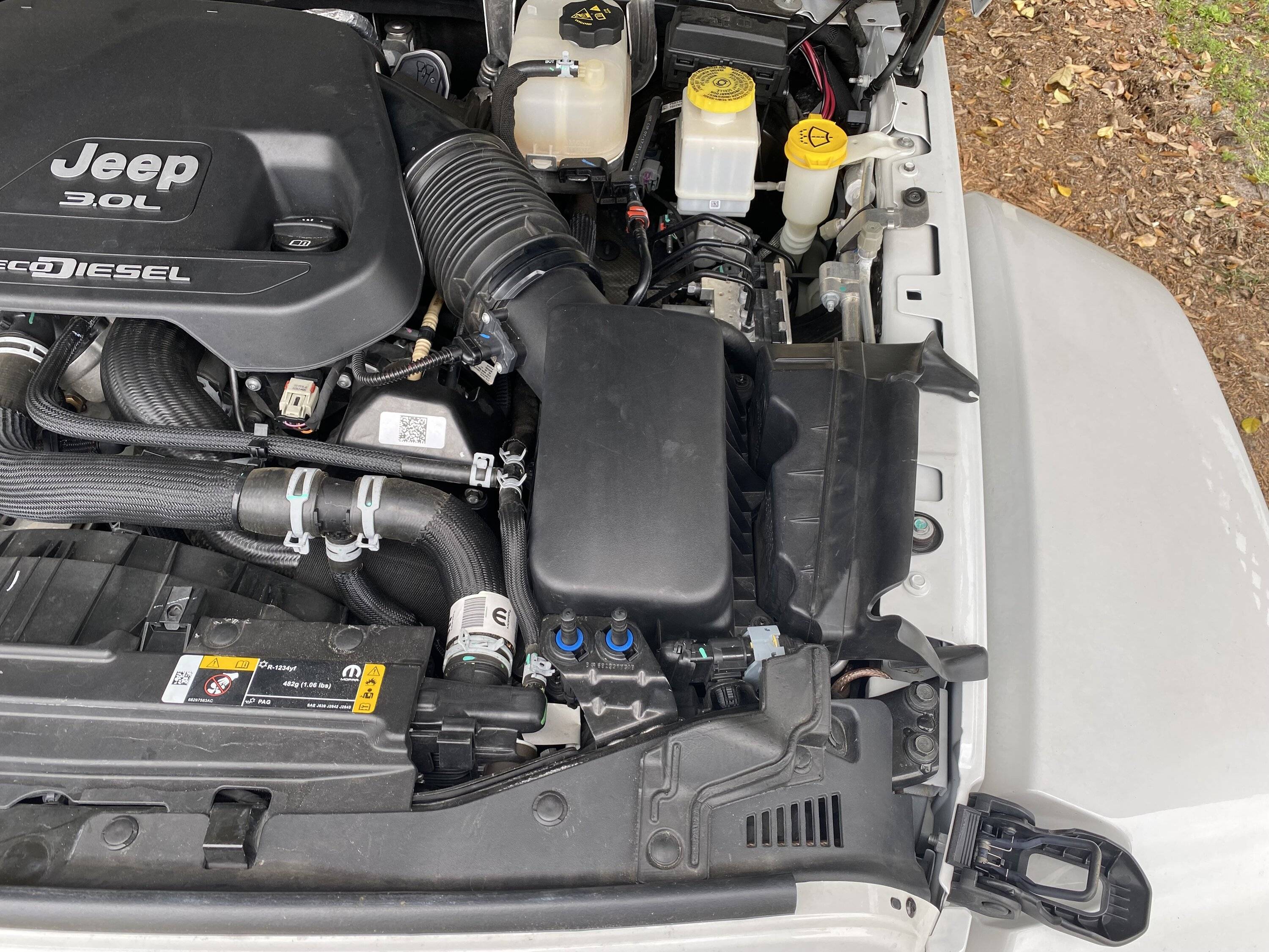

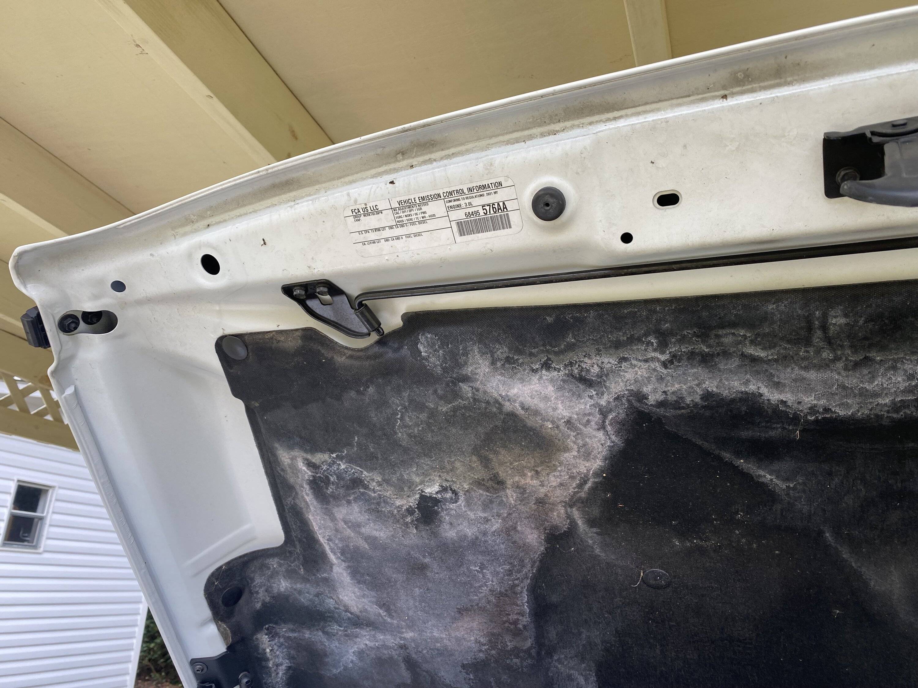

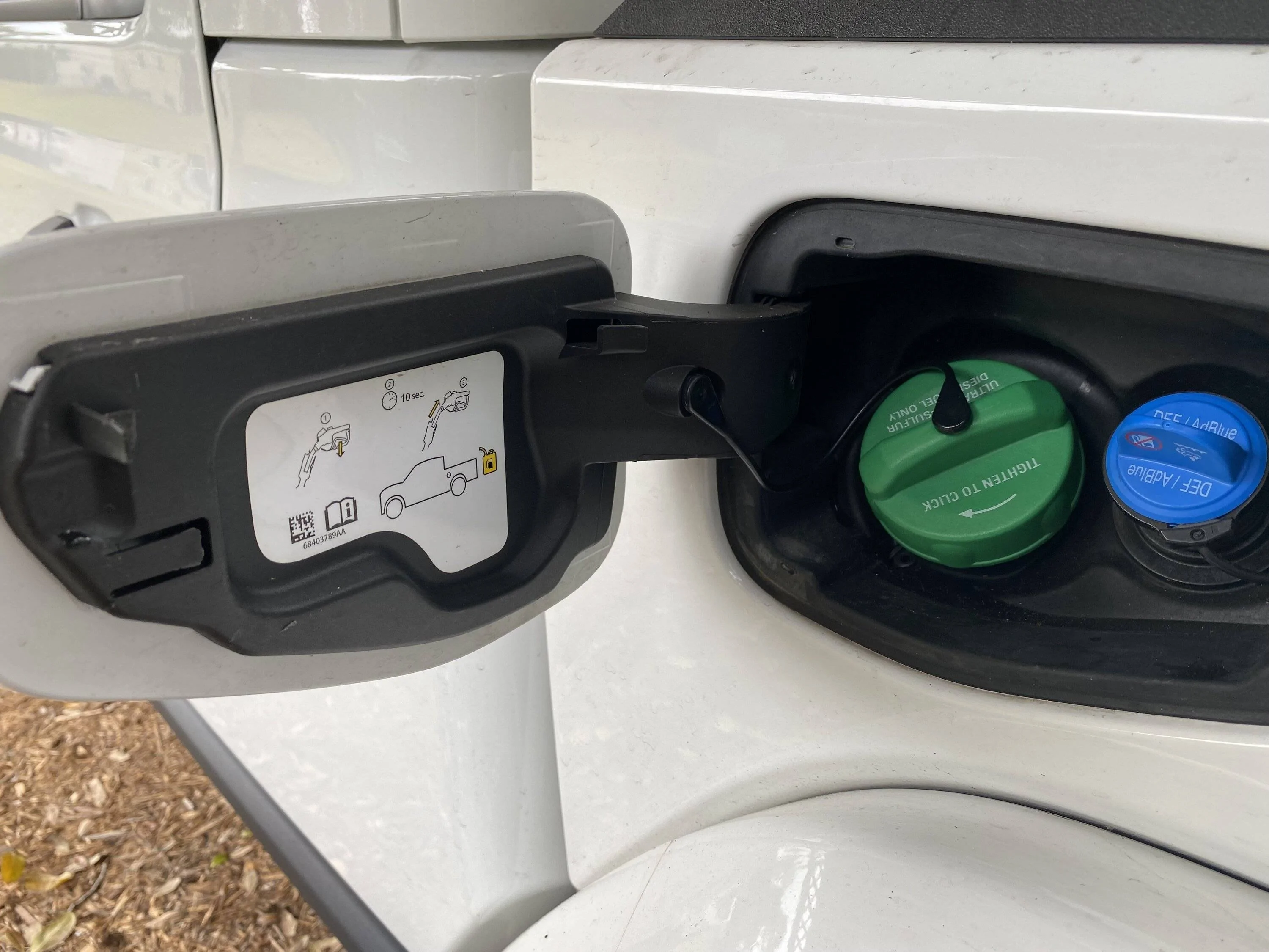

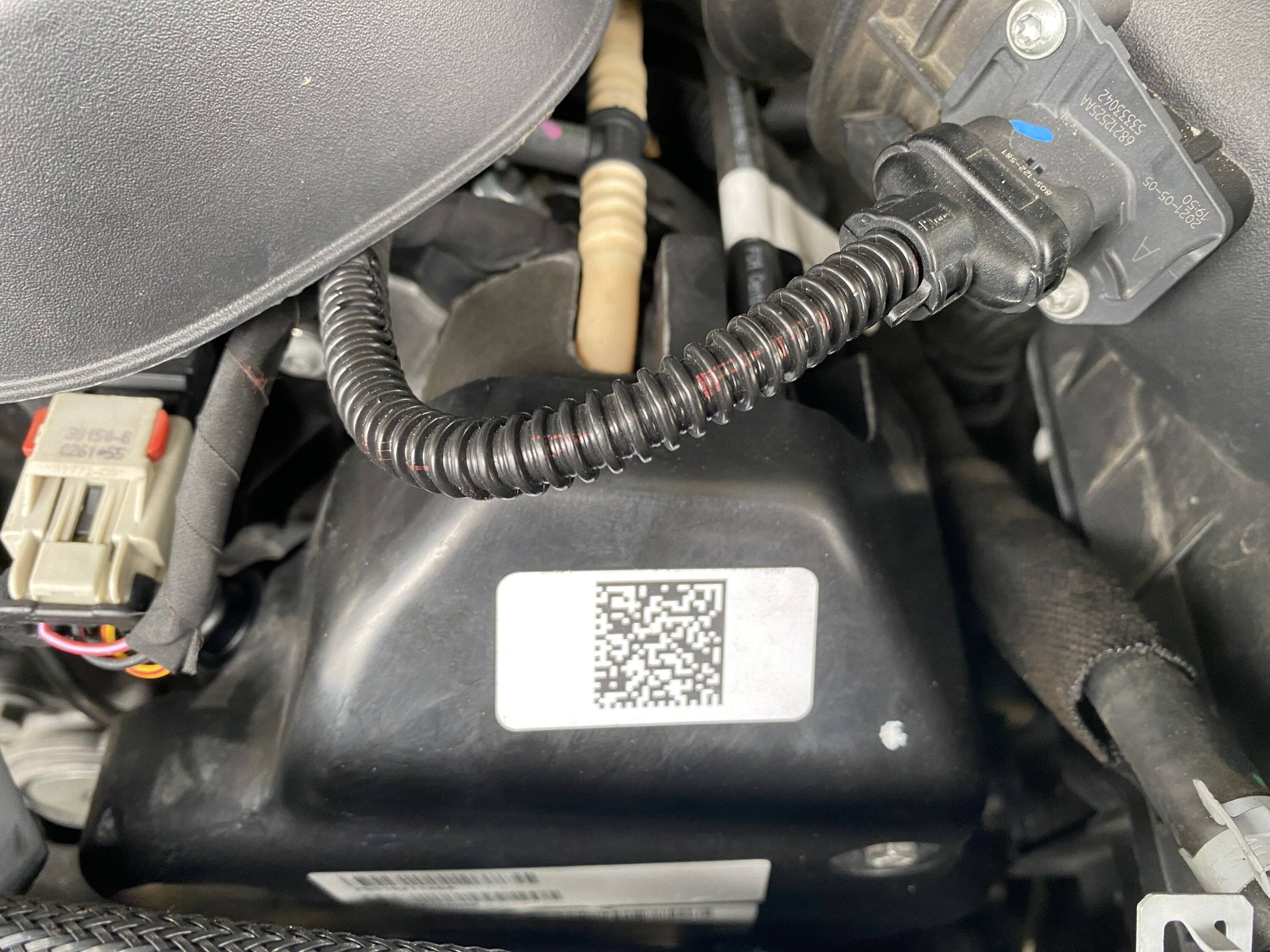

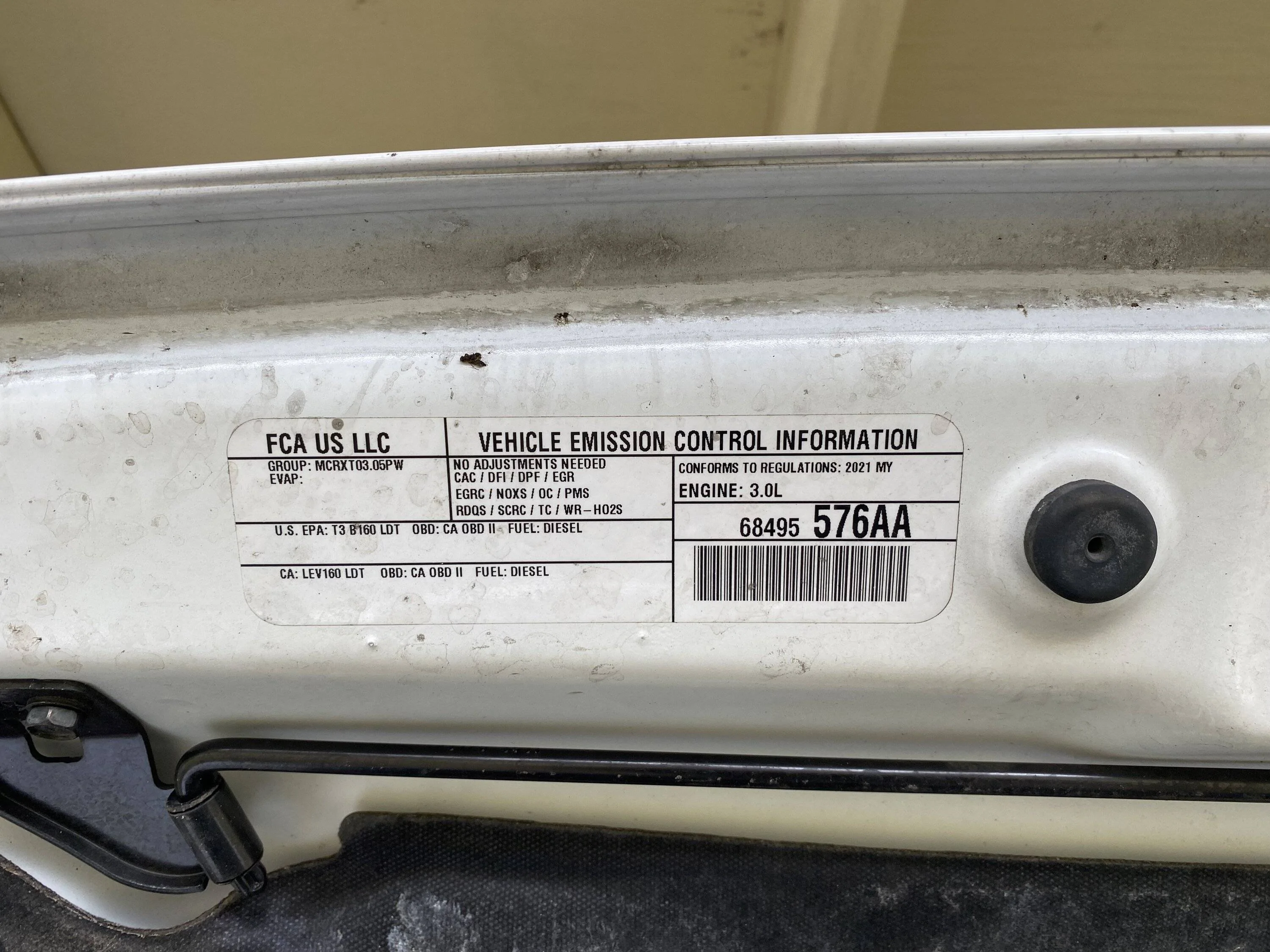

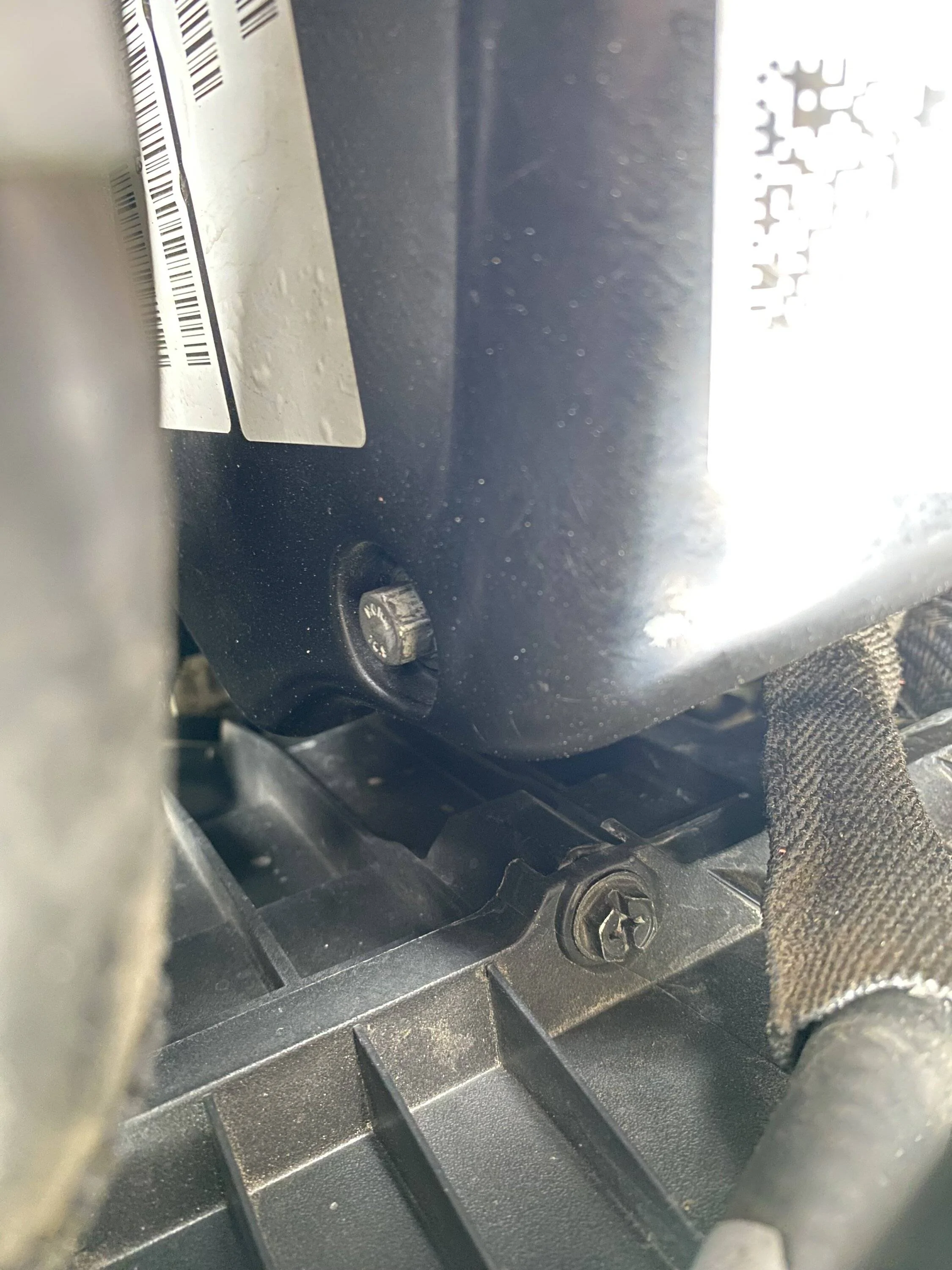

Well…. I’m not exactly sure what they did. I only see 1 bolt head that looks like a socket was on it. No stickers under hood, drivers door jam or fuel door. No instructional flyer on the dash, center console or front seats.
I didn’t even get a receipt from being there or for work completed. They said they’d email it to me once the tech completed his report.
they did however confirm my front drivers side warranted shock was bad and would order one in.
I had to ask for my stickers and the other papers that go into the manual. I asked for and got my old pump. When I picked it up to look at it. It was still warm.

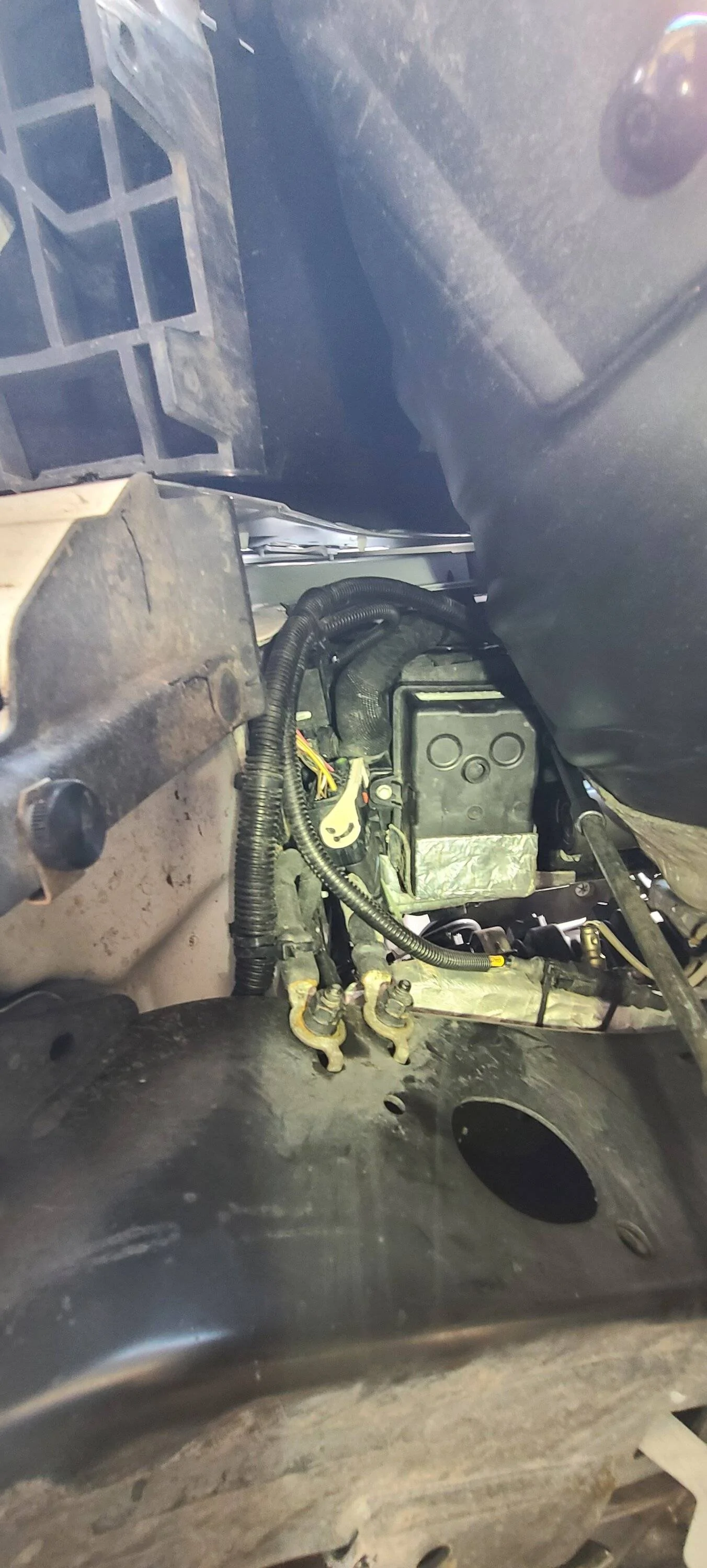

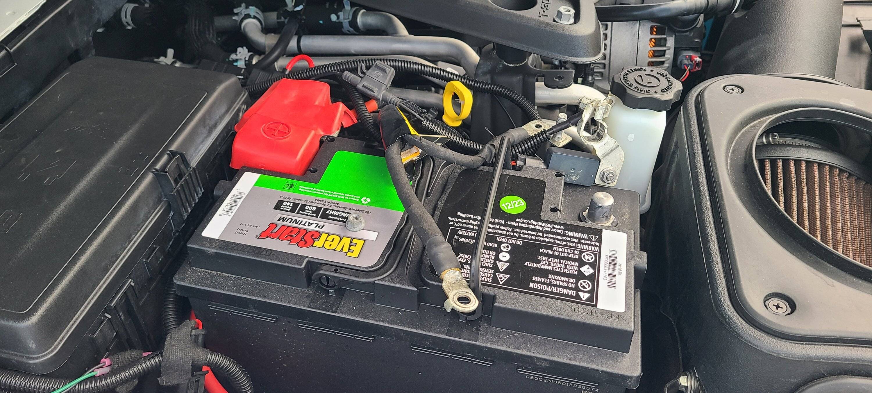

I had the ESS warning light pop up last week so checked the voltage on the 2.5 year old oem batteries and knew it was time to replace them. Yeah warranty could have replaced them but I despise going to the dealer for anything. Probably took less than 30 minutes to replace both. Went with the Walmart H7 AGM with 800 CCA's and 4 year warranty for the main and the Super start AGM for the auxiliary. Despite reading and watching many recommendations to pull the fender to do the aux battery swap I was able to just reach up and pull it down from underneath without too much difficulty. Helps to have specialty tools for the long reach to the bolts and a lifted truck.
You are better off for having avoided the dealer on a battery replacement. They have a ridiculous multi-hour procedure they have to go through to validate and document the batteries needing replacement under warranty. Most warranty replacements are just a matter of a tech verifying that the part doesn't work, but for the batteries they charge them, discharge them and a hole rigamarole.
Not to mention, if they replace it, you get the same cr@p battery that it came with...

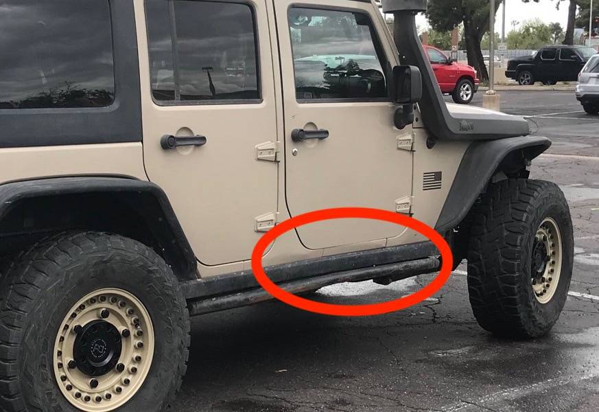

@CyberHero based on the question you are asking and the fact that Shrockworks is OOB, you may be tempted to look at the Ace Engineering sliders. My 2016 JKUR's personal recommendation would be to stay away from the Ace sliders. Here's what happened to her:
Jeep Gladiator What did you do TO your Gladiator today? [ADMIN WARNING: NO POLITICS, NO GUN TALK] WranglerBentTub
The ACE sliders mount using the body mount bolts. Between where they mount and the frame are BIG rubber bushings designed to accommodate the frame flex and not transmit to the tub. This means that if you come down hard on that slider, it will flex upwards, compressing the bushings and striking the tub. You can see the buckled tub in the pic. It also changed the door gaps all the way around the door...
If you want a good cosmetic look, the Ace sliders are fine. If you are going to wheel that rig and USE those sliders, ditch the Rubi Rails (because they can allow for the same thing to happen) and get rock rails that bolt or weld to the frame. My $0.02 USD
And they’ll likely leave something loose, blow a fuse, or short something out.

Was it the original battery? I know you have quite a few miles but it wasn't that old based on the year of your truck. My last vehicle did the same thing but my battery lasted about 6 years. Didn't give any warning or sound weak. Got in at work and it wouldn't start. Maybe that's just the way they work these days. Did you consider doing the aux battery delete? I have seen mention of it but have not researched how that works and if there are any issues if it's done. I have not had mine long but so far like you I am loving it. You need to plan that road trip to go see @WILDHOBO.
It was the original 650 CCA battery from the factory. Lasted 3 years 2 months
I have consider aux battery delete but this stuff has so much electronics didn't want to screw something up and replaced the aux back in the early fall
I agree completely. I’ll leave the system like it is when it’s time. I’ll replace with higher quality, but equal setup. Mine are still original and have lasted since July ‘21 and almost 50k miles. I attribute their decent life span to the hood solar that constantly maintains them.
