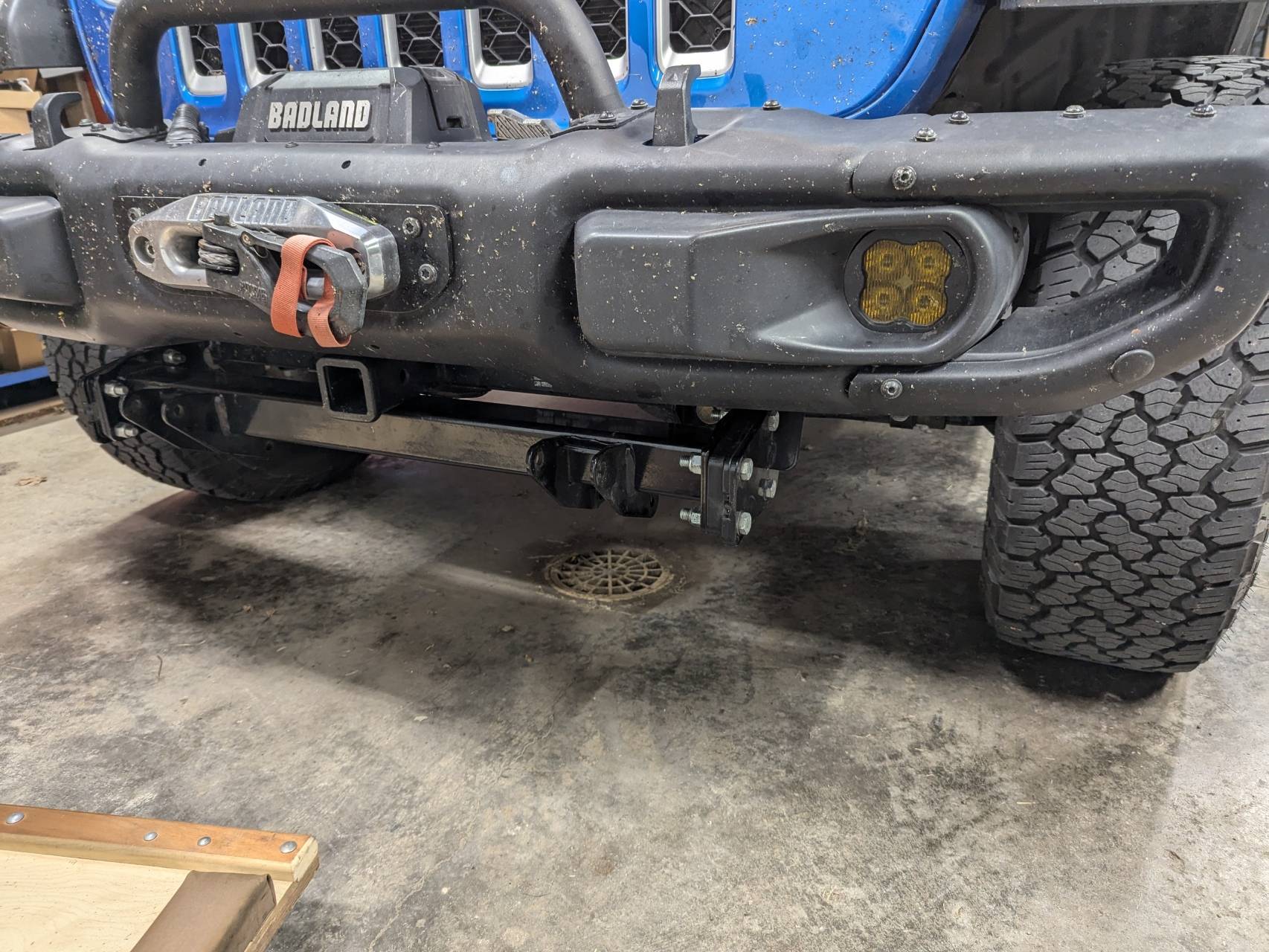

Today I actually did something TO it - I put the snow plow brackets back on for the season.
I typically take them off in early April or so to reduce weight (these beasts are heavy) and reduce drag under there with that flat bar facing the wind.
You can tell what parts are the snow plow mounting parts - they are the only clean and bug-free bits on the whole Jeep!
That bar across there is pretty heavy and hefty, with tonight's freeze, maybe it won't get plastered with bugs from here on.

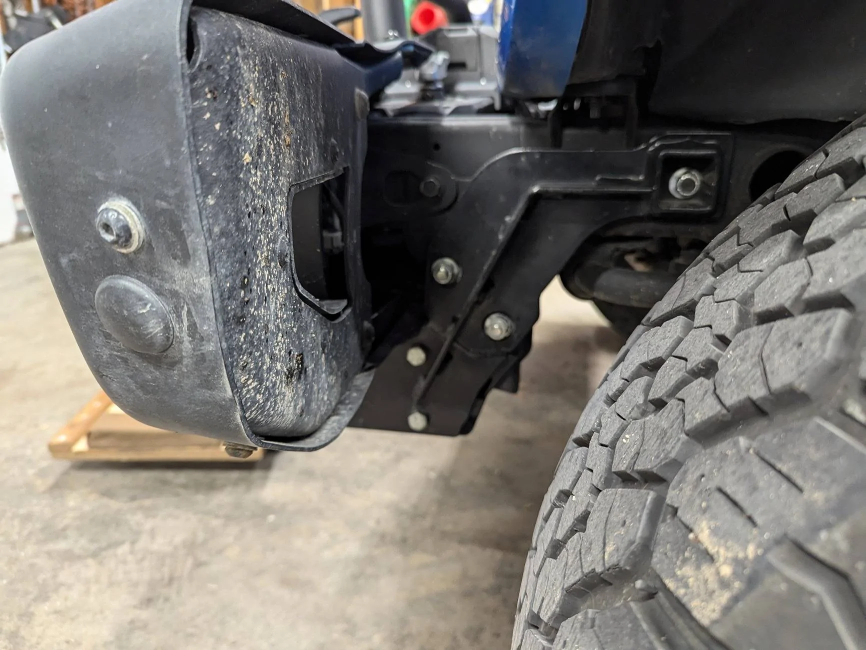

Left and right brackets each weigh easily over 10 pounds and bolt directly to the frame using 3 bolts each.
Jeep Gladiator What did you do TO your Gladiator today? [ADMIN WARNING: NO POLITICS, NO GUN TALK] PXL_20241014_190417941

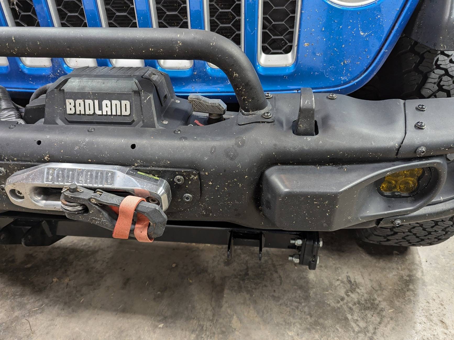

It's what you get for living close to the river and next to a creek surrounded by a lot of farm land, hills and valleys - BUGS
IMO, it's worth spending the 30-45 minutes putting the mounting bar and brackets on, then taking it all back off in the spring. A lot of weight savings (but my wife would tell you I could save as much weight if I just............ yeah, won't go there, it would involve eating less)

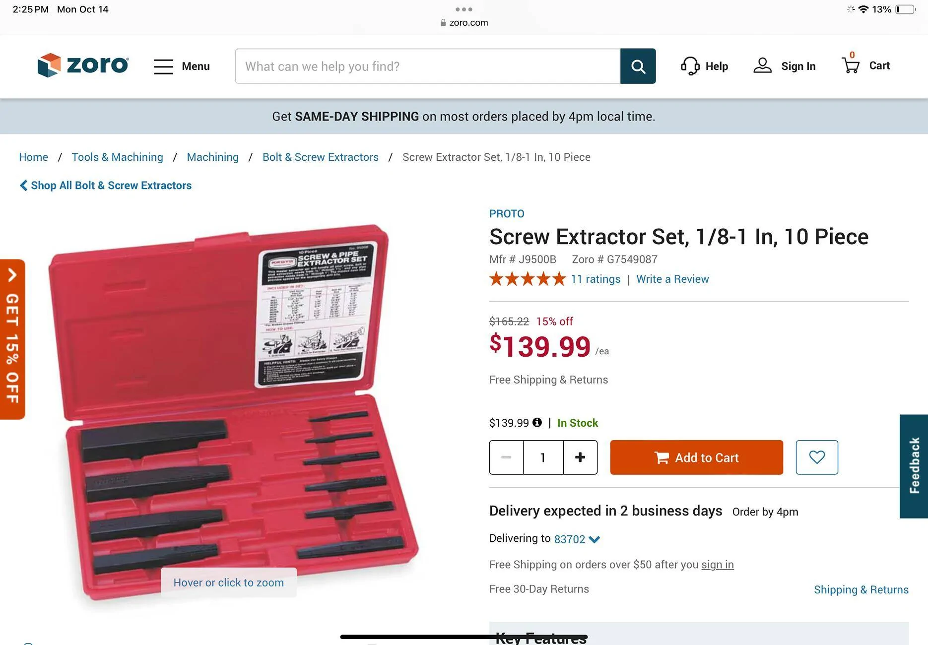

You know a good kit for a reasonable price? If it starts getting expensive, I have a Jeep shop that will probably do it pretty easily. I´d just like to keep the cost down.
