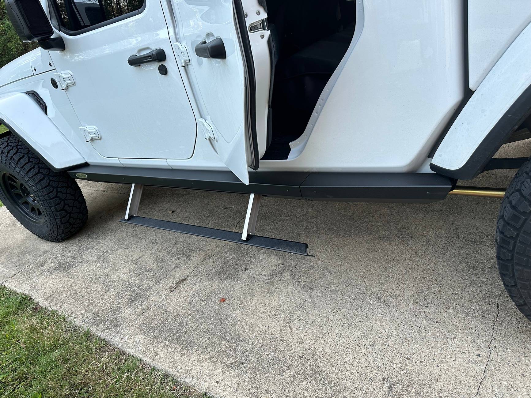

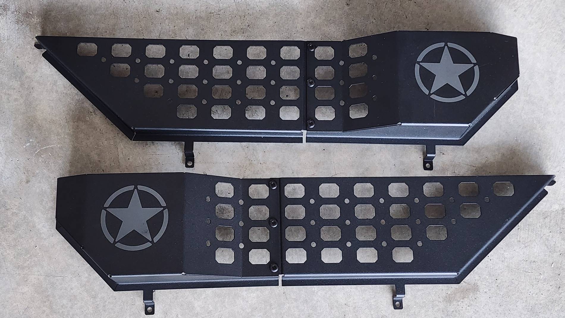

Finally got my RSE steps on. Been a battle with missing parts. No fault of RSE (Ian was awesome) but the company I bought them through kept giving me the run around. Like the way they look but the clunk sound when they retract will take some getting used to.

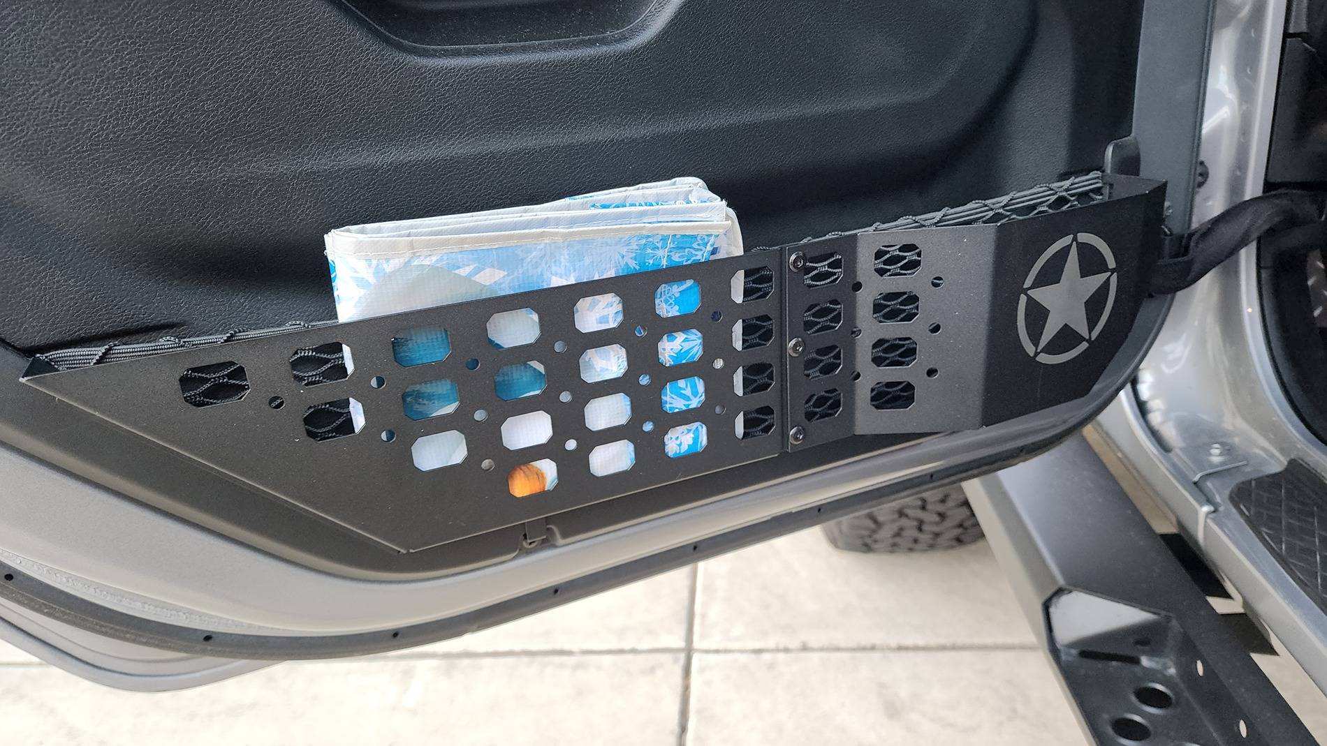

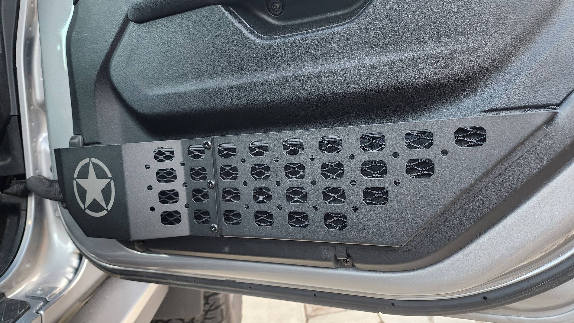

Got new door pockets on Amazon. Much better than the net pockets, which were starting to stretch and lose elasticity. These are nice because the front part isn't so wide (to hold drinks) that my leg rubs on it.
Jeep Gladiator What did you do TO your Gladiator today? [ADMIN WARNING: NO POLITICS, NO GUN TALK] 20241007_173152
Jeep Gladiator What did you do TO your Gladiator today? [ADMIN WARNING: NO POLITICS, NO GUN TALK] 20241007_173649
Jeep Gladiator What did you do TO your Gladiator today? [ADMIN WARNING: NO POLITICS, NO GUN TALK] 20241007_174159
Update 10-20-24: Need to replace these with slim ones, which is unfortunate because these are so nice to have extra storage without rubbing up against my legs. Wife can't drive the Jeep because seat won't slide forward. Thought about cutting notches, but don't want to put that much work into it and risk really hacking it up.

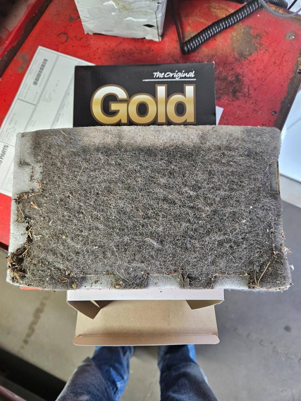

Going over the JT for our trip to Denver next week. Think it needed an air filter. Only 43,000 miles on the oem one. Surprised that it didn't throw a code as sensitive as the ecu is on the diesel.
