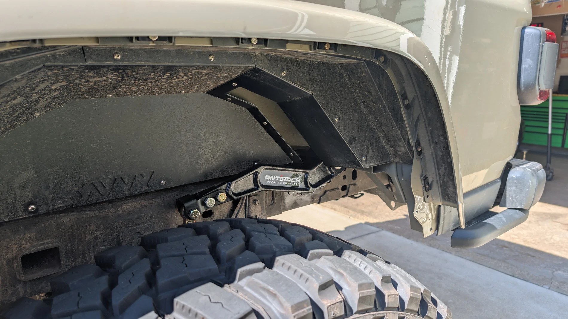

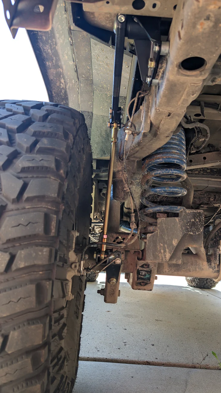

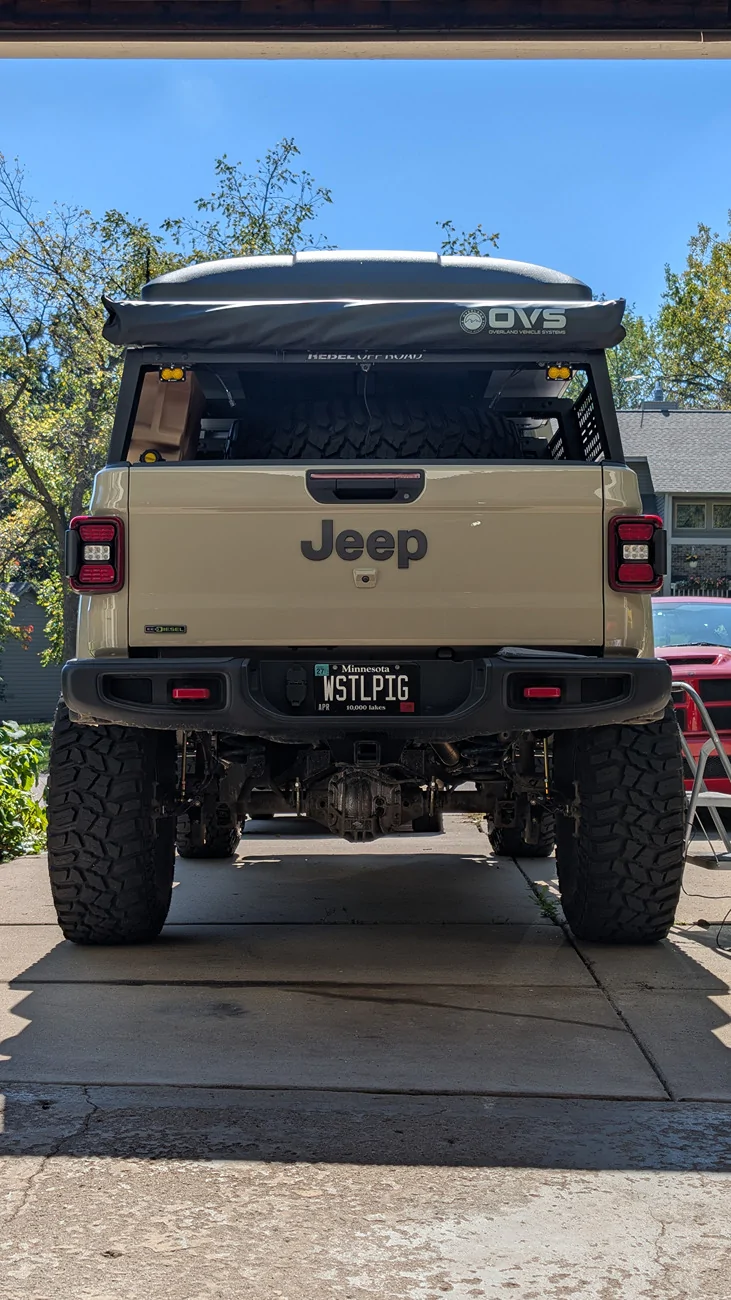

Antirock. Hard parts were easy, easy parts were hard. Didn't finish, broke for the wife's bday. Still need to set links and trim the Savvy liners.
Progress in my free time.
Rear antirock is done. Liners trimmed. Very happy with the cleaner rear axle. Still hate how the u-bolts look on the triangulation kit. I did weld the truss to the tubes but I contaced Rock Krawler and asked if I still needed the u-bolts and they gave me the blanket safe answer of "yes." I don't really want to find out in Moab so I'll leave them on and them maybe remove then when I get home later in October. I really don't see a need for them but they're not hurting anything, aside from my ego having welded them but still looking like bolt-on slop. Maybe I'll cut some u-shaped metal brackets to wrap around the lower side of the axle tube and really weld it on there, tie it all together.

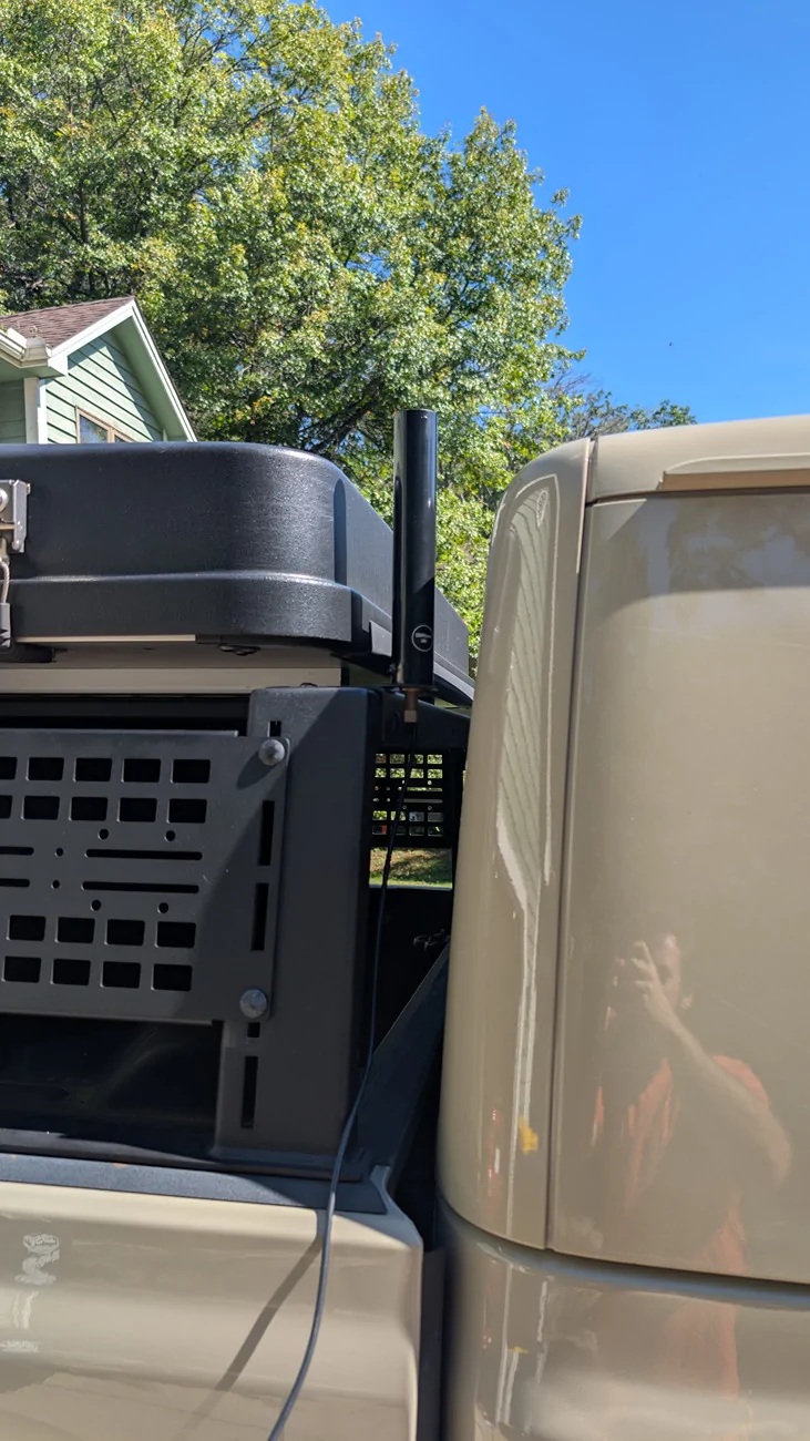

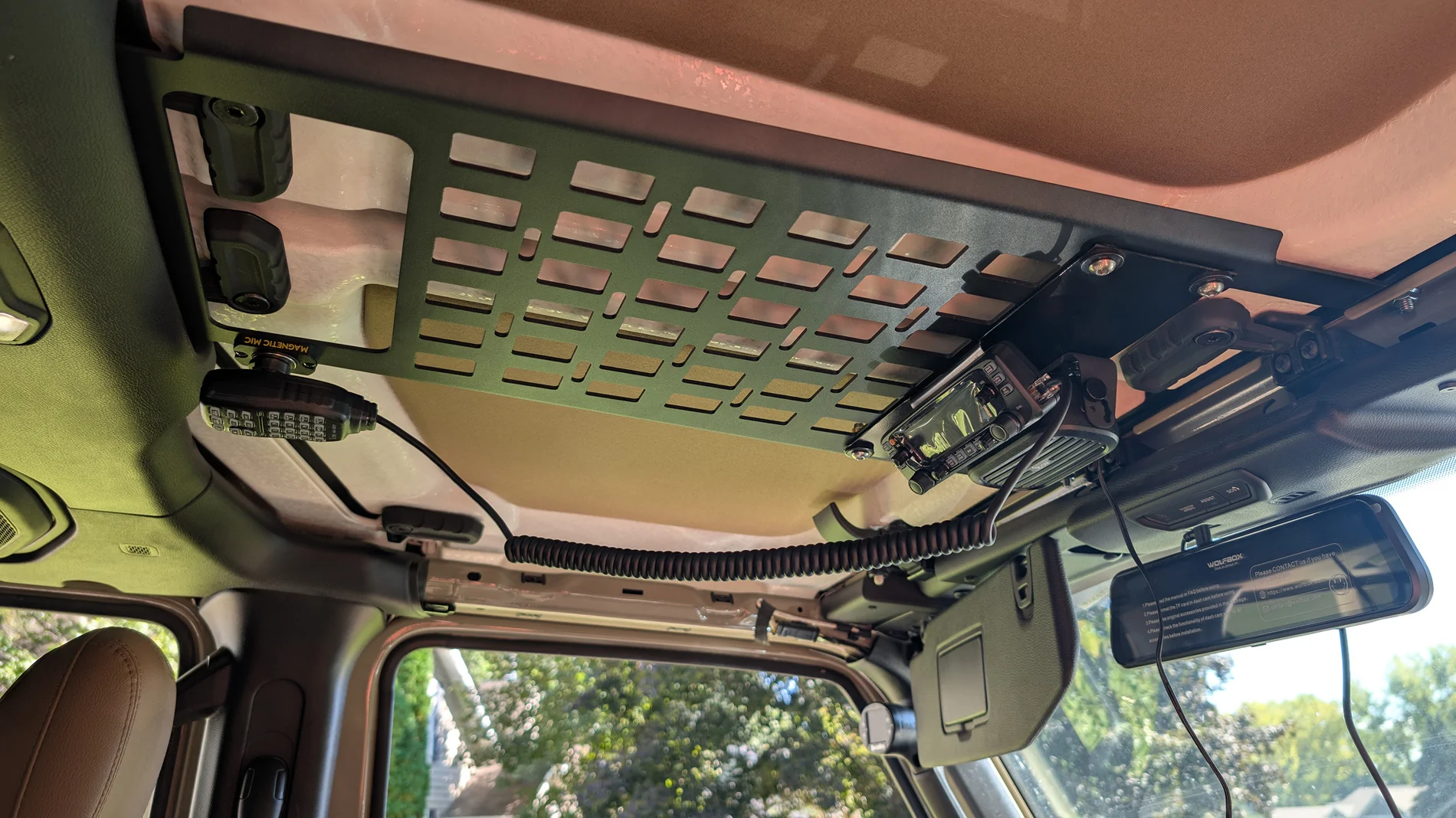

Working on rear dust lights and rear camera for the wolfbox mirror.
Wolfbox mirror itself has been hardwired with the monitoring feature. Made a bracket for the radio head and speaker on the overhead molle. Made a bracket for the antenna. Both brackets are sort of temporary solutions until I build my plasma cutter table I think. They were hand cut with various power tools and I just don't like the look. Made of thin steel so hopefully in the worst case of a rollover if one of us were to hit our head on the radio it will deflect and if a branch knocks the antenna it will deflect.
So what's left is actually running most of the wiring. Rear light to engine bay aux switch. Rear cam to mirror, think I'll run them together along the rack then down between the cab and bed and along the frame up behind the battery, passing the camera through the cowl foam. I never liked the wiring through the cowl approach until I saw the factory does it, so fuck it. Antenna will come down between the bed and frame to join the rear lights/mirror and run forward and up through the cowl as well to the radio in the glove box. GPS receiver still needs hooked up to the mirror. Speaker needs run down to the radio. Radio needs wired to the interior aux switch behind the glove box.
Then after testing I need to rip the radio back out to modify it to transmit on all bands. Yeah, I know, controversial. But I do have an FCC amateur license, GMRS license, Air Traffic Controller's license, and pilot's license... I think I'm morally and ethically comfortable modifying my shit to transmit on whatever I want. Really I just want my wife to be able to take the handheld out to spot me cause we can't hear each other yelling over the diesel.
Tomorrow is supposed to be a shakedown run before Moab on Oct 1st. Hopefully I got all the PSC hydro-assist stuff right.

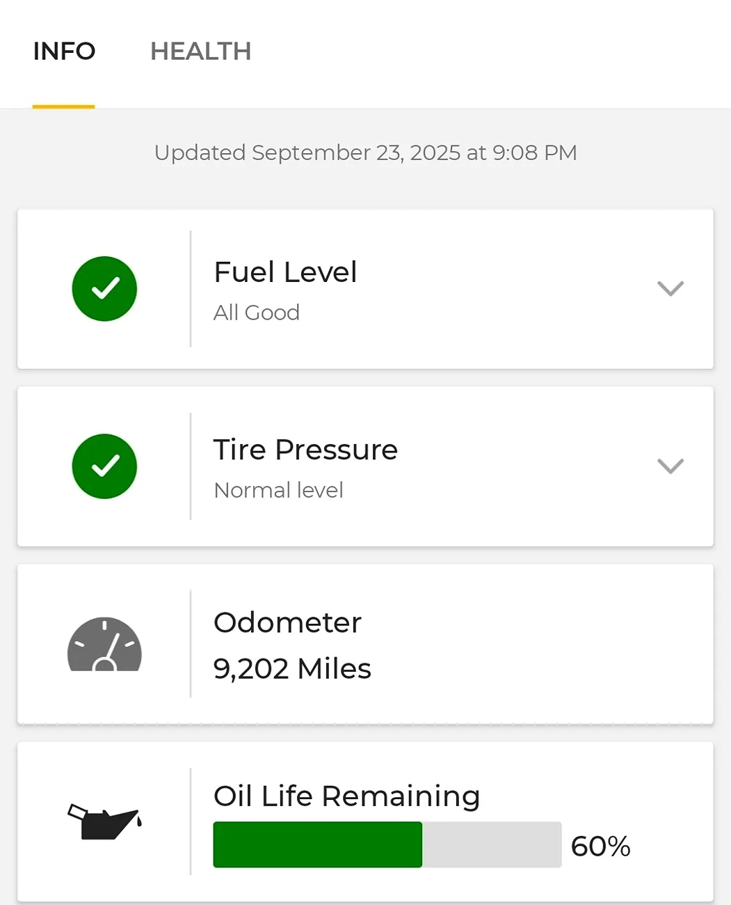

I'm at 3000 miles since mine was changed, and I show 60%.
My grandparents are gone now, but they lived in 3rd St in Morgantown then moved to Kingmont Rd. Most of my family have the last name Viglianco and live in Clarksburg.
You will see 5800-600k when ypur about 10-15% I usually change mine at 10%

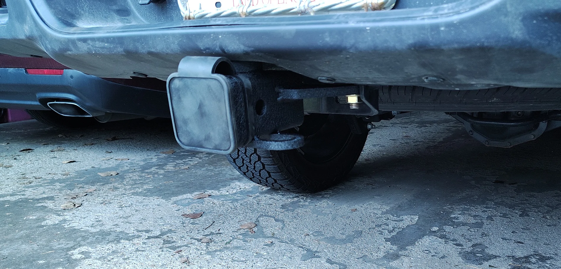

Yesterday I got my receiver mounted.
I'll just add one piece at a time until I have a whole trailer.

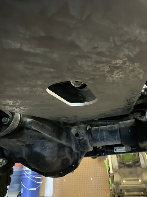

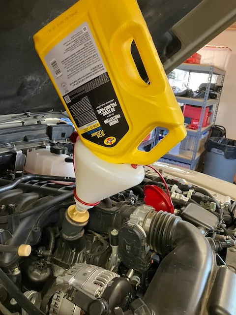

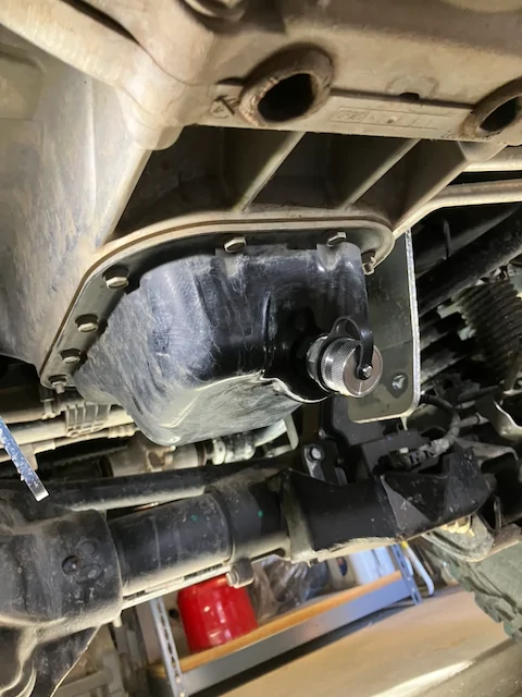

Changed the engine oil / filter and installed a Valvomax drain plug. All previous oil changes were done by dealearships. I had to use my short 1/2" drive breaker bar to get the OE drain plug loosened. 20 ft-lbs. my butt. Think the last guy used an impact to tighten it.
Jeep Gladiator What did you do TO your Gladiator today? [ADMIN WARNING: NO POLITICS, NO GUN TALK] IMG_2622
The skid plate that I have should protect it well enough.
Jeep Gladiator What did you do TO your Gladiator today? [ADMIN WARNING: NO POLITICS, NO GUN TALK] IMG_2627
The Lisle funnel with the adapter worked really well with the 5 qt. Penzoil jug. Almost like they were designed to work together.

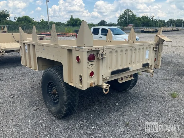

I won a whole trailer in an online auction of government surplus today. Possibly picking up Friday and my Adventure trailer build will begin.

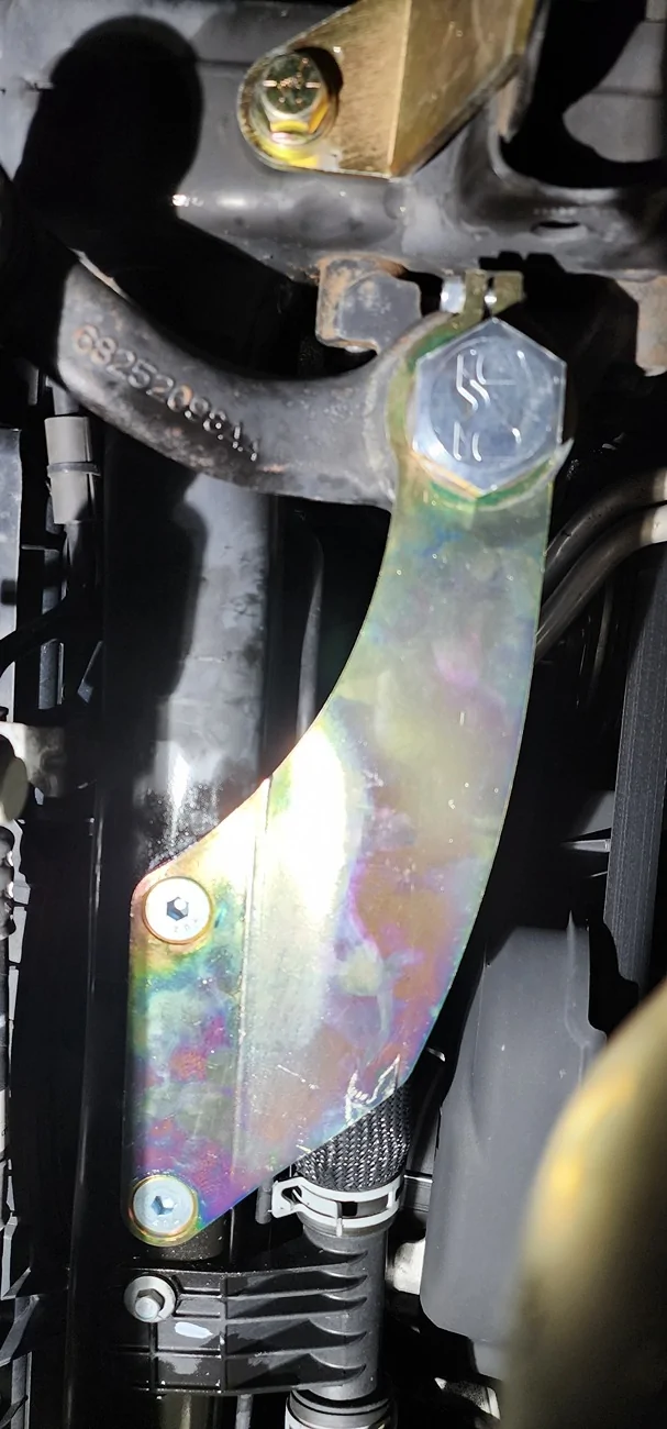

Installed the MetalCloak Sector Shaft Brace tonight, and adjust my front and rear tract bars.
Hopefully tomorrow after I'll install their Tie Rod Bar and the Draglink and flip kit. It's supposed to be 95° before the real feel and humidity, so we'll see about that.
Mine is sitting in my garage. I need to install it. How was it? Not bad?
sweet!
