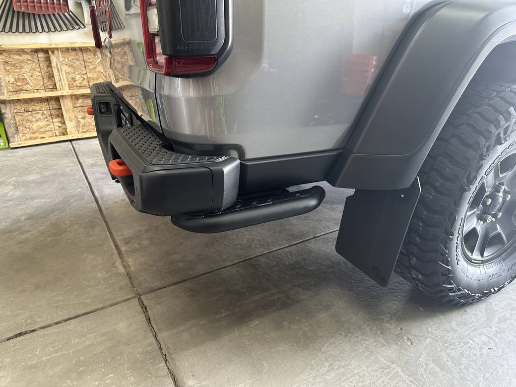

Installed Redrock bed side rock rails. Additional benefit...passenger side of the bumper had taken a big hit already, so these actually sucked the bumper back to the position it should be in.
Those things are of paramount importance. I don’t think I’d have a bed without them. Great addition.
