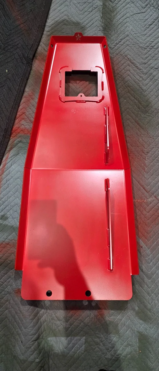

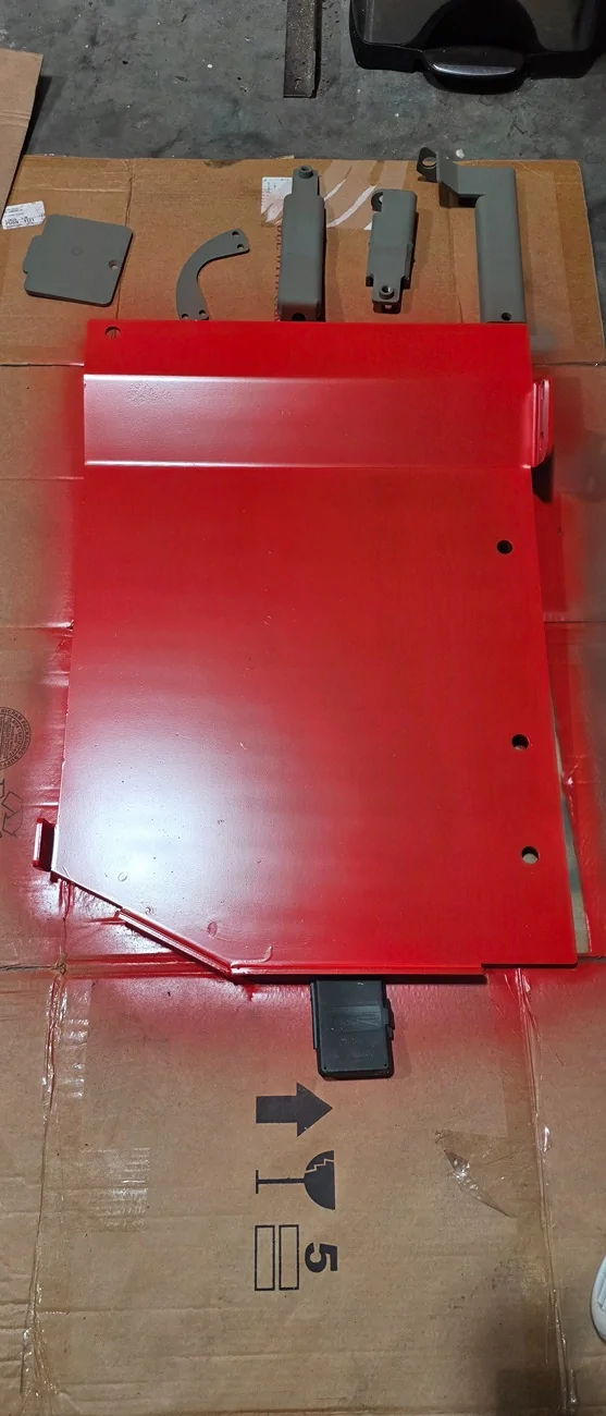

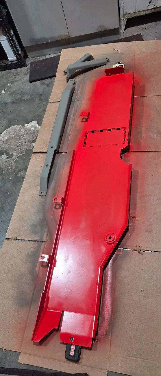

Inside (side you don't see when they're mounted under the truck) painted red. Can't decide if I'm going to do a second coat. Outside will be black Herculiner.
That should stand out pretty good are ya gonna tap it off after it dries and do a yellow band šŸ¤”

You won't actually see the red. It will be inside the skid plates. I did think of doing red raptor liner on the bottom.
Why not that would look Radical !!!

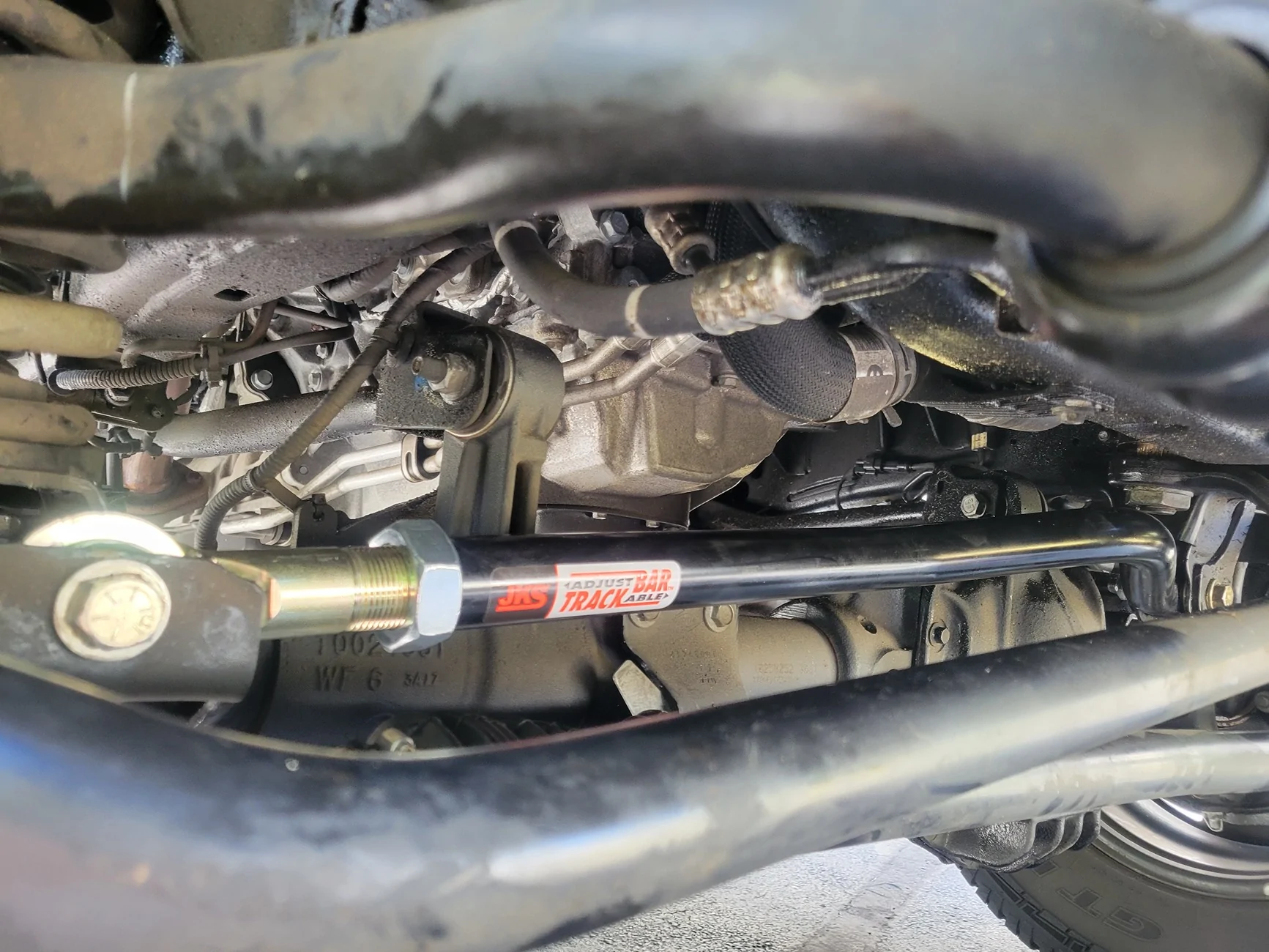

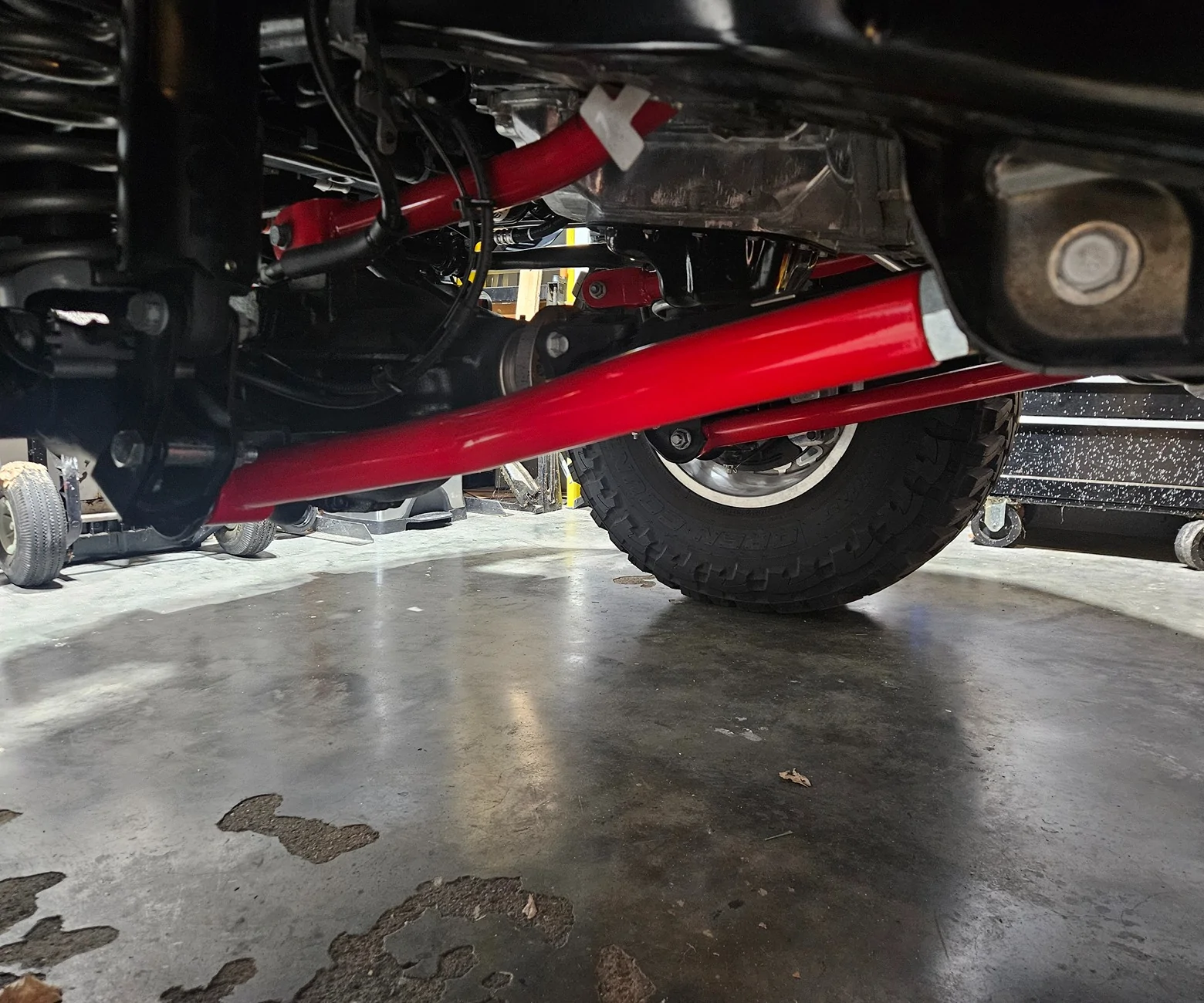

Got off work a little early today and installed the JKS Manufacturing front track bar this afternoon. Used 9/16" Grade 8 hardware. I will say there was a lot of preload on the Rusty's Off Road track bar reinforcement bracket as it was installed loose with the OEM track bar and everything tighten down. Had to loosen things up again to get the new JKS track bar installed.
Wow we was all doing stuff today. Today was perfect for it.

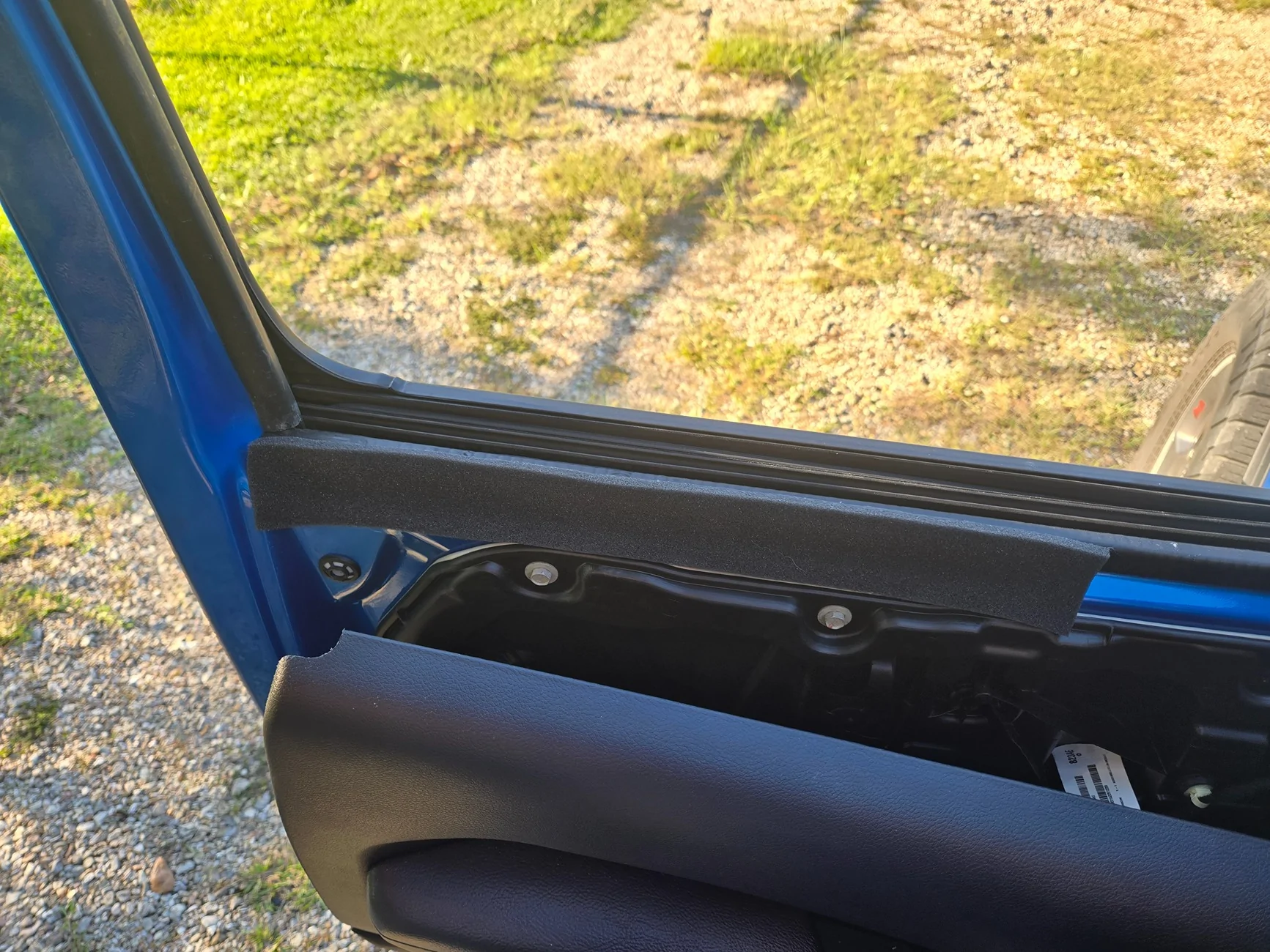

Took apart driver door and trimmed a few things and added some foam to hopefully silence a squeak that was along the window at the back corner of the door THAT WAS GONNA DRIVE ME APE SH!T IF I DIDNT FIX IT šŸ˜‚

Maybe I'll just paint the other side red to see how it looks. I really don't want to waste $100 or more on red bedliner, only to hate it. $25 in paint wouldn't be the end of the world. I could always recoat with red raptor liner if I like it.

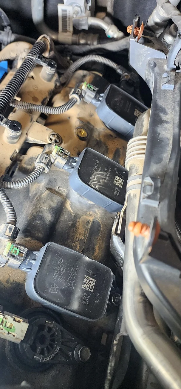

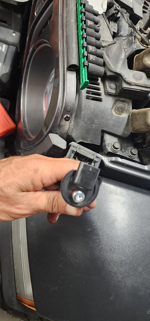

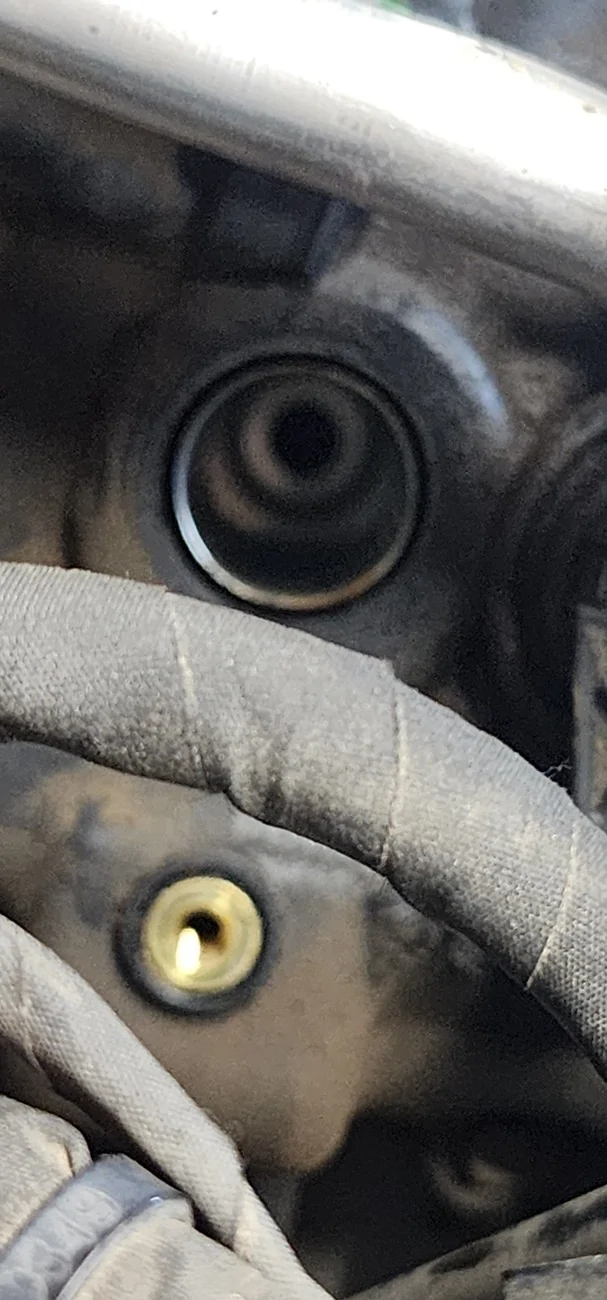

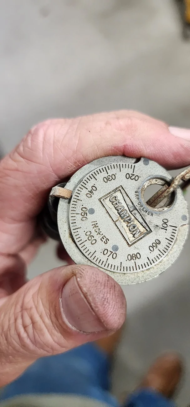

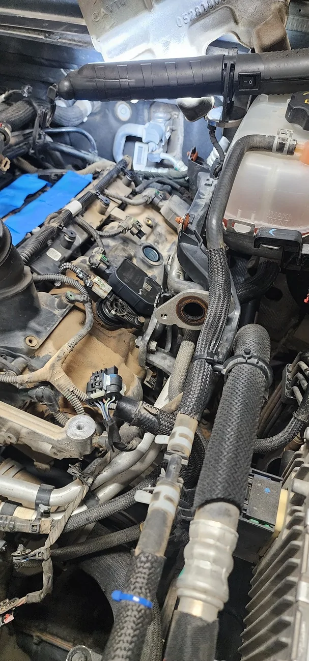

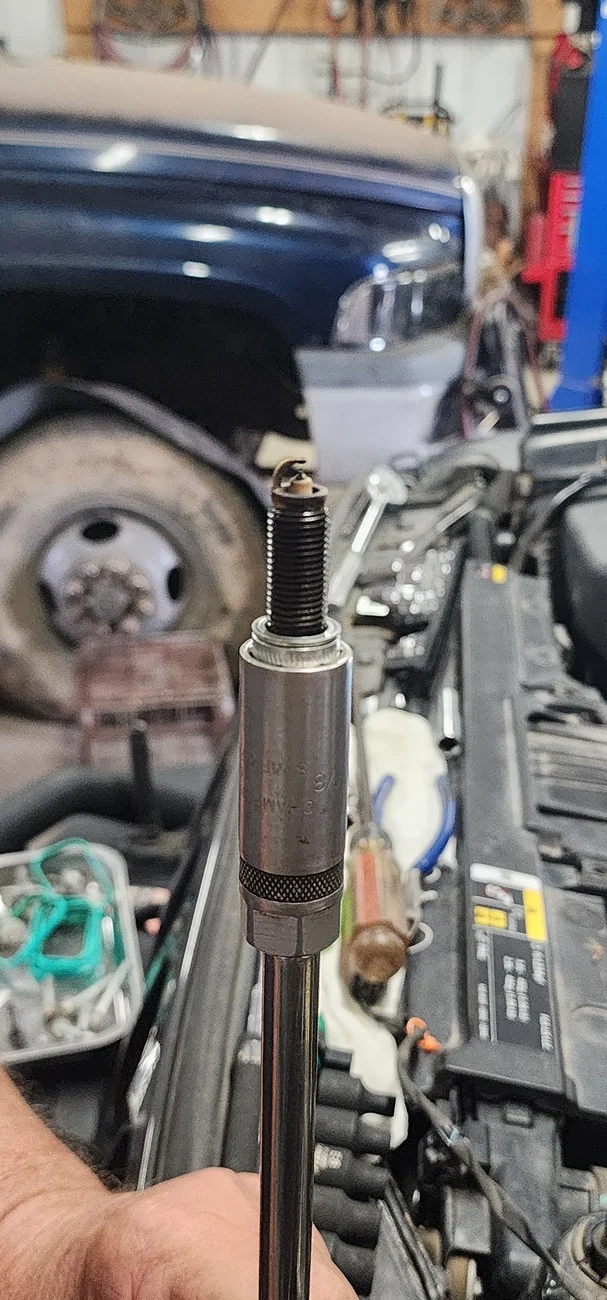

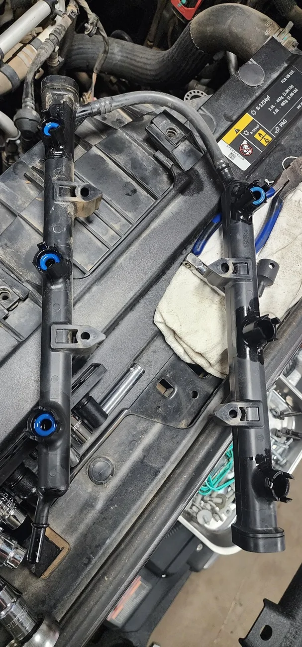

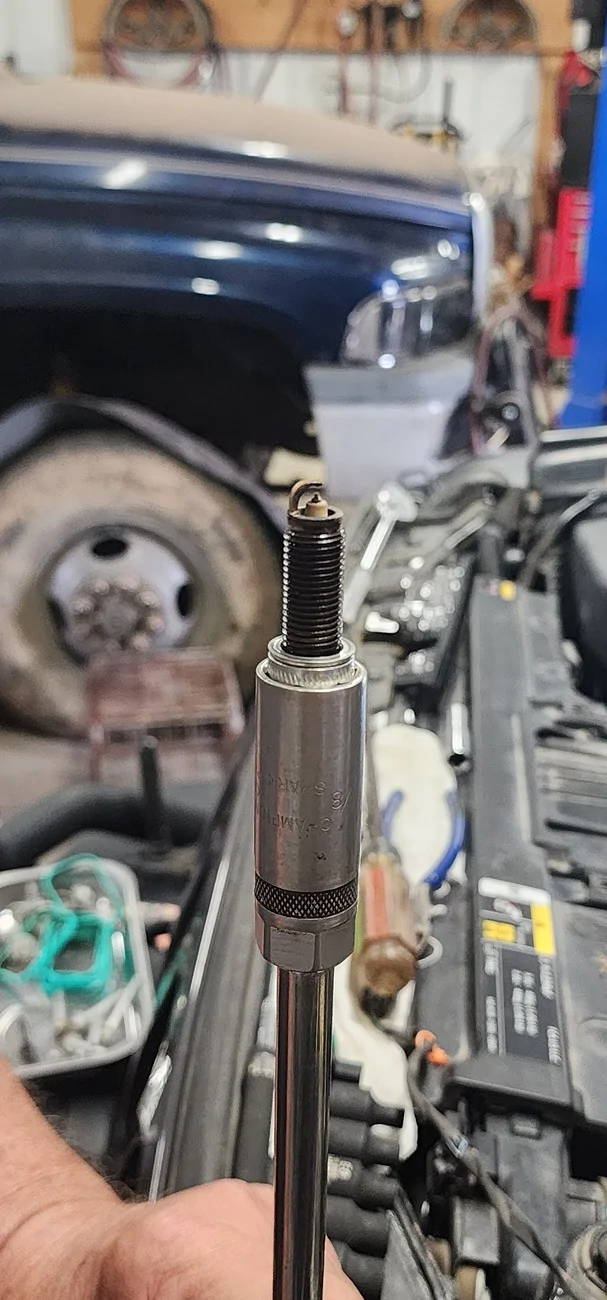

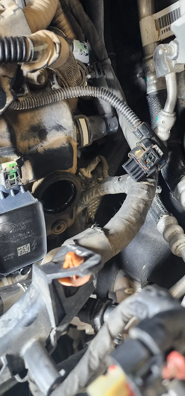

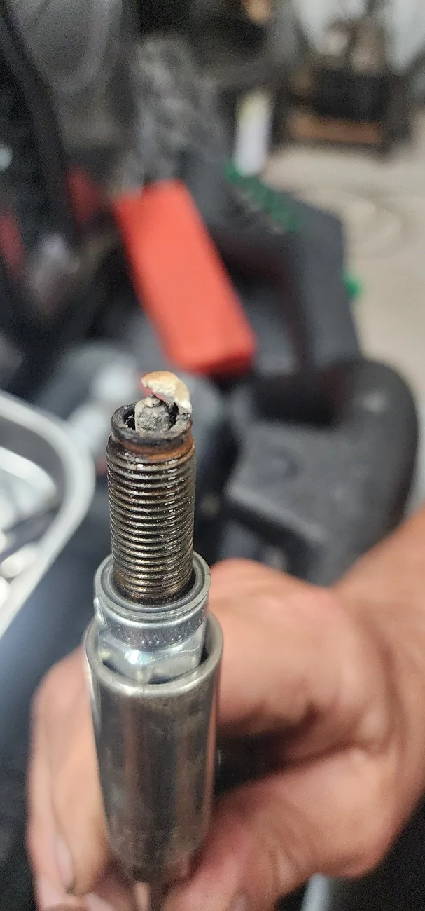

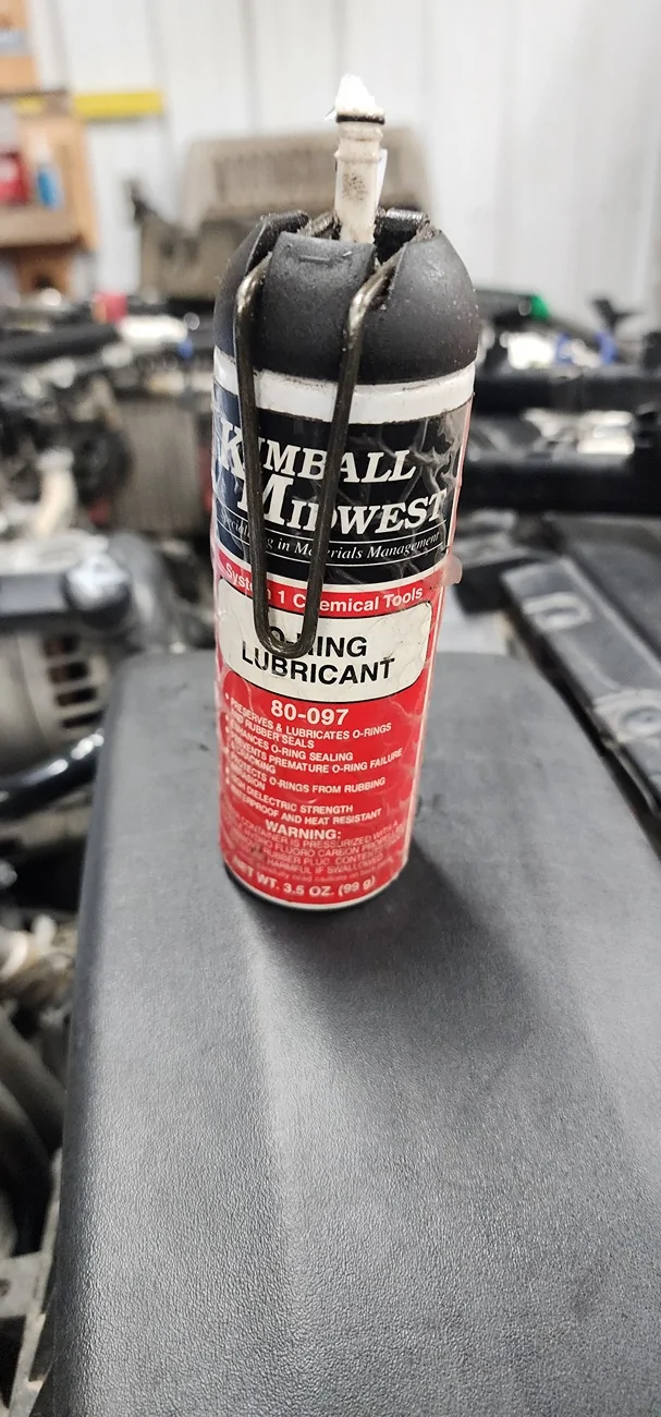

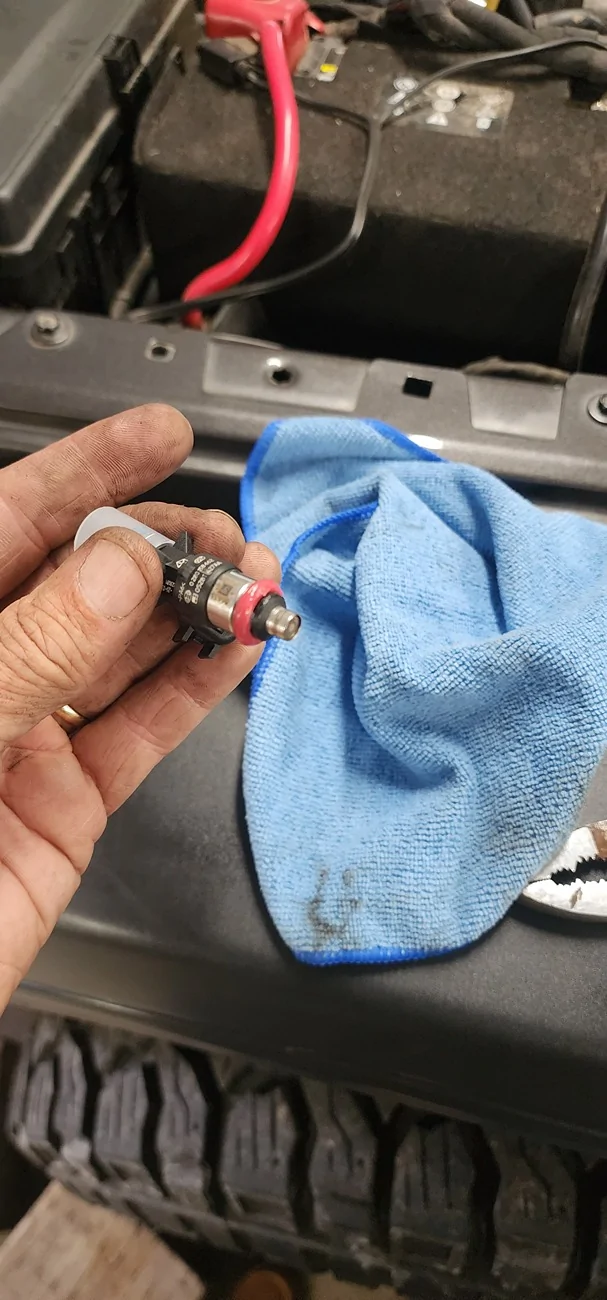

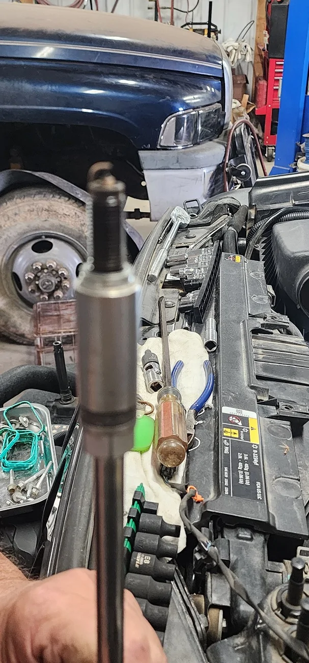

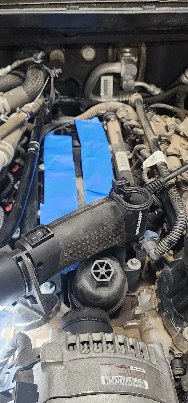

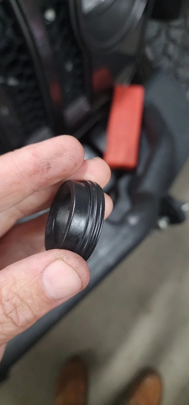

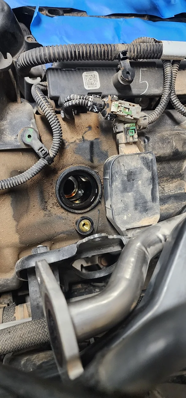

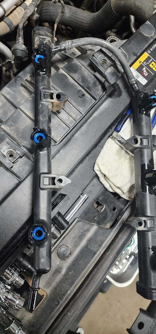

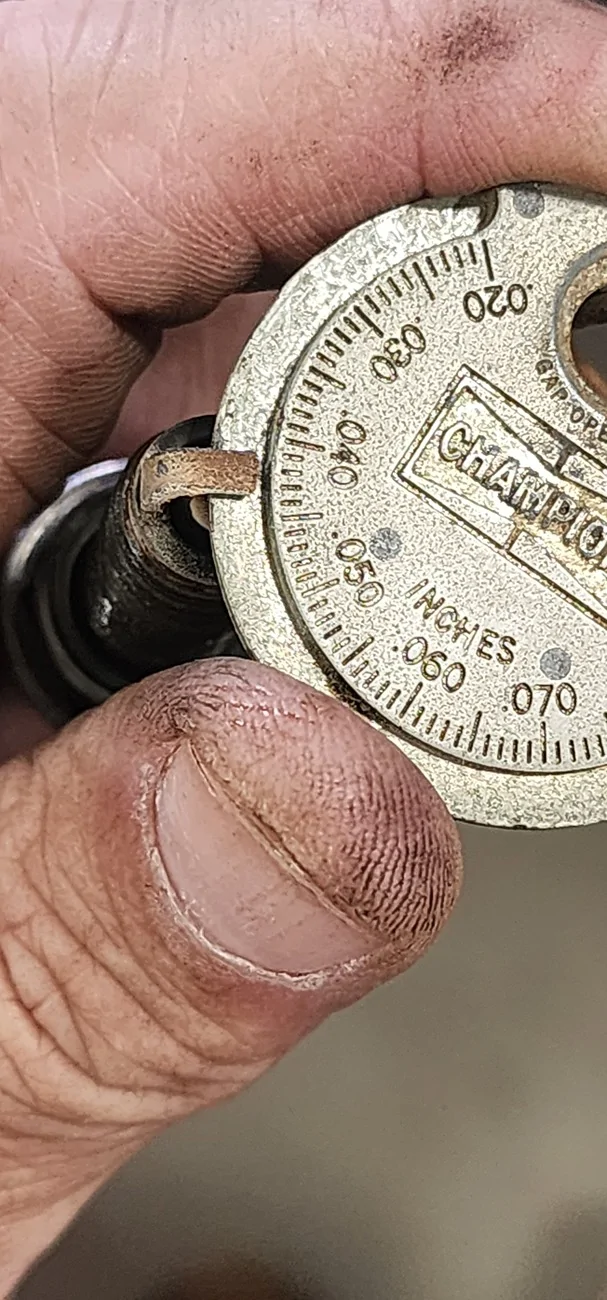

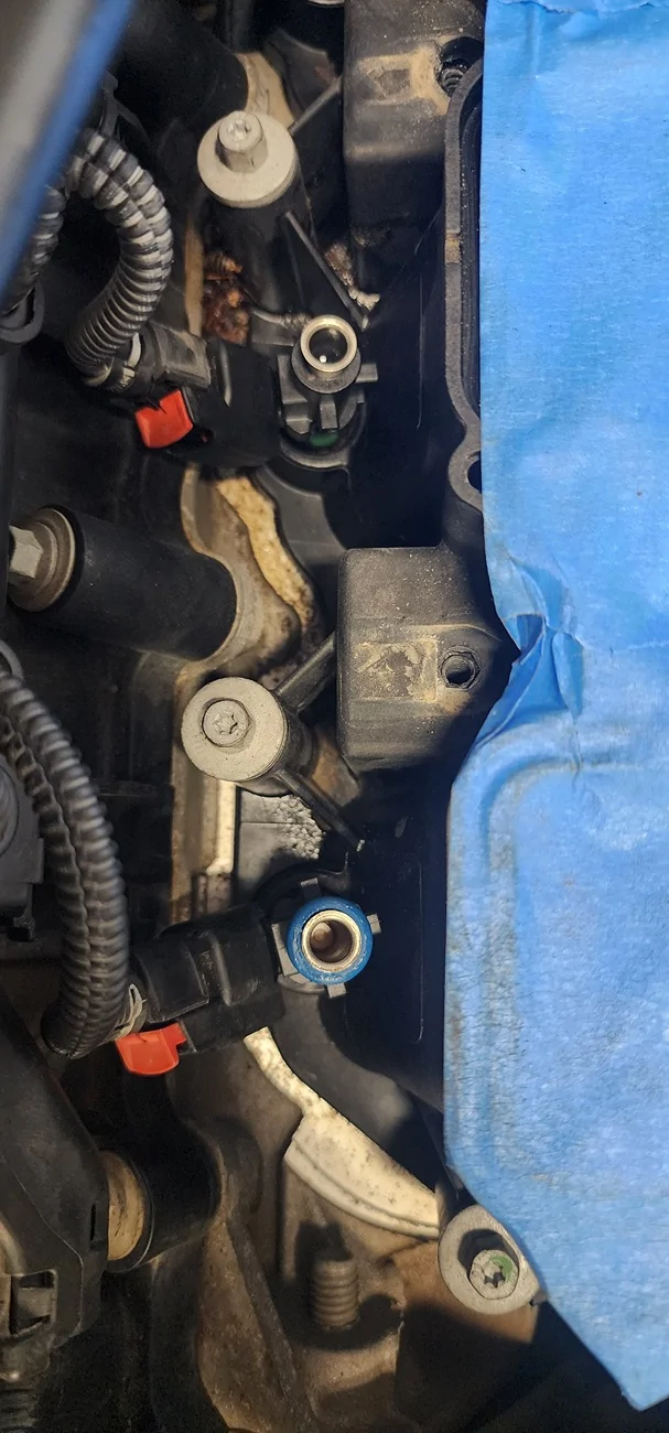

So today starting at 10am and finishing at 6pm with an hour ir so for lunch me and my Uncle Rick replaced Sparkplugs , Coil Packs , and injectors. And the camsensor on the drivers bank 2, plus both seals on each bank for the high lift cam oil sensors. In the one pick you will see the O-ring lube. That stuff was amazing. Also cleaned the plenum out with Non non-chlorinated brake cleaner and also cleaned the throttle body out ,and the EGR valve got a very thorough cleaning as well. This was a thorough cleaning. the o-ring lube was also used on the 6 new plenum seals that I also installed. It was a big job . But I was amazed at the increased power and acceleration. Even holding a higher gear on several hills I travel alot so I know this wasnt placebo

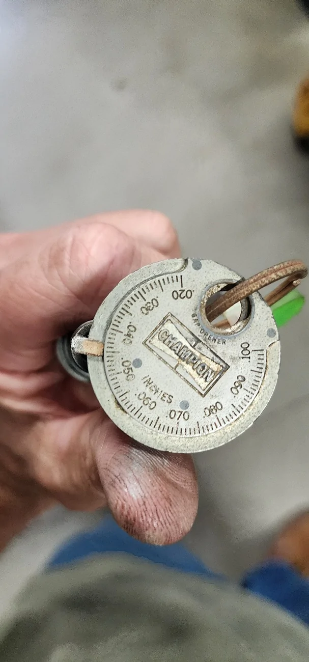

In the pics you will several plugs and gap measurements. #6 was the worst and probably where I was getting an occasional rough idle when cold. They ranged in gap from 43-46 .
P.S. shoot out to @WILDHOBO & @Maximus Gladius for some links to the lift solenoid seals and both on several guidance tips.
Super impressed and it didn’t take the two of you long at all! What’s up with that crappy spark plug? Were they all that way? Was there any part of that you’d do differently?
That was #6 all the rest looked much better. All but that 6th one was in the gap range very close. One thing I thing I would do is get a lay down creeper that was murder climbing up on top that lifted Jeep to get to alot if the bolts.
